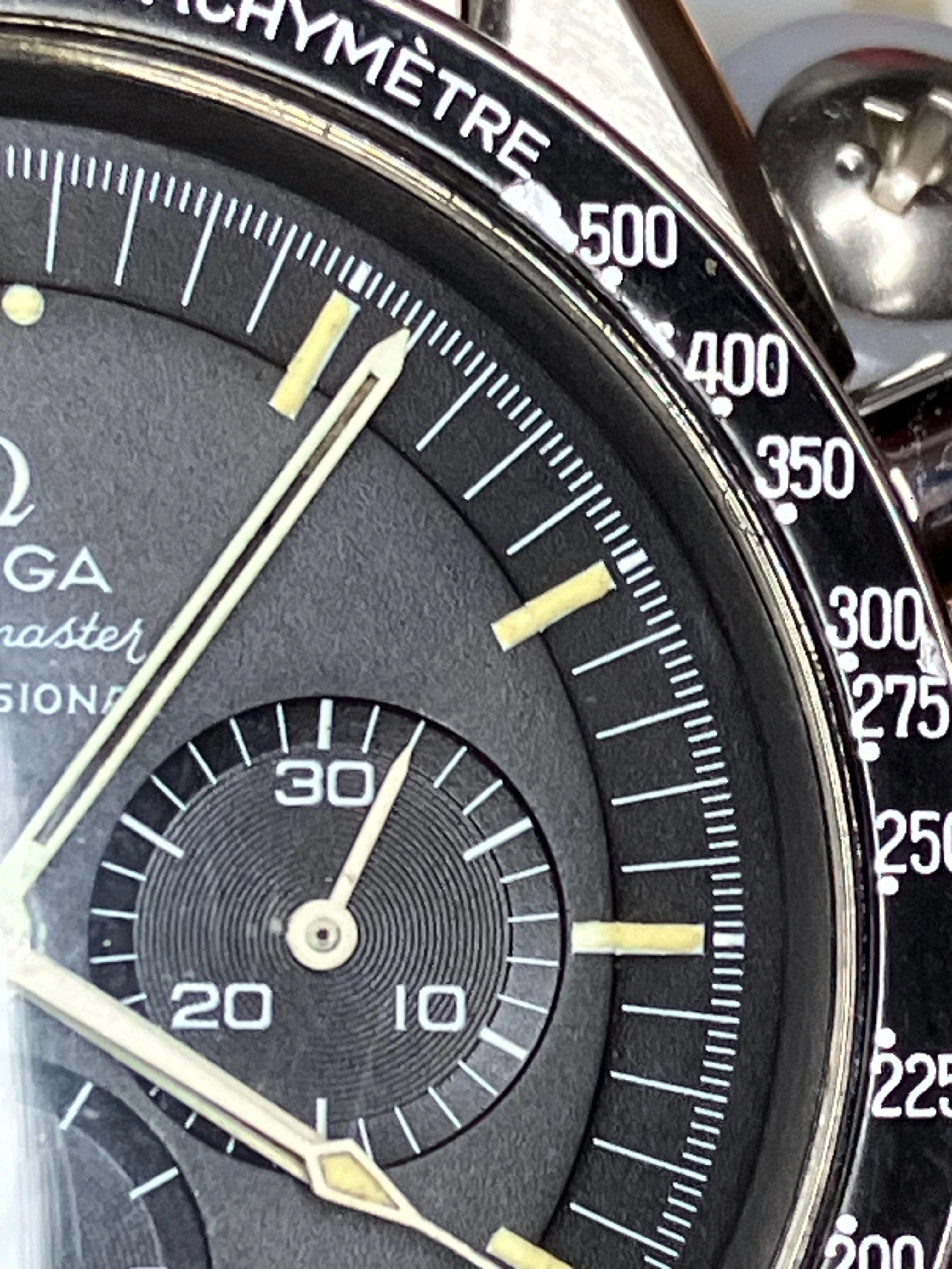

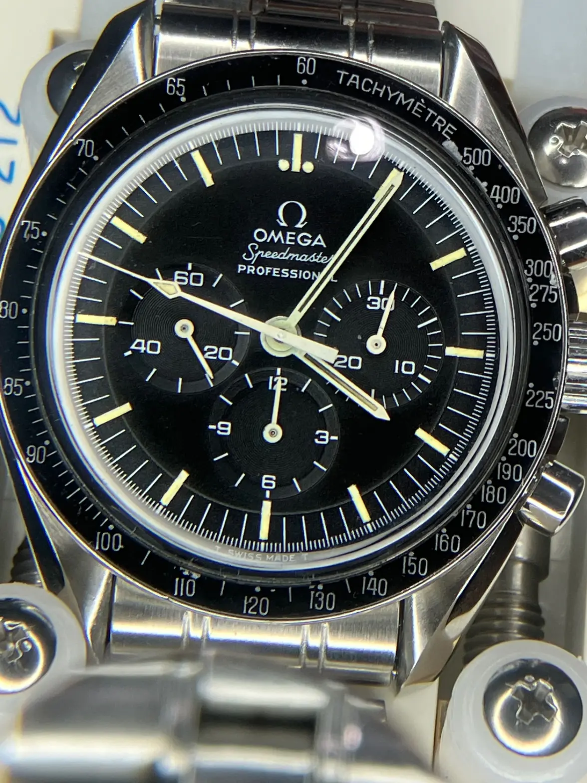

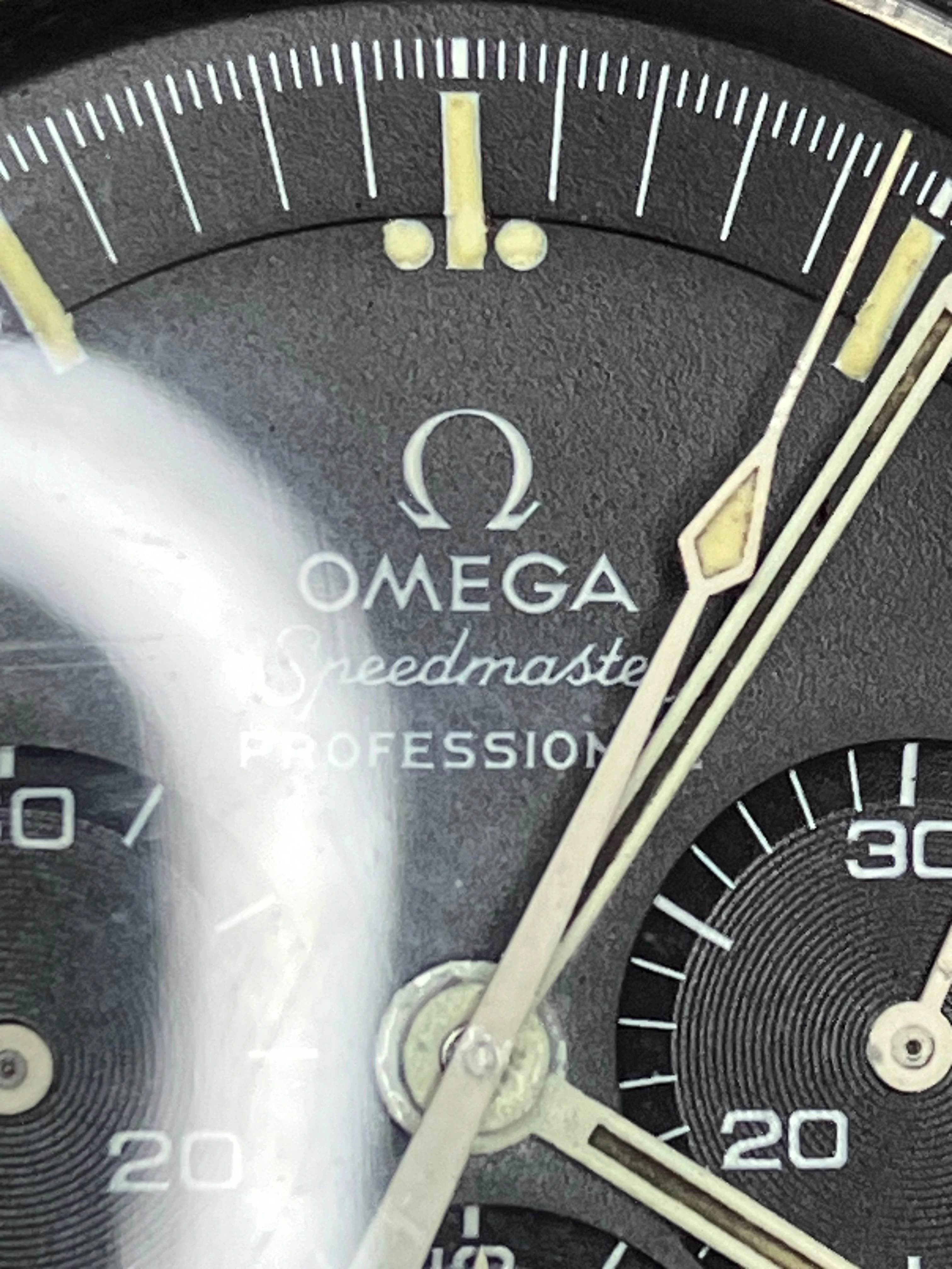

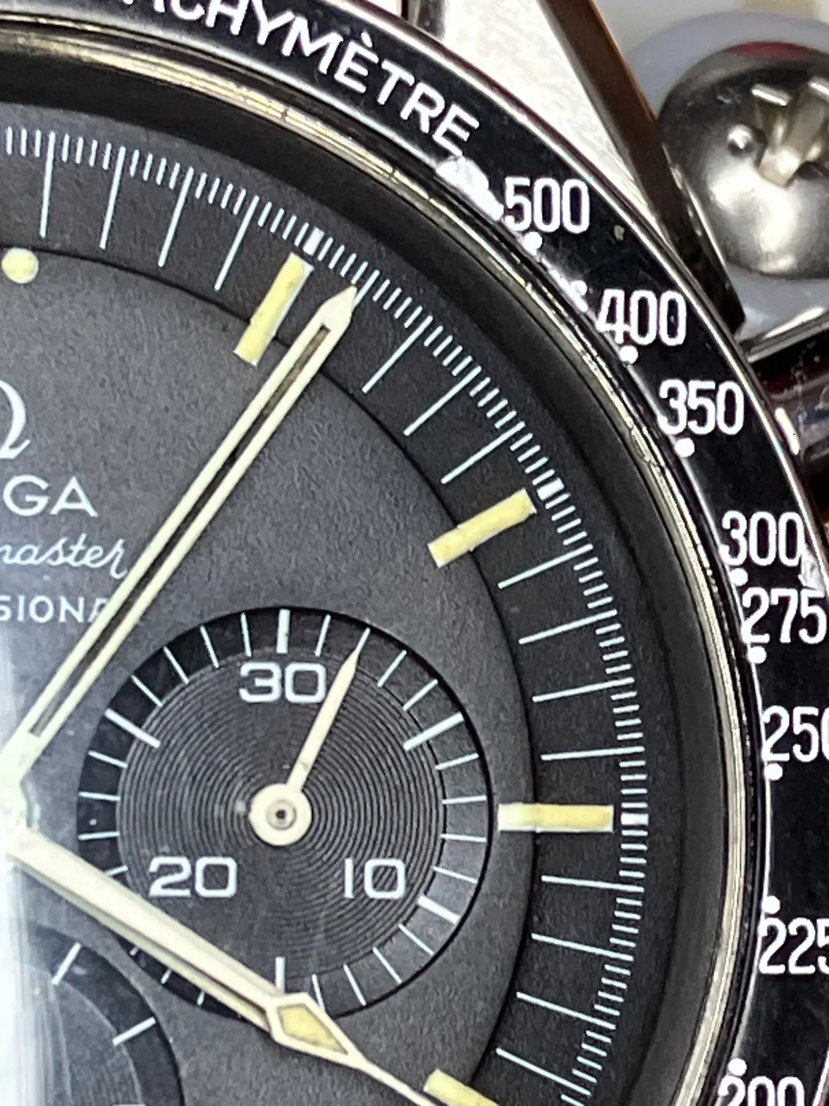

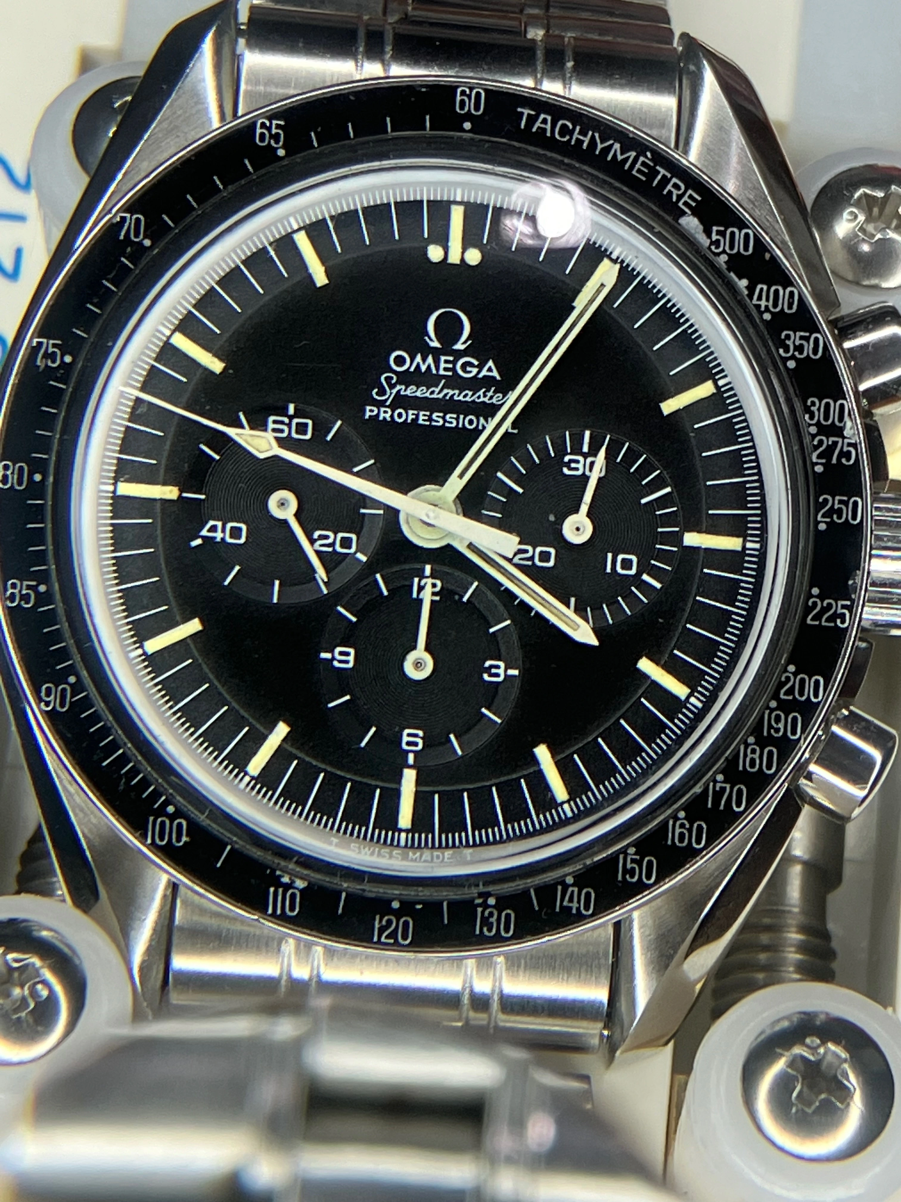

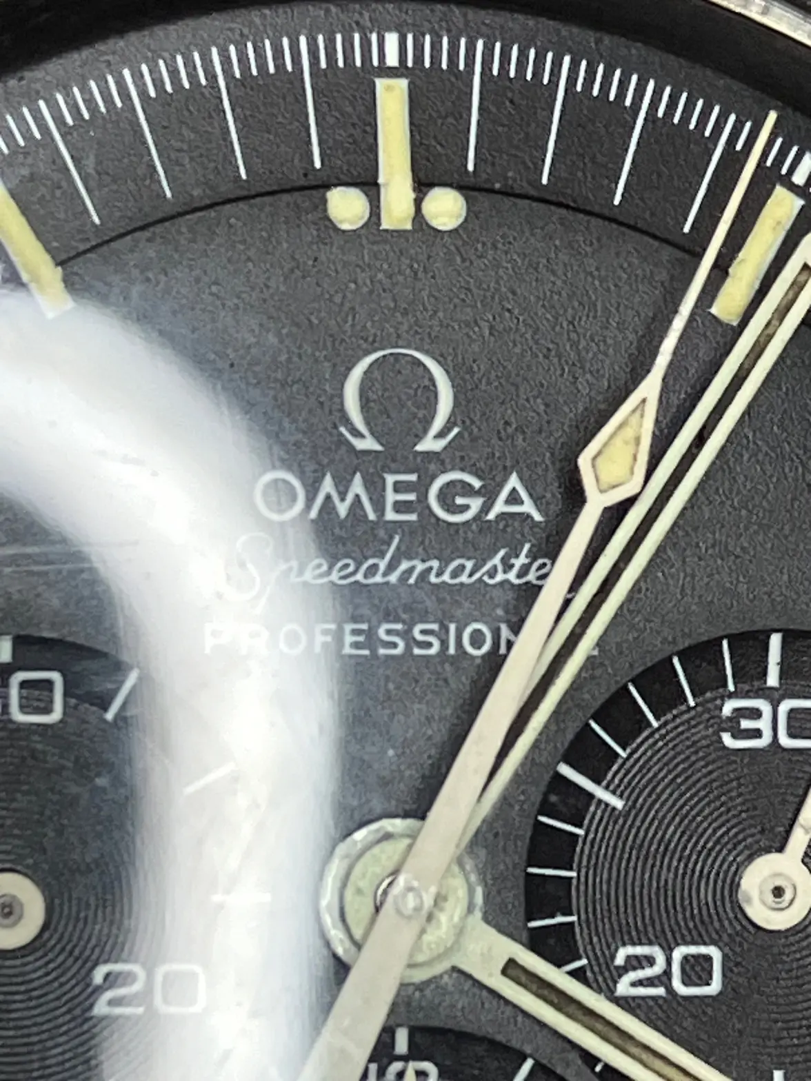

The watch I sent in for service some months ago:

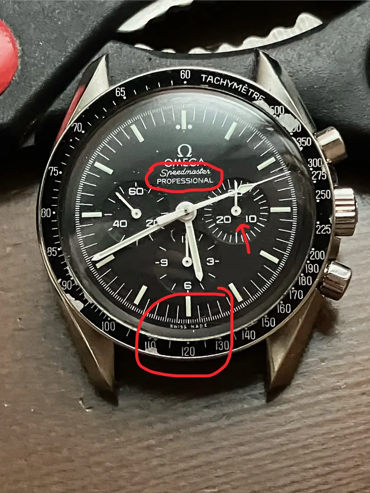

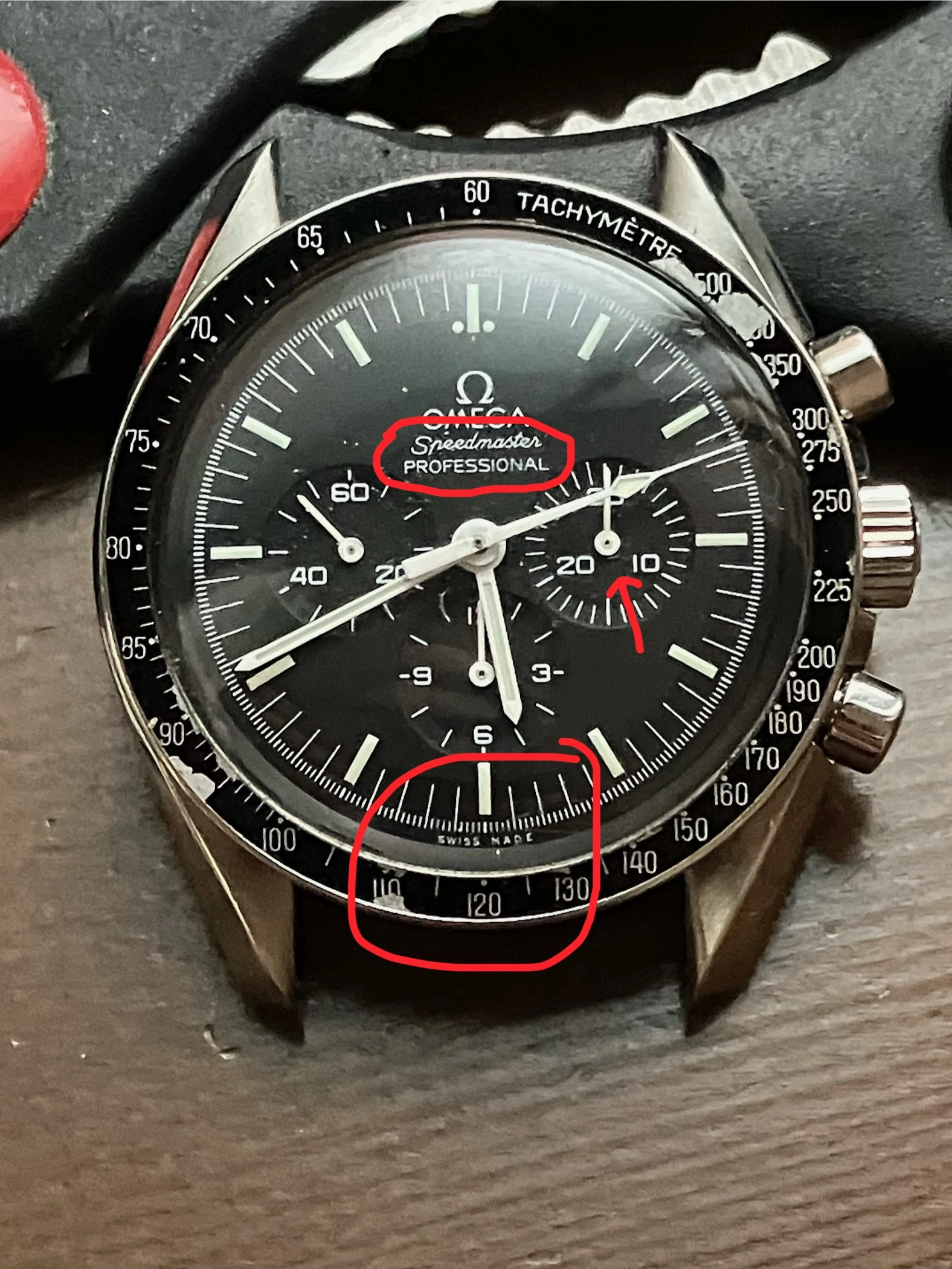

The watch I got back:
I would have been wearing my glasses had I driven to the shop but it was one of a handful of watches I was picking up and dropping off and didn't take a close look at it. The watchmaker insisted, when I called later, that he hadn't changed the dial and the bezel and case do seem to be the right ones. I seem to have a situation on my hands now.

If that is supposed to be the same bezel, he absolutely butchered it.

Have you shown your watchmaker the differences in the lume pre/post service? Even taking into account white balance and lighting, that’s indisputable.

The factor that is indisputable is the missing T marks either side of Swiss Made. Those don't just fall off. You got back a Superluminova dial so in a big way your watch is no longer as original as it was.

The bezel deteriorated a fair amount since I took the first photos, but the damage visible in the before photos is identical to the after photo.
It's absolutely a different dial—no step, no tritium lume, different S and r in Speedmaster and different PROFESSIONAL font. Looks like different hands, too. I've sent him the photos but he says he didn't receive them, so it looks like I'm trudging out there again on Monday to show him the pictures and I guess pick him up by the ankles and shake the original dial out of him.

you don't have to debate about the serifs and the lume, etc, as @padders already said, just reference the missing T's on either side of swiss made, end of discussion

Bezel spent a few days in the ultrasonic cleaner 🛁

The step doesn't typically fall off a dial either.
