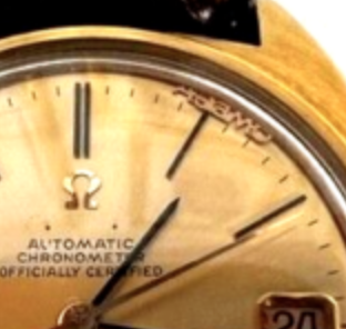

Recently bought a watch with a loose dial logo
After attaching it, I've been considering applying UV resin only on the underside and not push it inside the hole, so basically hoping it'll latch onto the feet of the furniture and help keep it in place
Wondering if there's any potential issues by applying UV resin inside a watch
