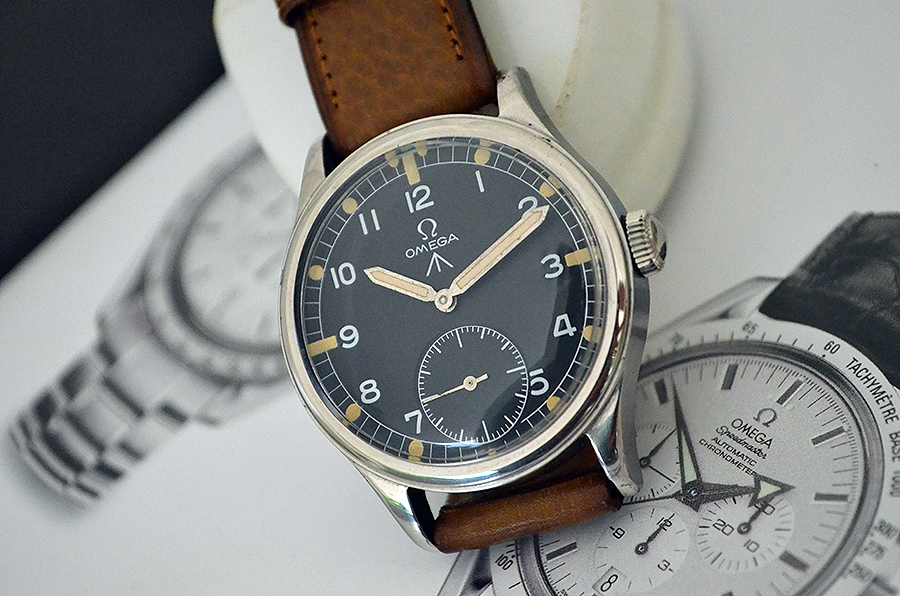

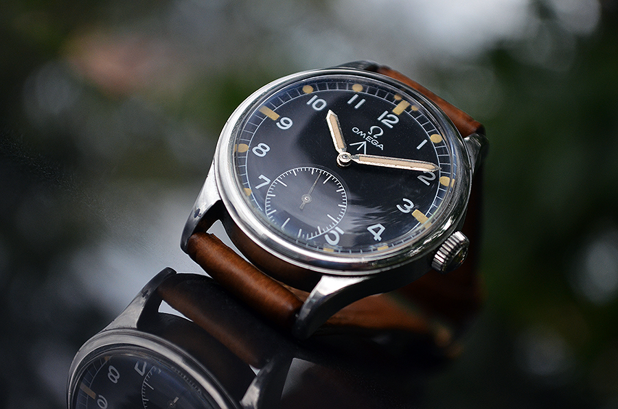

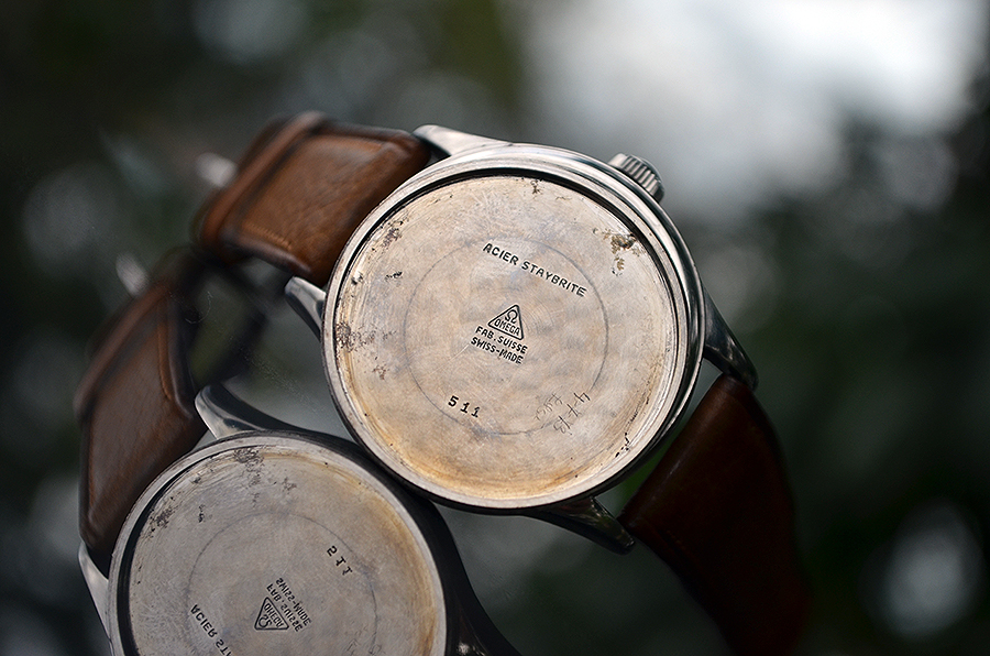

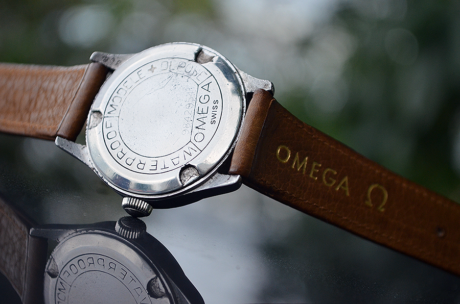

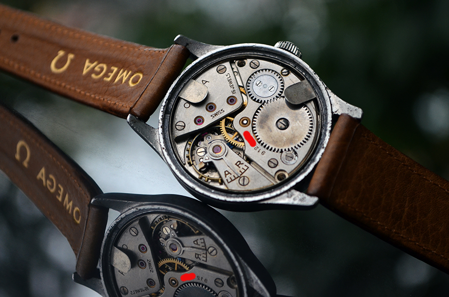

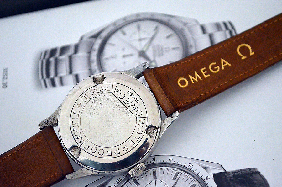

    Greetings,
    So i found this for sale locally and its claimed to be military, what do You think?
    DSC_1526_zpsqz0nafns.JPG DSC_1523_zpsg1ouh074.JPG DSC_1518_zpsnve8hup4.JPG DSC_1512_zps00kayple.JPG DSC_1511_zpsfaznx1ua.JPG DSC_1520_zpspn2j58xq.JPG

    The broad arrow would indicate that it is, but if it's a re-dial, they could have added anything.

    movement picture? Also did Omega ever do a caseback like that?

    No this is not an issued watch. The dial was refinished for WWW specs but the watch itself is not.

    The case definitely looks genuine Omega. Interesting, it's the first time I see this outside engraving on a three notches caseback. It's more common on six notches casebacks.

    It's a 30 mm "military" Omega made in India....
    Keep moving, it's nothing there to see (which is original and in good shape)

    Maybe Omega but absolutely not military-- and as such, a fake.

    There is a MoD specification for the watches they procured. The dial layout for the watch in the picture is for a WWW (ref 2444). An excellent reference for this is Z. Wesolowski's book "The Concise Guide to Military Timepieces 1880-1990". In it you can find examples of what the watch should look like. The watch in OP's picture is wrong. One easy example you can look for yourself online is how the watch should be marked on the case back. You will find that the watch in the picture is not marked correctly. There are several additional issues.
