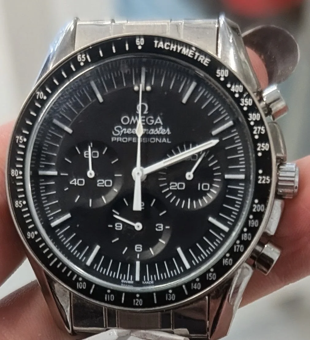

Is this Omega speedmaster watch fake?

Yes:
Hands are too short
Hashmarkers between minutes indicate it should be a cal 3861 dial but no DON bezel
Normally the subdial counters are the easy tell on fake Speedmasters but surprisingly these are what I expect on a real Speedy.
Sorry for not the best quality picture, but I have only this one.
Yes:
Hands are too short
Thanks, you saved me 1500 euro. I really want original Omega, but can't afford one.

Yes:
Hands are too short
I agree something is off here:
For a 3861, there should still be small hash-marks under the bold 5-second intervals, rather than those markers going all the way to outside of the track.
Also: the chrono-hand is incorrectly a square-end one
