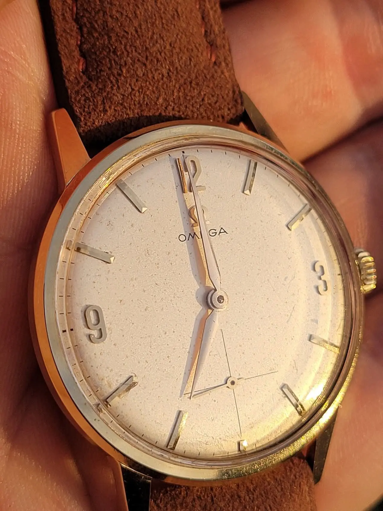

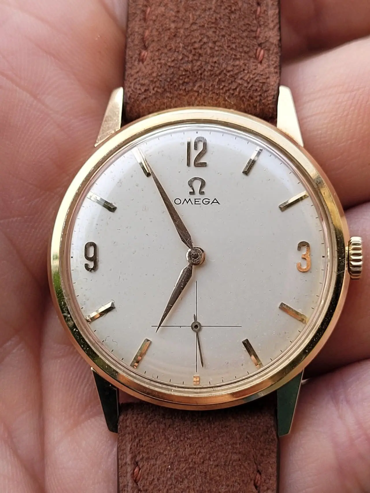

Is this Omega 14715-61 real

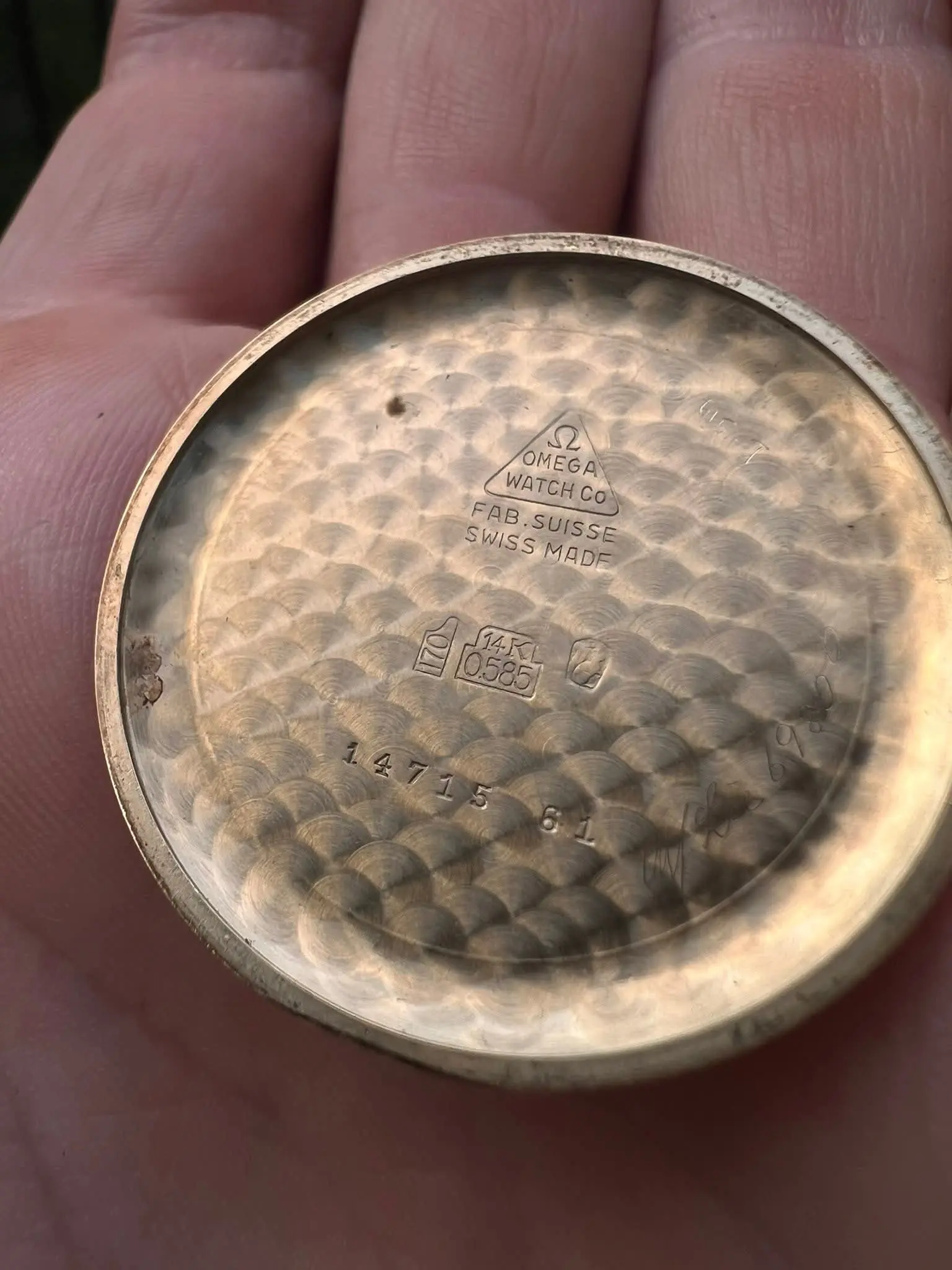

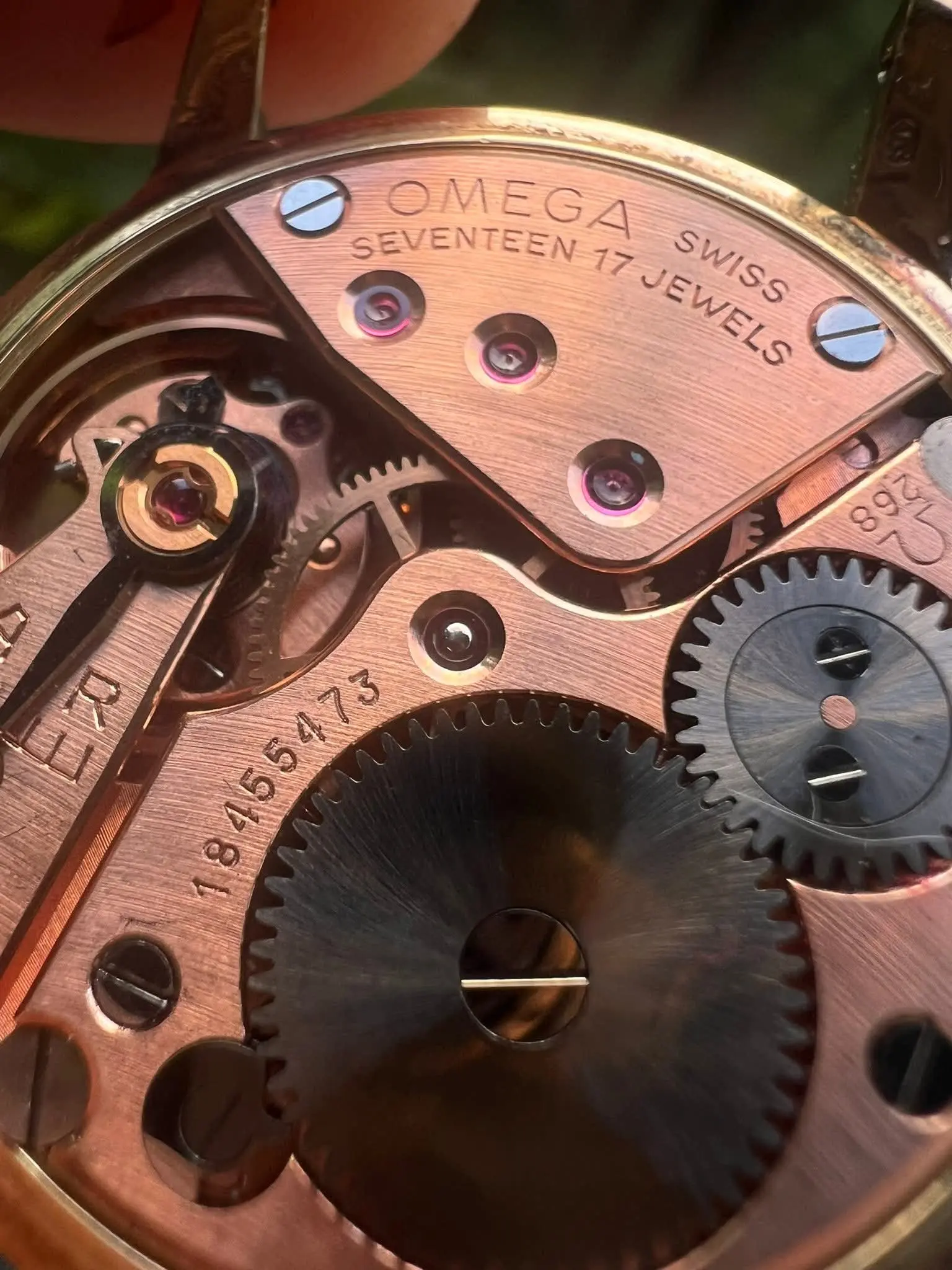

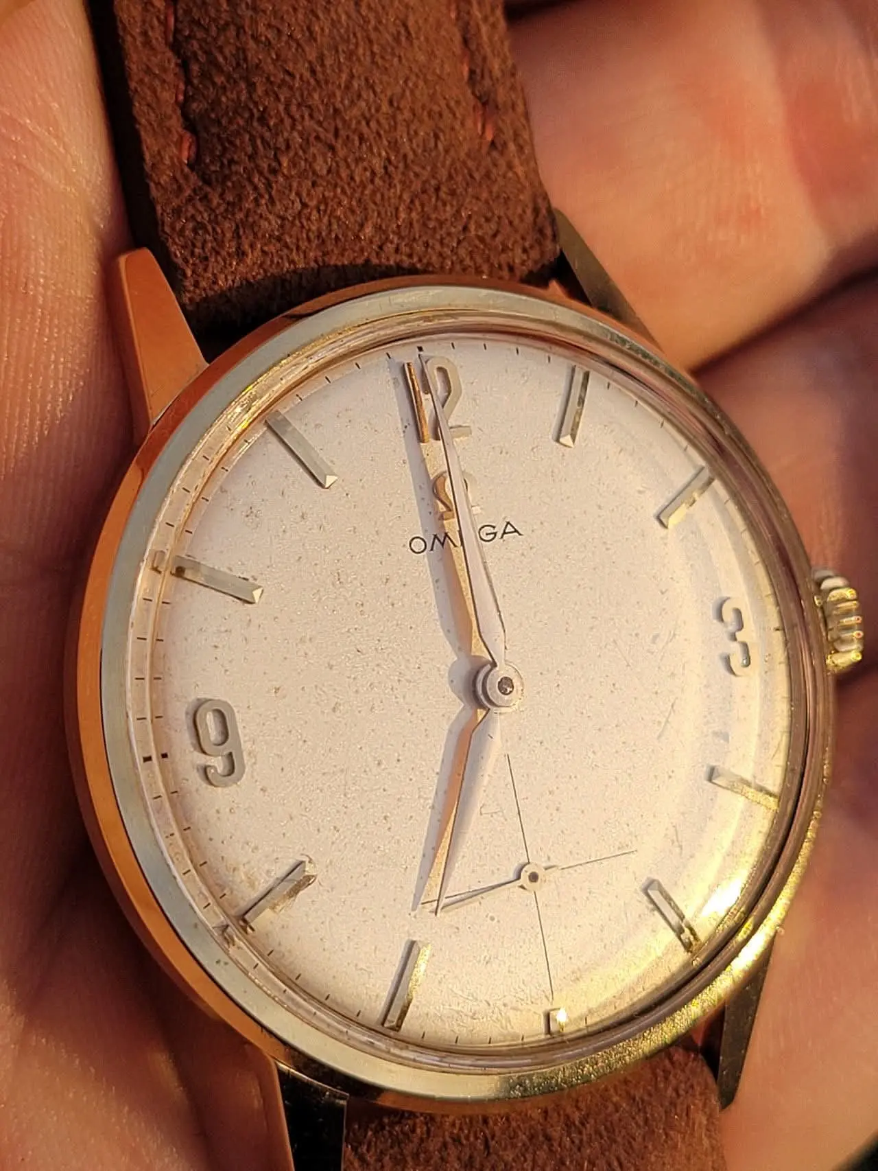

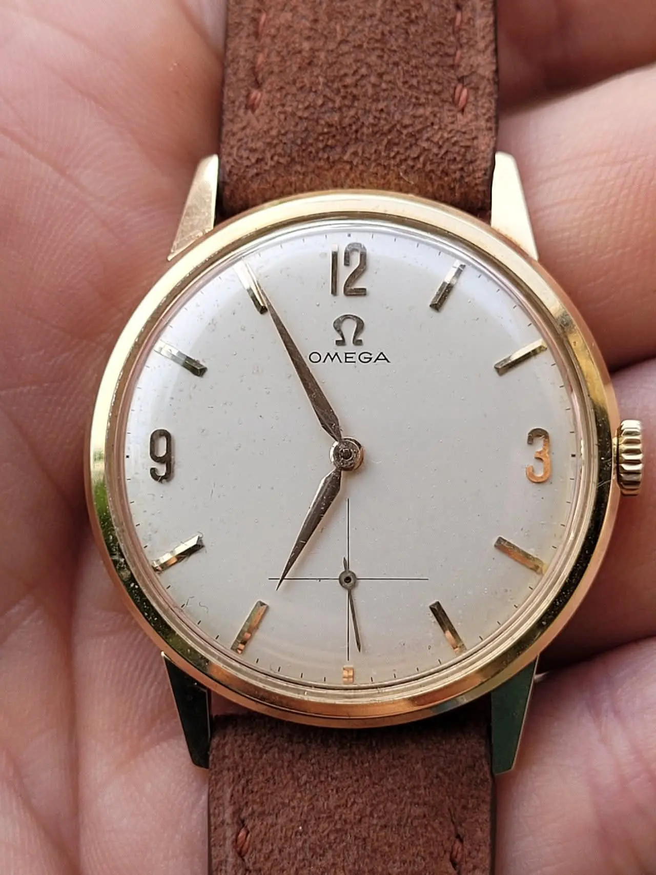

Hi, sorry I don't know much about watches, I want to buy it as a gift for someone who loves vintage Omega watches. Is the watch from pictures an authentic one? Also what would be a reasonable price for it?
Ref 14715-61 as stated in the listing
I would really appreciate the help and I hope I posted in the right section!
4,377
10,470

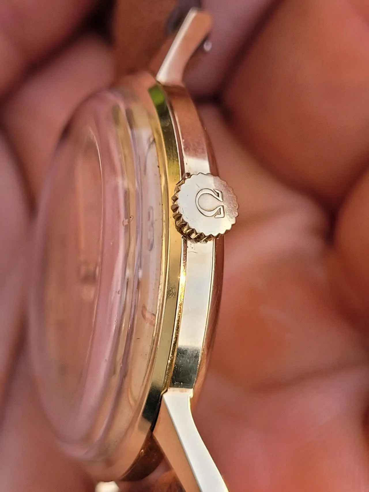

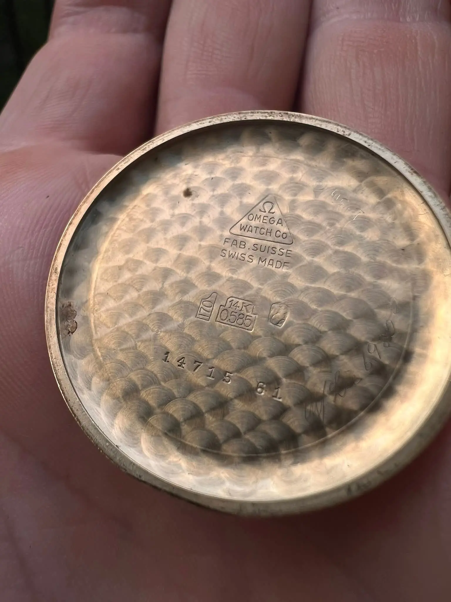

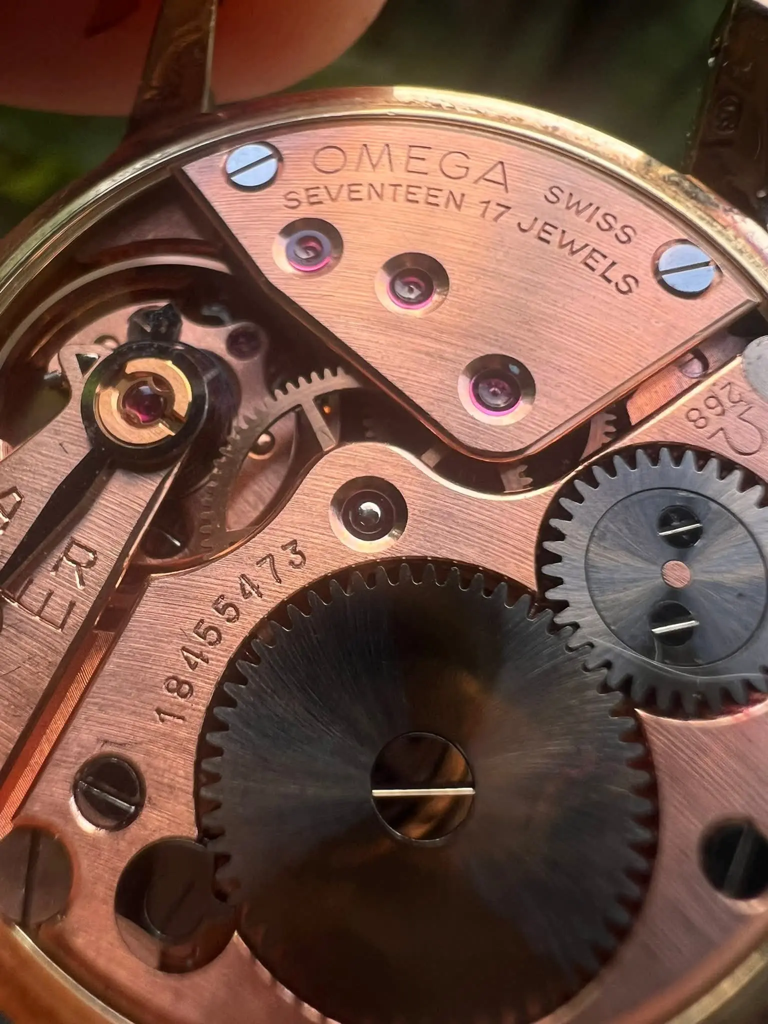

To start off, it's 14K gold. That will drive the price up. This is a standard manual wind Omega dress watch. Case looks pretty good. Can't speak to the engraving on back.
Not sure what the case weighs but gold value + $100 to $200 is probably what it would bring. Guess is $600 - $700 for the watch??
1,993
3,688

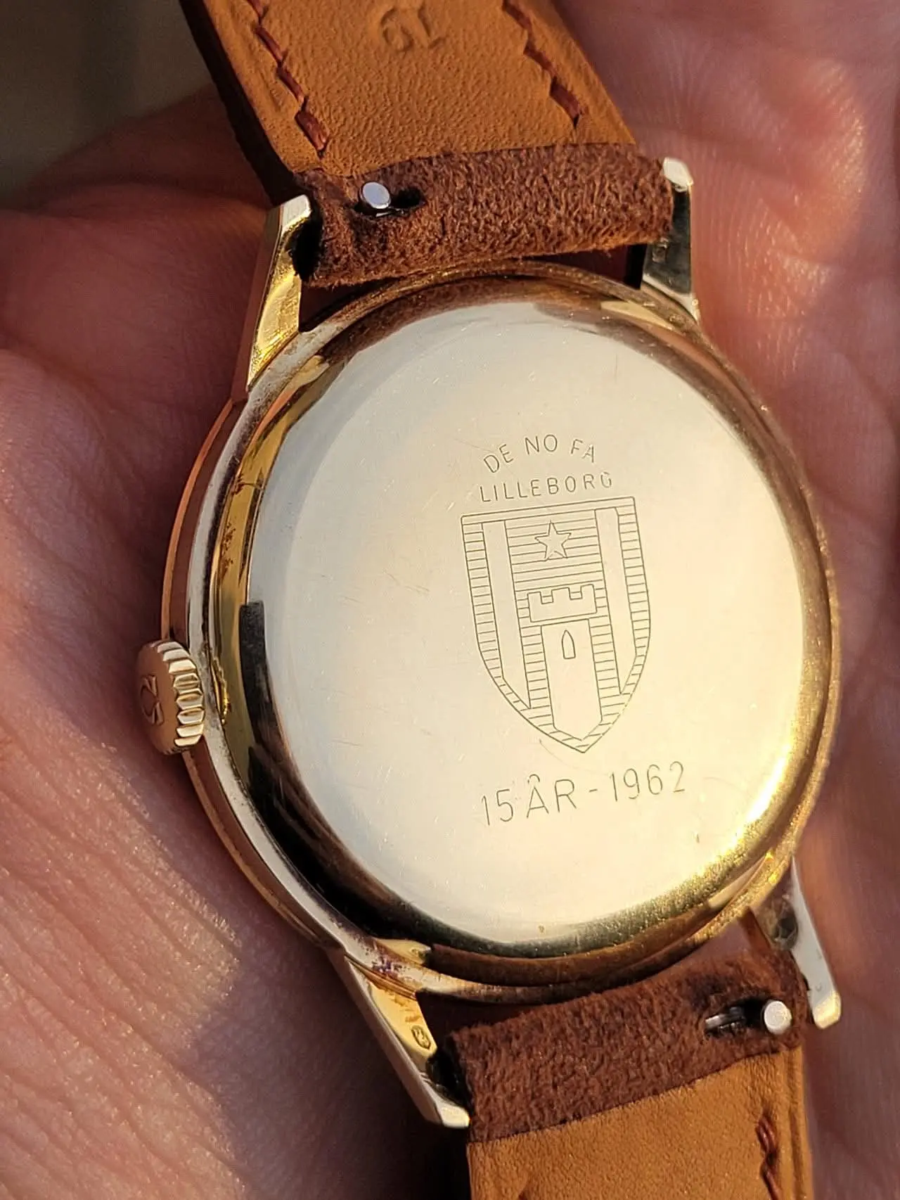

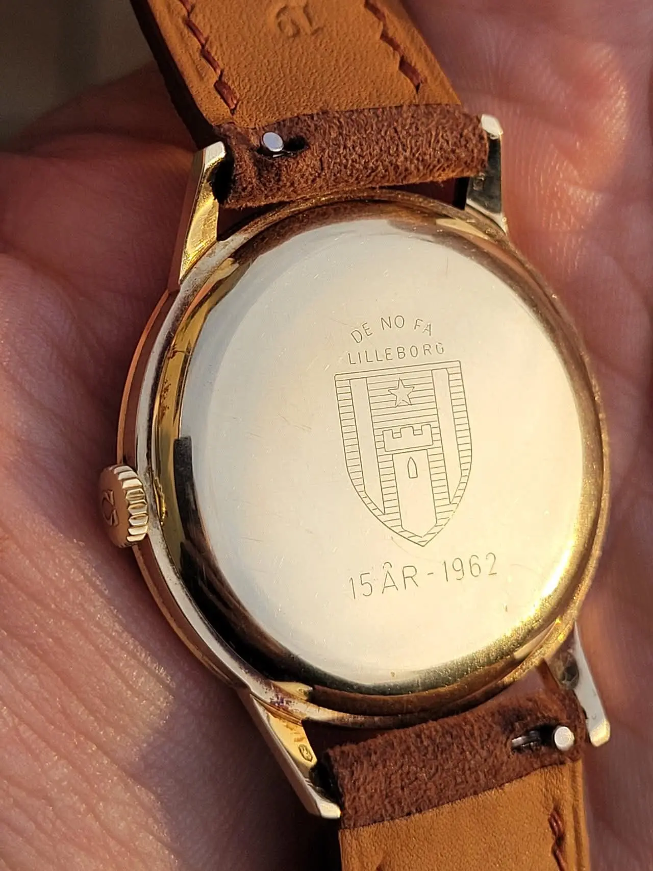

De No Fa Lilleborg seems to be a paint/coatings company based in Norway. Perhaps a retirement watch?
Yes, I think it is some sort of retirement watch. It is priced a little bit higher than what you suggested so I will try to negotiate the price slightly. Thank you!
