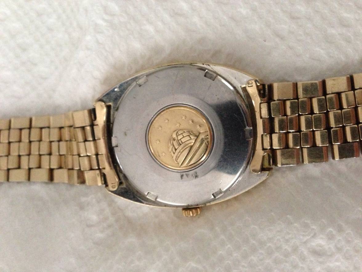

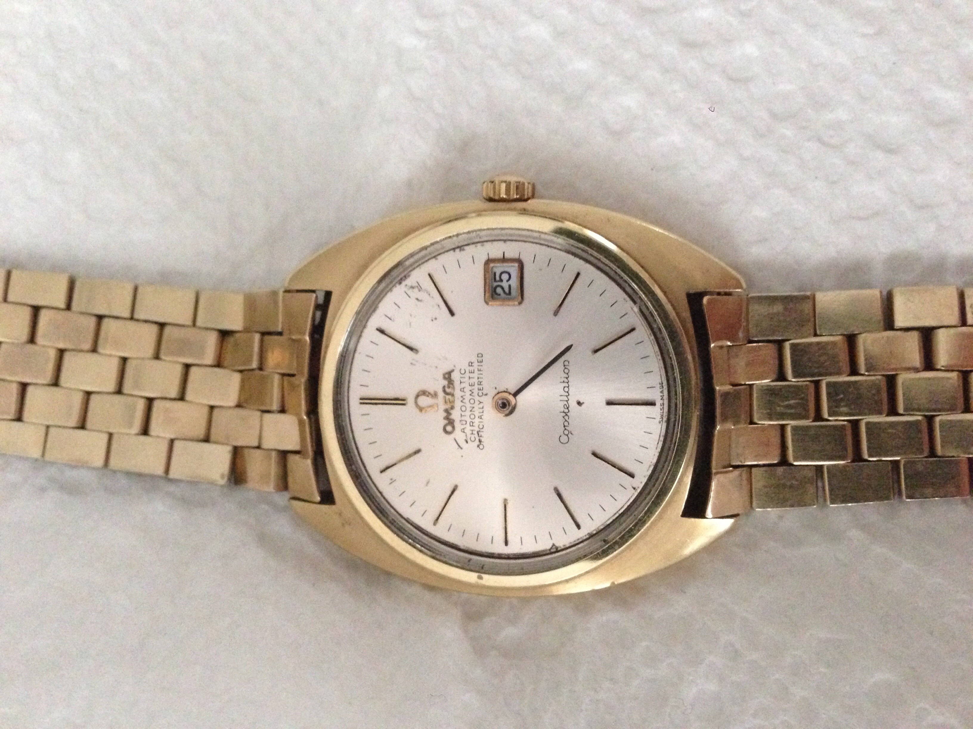

    I want an idea of the repair cost....
    I bought this in 1968 & would like to give it to my grandson... In 1975 it fell six stories and I never repaired it.
  6. X350 XJR Vintage Omega Aficionado Oct 29, 2013
    12,587
    29,837
    Figure $125-$150 for a basic service plus parts, which could add several hundred dollars depending on what may have been damaged in its fall.
    Its really difficult to get any more definitive from just a couple pictures.
    Does it run, can you set the hand?
  7. roadking95 Oct 29, 2013
    5
    Thank you,
    Hand moves, watch does not run.
    I'll send it to NJ for a quote.
  8. ulackfocus Oct 29, 2013
    25,983
    26,972
    Don't send it to Omega! :eek: Believe it or not, that's one of the LAST places to ship it for restoration work. They aren't careful about using correct parts and will put whatever fits on the watch (hands, crown, etc). Try one of the watchmakers who are members here - they're MUCH more sympathetic to vintage and will restore what they can and replace only what's necessary with the right parts.

    Is the rotor not dislodged ?
  10. roadking95 Oct 29, 2013
    5
    Not sure about rotor.
