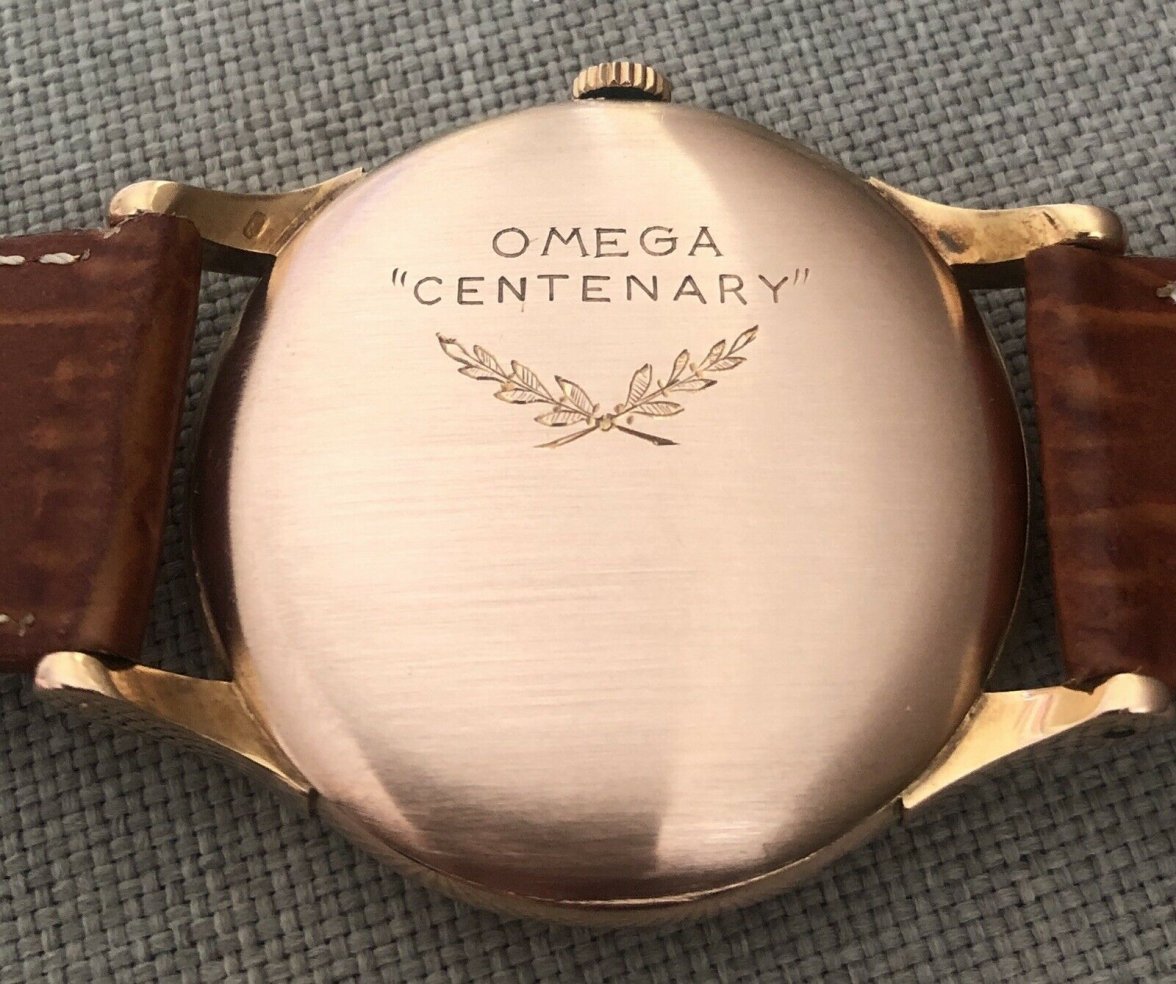

Is this Centenary engraving legit?

Its not cheap obviously at where they've priced it but looking at this caseback engraving the last two of these I've owned were both so very faintly engraved that you could barely see anything left of it, yet this one is so clear and different from other examples I've seen, are people re-engraving these now or are there just a lot of variants?

Re engraved in my opinion. Case back is freshly brushed to get rid of the engraving residue. Pantograph engraving. Well done, Btw.... Kind regards. Achim

The quotes are wrong for a French canton. I vote fantasy.
The real engraving definitely does have the quotes, its not fantasy just a matter of original or not and based on Achim’s reply I think he’s on the money.
No. You don’t understand. French quotes are << and >>.
That’s inaccurate. We also have the quotes on the engraving in French.

Serial number and case number are correct for a 30.10 JUB.
I am quite sure that the engraving is not original.
Thanks for the education. 😀
