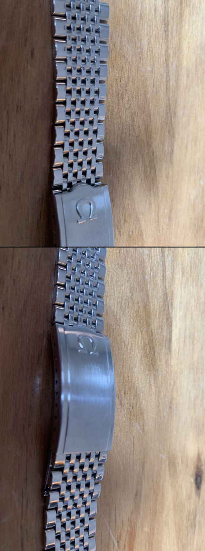

Hi!

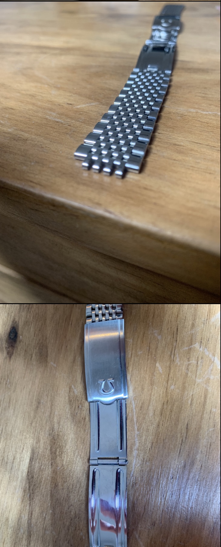

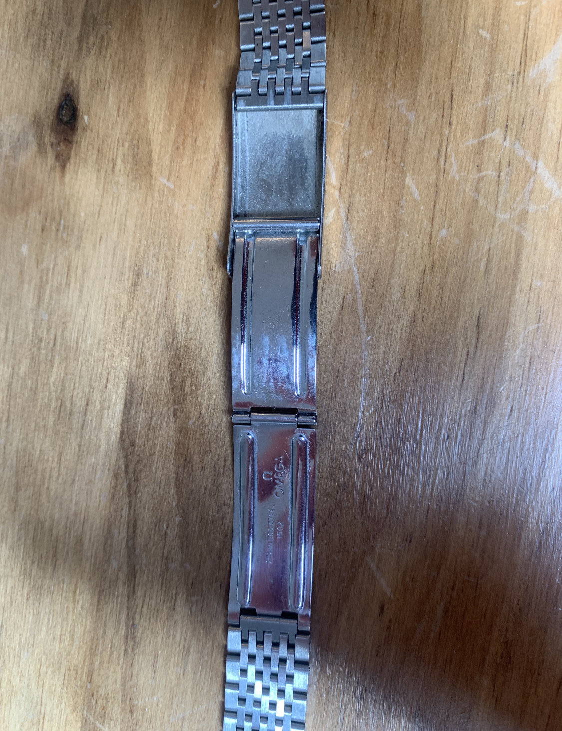

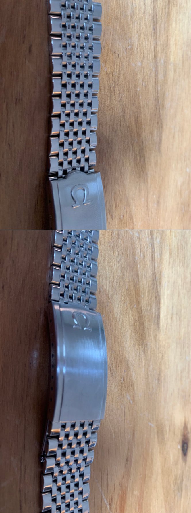

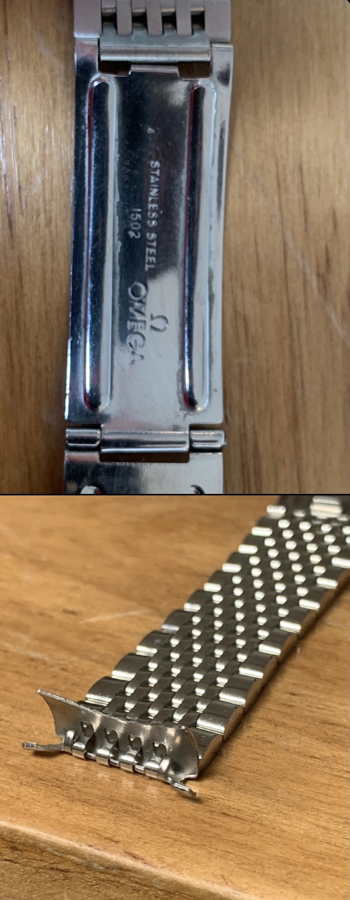

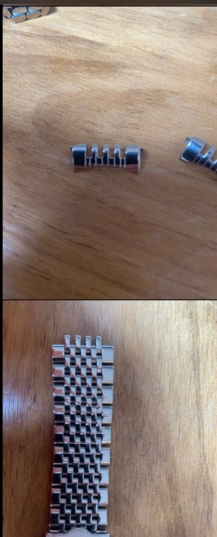

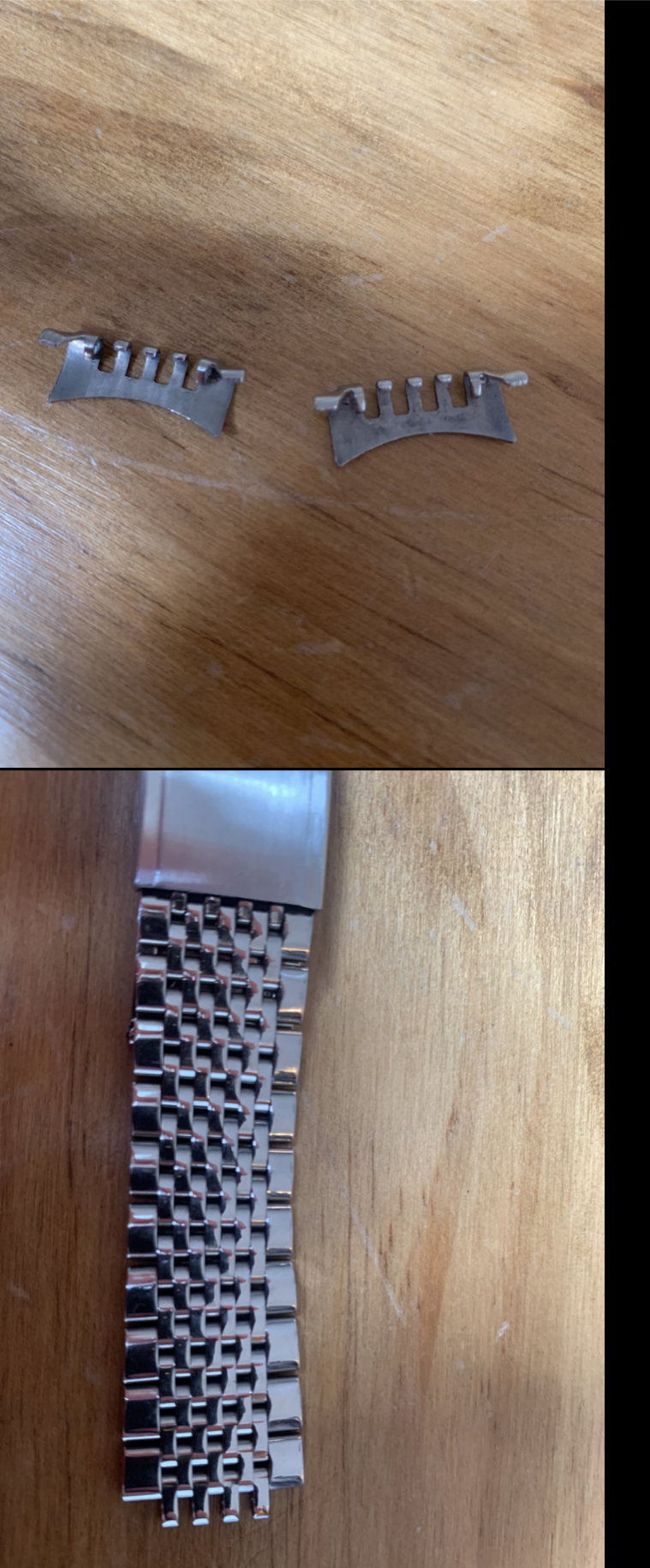

I was offered this BoR bracelet for sale but don’t know what to think of it. It’s apparently a 1502 with unmarked EL. Is it good? When is it from?
Would it fit a seamaster 30?
Thanks!
3,595
13,551
That’s a cheap repro I’m afraid. 1502s have two rows less (and the original end links aren’t half as flimsy). Avoid.
792
845

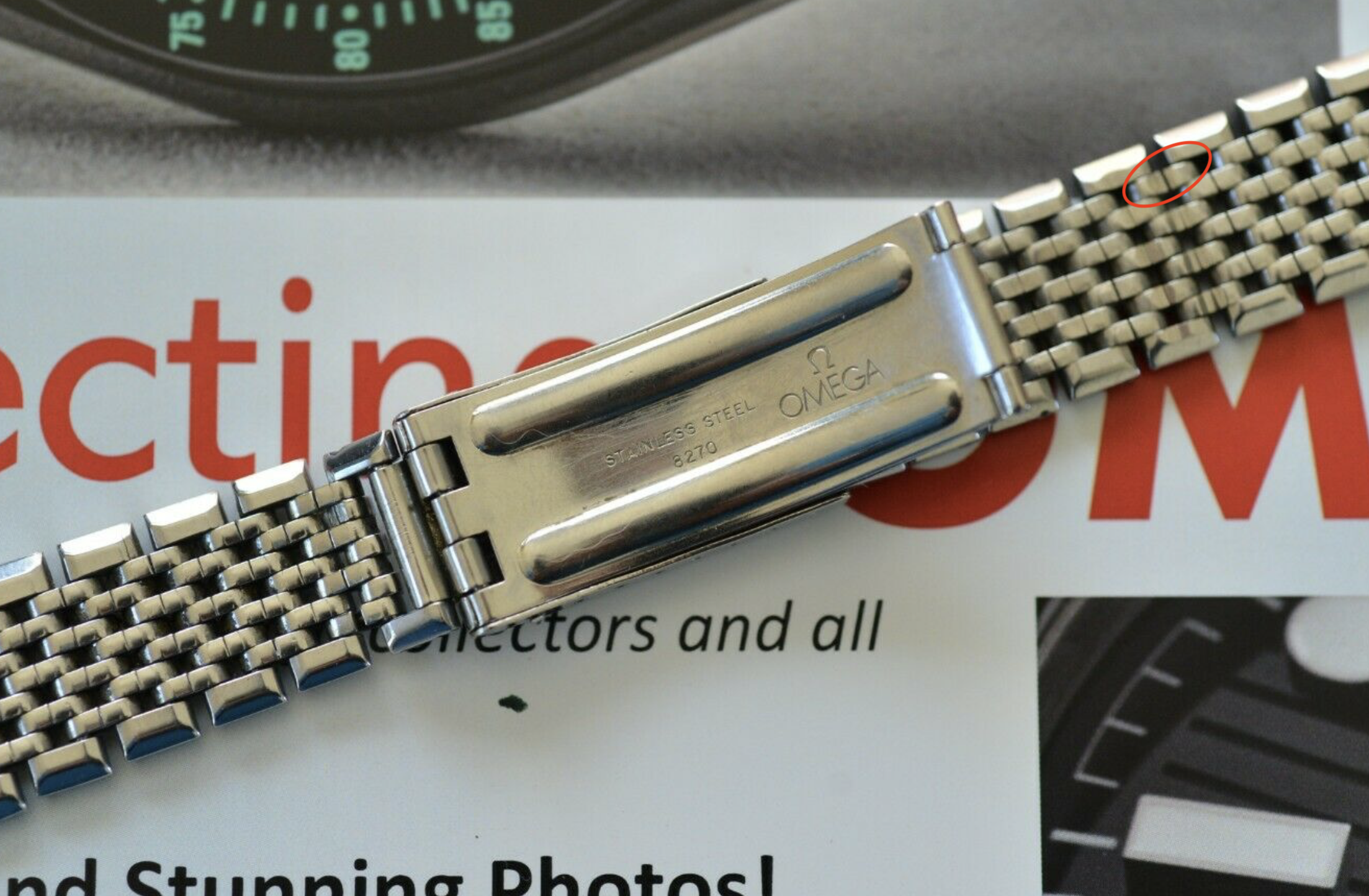

@MtV is totally right. I do want to add, that these vintage bracelets usually have folded center links. Machined center links are a red flag. I bought one of these BOR bracelets and found them to be junk and barely worth the $20-30 that you usually find them for from China.
(Source
- not my photo)
