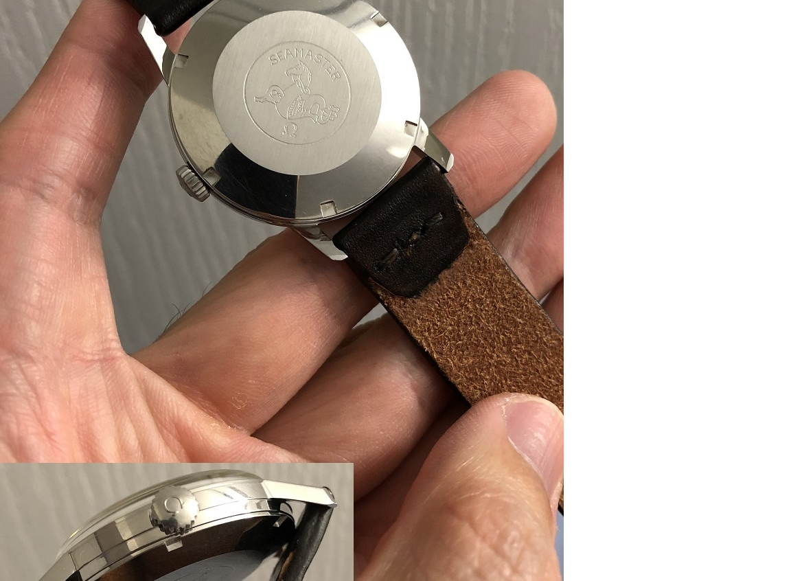

    I wont say what they want for it but I want to make sure that there are no questions about the quality? I really appreciate the advice.

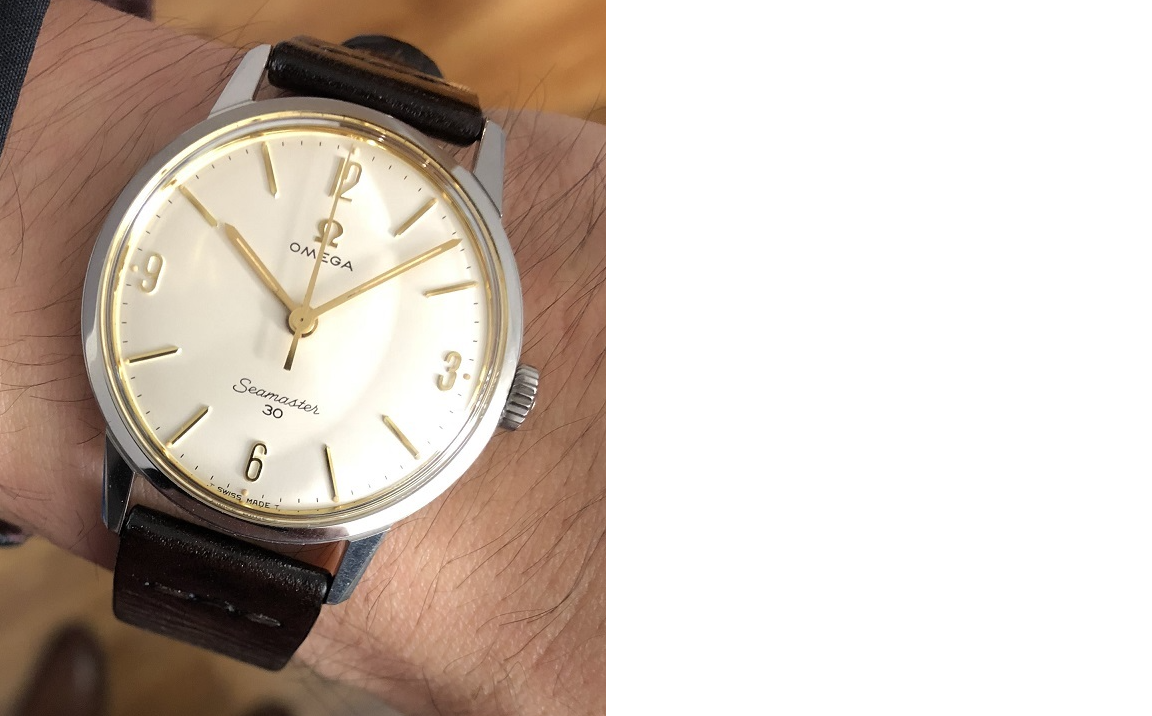

    The quality is there. The lugs are a bit soft/worn, but you have to expect that on a watch of that age if it's been used.
    See if you can get other shots of the dial. There's a mark outside the 9, it may just be a reflection/refraction caused by the crystal but better to be sure.

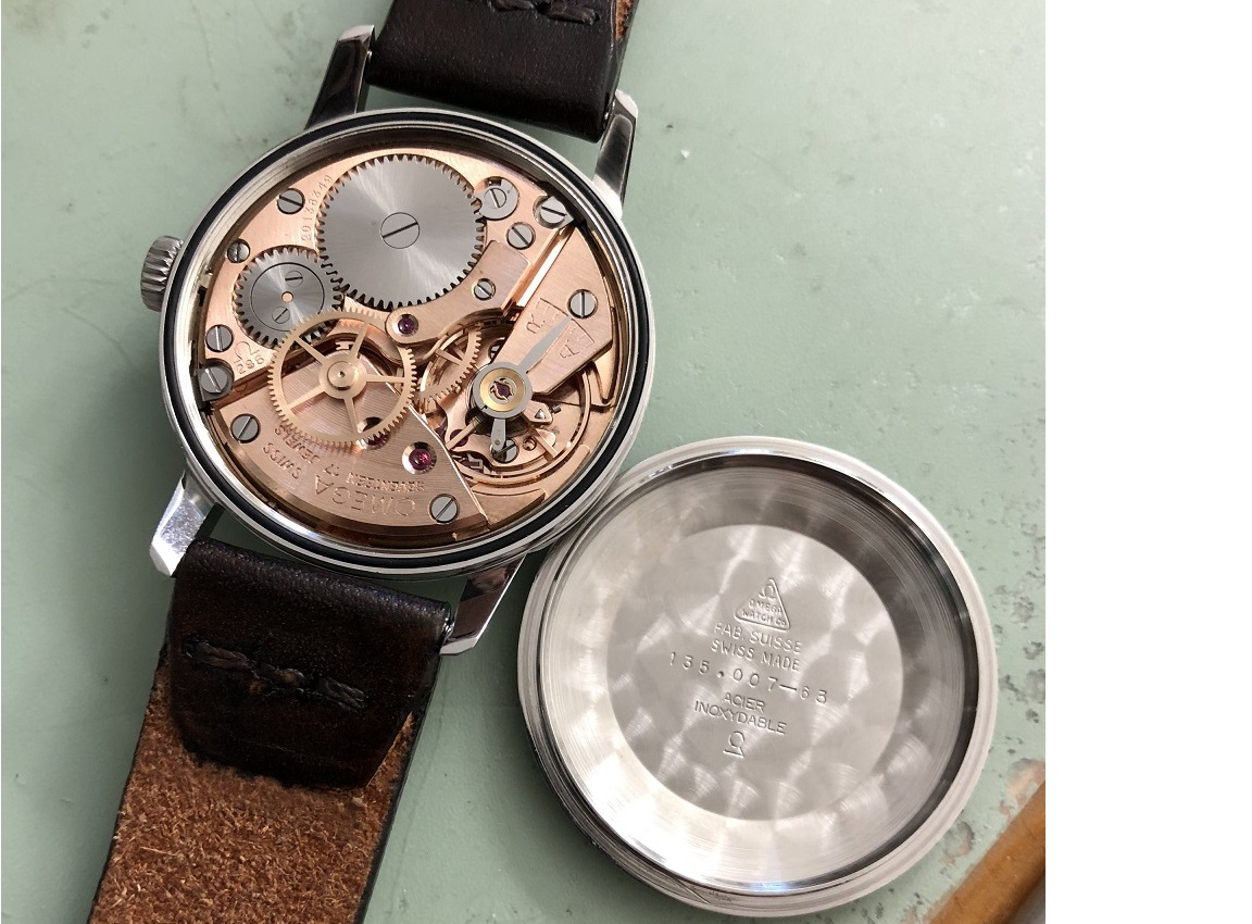

    Movement looks to be in good condition with very little damage to screws etc.

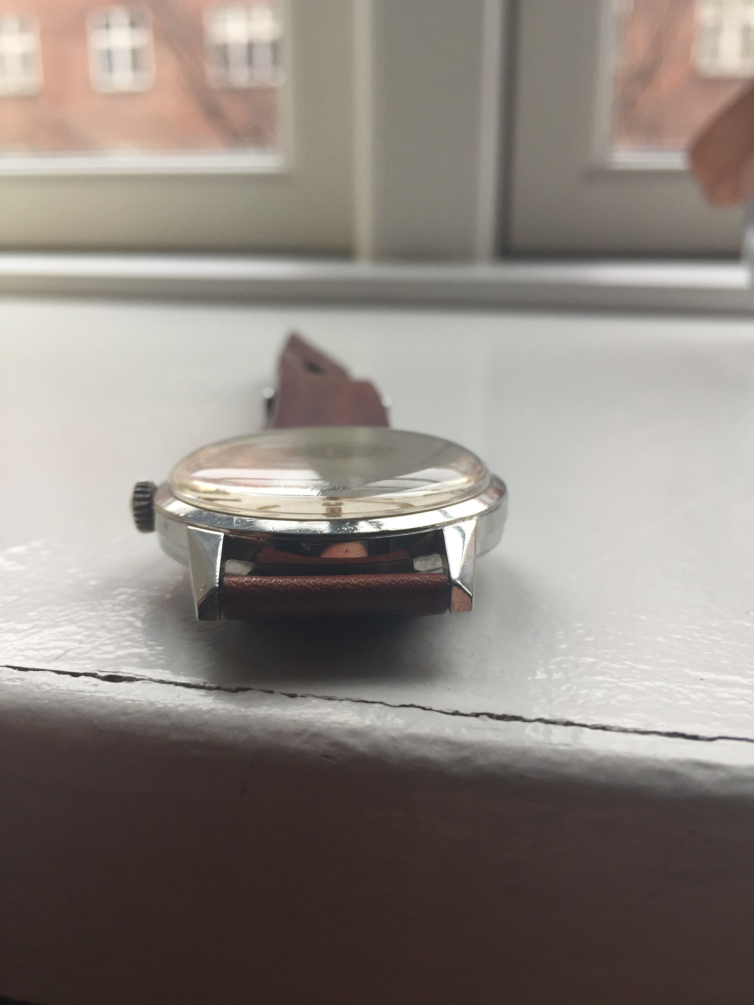

    Is it my eyes, or the angle of the pics, the lugs look to be different widths?

    However, I think it’s an outstanding example. The typical culprits I usually find as issues don’t exist. The lume looks original (and matches the hands), case back hasn’t been scratched up (has some nice brushing) crown looks good, dial looks stellar (I don’t see damage at 9).
    Two tone watches always get me thinking a bit about whether the dial (gold indices) goes with the stainless steel case). But even if it doesn’t, it’s a nice looking piece.
    You should also be prepared to answer a few basic questions. Why don’t you have a profile picture? What did you find by googling the reference on the case? What research have you done thus far that has prompted the need for help? What concerns do you have?

    Agree that the lugs look a bit worn. Otherwise seems like a nice piece. The lugs ideally should look something like this. This has also been polished but only slightly.

    Looks like a redial to me.

    Looks like a redial to me but what do I know and pictures are not that good. Otherwise, watch seems perfectly good for the purpose you declare a couple of posts above.

    Dial looks fine to me. Lugs are somewhat polished.

    Definitely not a redial and overall a nice example.
