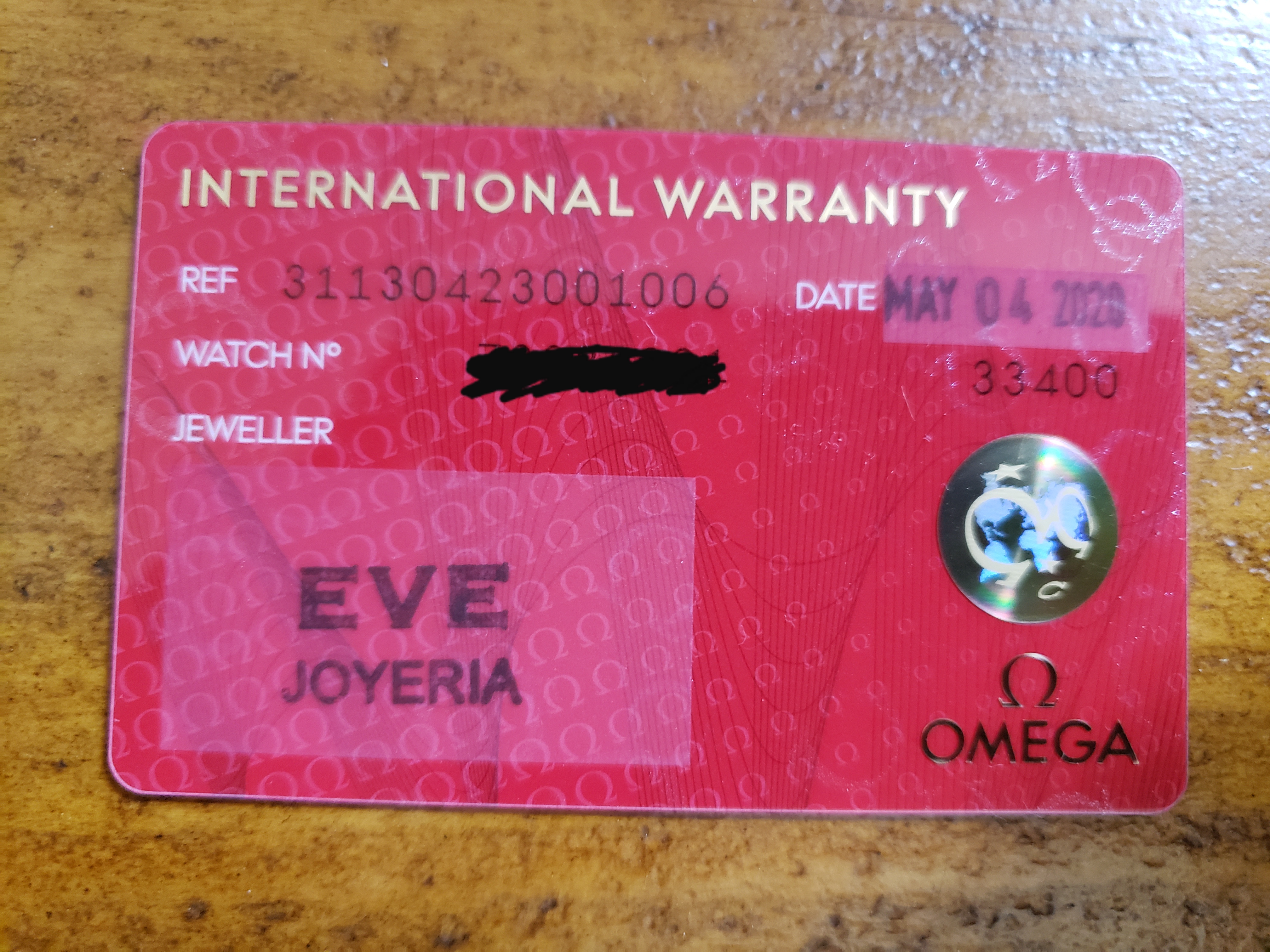

Is this an Authentic Warranty Card?
10
6
Look at the spelling of JEWELLER.
Is there some database where I can look up the serial #?
This watch came with everything, including the presentation box with all the goodies and pictograms (I have no idea what this is).
What can I look for on the watch?
I looked up the JEWELLER and this shop is a legit AD located in Argentina per Omega.com. But why the heck did my watch come all the way from Argentina?
FYI - I bought from watchshopping.com

Looks legit
‘Jeweller’ is the correct spelling in the British English language, which is how Omega spells it. ‘Jeweler’ is correct for American English. Both are correct
There could be any number of reasons why your watch comes from Argentina - most likely someone bought it during a holiday stay (vacation)

Just noticed the date on your warranty card. Your watch was most likely sourced by your online vendor. This is fairly common practice for arbitrary dealers who offer a better price.

The spelling doesn't necessarily indicate anything fishy, as mentioned. And looking at that website, the watches shown there look authentic, though of course that doesn't mean anything if they don't actually sell the watches that are pictured on their site.
People in Argentina buy luxury watches too! 😀

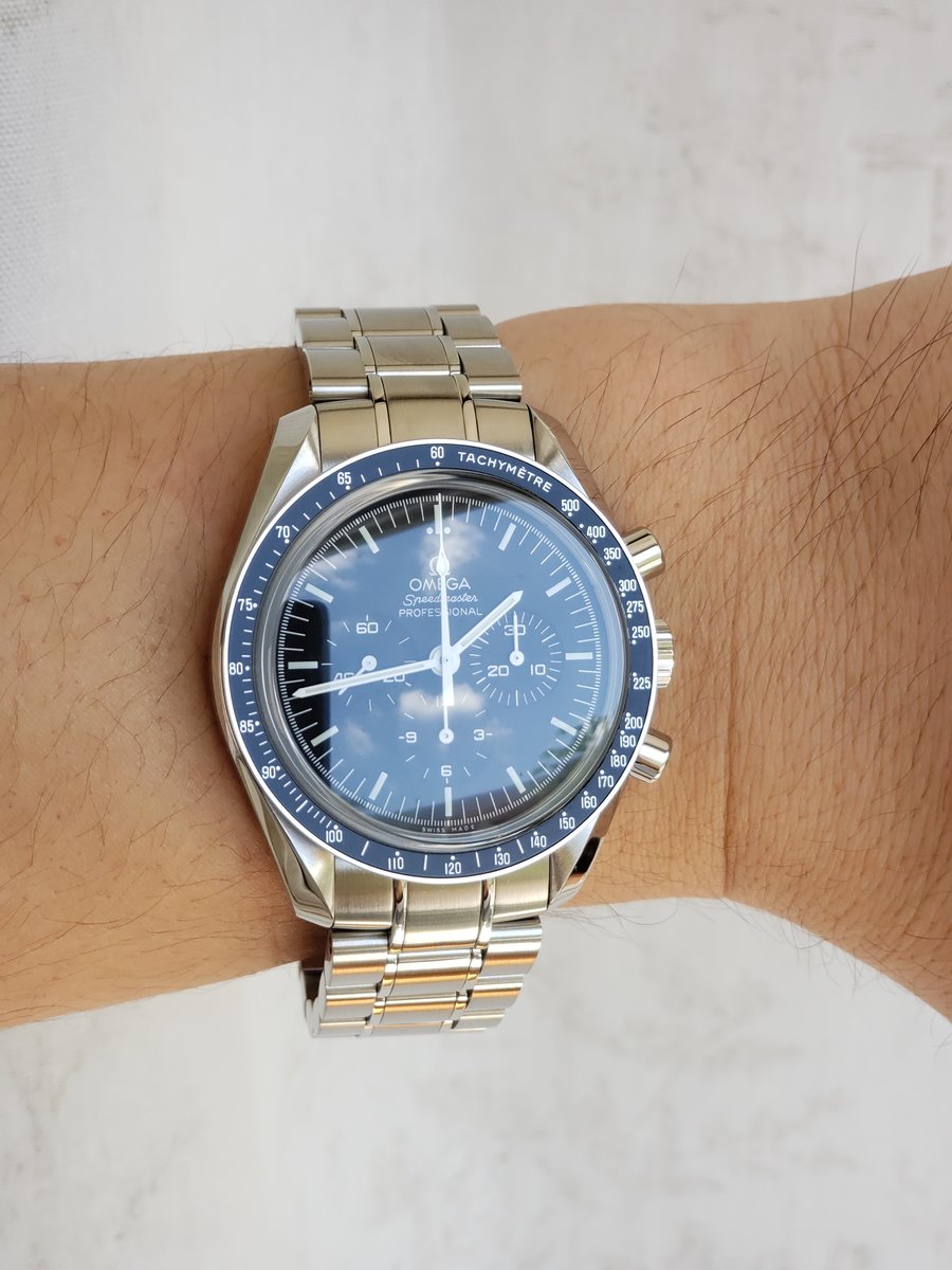

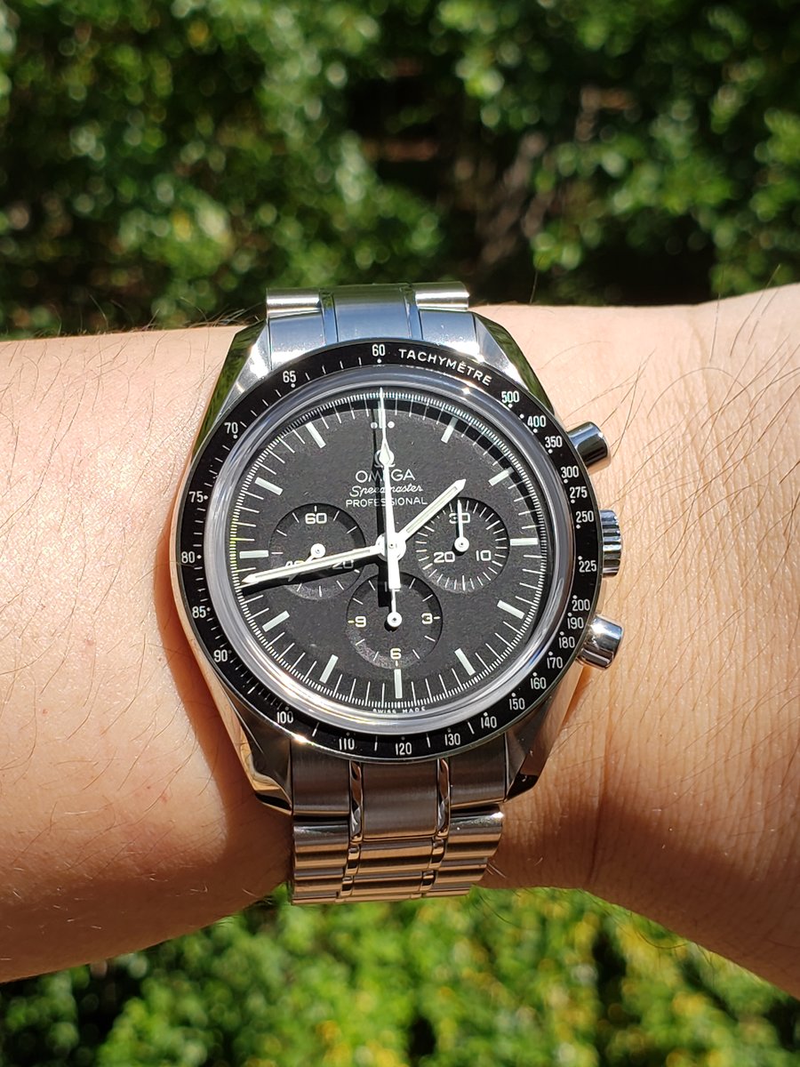

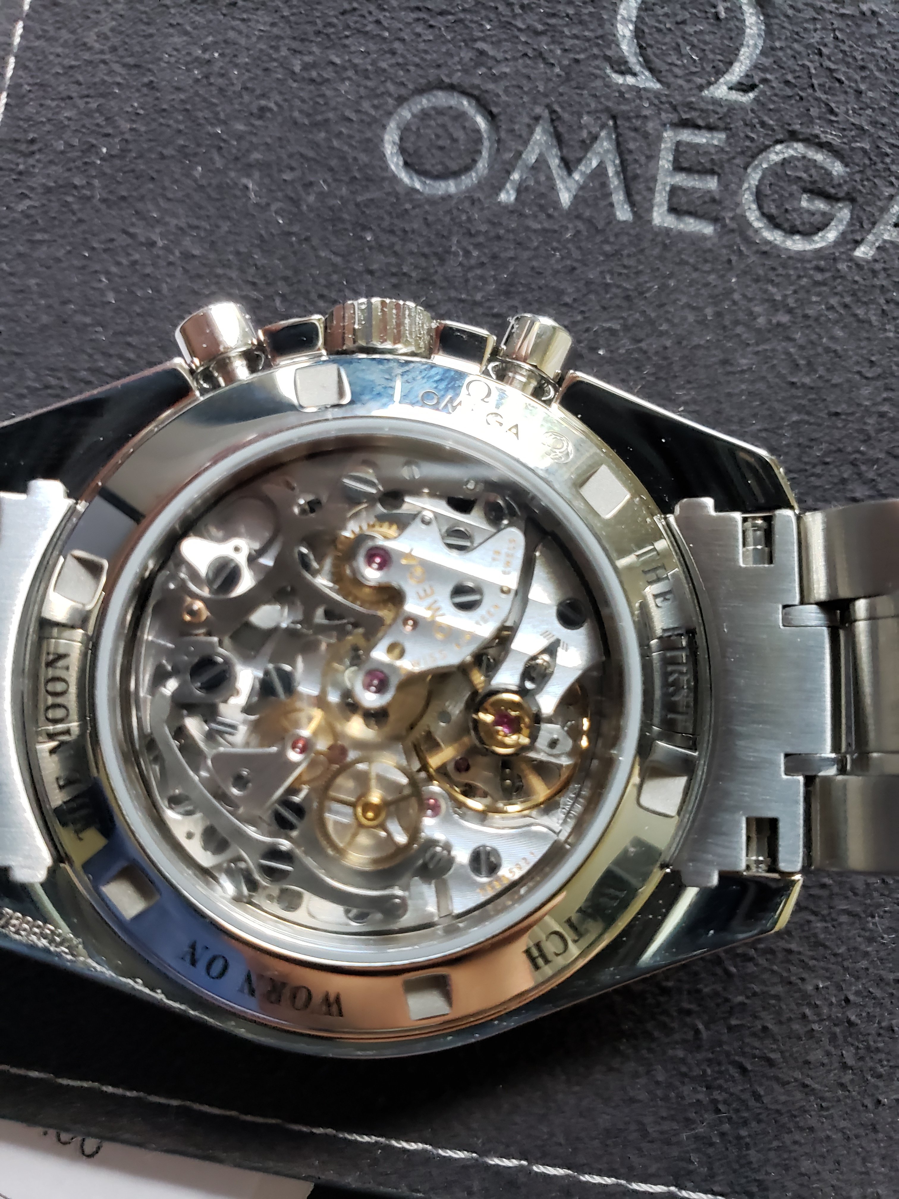

That said, if you're concerned, post some good (well focused close-up) shots of the watch. What kind of Omega is it?--from the card, presumably a Moonwatch? The serial number will be on there somewhere. If it's a newer piece, probably laser-etched in tiny writing somewhere on the case, like the backside of the lugs. It should match the number you've blacked out on the card, and if it's a watch with a seee-thru caseback (as I'm guessing it is), you might be able to find the same number again (also tiny) somewhere on the movement. If all the numbers match up, that's a good sign.
Is it a Master Chronometer? If so, you might be able to pull more info from Omega's website. But I don't think this one is...
Post pictures---folks here are pretty good at spotting fakes. And if you're really in doubt, take it to your nearest Omega Dealer/Boutique (if they're currently open) and have someone there have a look at it.

Thank you all for responding. I am quite concerned about this purchase. I have the serial # beginning in 7888xxxx. Where can I find out when this watch was manufactured? I am getting year 2000 from some website to 2006 from another website. Ugh;;;;
This is a Speedmaster moonwatch 006 with the sapphire crystal.

Can you provide more close-up photos, including photos of the back? Does the serial # on the watch itself match the # on the card?

I'm guessing, if you turn the watch over, you'll see the serial on the lower right lug. If your watch doesn't have the clear caseback, maybe don't try opening it up to look at the movement...

Both the # on the card and the # on the back matches. I'll start with Omega's chat and report back. I would be very troubled if the watch was manufactured like 10 years ago but sold as new.

Good luck! After the chat, I'd suggest you start a new thread with a new subject line (like "is this watch authentic?") and post some additional pics, front and back. It looks good to me, but I don't claim to have the required expertise in authenticating this watch.

So I just got off the phone with Omega and provided them with the model # for this moonwatch and they said they didn't start manufacturing until 2016. They don't have the serial # in their database as they don't keep it. I guess I freaked out when I saw that my watch could have been manufactured in 2000 based on some website while another said 2006, both websites are some no name websites. So the only thing Omega can do is to provide a certificate of authenticity but do not have anything on when it was made. I don't know why this kind of info is so hard for them to provide.

You should have no worries - with a valid warranty card (which you have) the watch will be guaranteed by Omega for 5 years from the date of sale, regardless of the date of production.
