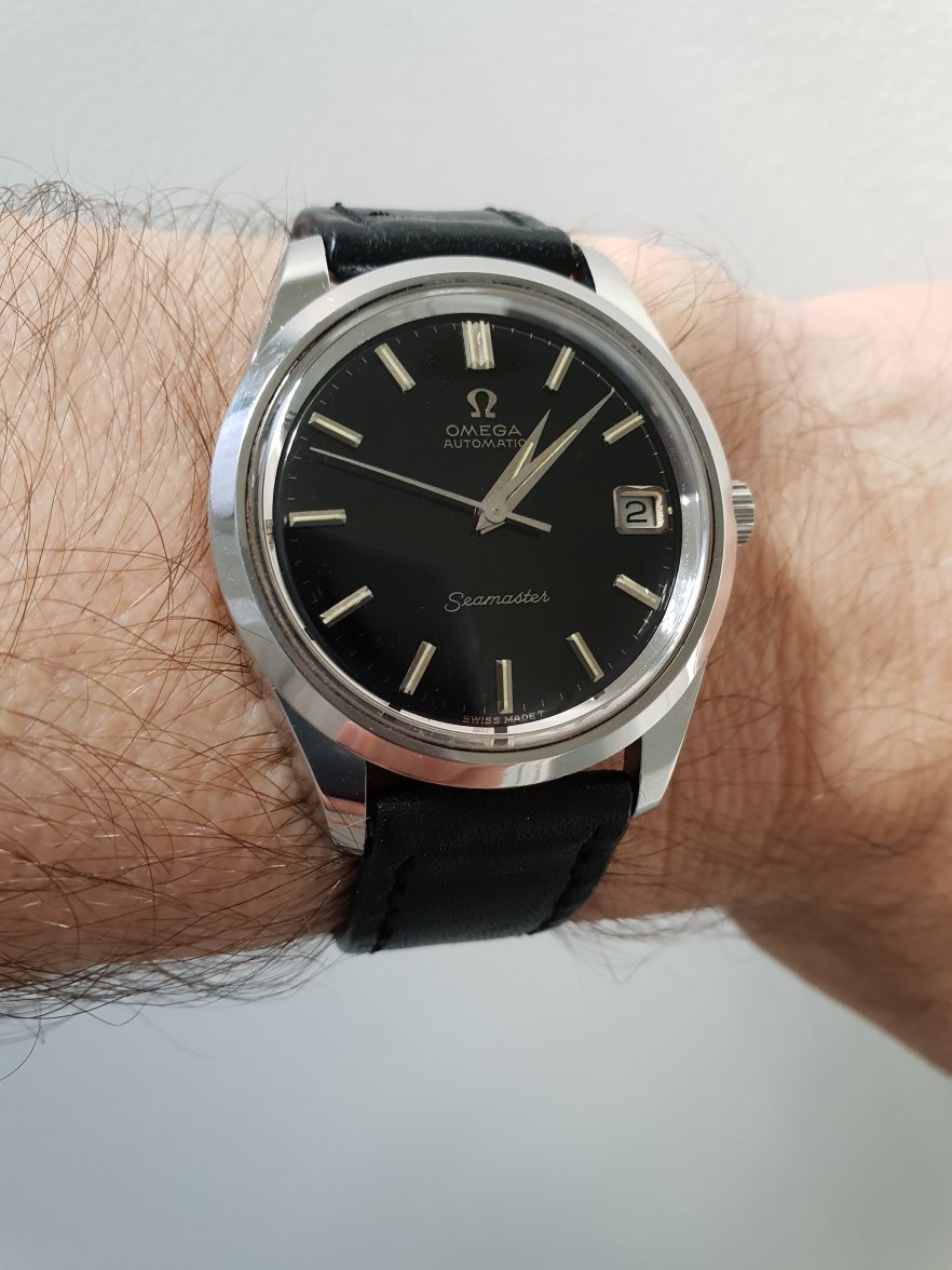

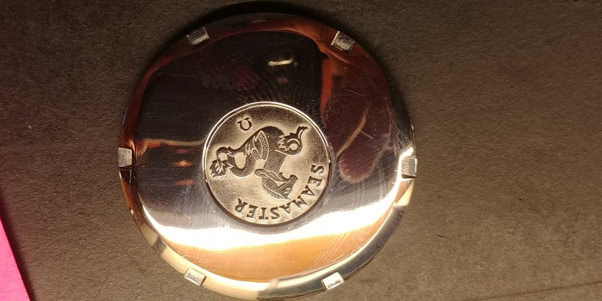

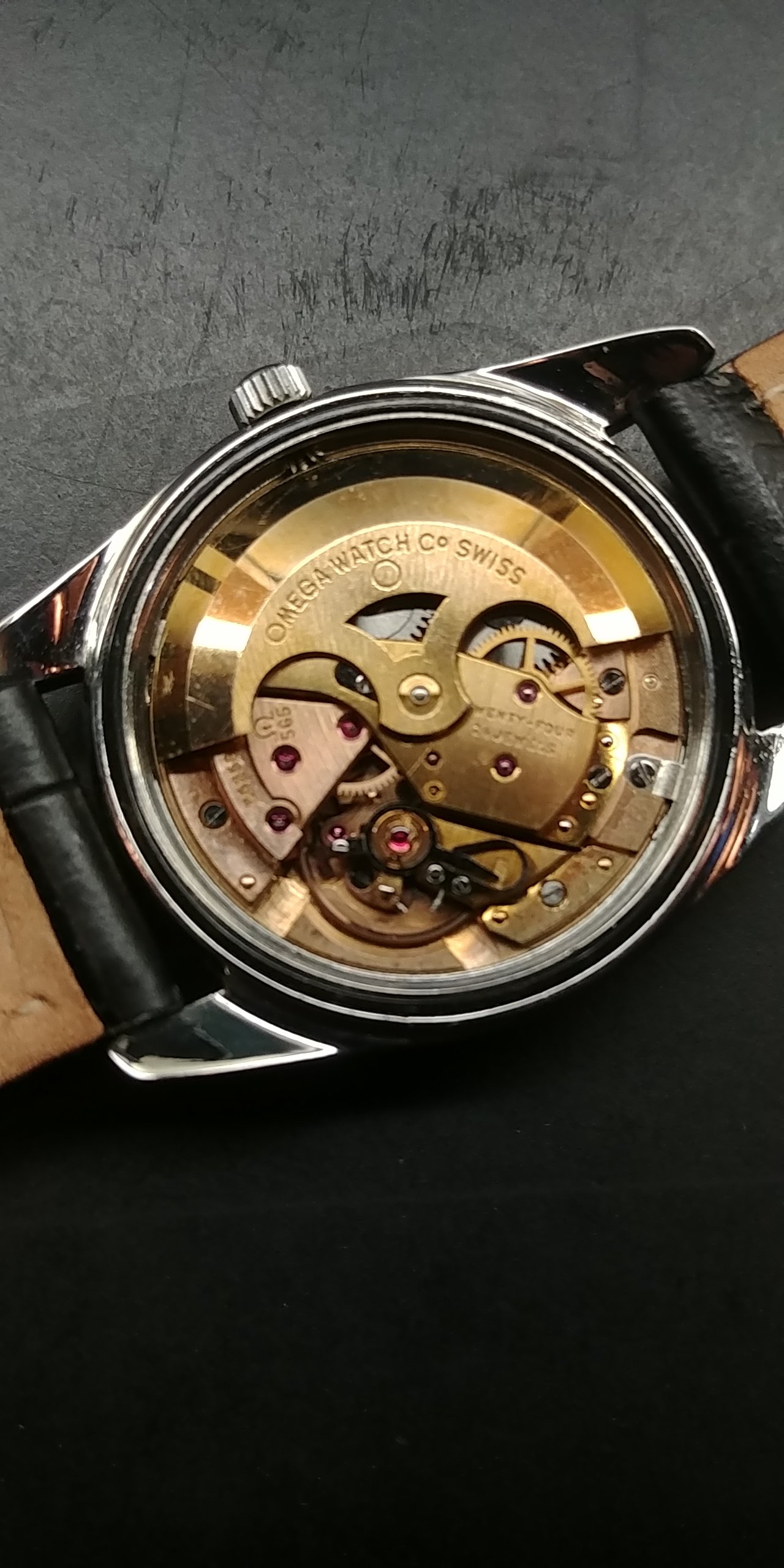

    I recently purchased this watch and was curious if it is an authentic omega? The case is a highly polished steel finish and the steel hands and accents against the black face are truly stunning.. Thanks in advance. .
    20190601_085818.jpg 20190601_085808.jpg 20190601_085755.jpg 20190515_194133.jpg 20190515_194037.jpg 20190515_194055.jpg 20190515_194149.jpg 20190515_193341.jpg
  2. X350 XJR Vintage Omega Aficionado Jun 1, 2019
    12,619
    29,918
    Genuine yes, original no, refinished dial and case, probably some replaced parts in the movement and it needs a service or has issues.
  3. JwRosenthal Jun 1, 2019
    14,932
    40,297
    It is pretty. If you bought it under the terms of it being completely original and paid a premium for it, then you need to contact the seller and request a refund. If you got it for a good price and are happy with it, then enjoy.

    I’ve never seen (or maybe never noticed) the #1, or any other number, inside the omega symbol in the movement.
  6. padders Oooo subtitles! Jun 3, 2019
    8,993
    13,941
    Its pretty commonly seen and believe an indicator of the hand height for that given installation ie do the hands need to clear dial furniture or not.

  7. ihassan Jun 3, 2019
    9
    5
    I paid about $700 for it. I assumed dial was refinished and didn't care to much about that. I just wanted to confirm that it was not a fake replica. Thanks for confirming this.
    I assume it's from the middle 60's, is that correct? Also, I'm leaning towards getting a beads of rice band. Would that be appropriate for this style watch?
    Its interesting how the date moves by pulling the crown out to the furthest position. The watch keeps excellent time and is truly stunning. The pics I uploaded don't do it justice (bad lighting).
    I truly appreciate your advise and comments and everyone's elses on this forum.

    I am with the previous replies- it is a genuine Omega, but has a refinished dial. The case refinishing is something that is the preference of the current owner- to "polish" or more accurately Refinish the case is something collectors frown on, but owners truly enjoy.
    Nice watch- make sure you keep it serviced regularly (every 5 years). Omega has recently begun limiting the supply of reversing wheels for these models (550-565 caliber family of automatics), but they actually restarted parts production for them 10-15 years ago due to demand.

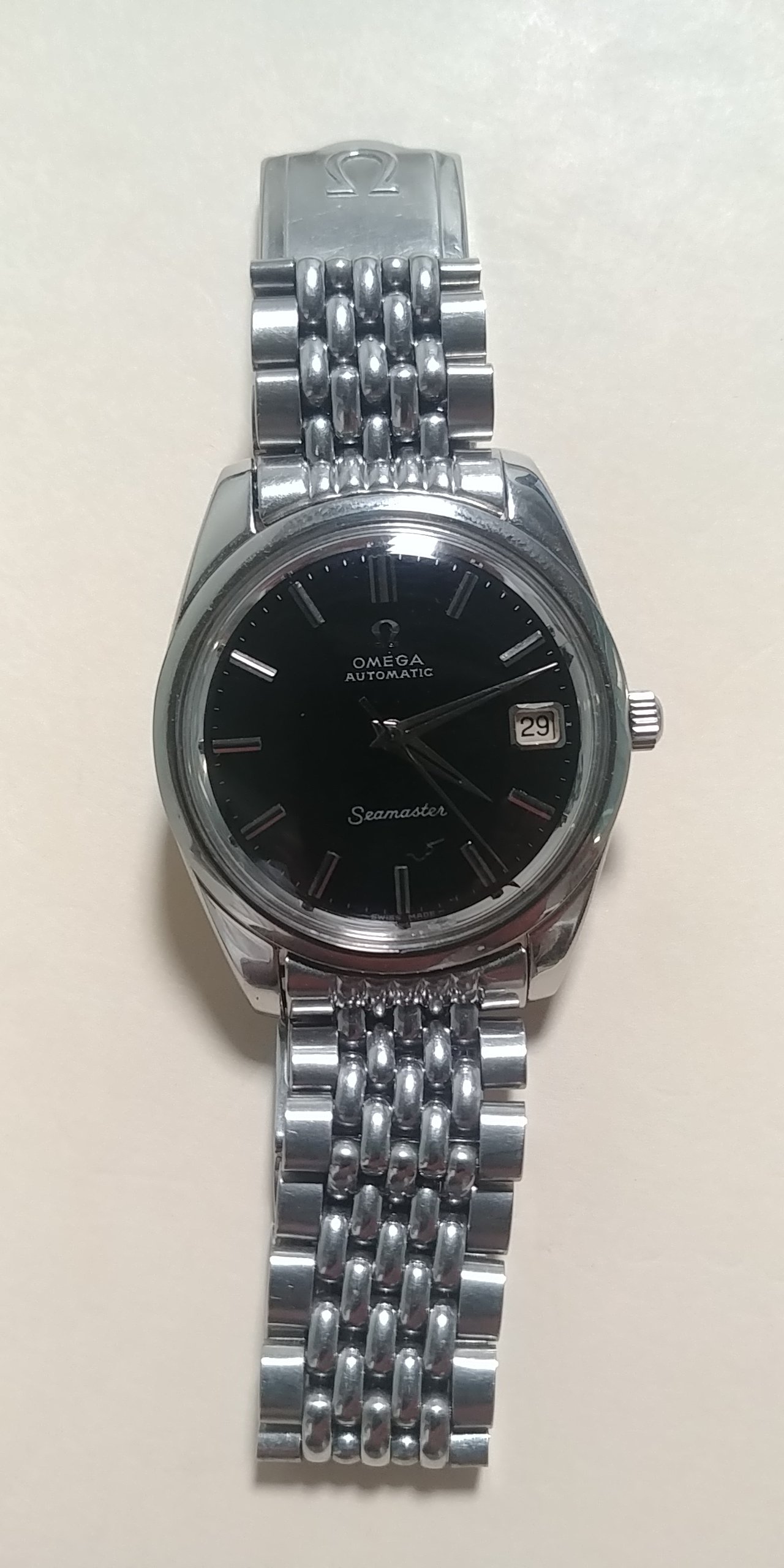

    Thanks everyone for all of your advice. The people on this form are absolutely amazing. I've attached a picture of the watch. It has been serviced and I was able to find a beads of rice bracelet from a fellow Forum member. It fits perfect just as expected.
