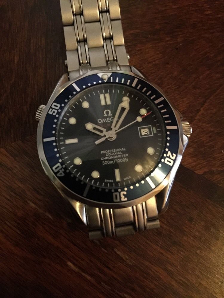

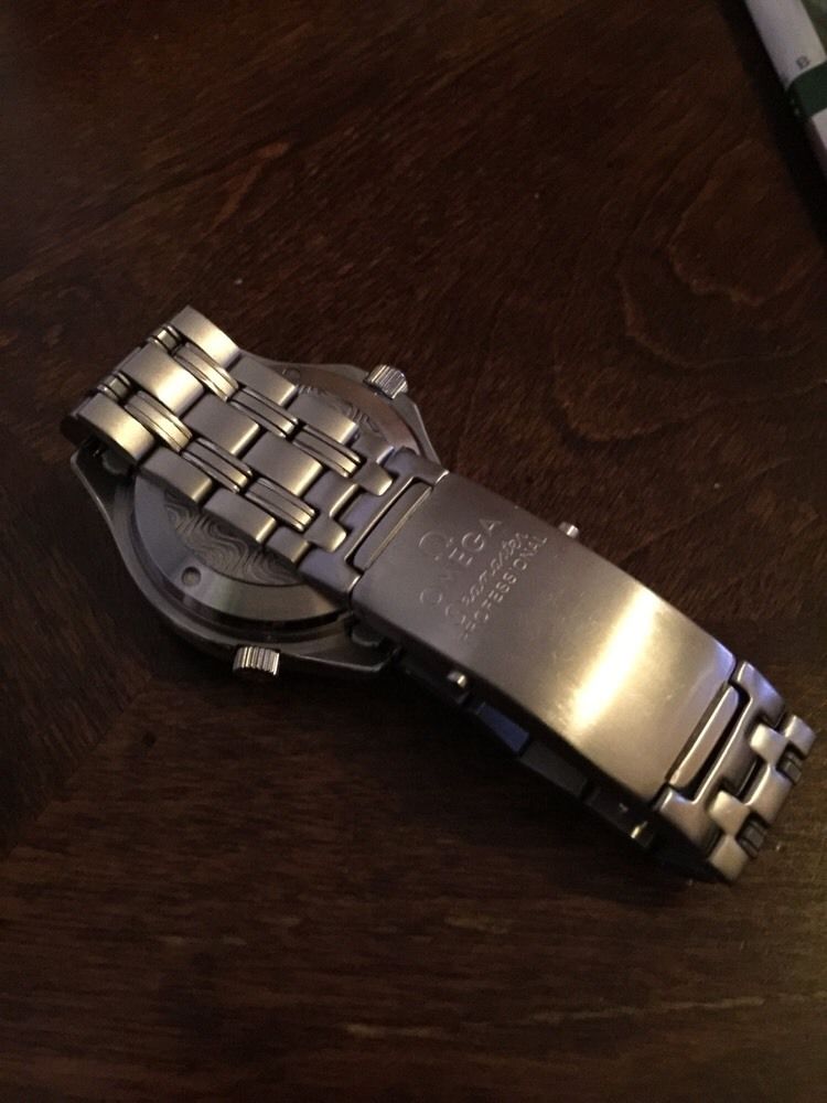

    I can't tell if this is authentic. The serial number is 80617655. What do you guys think?
    Thanks,
  2. Archer Omega Qualified Watchmaker Oct 9, 2015
    26,344
    65,056
    That serial number is for a 25318000, so it does not match the model that it this watch is trying to be. That watch is trying to be a 22208000 I believe, and it is a pretty poor fake. There are a lot of problems with this watch, so stay away from it and the seller.
