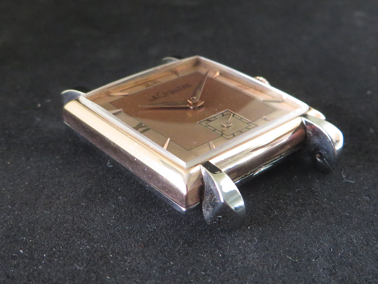

I suspect that both the lugs and bezel are indeed solid gold.

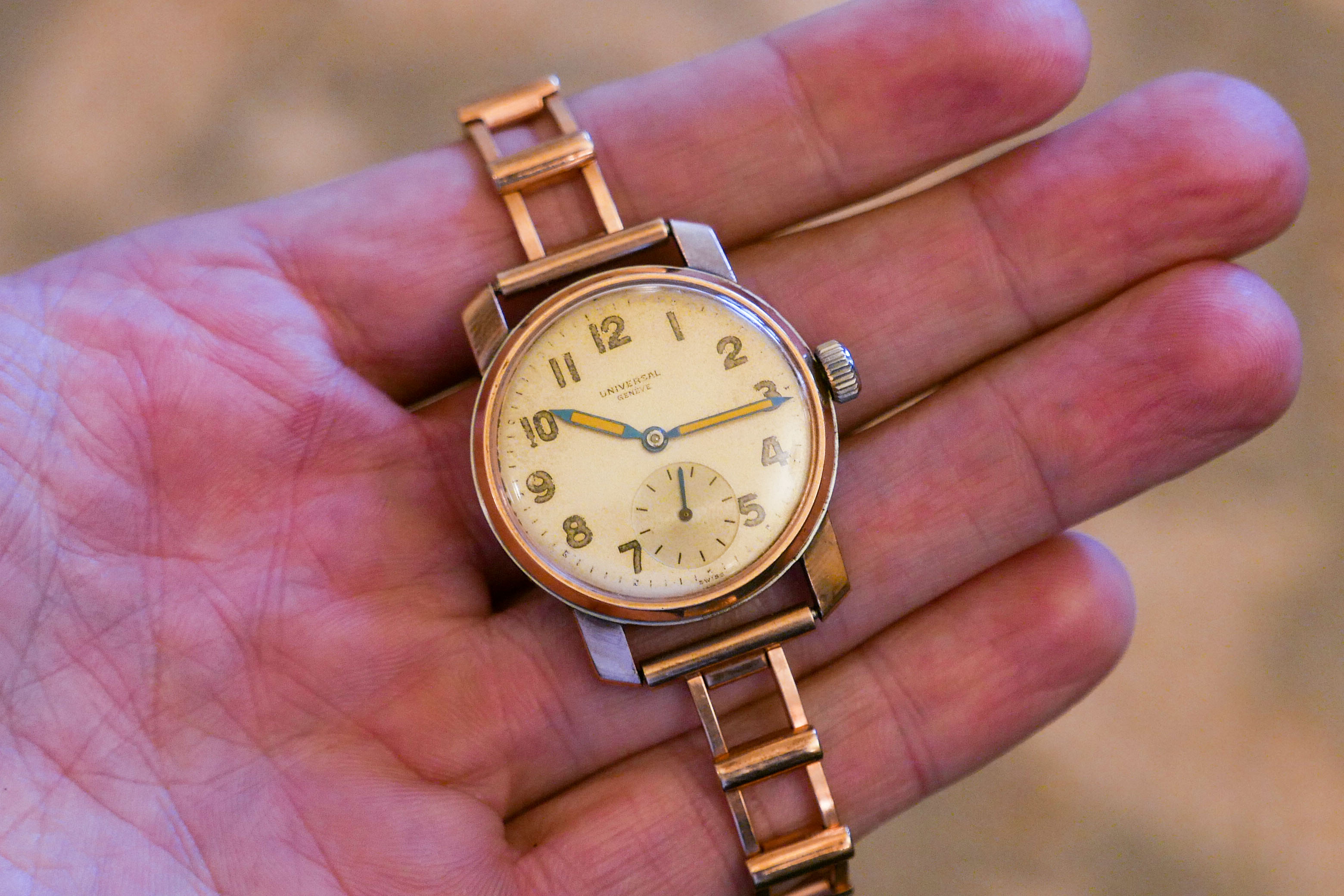

Here is a LeCoultre I own which is the reverse, a solid gold case with steel lugs and back. It's a LECoultre case, but there is no indication as to gold content, but the weight and softness of the main case demonstrate that it is very likely solid gold.

Wow great case! Looks like amazing dial, can we see the front ?

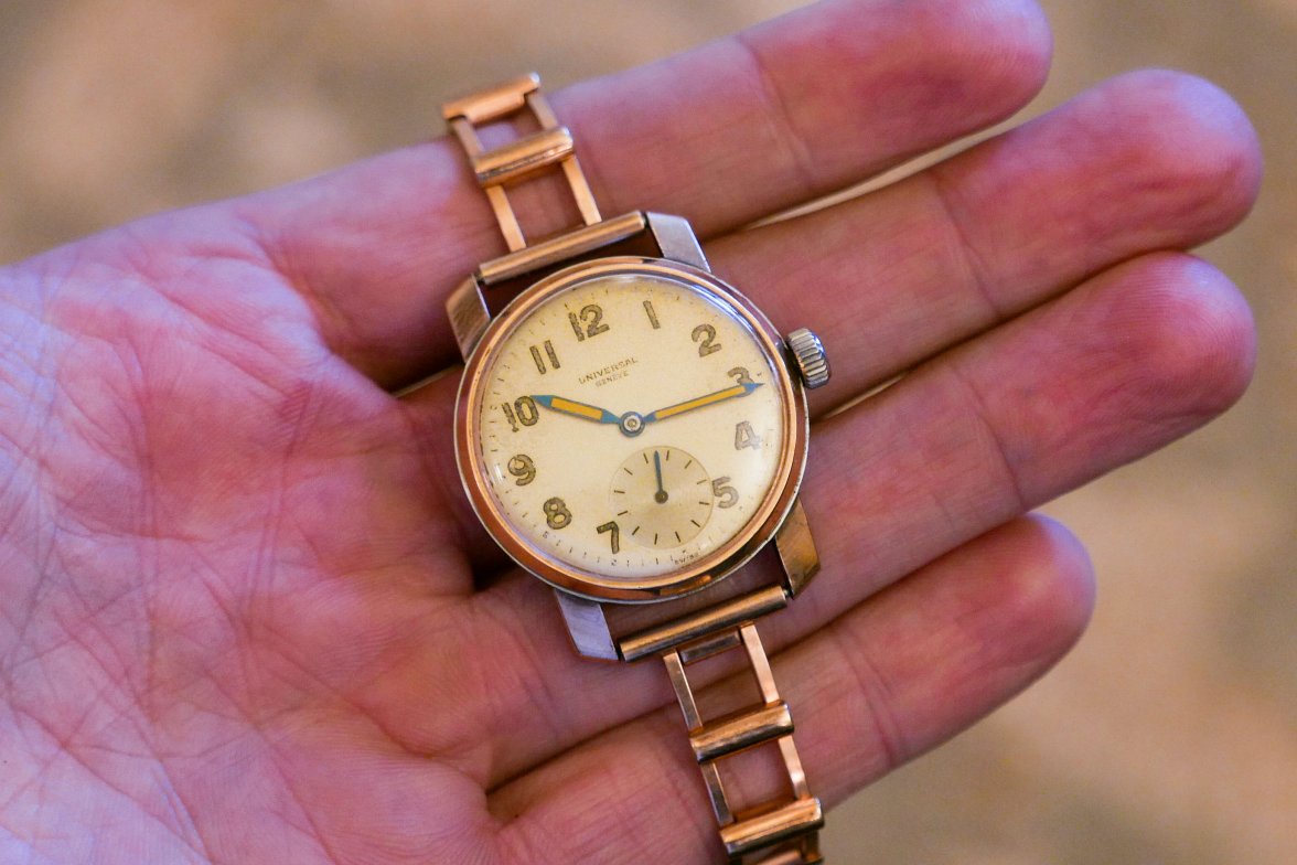

What do people think of a ladder bracelet on a ribbon lugs case ? (This watch belongs to my GF, not me)
3,150
24,012
I find the proportions off, B.

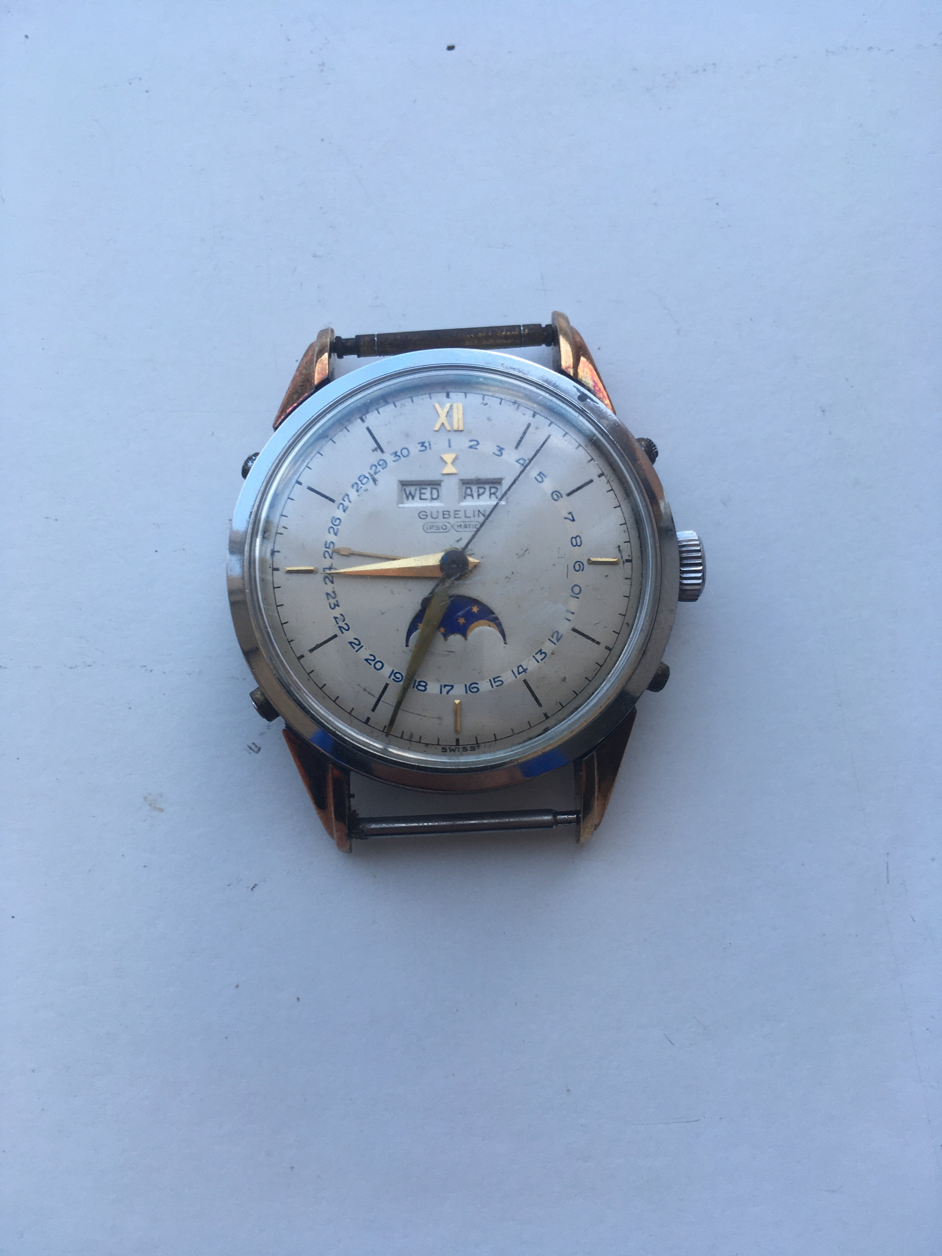

I have similar Gubelin two tone, lugs are solid gold.

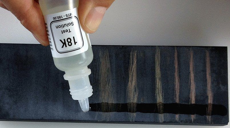

A simple gold acid test would give the answer....
is that a non destructive test? The acid tests I have seen I thought you make a scratch in the metal to apply the solution?
