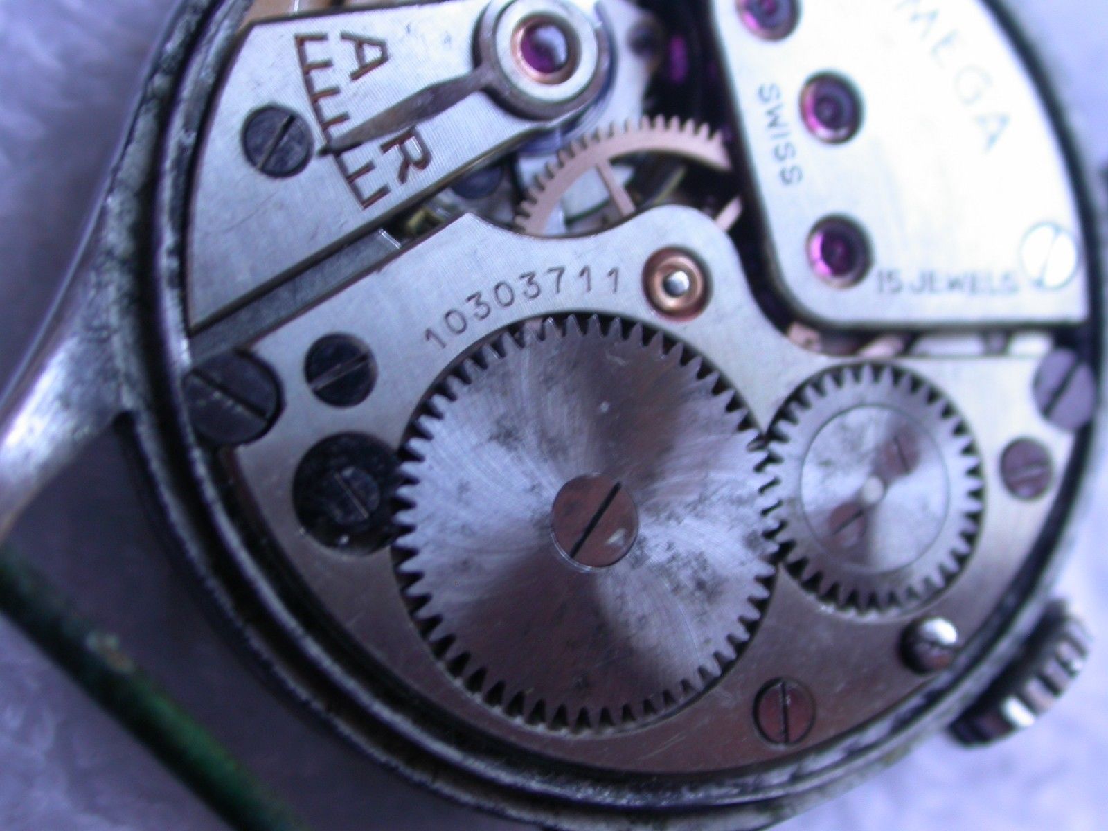

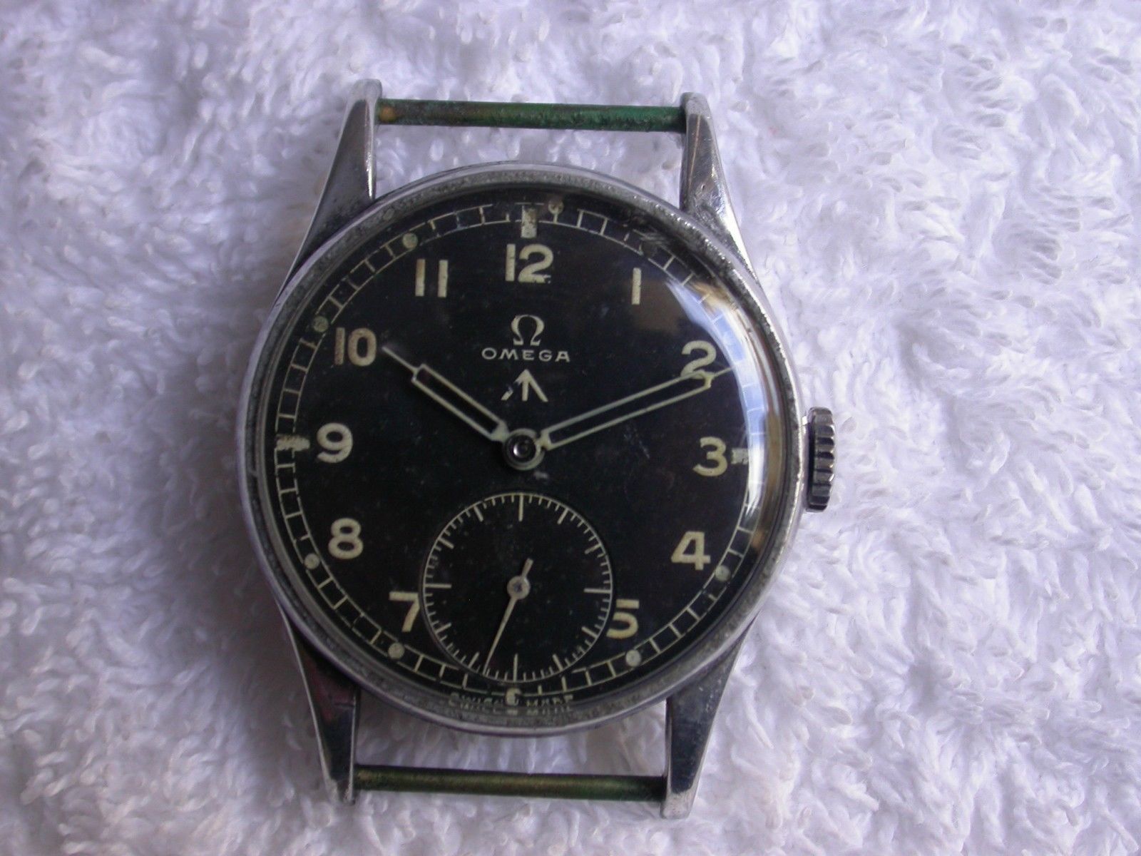

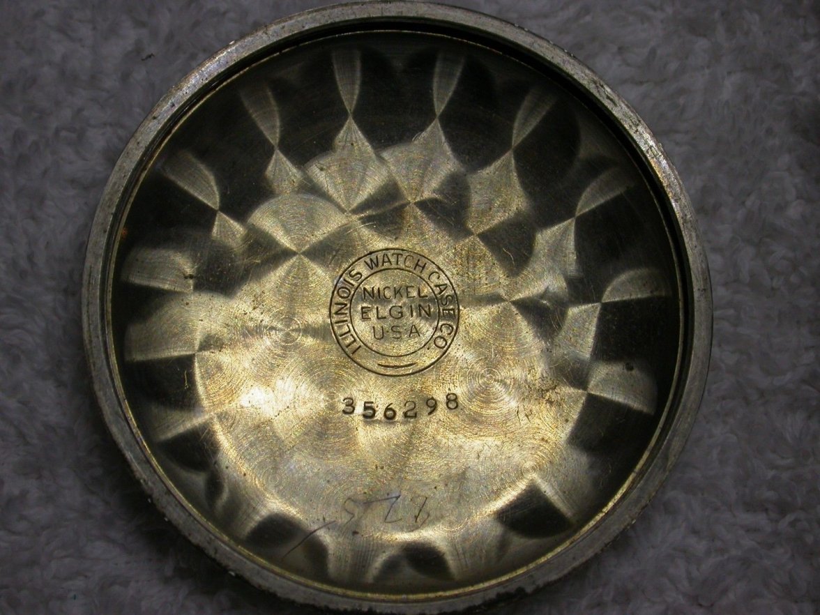

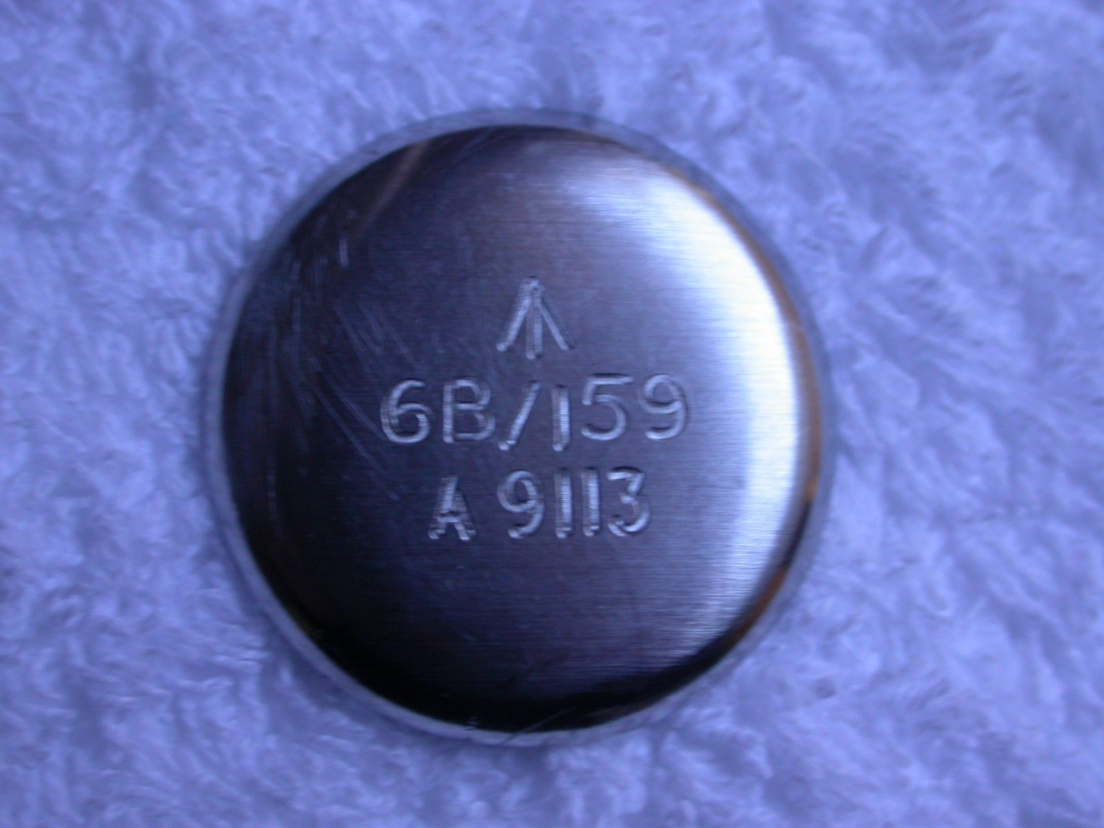

    Hi People,
    I am having a hard time figuring out if this watch is a real Omega produced for the british solider. I don't understand how this watch was made in Illinois yet have the markings on the back above the 6B/159 shows it to be a british Military issue. Also I have read that the movement needs to be a 30T2, is that true? And if so, is it? I can't tell. I would appreciate any correct information.
    Thank you

    My uneducated guess is that it may be a Dennison case, possibly an aluminium one where the re-furbishers (sometimes RAF Instrument Fitters) had to use whatever they could get their hands on, thus the Elgin caseback re-engraved on a pantograph.
    The hands don't look Omega to me and I don't know enough about period markings to comment.
    For conclusive answers please wait for somebody who knows what they're really talking about.

    Looks like a put together watch to me.
    Certainly non-conforming in numerous ways to an authentic military issued example.
    I would steer clear.
