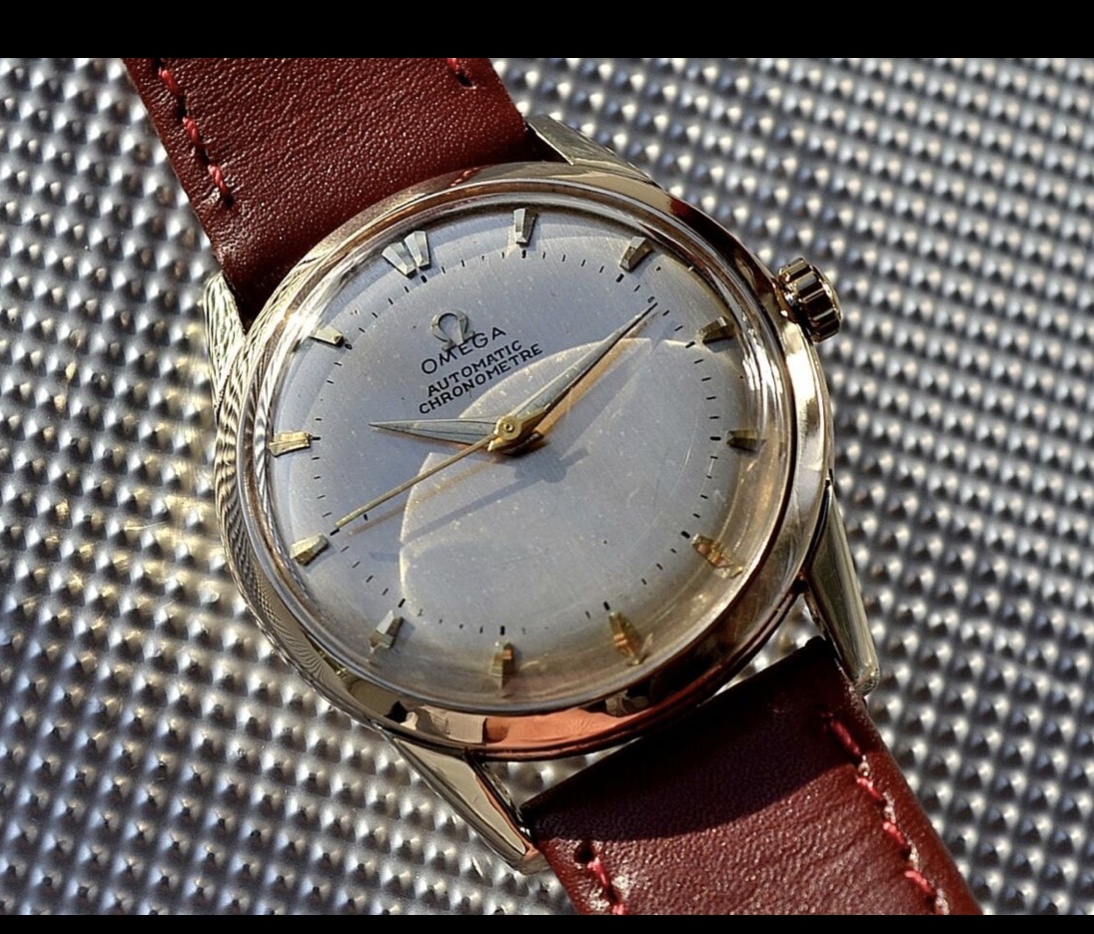

Is this a Franken bumper, and which Omega bumpers might be chronometers?

No, I’m not bidding but I was curious about the movement/dial.

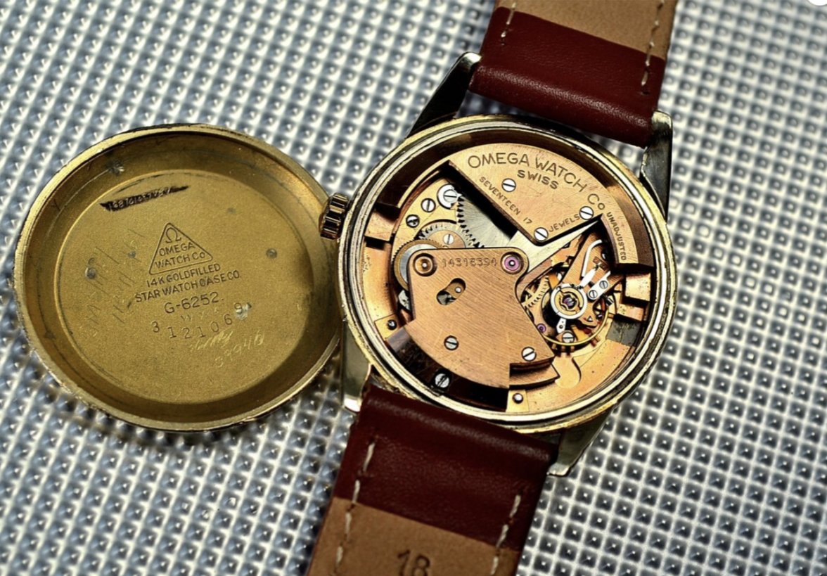

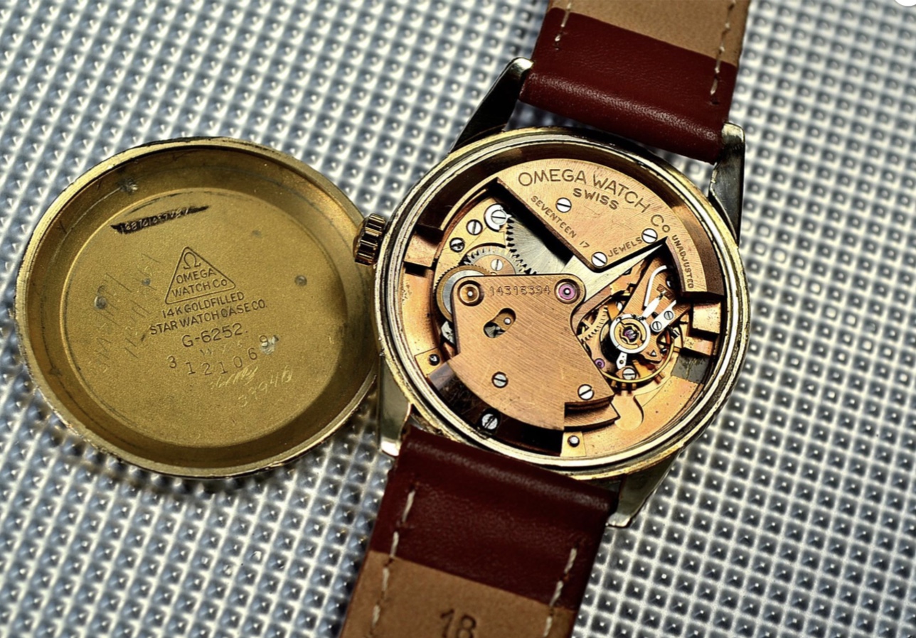

Advertised as a ‘refinished' dial, the poorly refinished dial describes the watch as a 'chronometre' whilst the 354 movement is marked ‘unadjusted'.
I assumed that this 354 wasn’t a 'chronometre' but wondered if a 354 was ever calibrated as a chronometre and, if not, which of the various bumper movements might ever achieve chronometer status

And the chronometers would say Adjusted.

well at least the strap is the right width for the case.

I have a Seamaster Calendar powered with cal.353 and it is non-chronometer. The watch you've posted has a poorly refinished dial, seconds hand is goldtoned but it's color differs from the hour and minute hand (from the pics), also if this is a 14k or 18k gold model it should have hallmarks on the case or inside the caseback - which I don't see here.

Hi,
It is an American made 14k gold filled case.
Cheers,
François
