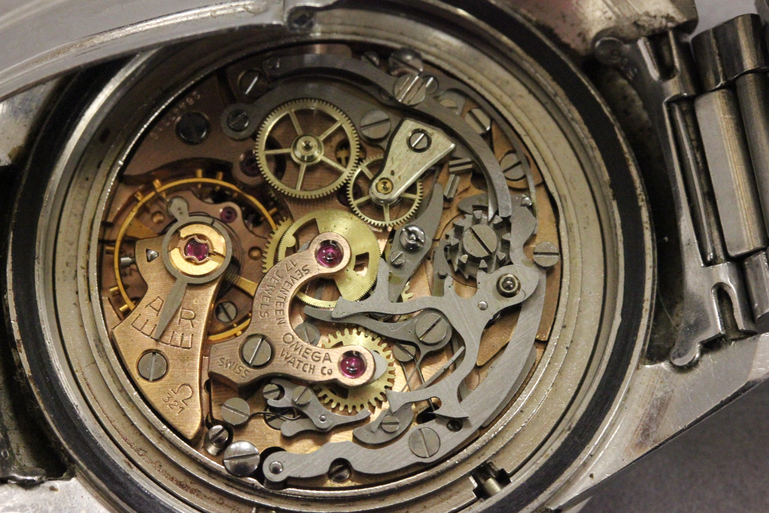

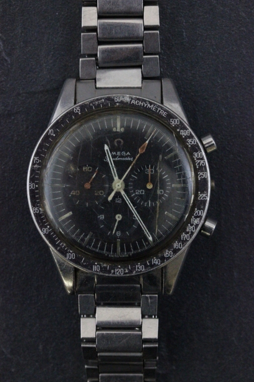

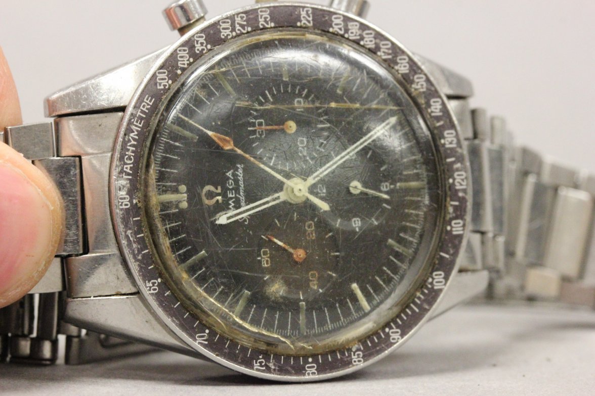

    An upcoming auction for a beat-up speedy and i thought i'd ask the experts, the latest speedmaster101 states the movement should be is around the 2544XXXX number.
    Your opinions are appreciated

    Hi there,
    What's the movement number of the watch in question? And what do you mean a 145.003 case?
    25,446,xxx would be ok for a 105.003-65 (which may have been referred to internally within Omega as 145.003, but not stamped in the caseback). Its also ok for a 145.012.
    As to the watch in question, it's pretty beat up. Movement could probably be sorted by a WM with a Parts account and some experience. The main problem here is the dial. That dial will probably never be pretty, but it would look better with a new crystal.

    That one even I'd be cautious on, could end up a total money pit given the moisture that's no doubt gotten in, just because the movement pic looks ok on the surface doesn't mean it'll be rosey when your watchmaker gets it all apart.

    That dial looks in a pretty bad state. At best it could end up to be a really unattractive working piece.
    Looks indeed a bit of a money pit. That missing crown makes me wonder what has happened to the movement anyway.
    Best feature to me right now is the bracelet.

    That watch looks like it's had a single owner who purchased it and wore it everyday until it was dead. The top of the movement looks pristine- I doubt it was ever serviced by the owner- none of the screw heads even look scratched. Water has gotten in though and that makes it a real gamble. The pivots may be ruined on every gear (you can't see under the dial) and the hour recorder and keyless works might be a rusted mess.

    Looks like a rough one. I wouldnt want to see what's happening under the dial with those rust spots on the hands.

    It already has been said: depends on the price. If I could buy it for a reasonable price I would only put a new Hesalite on it and have the movement serviced/running again. A new crown is not a real issue for me. This is a replacement-part and this one has no crown at all, so it's an easy decision. And, by the way, I've seen more damaged DON90 bezels...

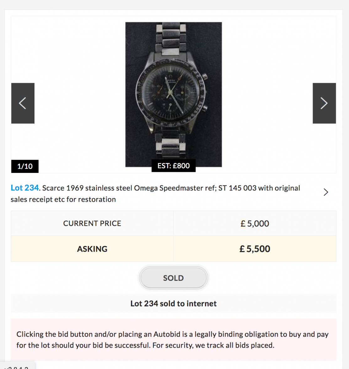

  14. tyrantlizardrex Nov 4, 2016
    8,881
    27,410
    That escalated quickly... he opened at £3k, it sat at £4k for a couple of minutes and then two bidders pushed it to £5k + 18% comission.
    Seems like a high price to pay for a watch in this condition.

  15. prontoprint Nov 4, 2016
    281
    559
    Apologies for starting separate thread on this watch, should have known it was being discussed ;-) ( Now deleted thread - thanks Mods )
    I too was shocked by how much it sold for, think I'll stick with my current collection and stop playing at the auction houses. Might start tapping up the elderly neighbours in the street, best chance of coming across one.

    Condition, condition, condition is right, but you can add originality to the mantra. Watches like this will always attract the buyers that favour originality over a dealer prepared watch, and it only takes two to go head to head.
    It will improve significantly with a service, clean and new crystal, but unfortunately those plots will always be green.
    Given the above, I hope it's gone to a collector. However, I wouldn't be surprised if a dealer snagged this. If you add a sympathetic relume and aged hands to the service, you could have an attractive and expensive watch to the right buyer.
