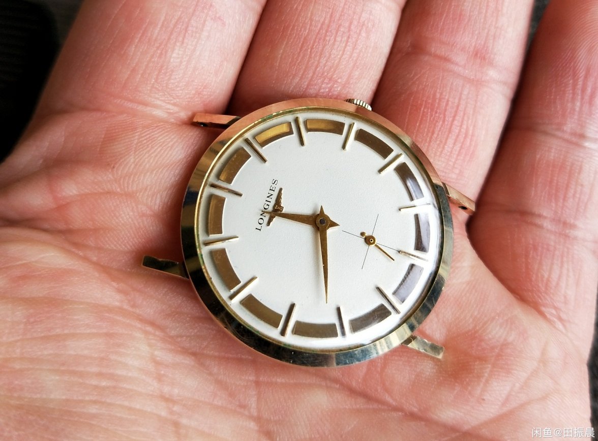

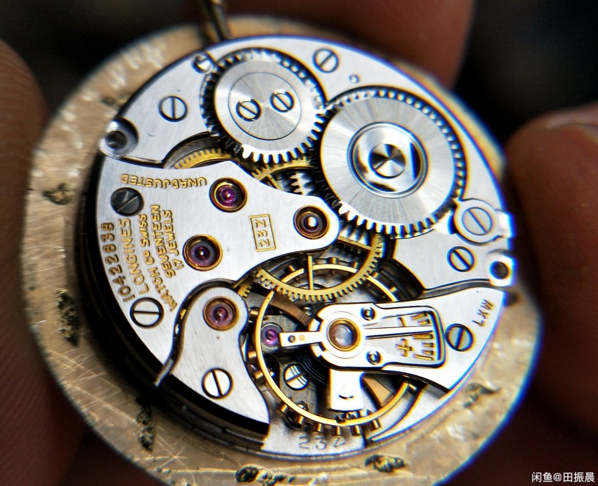

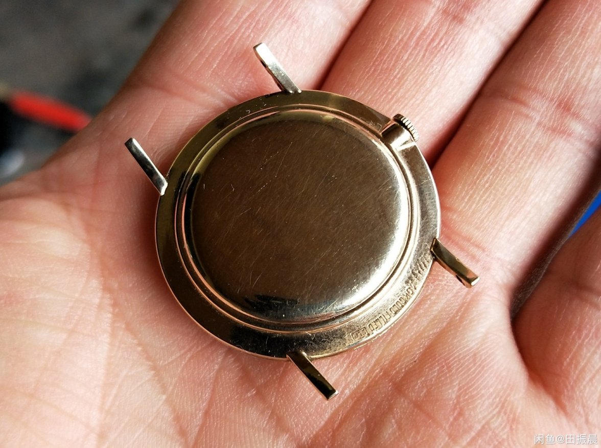

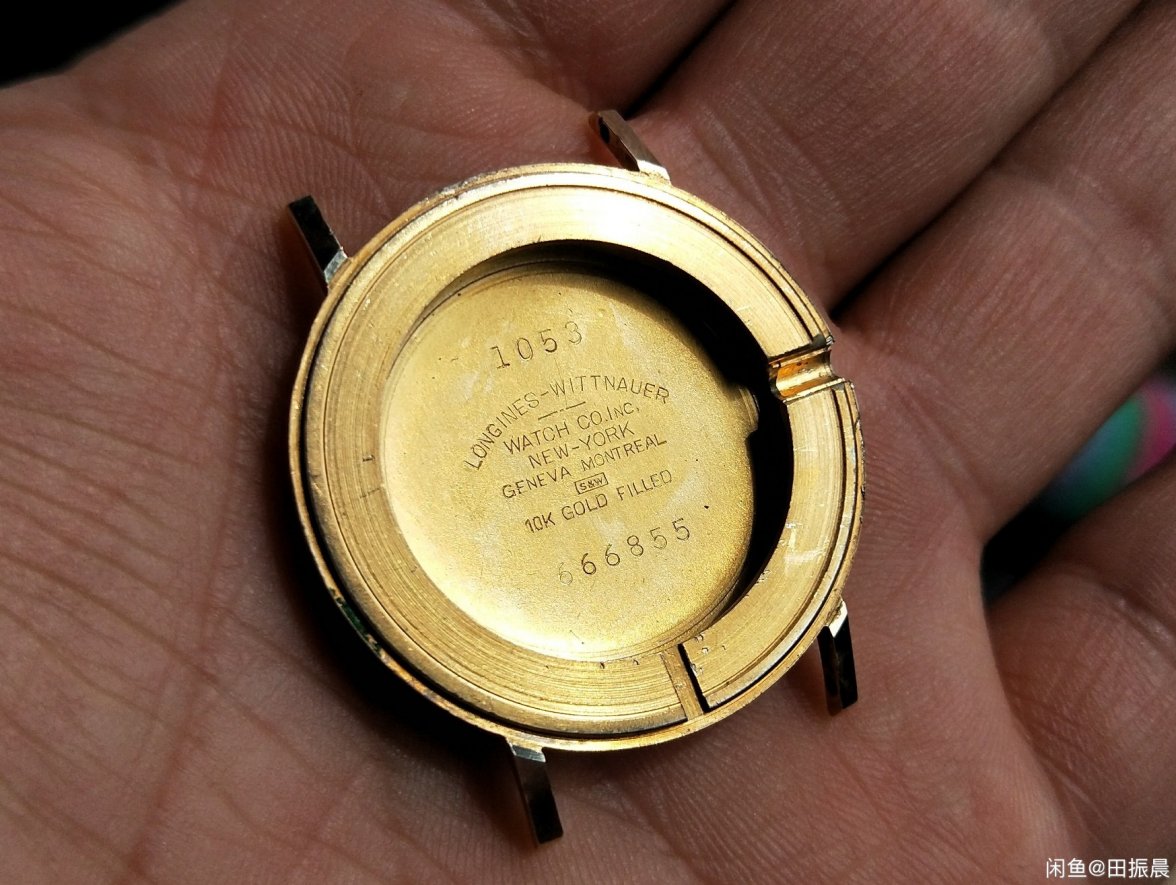

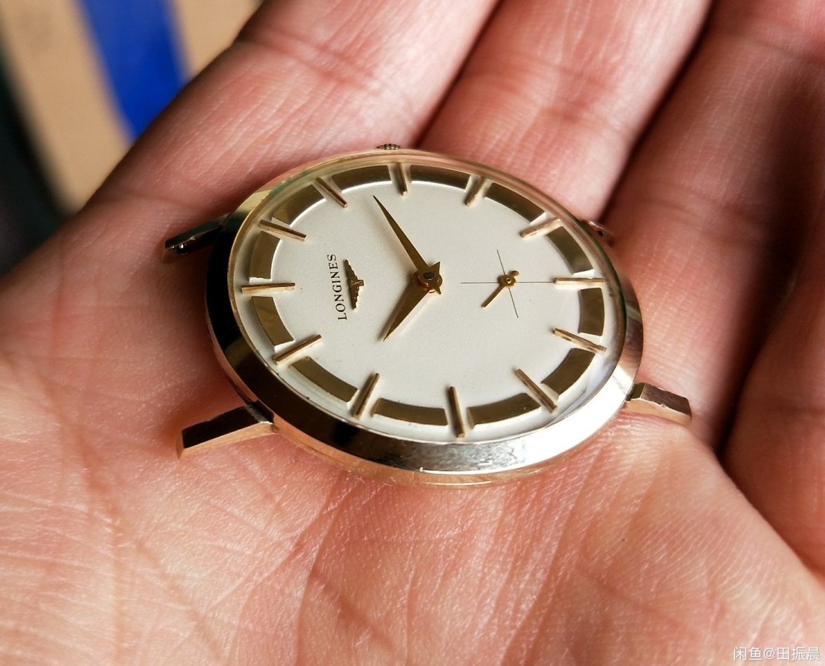

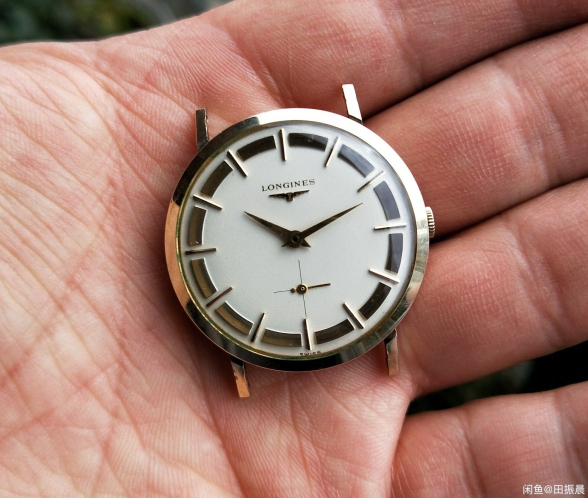

Hello everyone, I have found this vintage Longines from a local dealer, the caliber looks fine but I have not seen a dial of this style before.
I have bought several vintage Omega these days and would like to add some Longines. Could any kind hearted provide a reference that tells all key calibers history and yearbook of the serial numbers on the calibers and cases?

This appears to be a US-cased watch, so I don't know what the archives will show. I don't see any obvious problems with the dial at first glance. I certainly would have expected longer minute and hour hands, but who knows.
