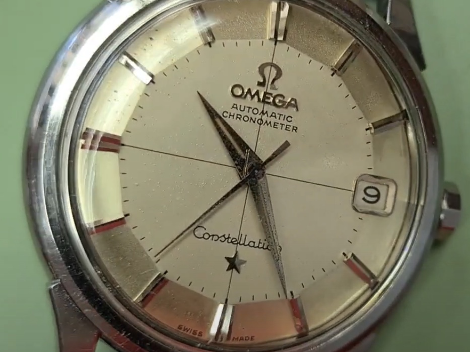

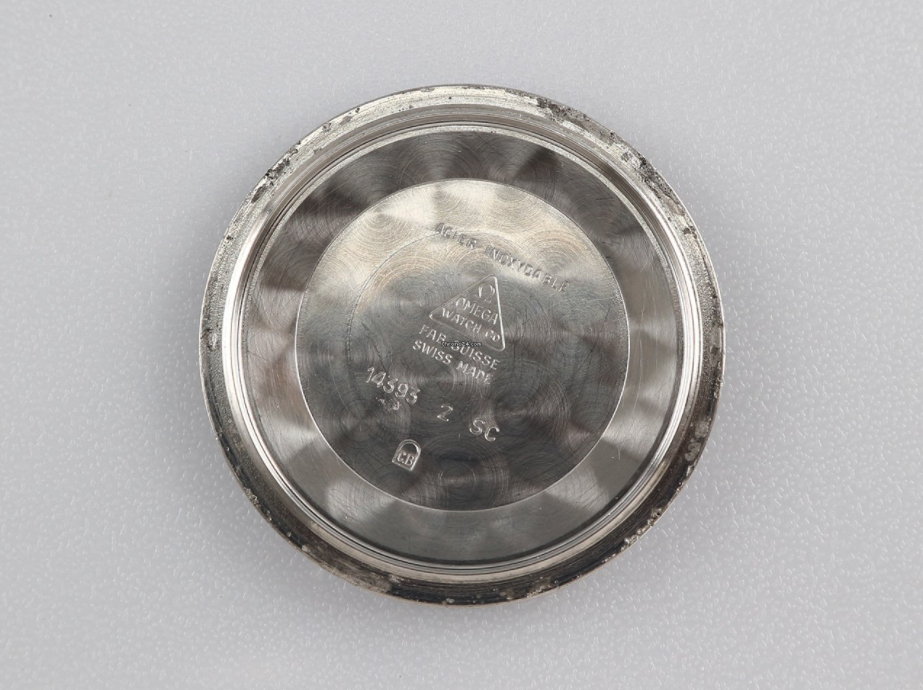

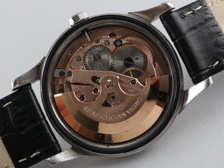

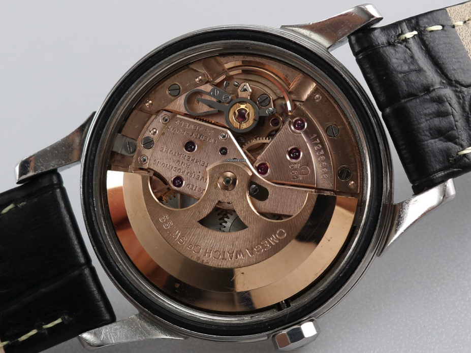

I am looking to buy this 14393 constellation from a private dealer, and I am seeking your expertise. Are you able to spot anything wrong with this watch? Should I be concerned by the poor case back condition? Would love a second set of eyes on this.

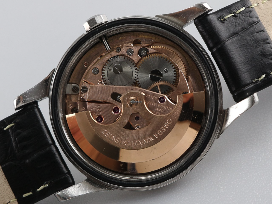

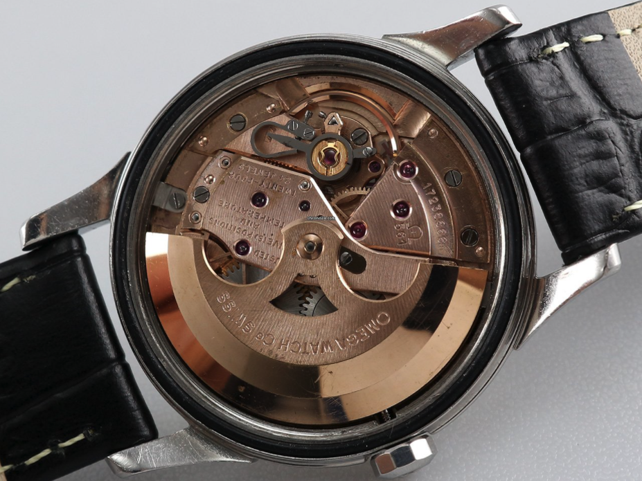

Do you have photos or video of the movement and inside cover?

All looks correct on the outside.
As per @gbesq comments you need to see pics of the inside.
Up close you can see the dial has some light spotting and the case back has plenty of scratches as noted.

An up close pic of the dial.

Hands have some corrosion. The dial looks more like micro-bubbling of the lacquer than spotting. The asking price should reflect the condition of the dial and hands
Same difference in my world. Whatever the cause it’s non retrievable without great risk.

Does it need to be retrieved though? It's just another kind of patina. My 168.005 has micro bubbling/spotting and I still love it.

Not at all it looks absolute fine and probably even better at normal viewing distances.
My point was more about the difference between bubbling and spotting. Same thing in my book.

I'd say that the dial bubbling is something that would worry me a lot more than the caseback. I still find it attractive though 😀

Ask the dealer when the watch was last serviced. If it was serviced, ask when and if there is documentation showing what was done. Depending upon whether a service was performed, I’m thinking more like $1,300 - $1,500. This is not a $2,000 Connie IMO. Others may differ.

movement pics look good, shows cal 561 for date (which shows on the dial).
