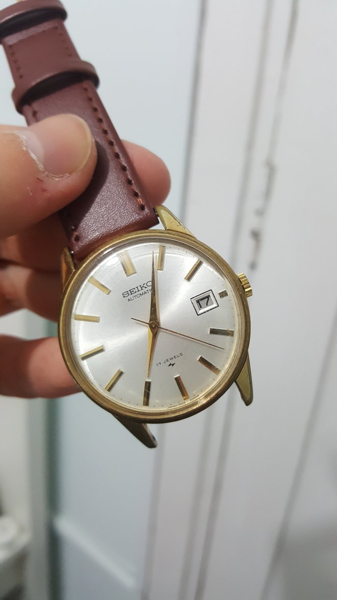

    Hi,
    Thought I'd reach out to vintage Seiko owners regarding the vintage 7005 model. I have one of this from a few weeks back and while it runs well, it does not seem to manually wind? When I wind the crown, there is no catchment so initially I thought it was loose.
    Did some searches on WUS and it is described as auto-wind. Does this mean that it is futile to wind the crown, unless it is pulled out to set the time/date?
    Cheers

    Yes, you are correct. Many less expensive or older Seiko watches only auto-wind but can't be manually wound. The Seiko NH35 movement used in some micro brands is an example of one that can do both.
