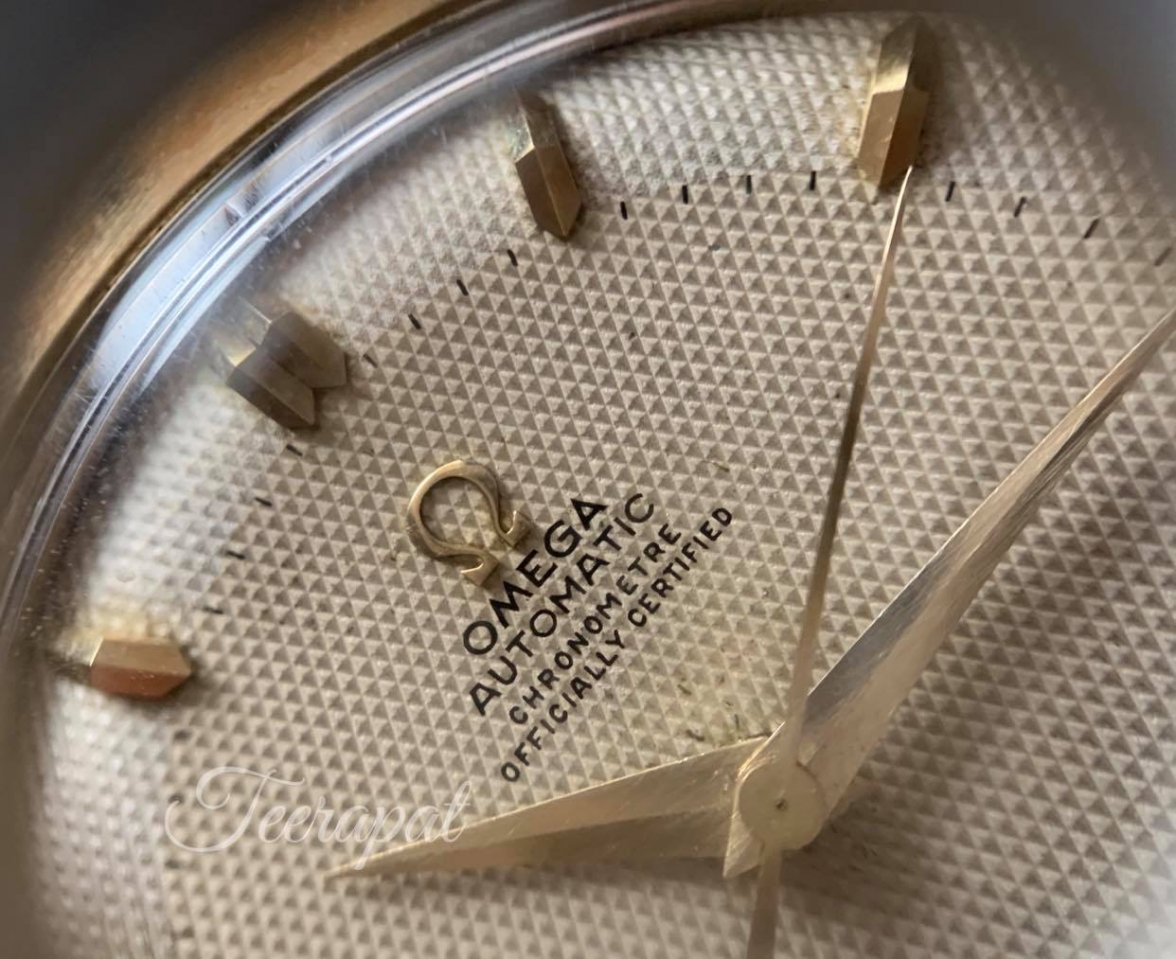

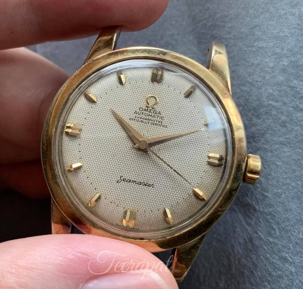

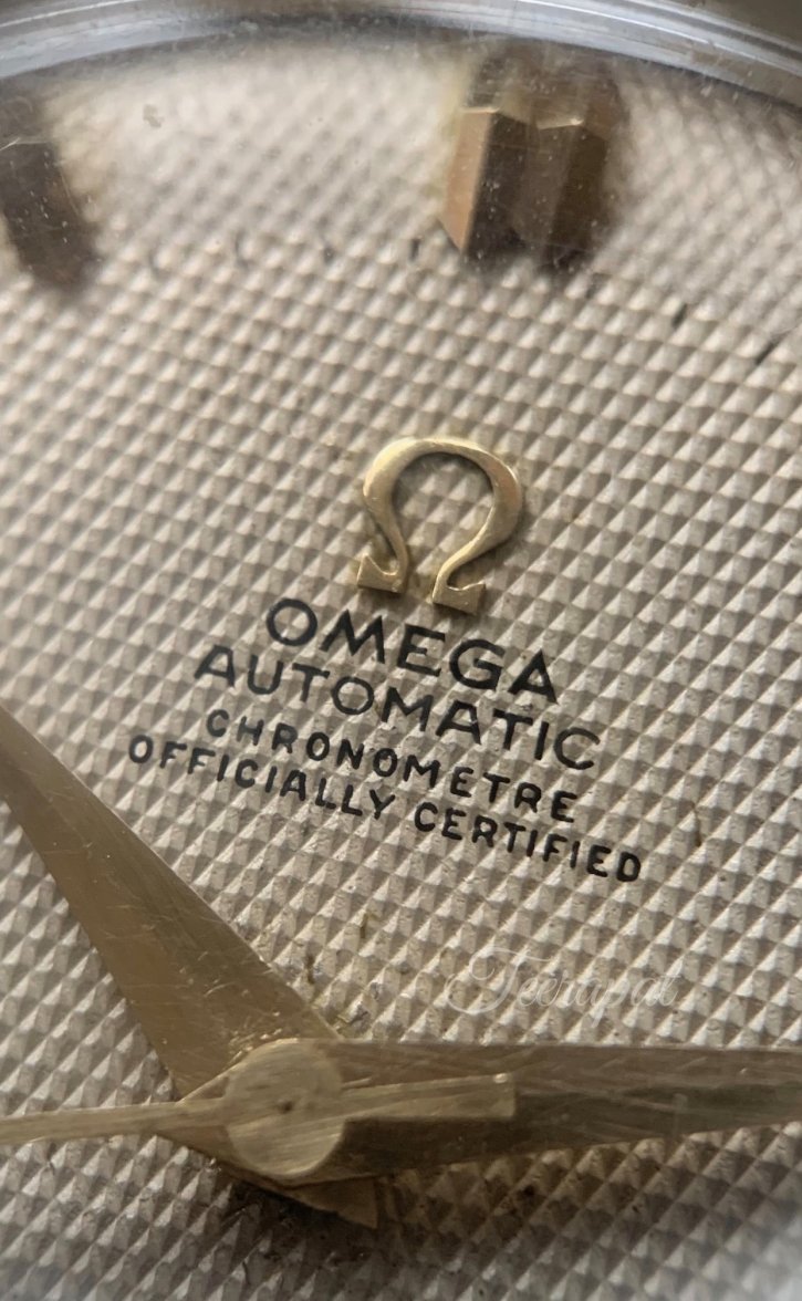

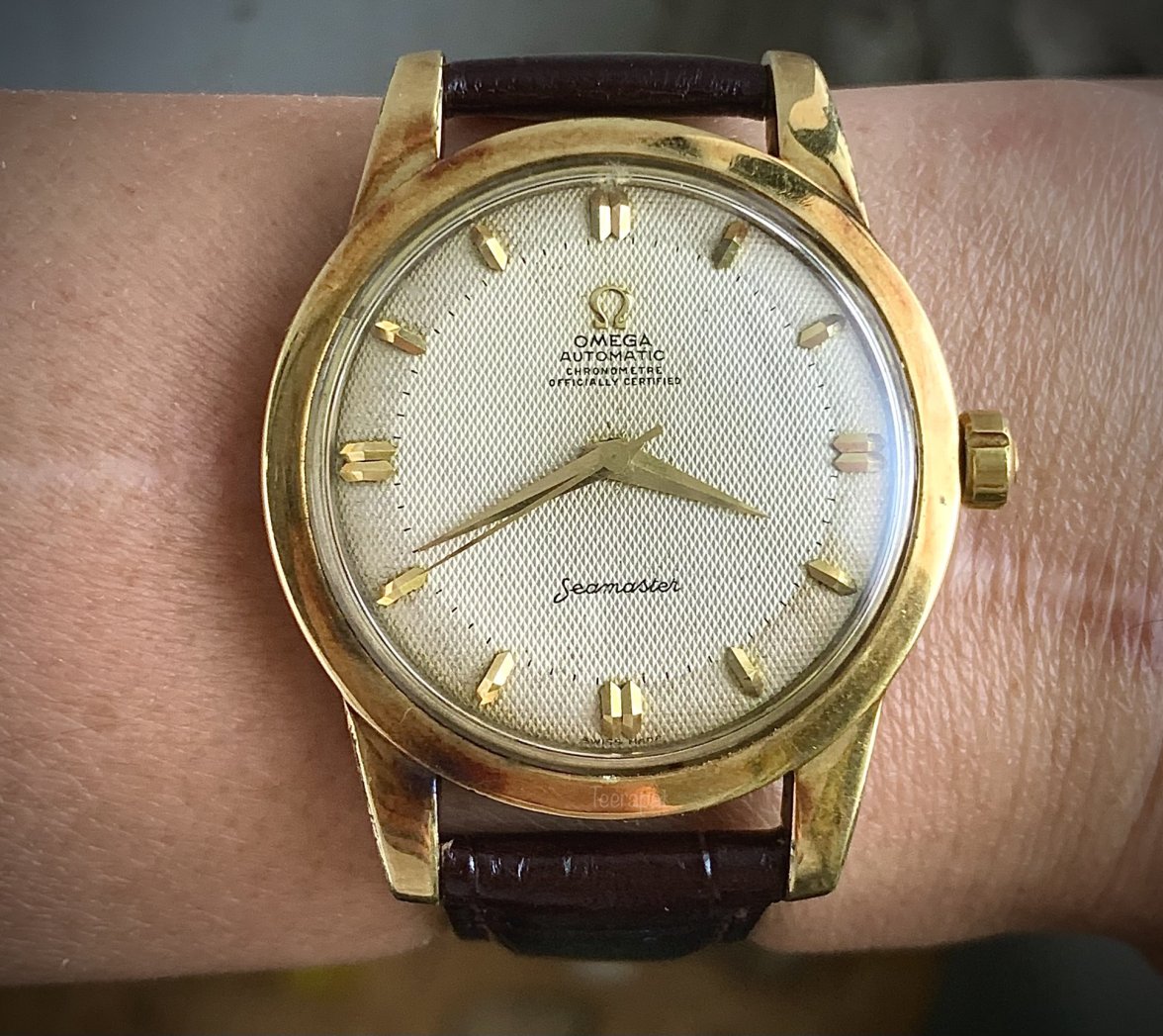

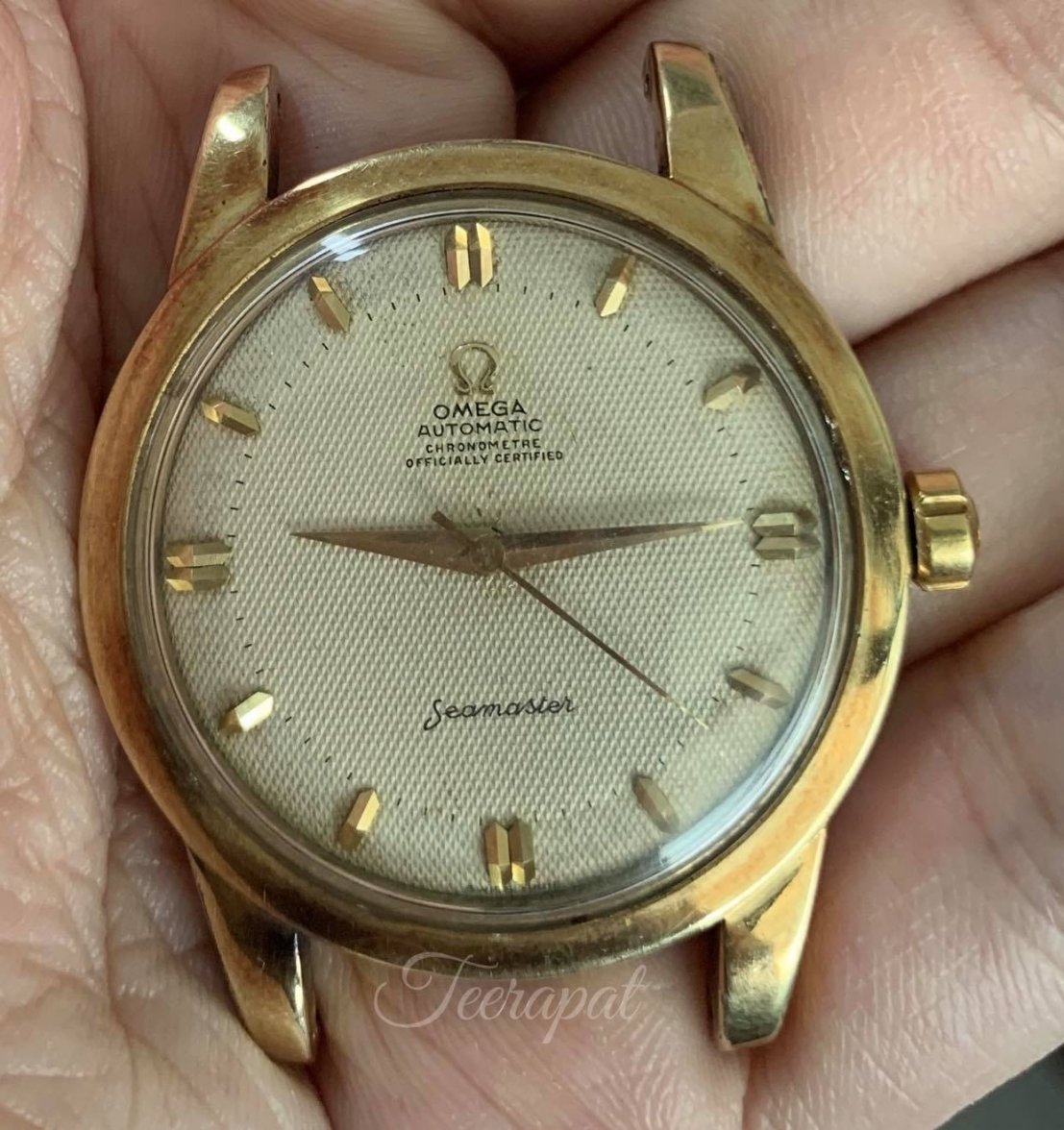

I want to share another of my uncommon watch ( in my opinion). Omega seamaster in jumbo case (36.5mm) with textured dial. Moreover, wording of chronometer was shorter than automatic, also pointed “A”.

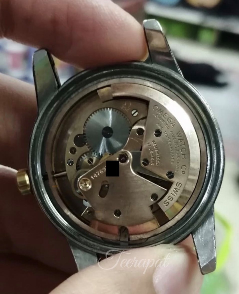

This serial number of this watch is 1,476,9xx (indicate production year was around 1955).
Caliber of this watch is 354 , 17jewels.

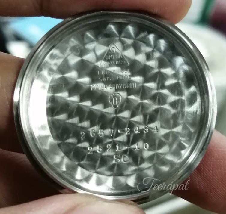

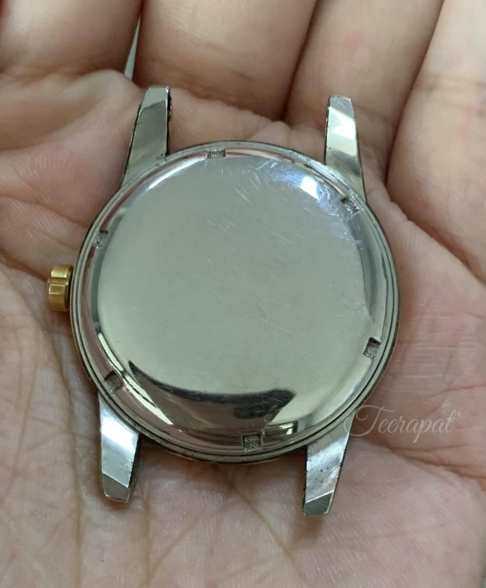

The caseback reference has 3 numbers as shown in pictures.
“2657-2494”
“2521-10”
“SC”
I also created another post about the seamaster jumbo with chronometer officially certified in this forum.
(Using the same number inside the caseback and serial number was different only by “626” , comparing with this watch)
https://omegaforums.net/threads/my-...tre-officially-certified.112122/#post-1482253

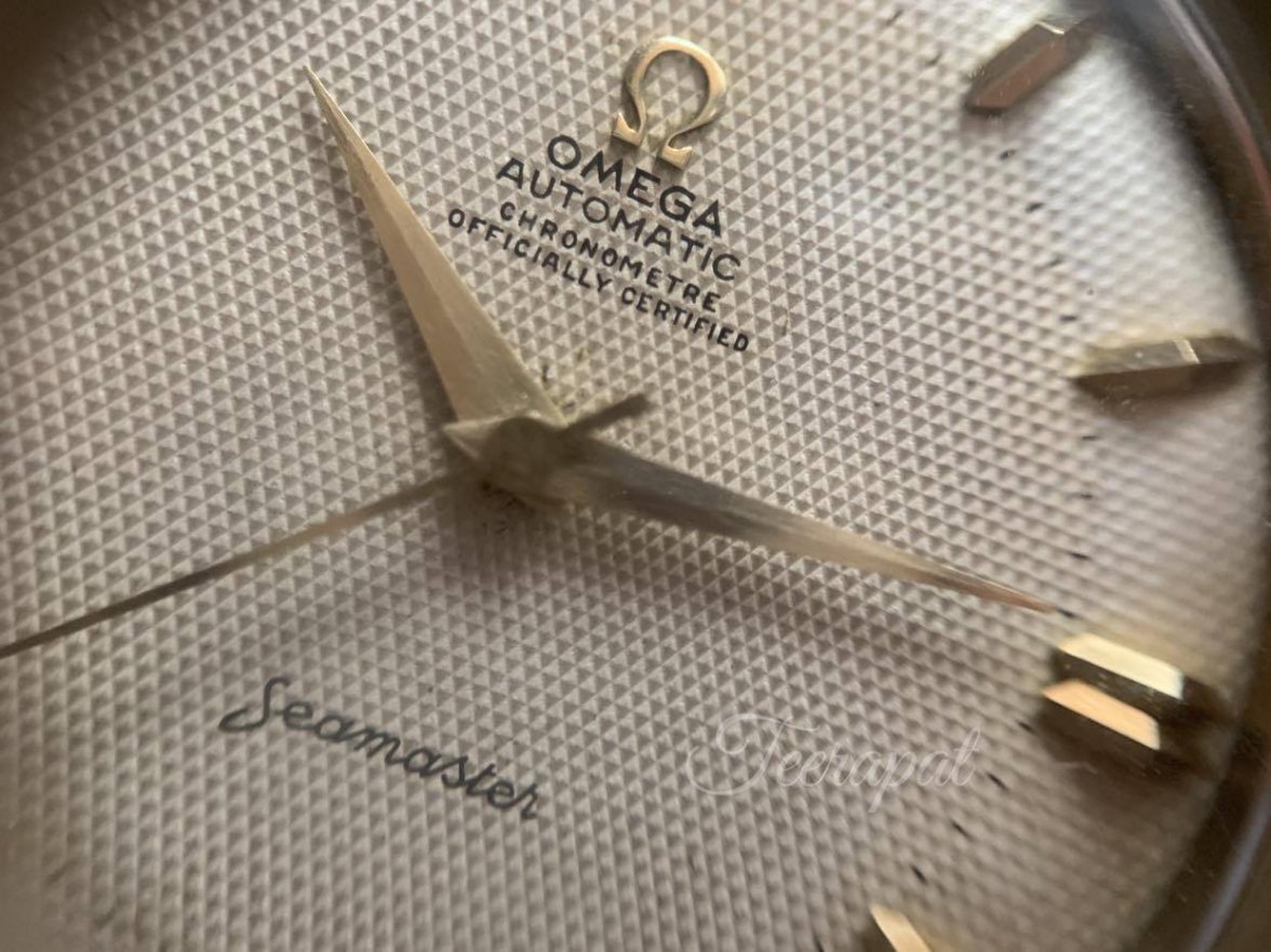

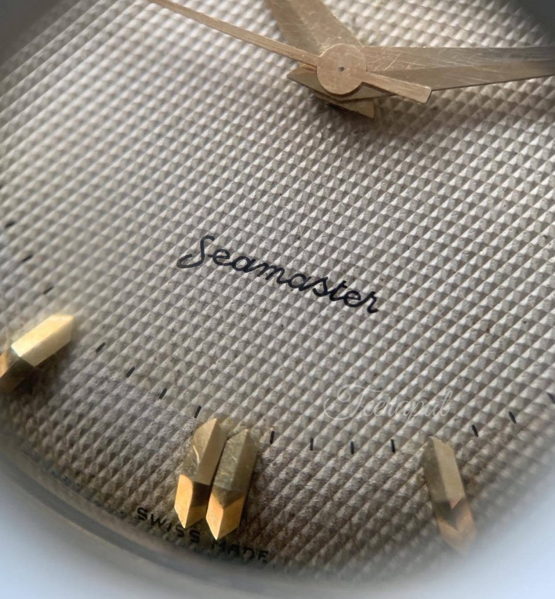

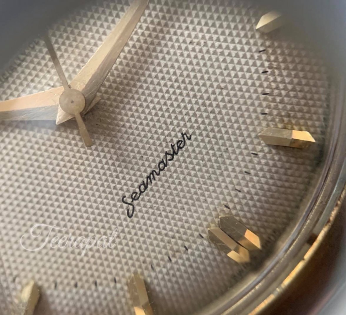

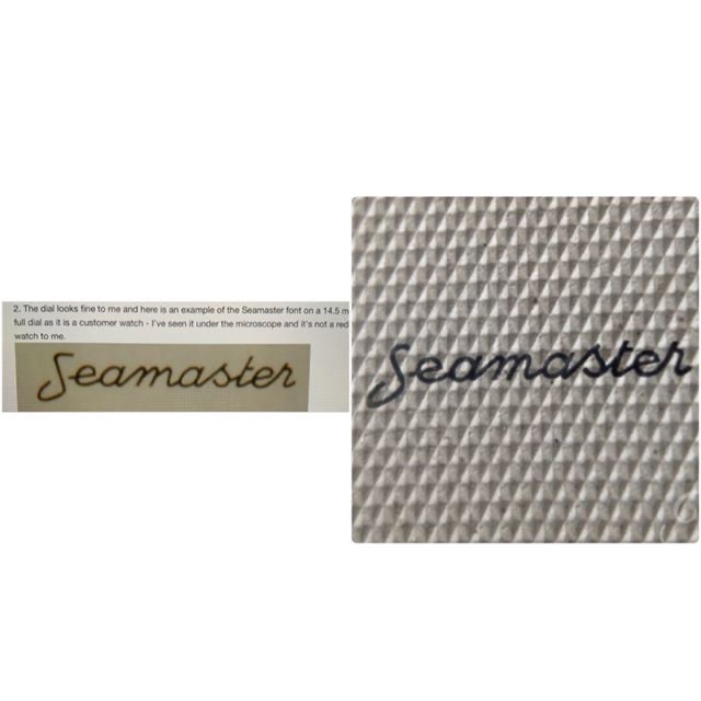

I’m not sure about the font of my watch
(it's hard to interpret due to textured dial style; different style of “S”in the “Seamaster” word)
What’s your opinion ? (Redial or not?)
Does someone try to add“ chronometer officially certified“ later to increase value of the watch?

Not added, I think. It is a re paint. The omega is too thick, even for a hobnail texture. Which is tricky to print.....kind regards. Achim

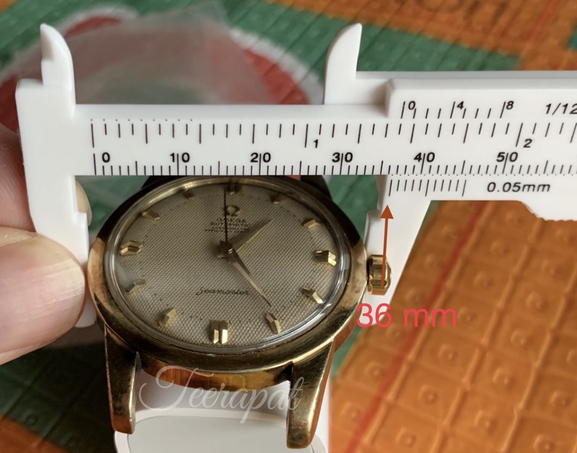

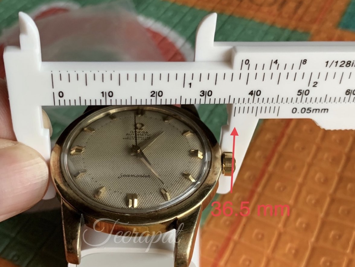

So sorry, I try to edit the jumbo size from 36 to 36.5 mm.
Thanks,

I agree that it´s a redial, but a quite good one and I would wear that watch with pride. 😀

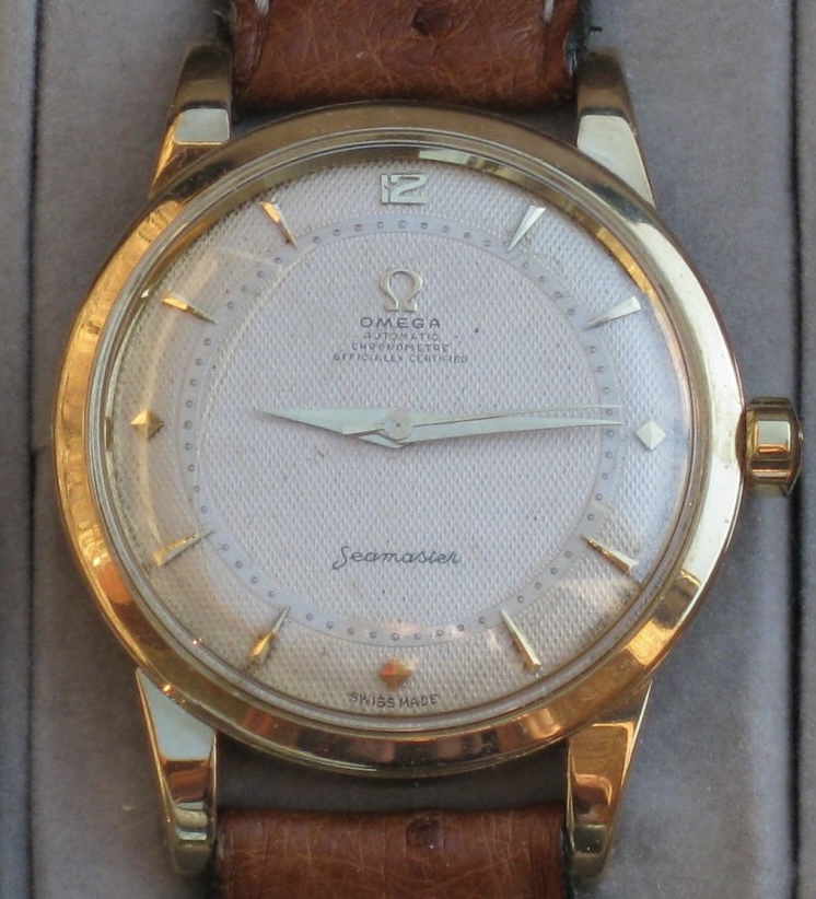

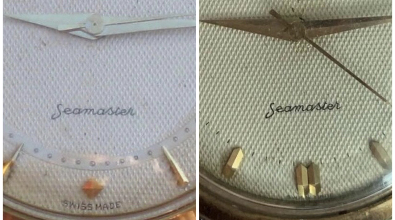

https://omegaforums.net/threads/rar...-pink-gold-jumbo-seamaster-chronometer.13092/

Whoever refinished this dial can paint my car anytime.

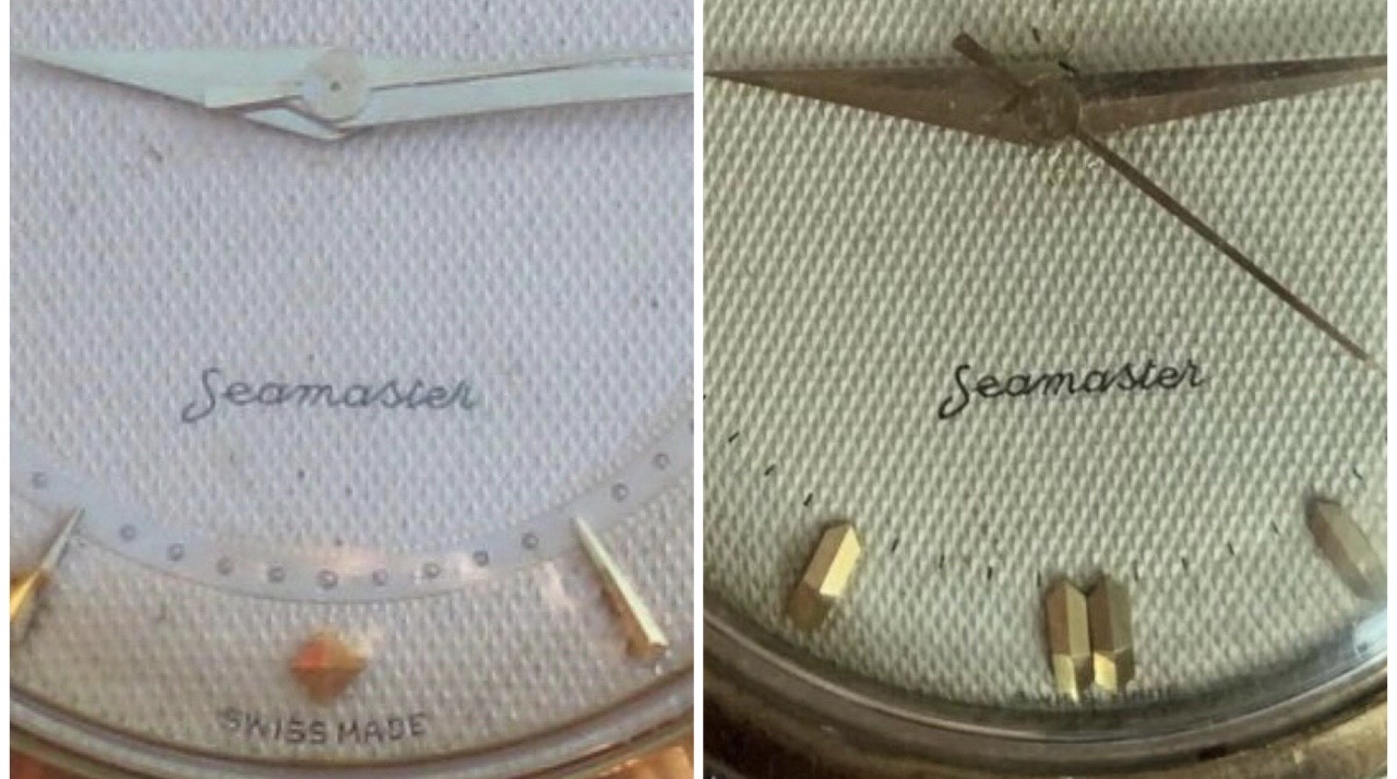

And a Jumbo that I once owned, for further comparison:
I do agree

It looks really nice though! The "seamaster" looks really quite straight compared to the mesh of the dial

I think the alignment of the 2 applied markers at 9 o'clock look off also.
Nice watch though!
