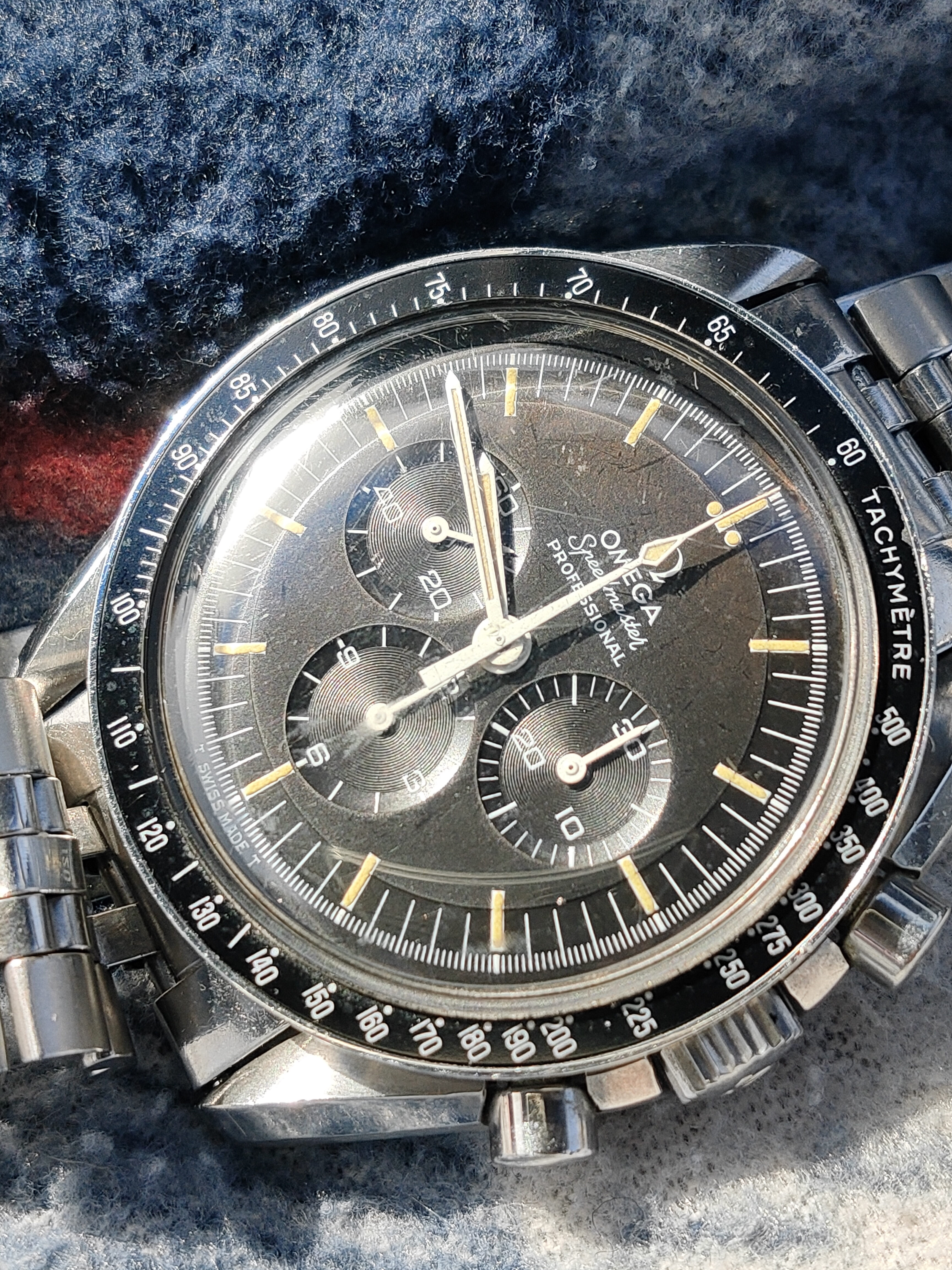

Does this watch have a tropical dial?
Hello all
The serial number is 28425xxx, which is outside the range of tropical dial feature serial numbers (29xxxxxx).
The price is JPY398,000
My personal opinion of this watch
The bezel is a service bezel.
The indexes and hands are nice and nocturnal; they shine for a few seconds under UV light and then go dark for a few seconds.

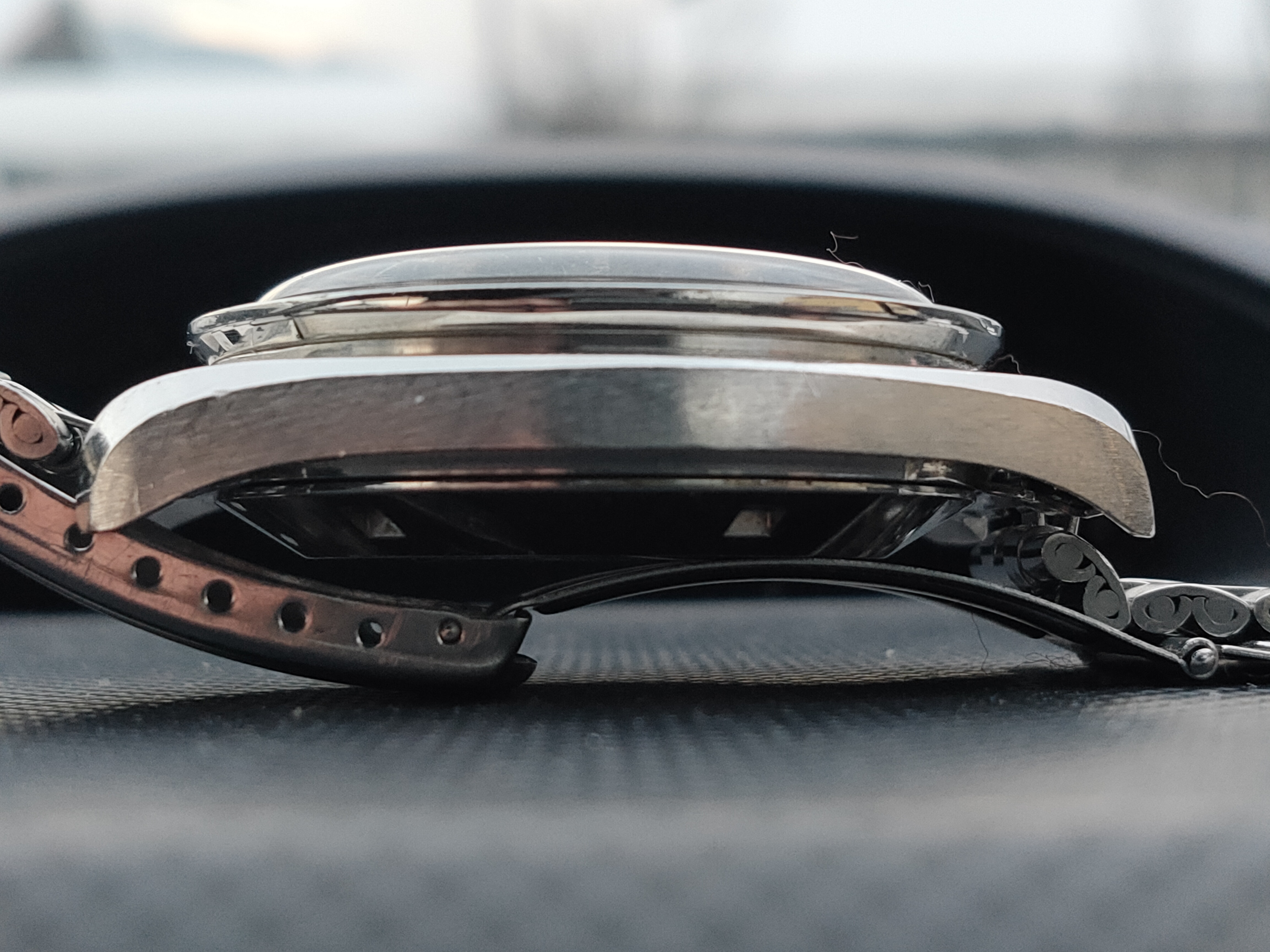

The case is edgy and has some hairline marks, but it feels skinny and polished.
The bracelet is generic but looks good in my opinion. The end links are 516.

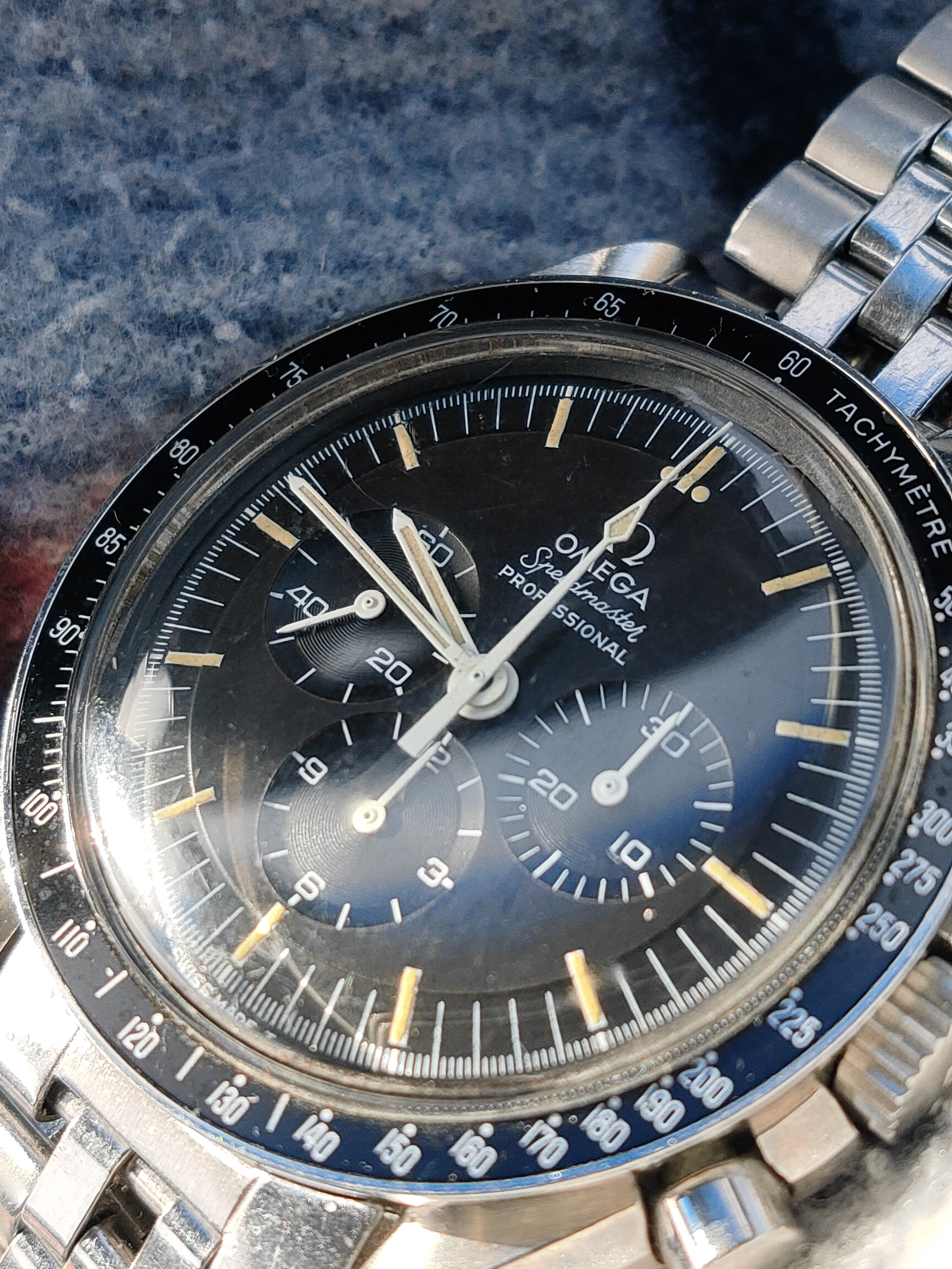

Pictures of the dial on a sunny day
Pictures of the dial on a cloudy day
Other pictures

I don’t think it’s “tropical” in the traditional brown dial sense. However I do think it has a nice aged dial that may continue to change to a lesser degree than the “chocolate” dials.
I didn’t check if it is supposed to have a DON but the dial and case look great IMO. The lume is super consistent. And the case looks sharp to me. I’m not saying it wasn’t polished, but it looks like a watch that wasn’t abused for 50 years at the very least.
Not sure what the yen conversion is, but that’s a slick watch if you want a good looking -69 albeit if your’e set on a tropical I’d keep looking for something else.

I really like it a lot.
The dial starts to turn a slight brown. Lovely -69.
At that price, I would buy it !

It should definitely have a DON in that serial range. The current bezel is a service replacement with virtually no value. Discount several thousand USD. Otherwise, I like it.

Good looking watch, especially at this price. Whether it is tropical or not, it has an appealing dial body colour to me.
You might have noticed it comes with a bracelet that doesn't really match, but brings two 516 end-links as a bonus. These are worth quite a bit for people to complete their 1039 bracelets with... 😉 Could give you a small head start towards sourcing a nice DON to complement this piece, or a much easier way of getting a 1039 fitted as you already have the relatively harder to find end-links.
If you wouldn't buy it yourself; let others here know, I am sure this would be a great watch to stay in the OF family!

Definitely not tropical in my view, but a nice and honest looking Speedy. You got a decent deal at around $3,800USD, with the understanding that the watch will need a decent condition DON and potential service.

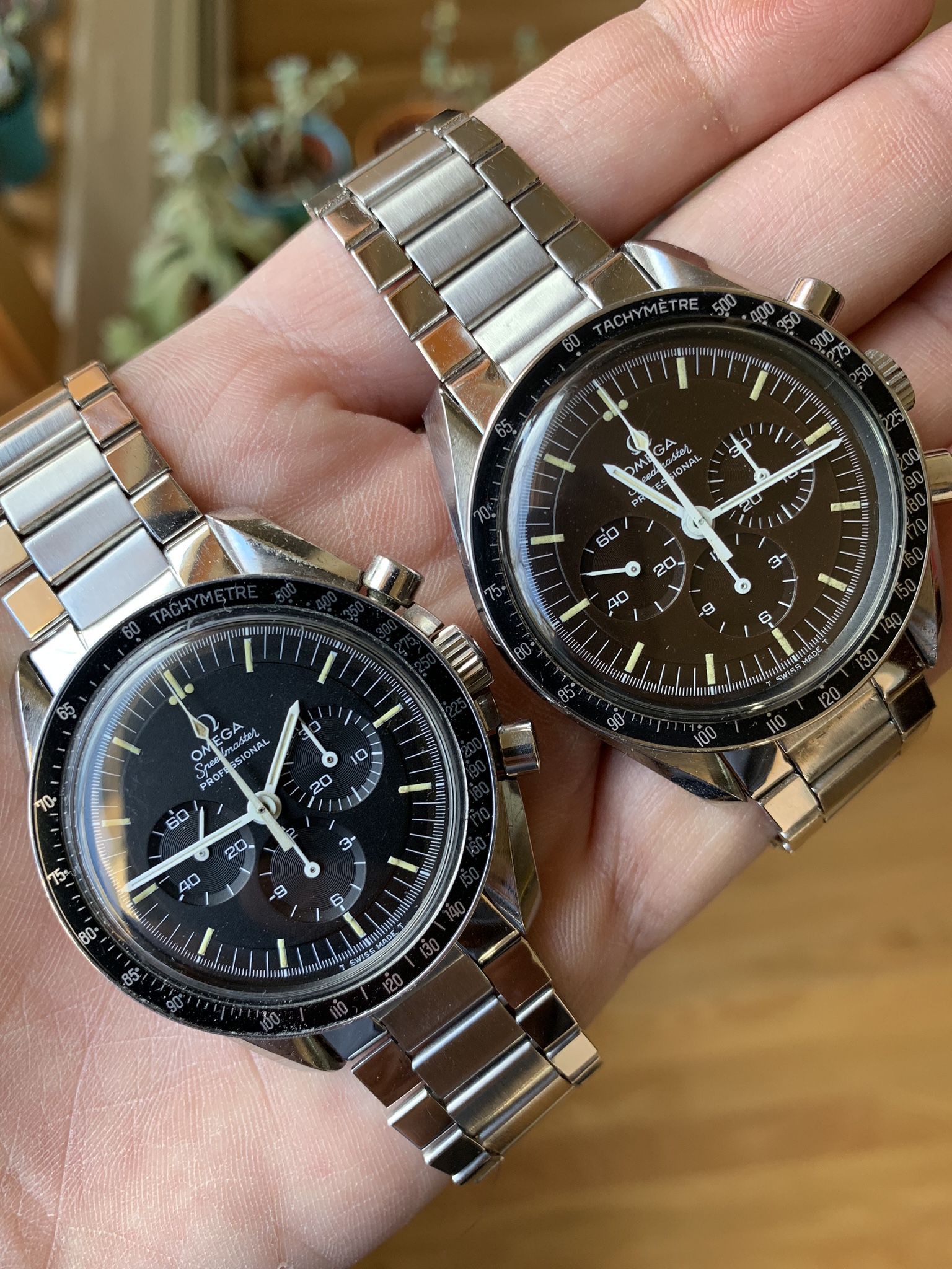

Just for your reference, here is a side by side comparison of a tropical.
521
980
Wow, nice watch.
Thank you for the comparison images.
It's a good reference.😀
