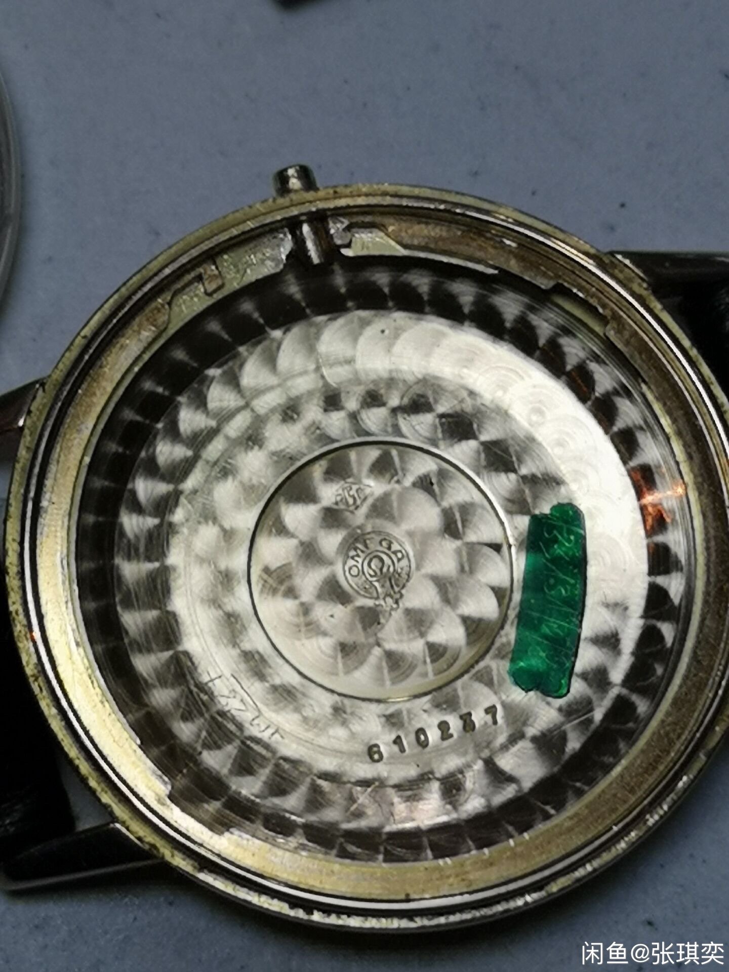

I’ve got this watch in 2019, the seller says this watch is 18k gold. I can’t find any hallmark for gold material, but I find something on the case back.
3,593
8,210
I believe that is the case makers mark, not a hallmark.
Agree, please give us a clear photo of the triangle (parallellogram?) inside the caseback and some good overall photos of the exterior.

Is there any information for the code 610237 which engraved on the case back?

Sure looks steel to me! If the case was karat gold, it would be marked inside the case back. Well, it’s not marked with a karat mark!

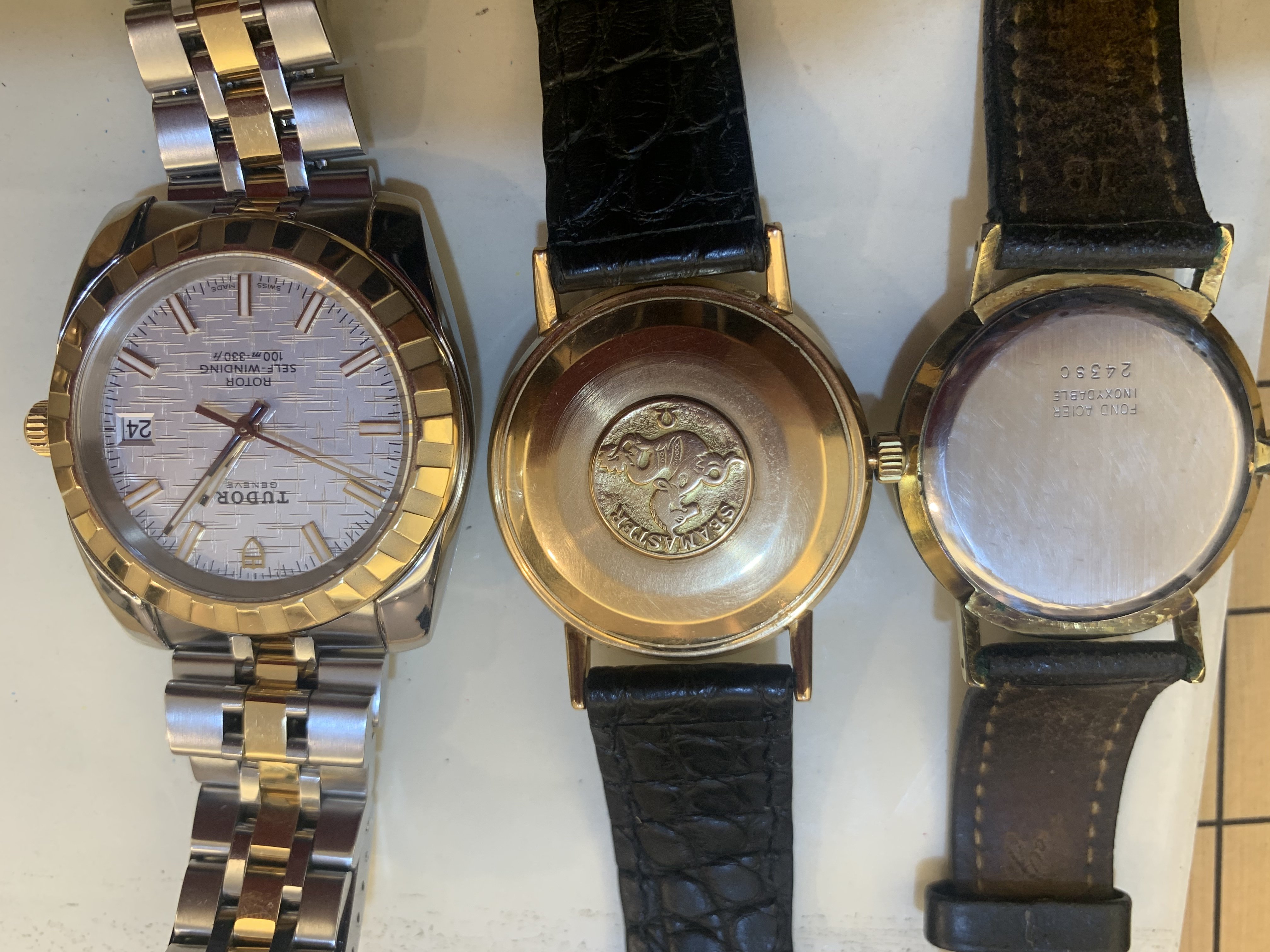

The omega is in the middle. The Tudor is steel/gold, the Jaquet Droz is steel/ gold filled. I think this picture is helpful to define the color.

The case serial number is not Omega model number. It's probably some French casemaker ref. number.
The Seahorse medallion looks strange.

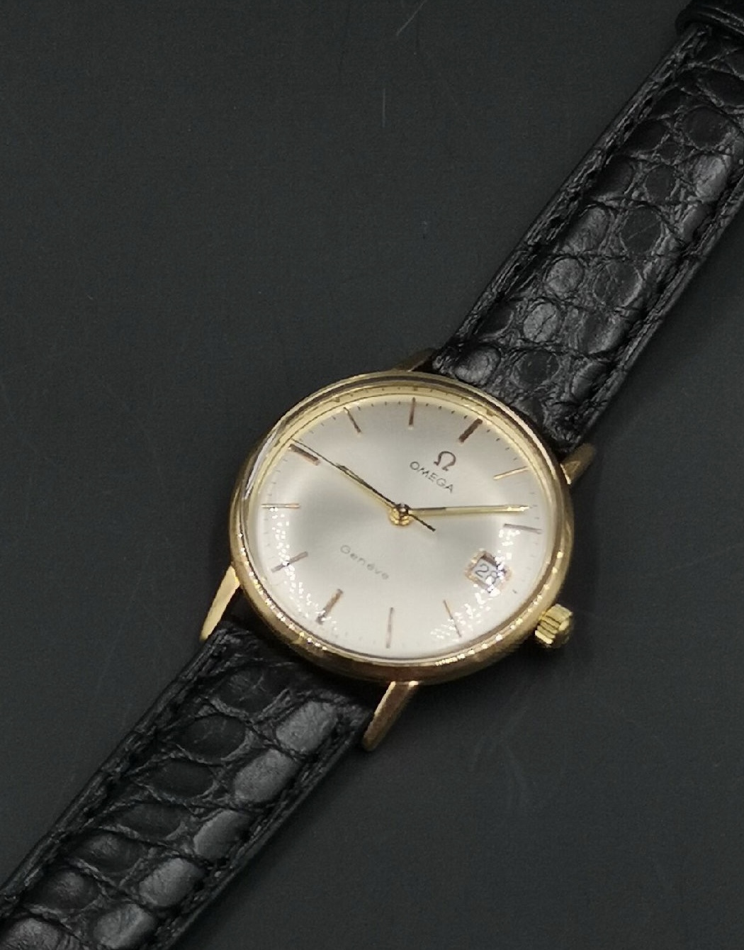

The dial is wrong to the case model. Having Seahorse on the back it should be Seamaster or De Ville dial but not Geneve one.

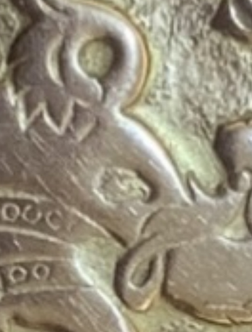

There is a French gold hallmark in the middle of the medallion!
You can see it very clearly in the photo of the three watches.
I don't think there necessarily is any issue with the dial, sometimes the model name on the dial doesn't match the caseback.
13,676
19,044
Yes, it’s there, but that’s a “Where’s Waldo” moment. Looks like 18K to me.
