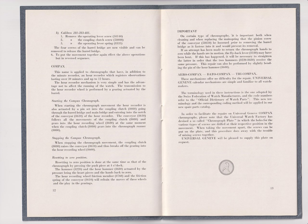

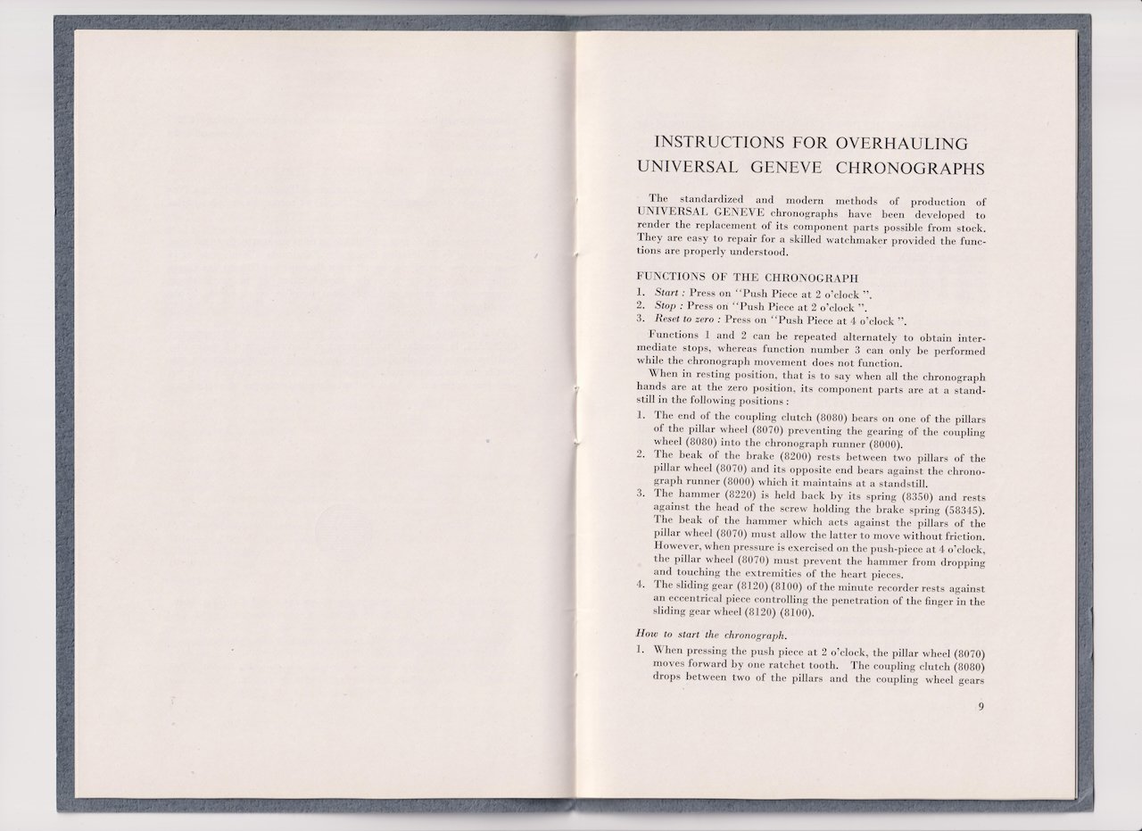

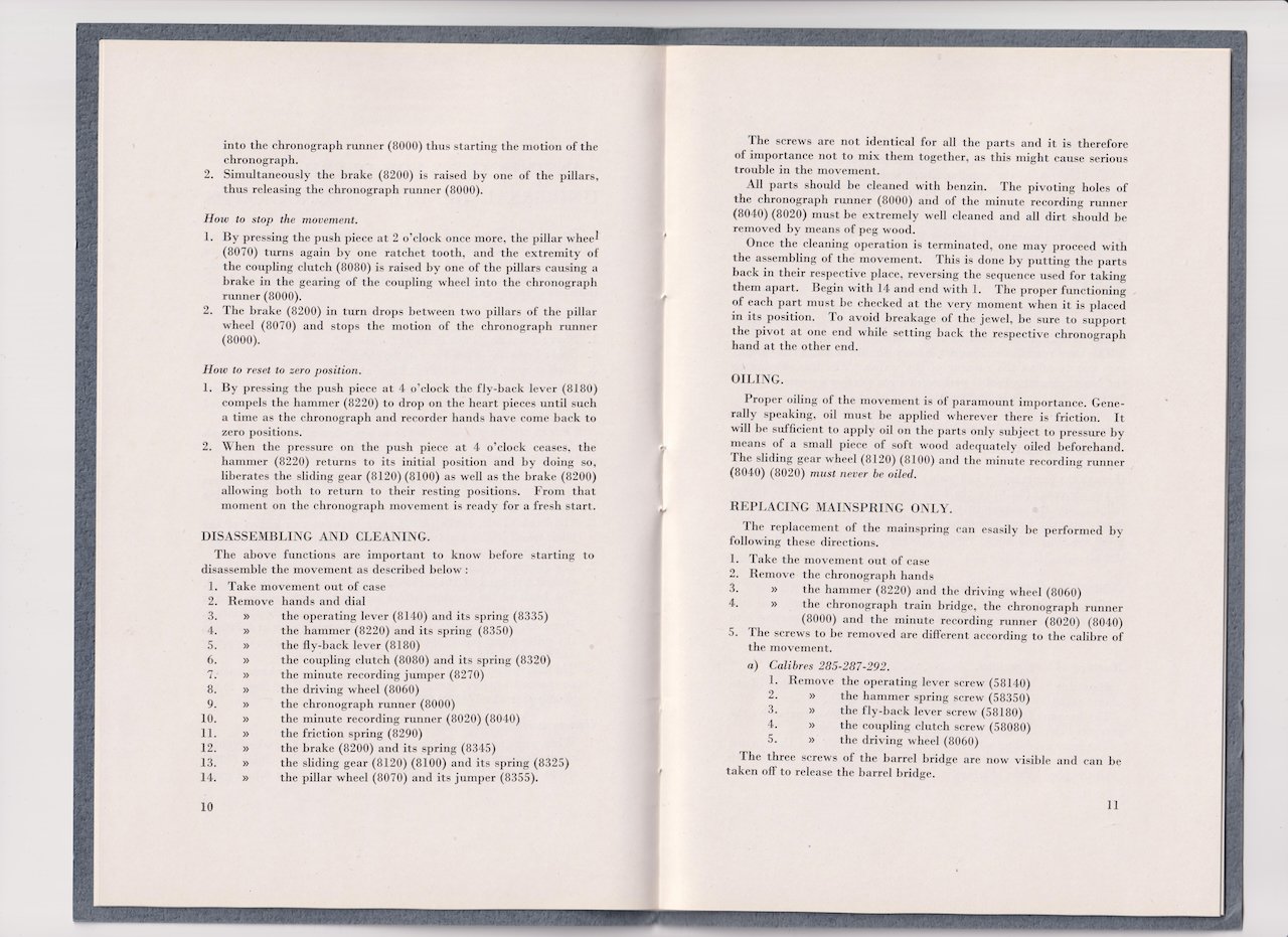

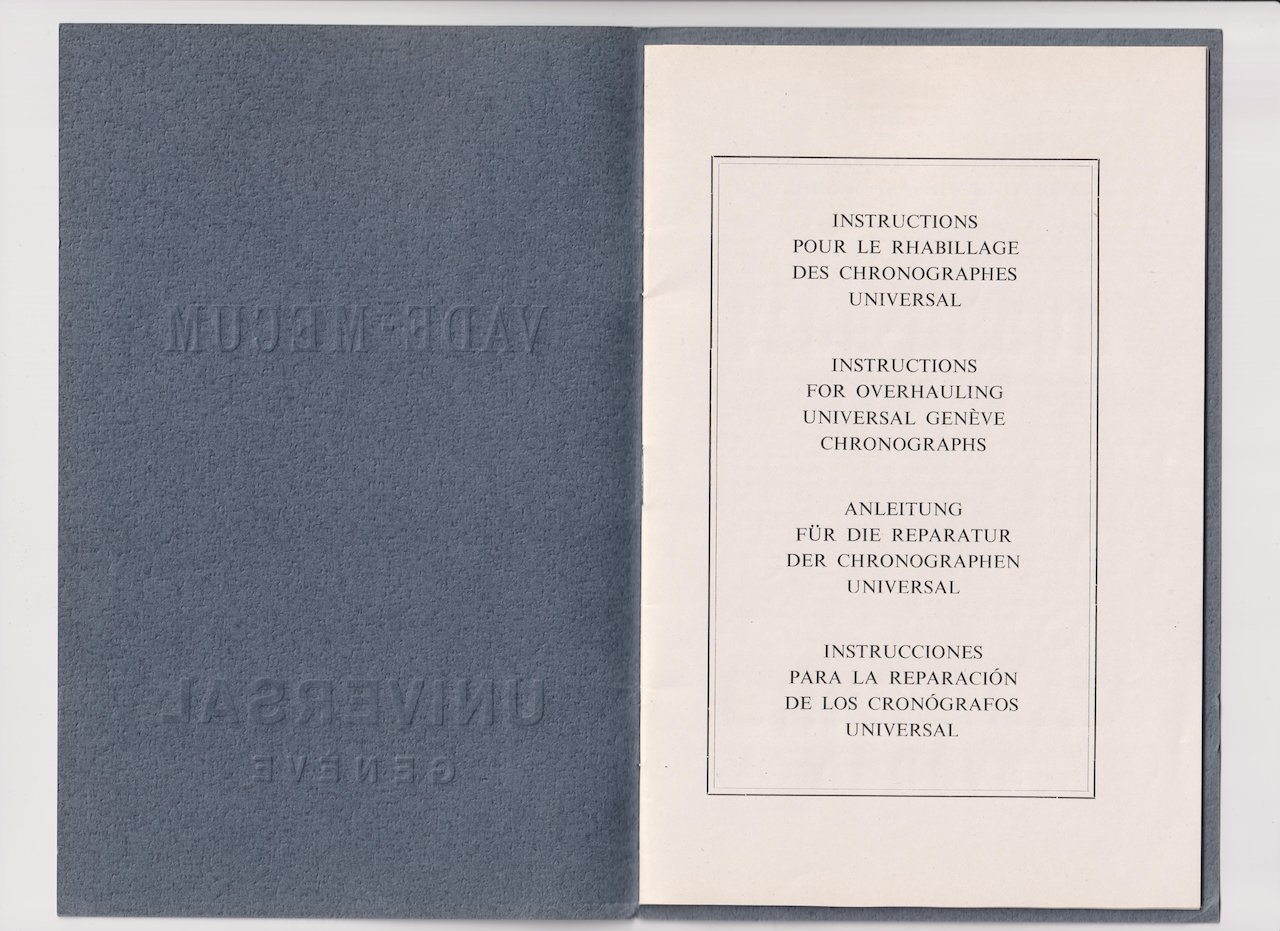

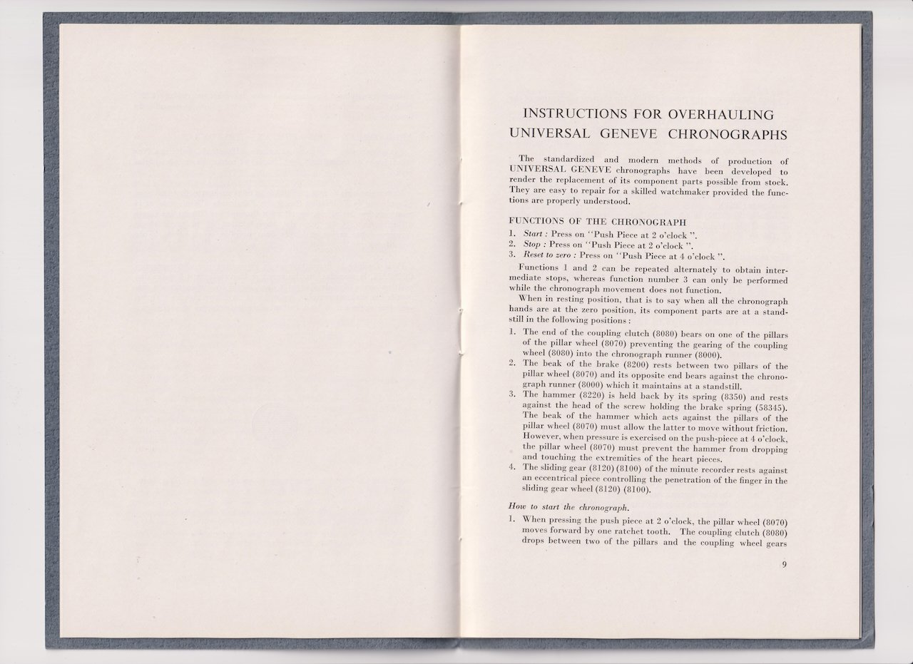

Instructions for overhauling Universal Genève chronographs
1,209
3,069
More reference material we came across whilst researching the Polerouter for our book.
