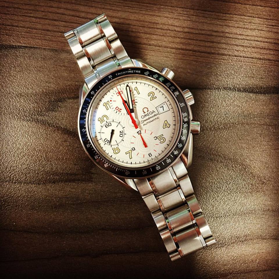

I had this version (which is supposedly Japanese market… but I’ve not seen anything that really confirms that one way or another). They also made a black dial version.

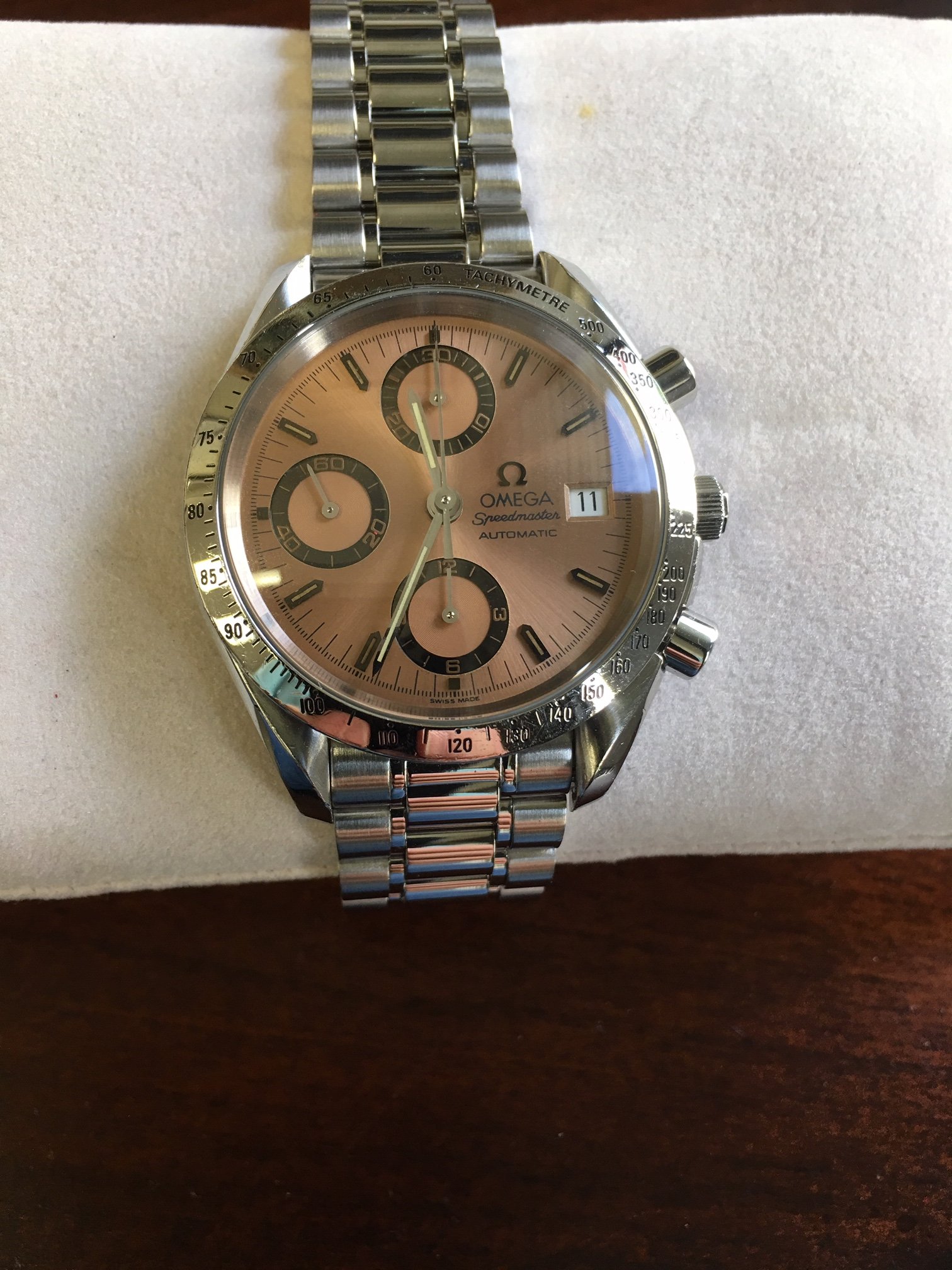

These are a few Japan market Speedy Dates
ST 175.0043
Speedmaster Automatic "Date" steel case with leather strap, white dial (3811.20) or pink dial (3811.60) and special edition for the Japanese market with yellow dial (3811.12.00) and burgundy dial (3811.61), then blue laquer dial (3811.81) since 1995
DP 175.0043
Speedmaster Automatic "Date", steel case with leather strap, rose gold bezel, special edition for Japanese market (PIC 3717.50)
DP 375.0043
Same as above but with bracelet , special edition for Japanse market (PIC 3317.50)
These and many more Japan edition are listed here, too. http://www.chronomaddox.com/omega/tables/mr/20050105_speedy_table.htm
