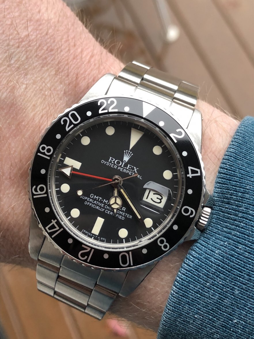

Thanks everyone for the help. Ended up attempting it myself and I’m glad I did because it turned out to be pretty painless and easy as many here stated.
I used an old drivers license inside of a zip lock bag to pop off the bezel as I was pretty concerned with scratching something. Initially tried a credit card but it was too thin.
Pic below! This is the fun part of the GMT for me. So many options for inserts!
