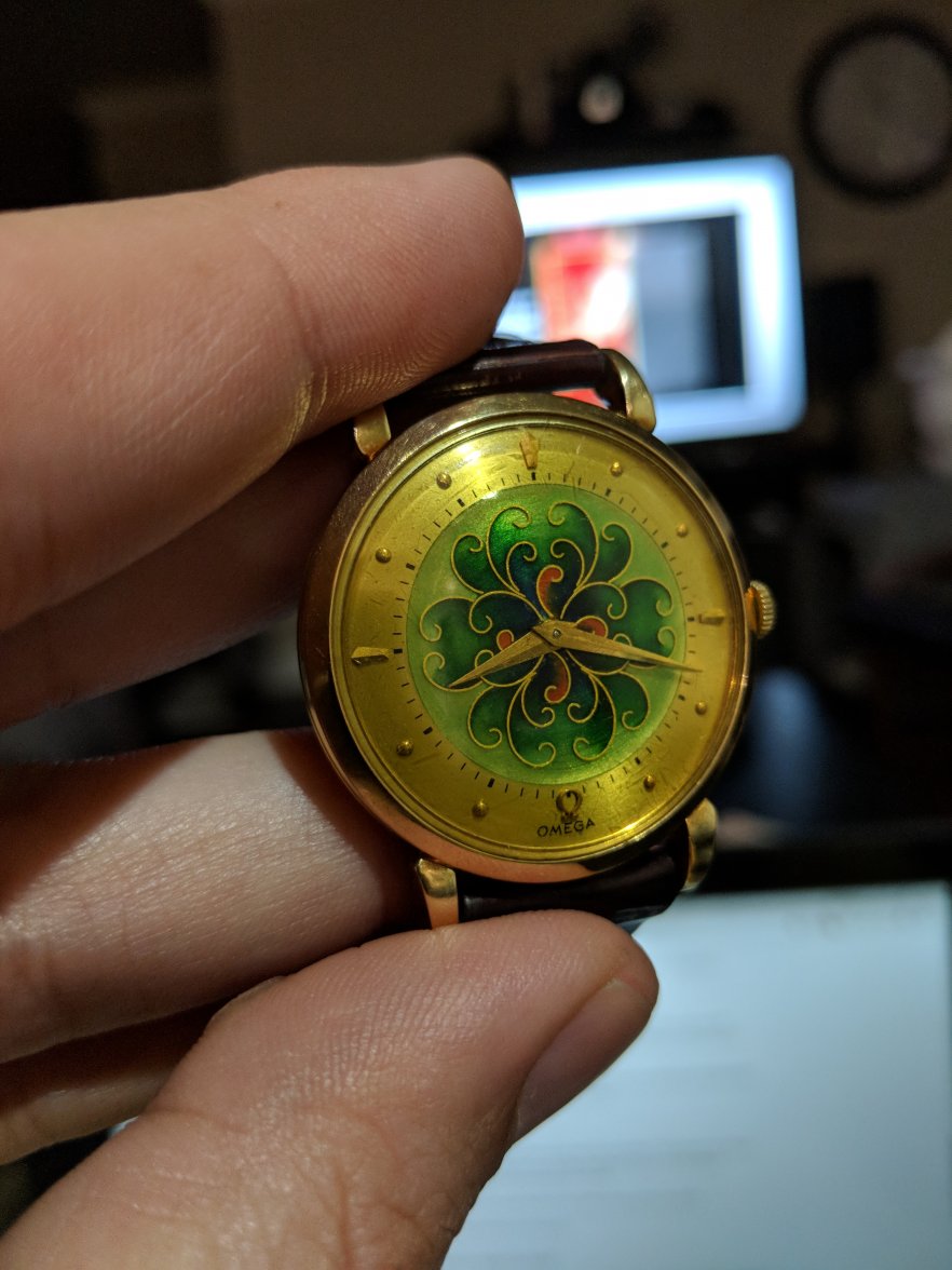

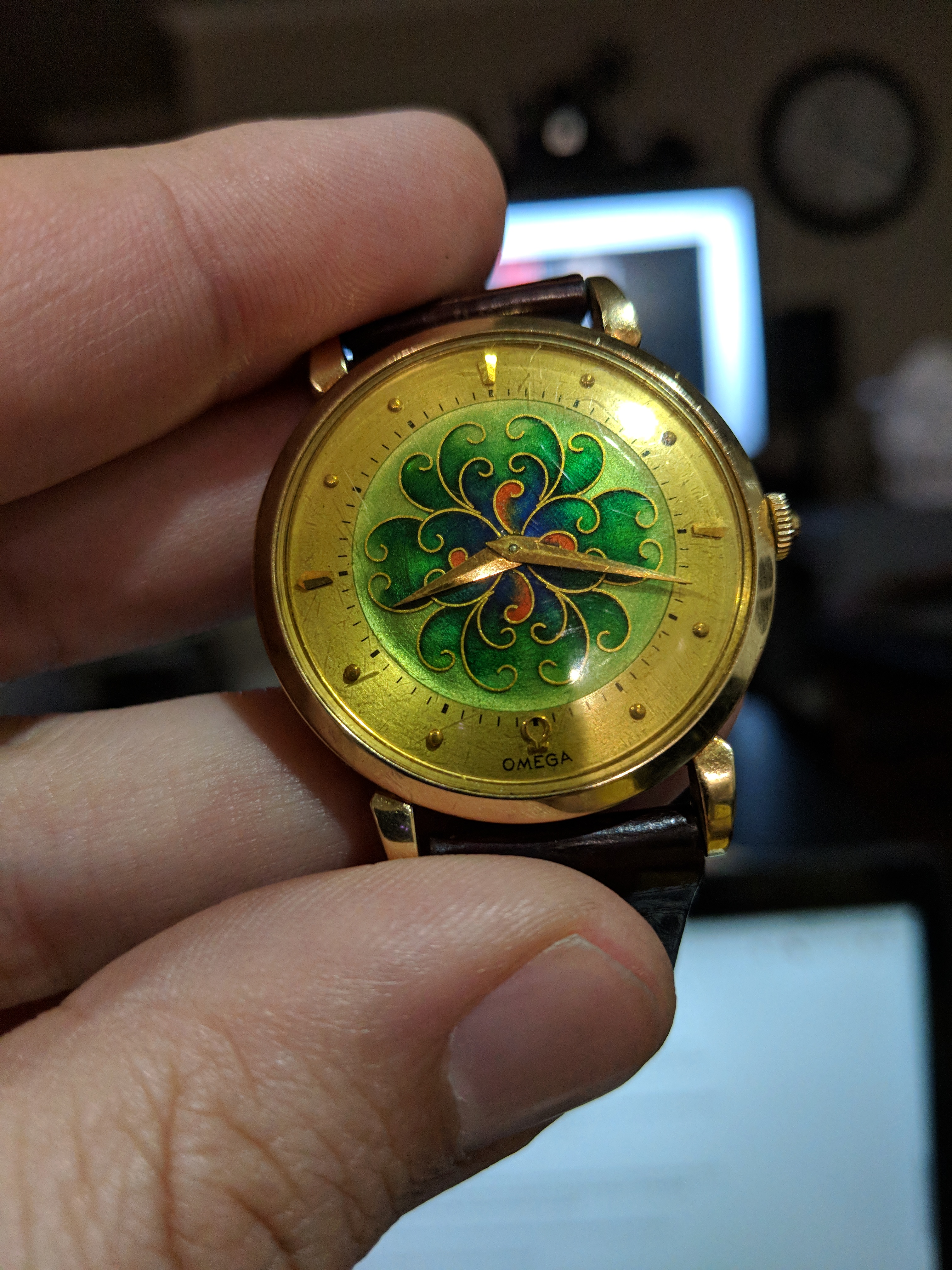

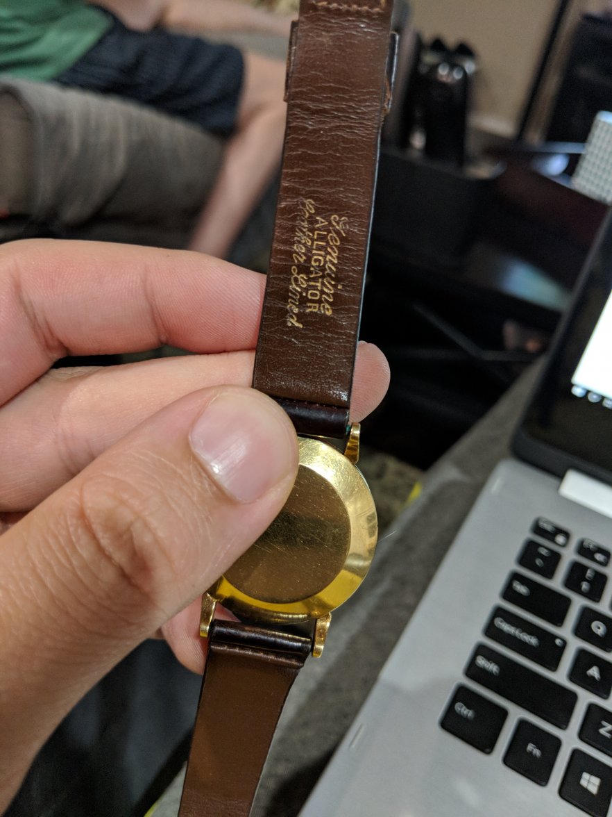

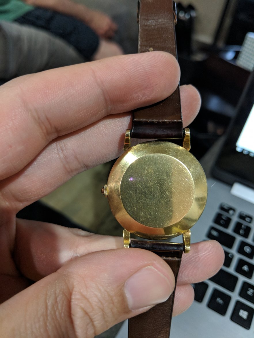

30 years ago my grandfather died and amongst the things he left me was a small watch that we all put away and didn't think of for years, when i found it recently i decided to find out what i could about it and it is turning into a difficult and unfruitful search.
the most relevant item i've seen is a couple of 1994 100 year anniversary watches that look the same as mine, and it seems that mine was perhaps made in 1954 based on information i could glean from those auction sites. (links included).
based on what i've found this seems to be a 1954 omega (1894 seems to come up often as a model or name also) cloisonne floral dial possibly crafted by stern freres. this is all helpful information but after scouring google i have yet to see or read about an example of this original watch, only the 1994 version. i'm trying to figure out any more information about it if i could. i don't think it is a replica, my grandfather was a watch maker in the 50s-60s and this was his prized/favorite watch.

Beautiful watch! It probably has a bumper 28.10 or 351 movement in it, although it's odd that it doesn't have a seconds hand. The enamel looks well done, so I hope it's the real deal. 😀

I'm a little worried about the pinched Ω logo and the OMEGA being flat and not curved, but will wait to comment about the originality until we have better pictures from several angles, including head on.

okay besides just sending the watch into omega to be cleaned up how should i find a good expert to take a look at the watch and tell me what i have, verify its authenticity and give me a rough value? Do i just need to google and call around? sorry for the dumb question but this just fell into my lap

I think it is the Real McCoy. Not the 1994 reissue, but the 1948 original!
It is listed in A Journey Through Time:
The above says it is Ref. 2482. The Omega information on this reference shows the movement as a bumper automatic cal. 342, that normally has a subseconds hand.
https://www.omegawatches.com/en-us/watch-omega-other-omega-dw-2482
Note the similarity in the lugs. I guess it’s a very simple matter to leave off the subseconds hand and cover with a solid dial. That would explain the lack of any seconds hand on this model.
The AJTT listing and the OP’s watch both have the unusual Omega symbol and dial lettering.
There was another one of these on our forum a couple of years ago.
image-jpeg.241829
https://omegaforums.net/threads/omega-2482.40457/
At that time, we thought it strange that the watch had no seconds hand. The AJTT listing solves that riddle for us. The dial markers are slightly different on the example immediately above, so maybe that’s just another variation without the Omega name.
Of course, the only way to tell for sure is a close-up examination and a view of the movement. I’m with the Squirrel on this one. Only a top notch watchmaker should touch this one. The value is that high.
I found this watch with a similarly pinched logo:
The one from the OP still isn’t a perfect match though.
