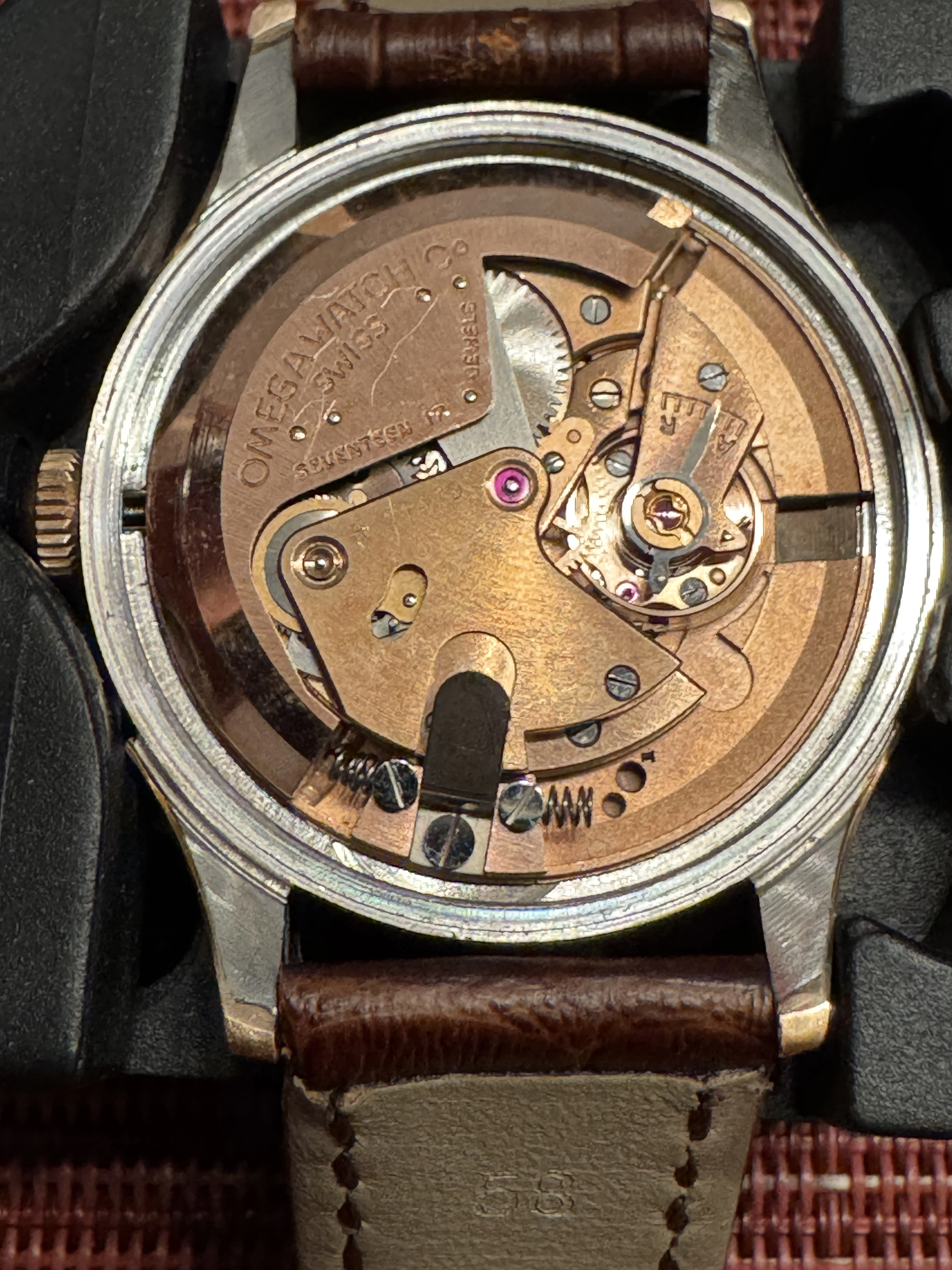

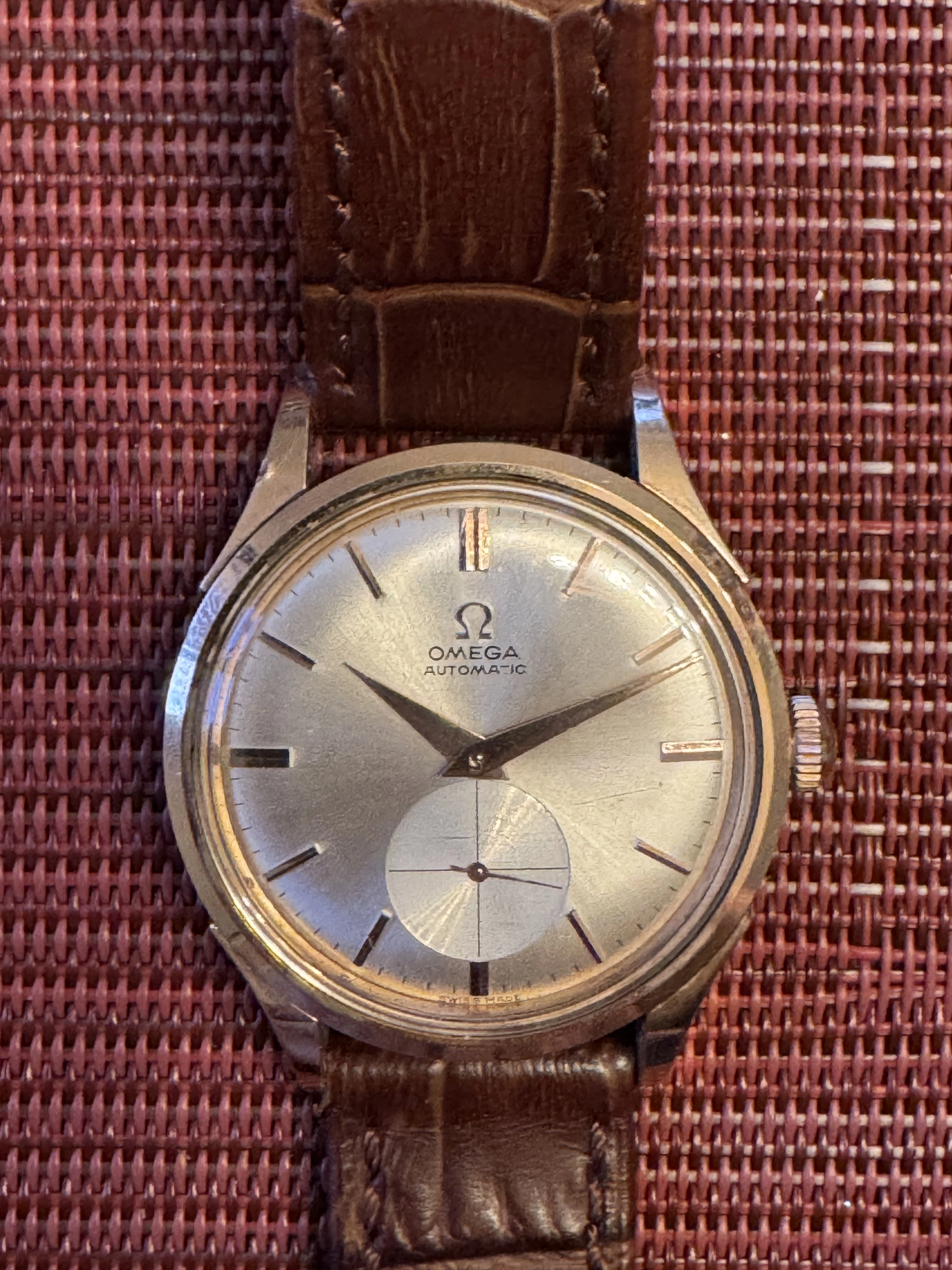

I found this 2638-4 years ago in a pawn shop and purchased it for a couple hundred dollars. Now I'm trying to learn a little more about it. I can't seem to find many examples that look like it, which makes me wonder if it's some sort of parts-bin watch, or if I'm just looking in the wrong places? Either way, I enjoy wearing it, but any clarification would be wonderful!

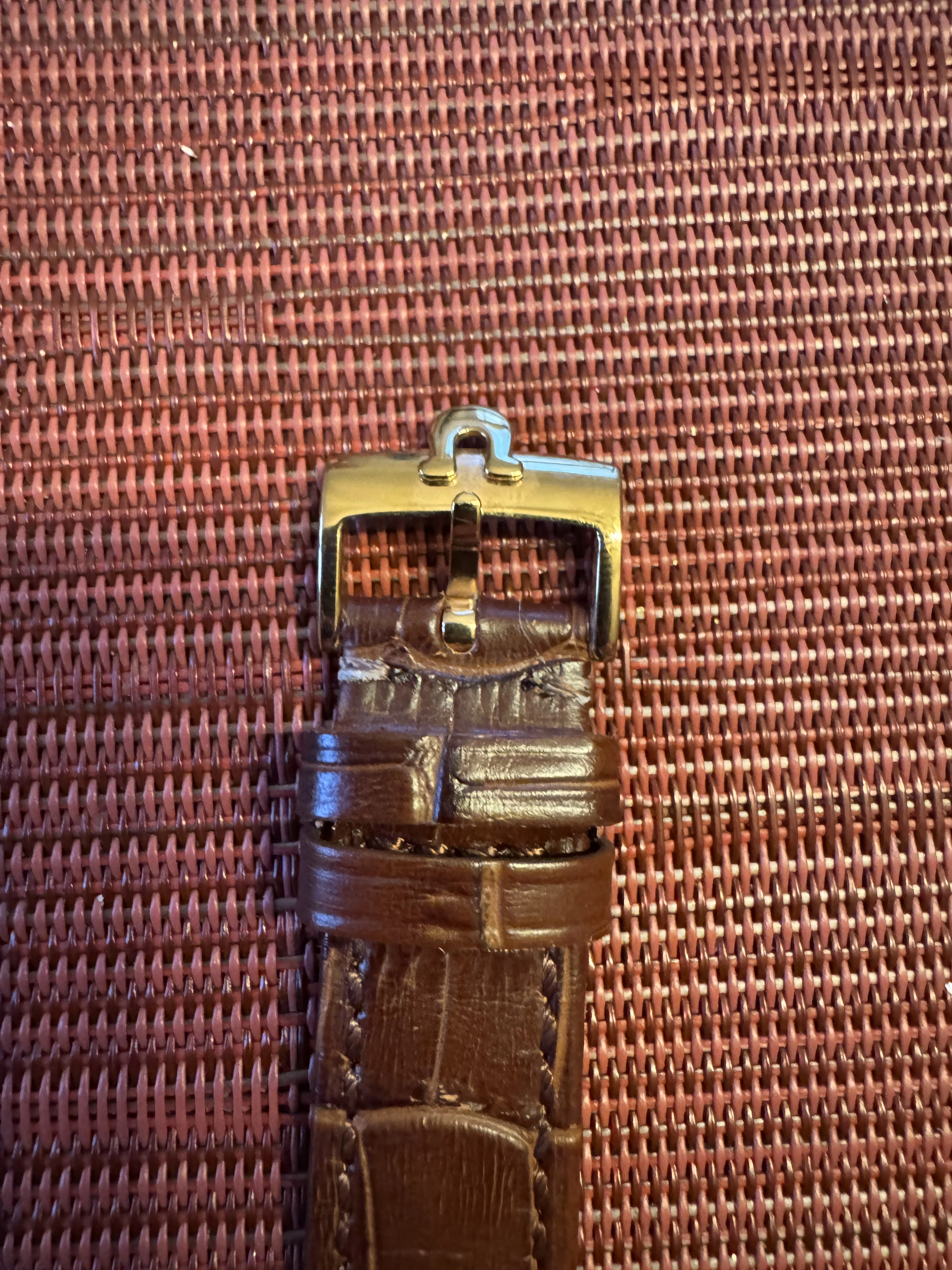

Looks ok at first glance, except for the buckle.

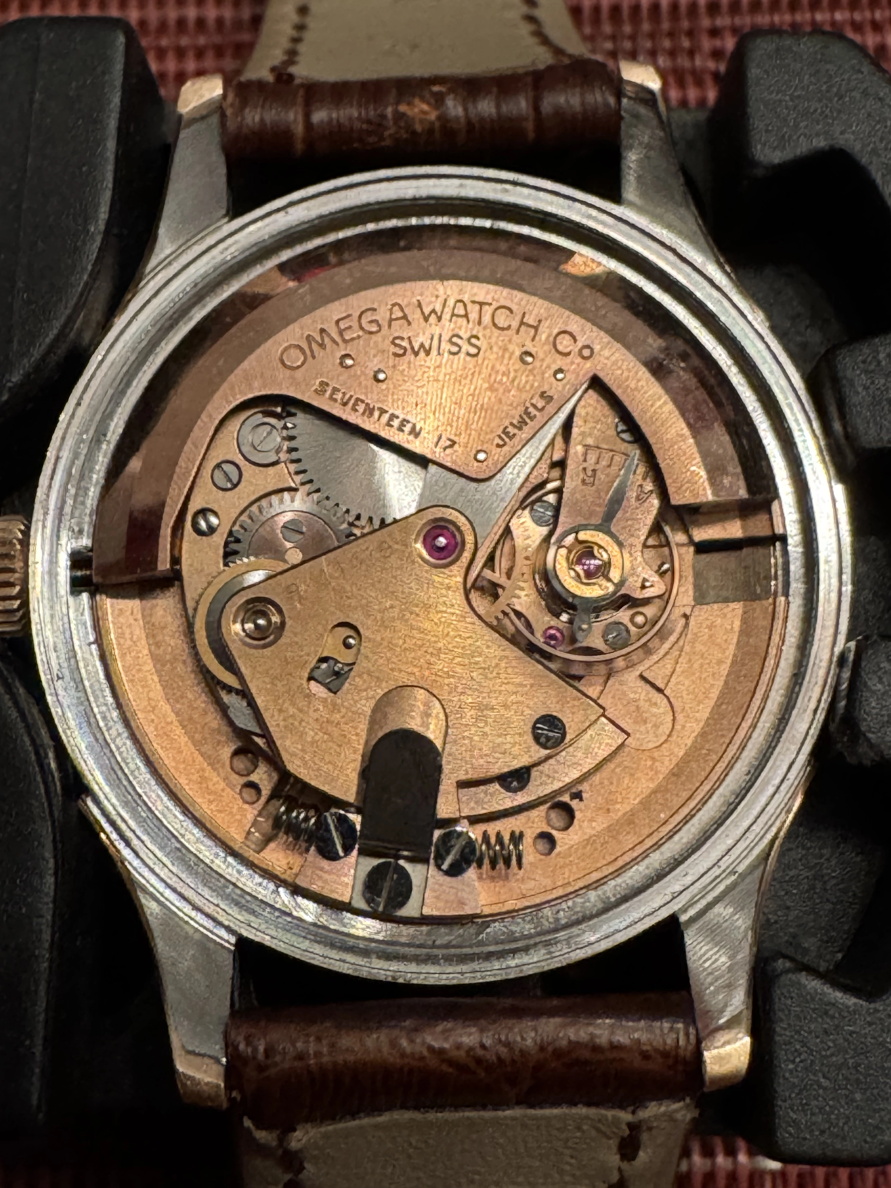

Nice watch and with bumper movement. What is cal and first 2 digits of SN? Must be early model around 1950?

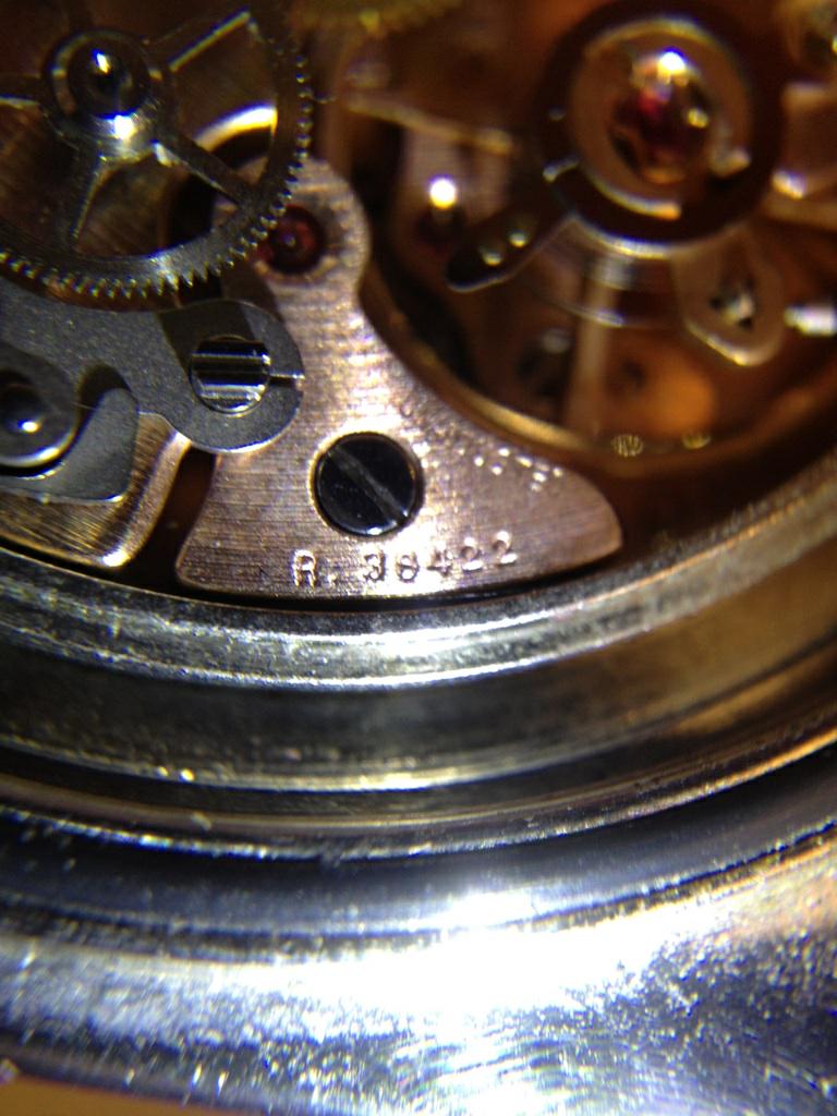

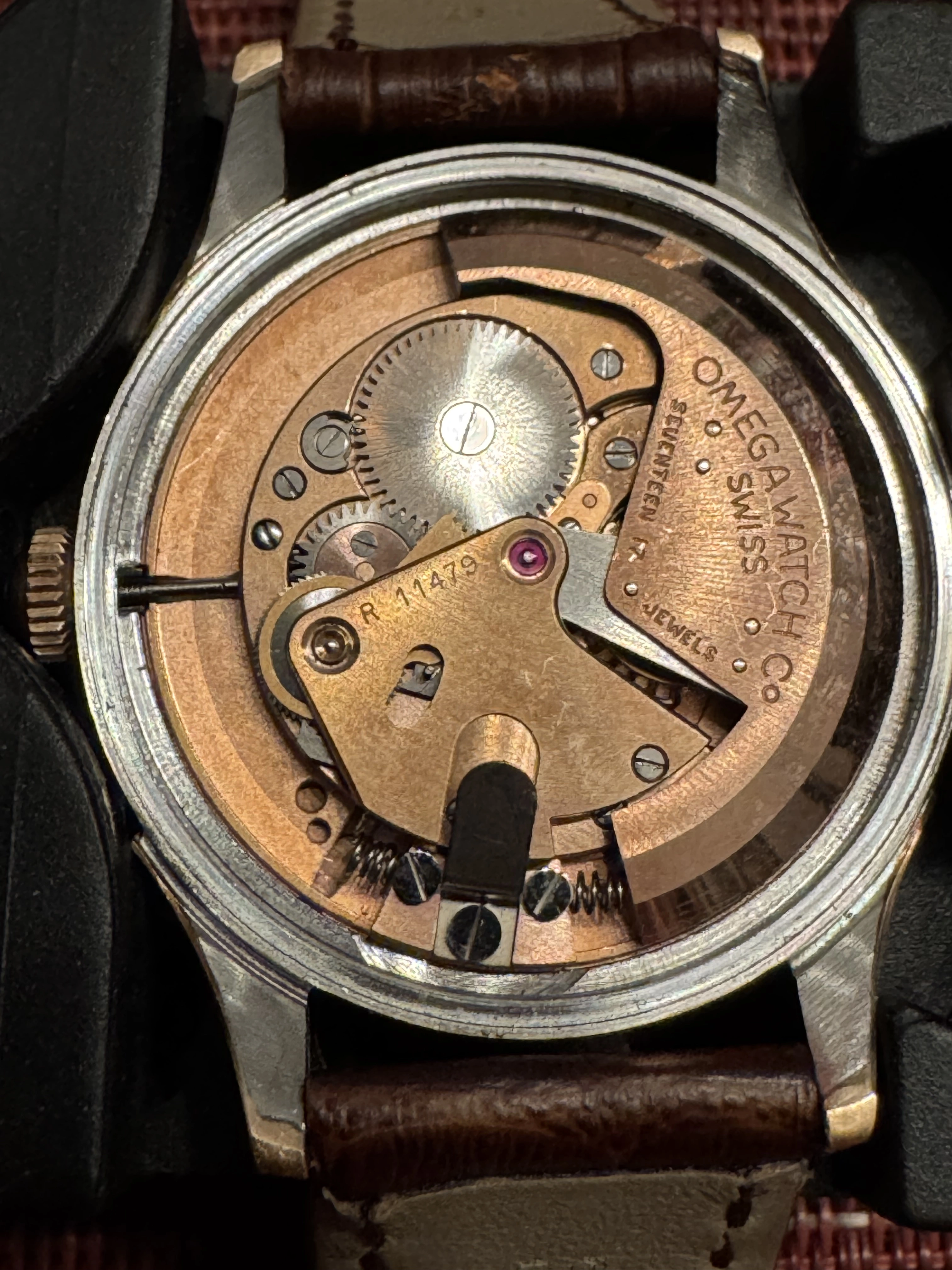

Hrmm. I'm having a hard time finding the cal and serial numbers. Normally the serial would be on the bridge, right? On this, I have the letter R followed by a five digit number. Wonder if that's a replacement piece and the original serial is gone?

It could be a replacement bridge. Did you try moving the oscillating weight to the other side?

I did, no tiny numbers.

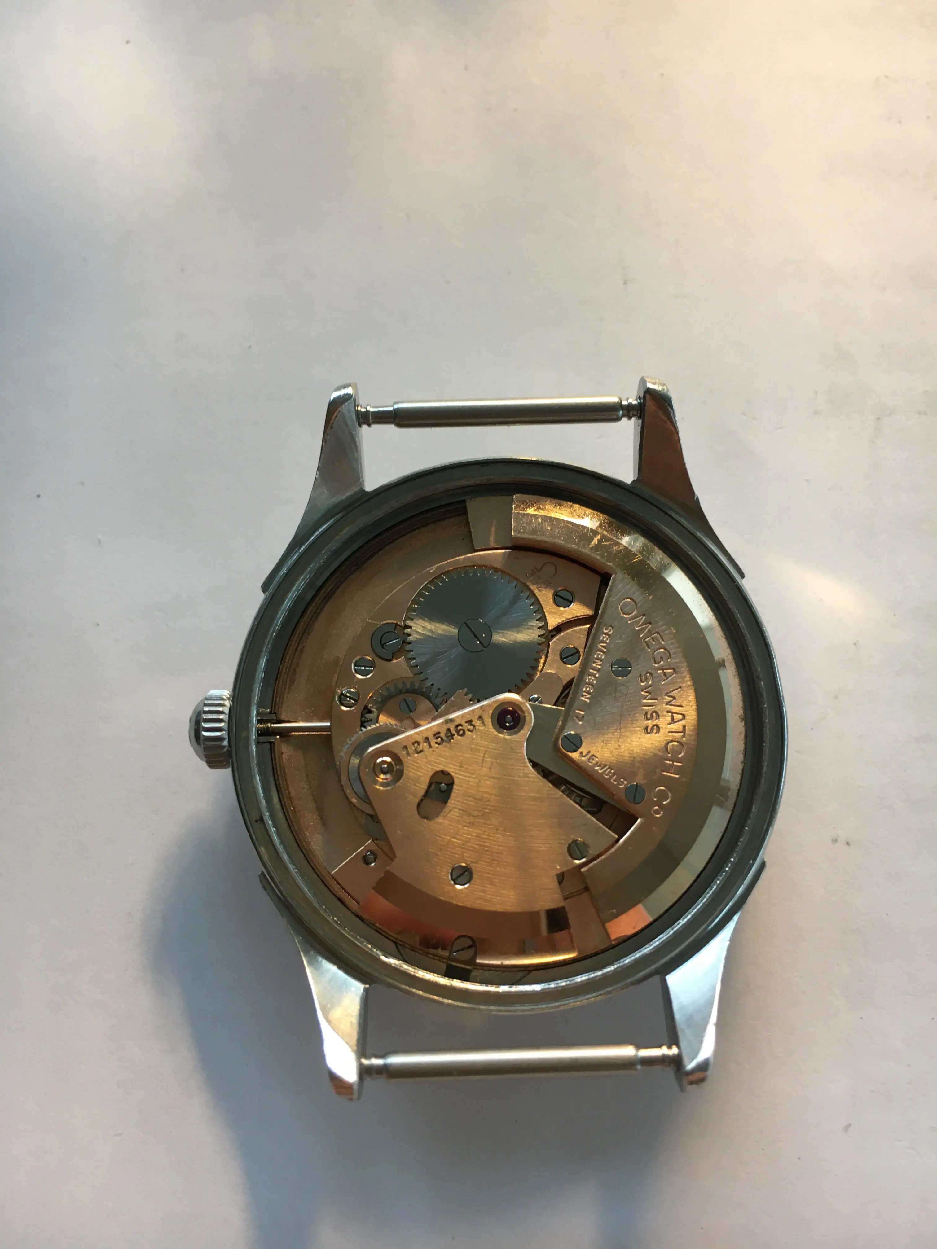

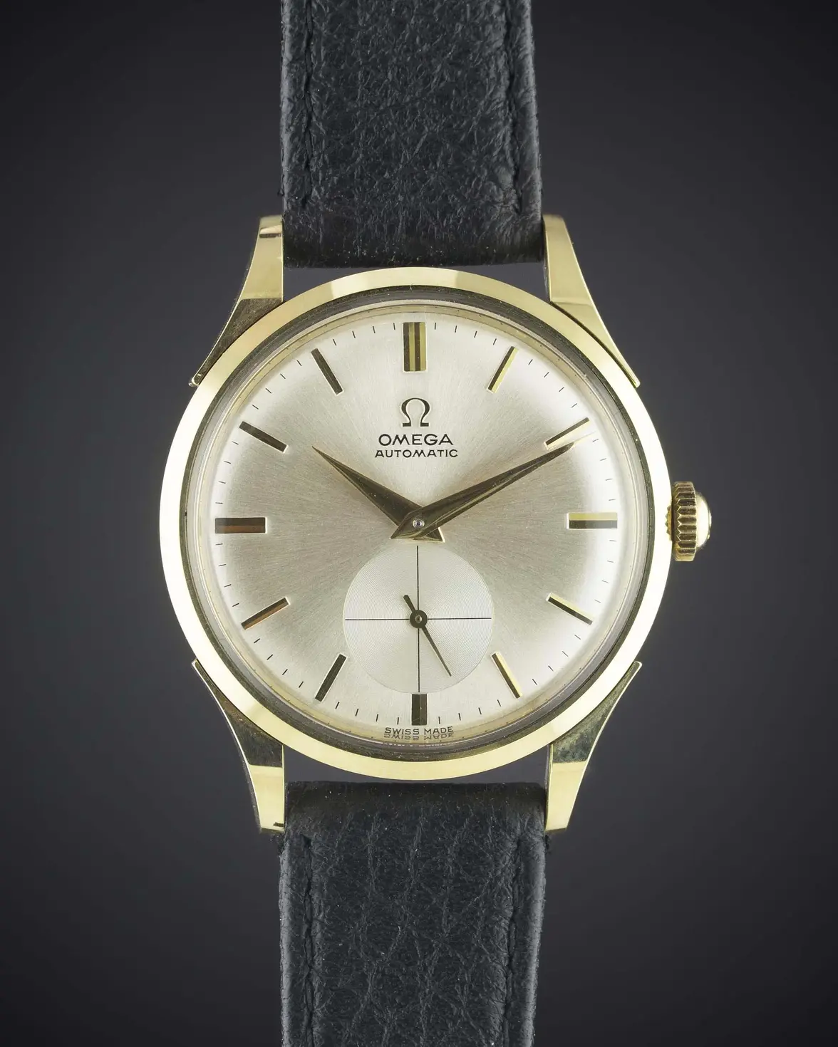

That's funny. You should be able to see the caliber, like from this sales thread.

It looks like someone may have scratched out the caliber number possibly?

That's a slightly different bridge piece than mine, but I'd still expect to see some numbers somewhere. 🤔 maybe a hobbiest-watchmaker did the service at some point as a project? Strange.

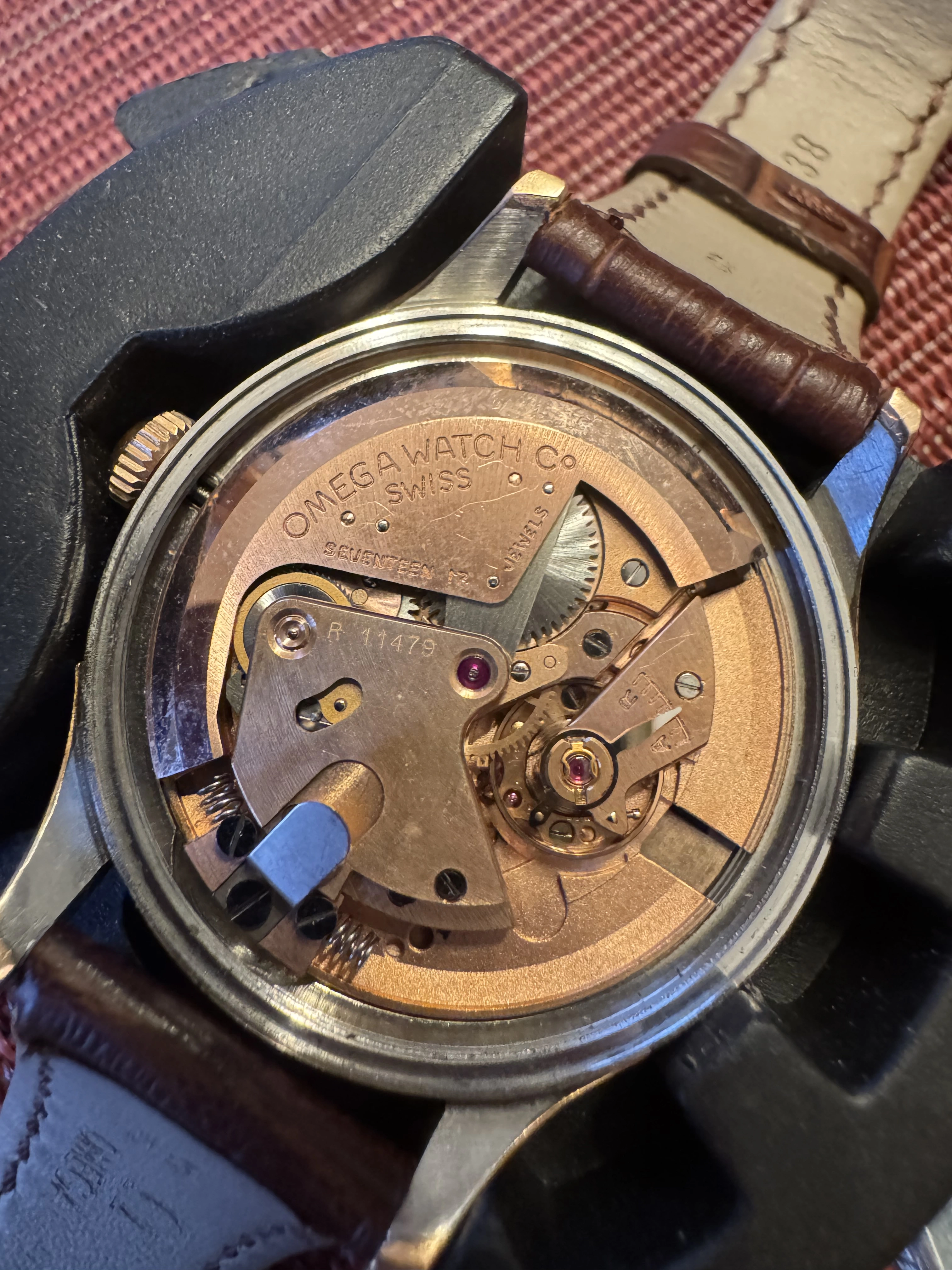

IIRC, there are two styles of bridges for these Omega bumpers, one with hidden springs and one with exposed springs. I don't recall which movements used which and/or when the transition was made. You could probably research that, if interested.

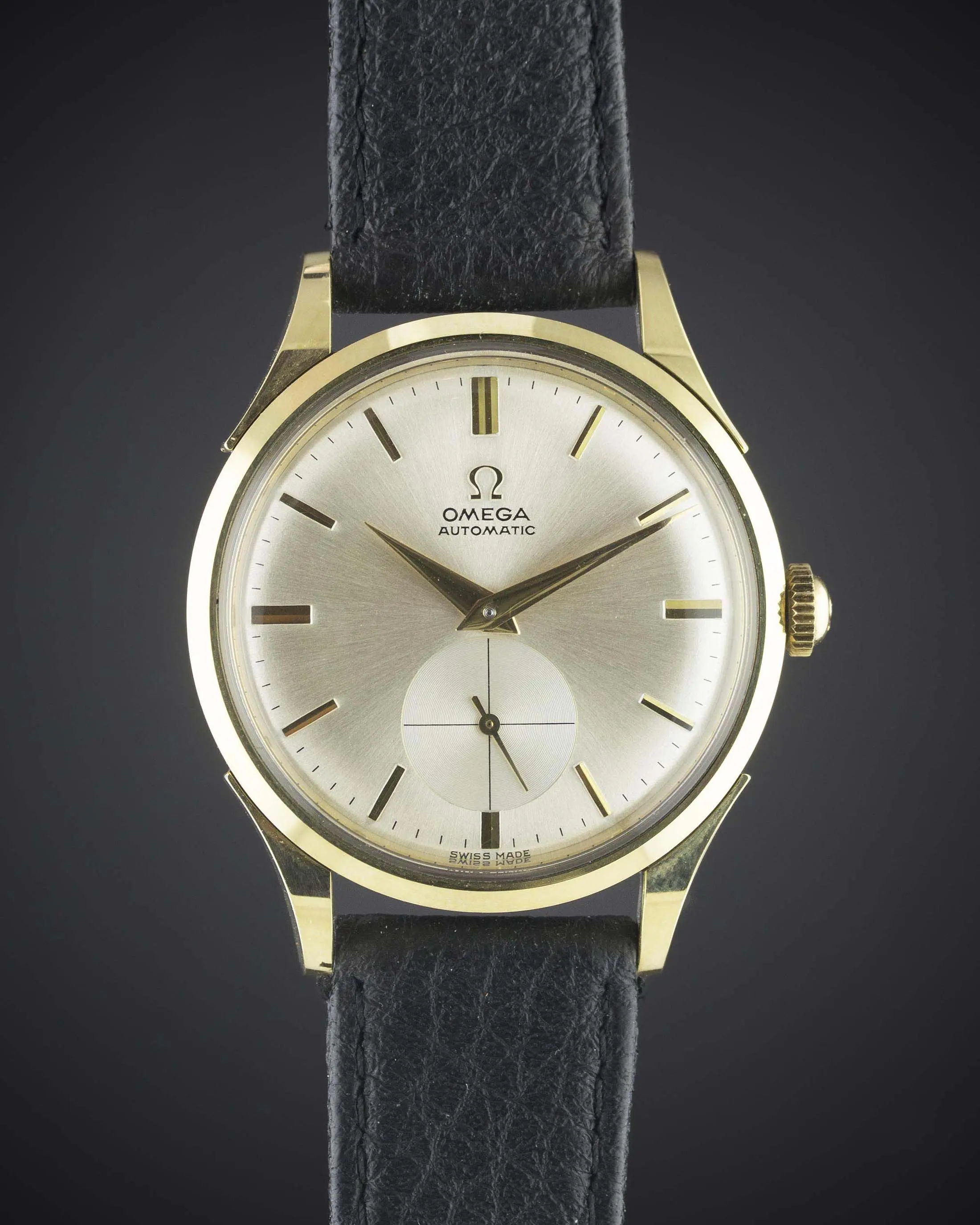

I am afraid this dial is either repainted or not original to the watch. This reference came originally with dials without this sunburst effect, which is more of a 60s thing.
Furthermore, the subdial looks very suspicious to me. I often see this kind of subdial on redialed watches.
Case and movement condition seem to be nice.

The dial looks like a pearl in person. It reminds me of a 60's timex I have in my collection, so that makes sense. That also explains why I've had such a hard time finding a related Omega in this time period.

I think the R before serial number indicates replacement part or replaced entire movement which may explain rubber out cal number. There was discussion on prior thread here.

So, I have a potentially-replaced or prototype face, and a replaced part or prototype movement. I've learned more than I expected. Thanks everyone!

We can speculate that the watch was badly damaged at one time and someone cared enough about it to pay for a full restoration with replacement parts. 😉
