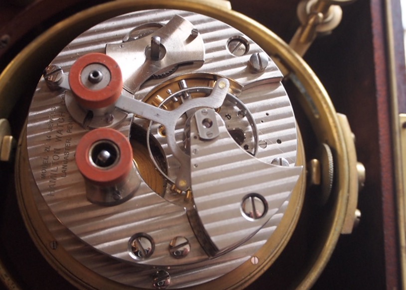

    You are indeed fortunate! Beautiful chronometer. Many of these had a yoke to secure the balance wheel added at a servicing. It eliminated the need for “corking” the balance wheel during transport. It shows in the picture of mine. There is a screw called a “stop-up” screw which was built into the model 21 chronometer by Hamilton. This screw was used to block the train wheels for transport. This screw was often removed during service. Yours still has this screw.

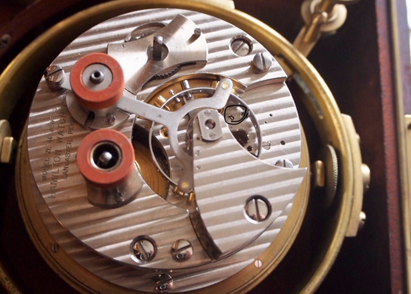

    I have posted another picture of my 21 with the stop up screw circled. Typically, at a time when these chronometers were serviced and the yoke added, the stop up screw was left out upon re-assembly. Mine came to me without the stop up screw, and I wanted to fit one. Larry Crutsinger has parts for these, so last time I serviced mine, I bought a screw from Larry, and fitted it. Care must be used in deploying this screw. It should project downward between two spokes of a train wheel. If it come down ON TOP of a train wheel spoke, you can snap off a pivot. That is possibly partly why many of these screws were left out.

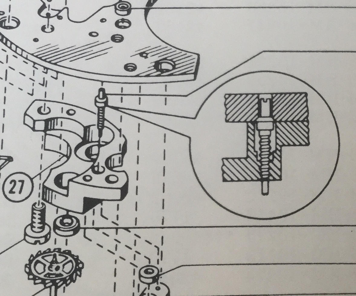

    The stop up screw was often left out when the yoke was added. The part number is 42247, and it is shown on page 466 of Whitney’s book on the chronometer. See image.

    Thanks a lot on that stopping screw info. When I got it today I pulled the corks winded it set the time going forward with the hand never backward or damage can happen gave it a gentle shake and she would not run. I looked between the plates and what did I see a screw between one of the gears got a jewelers screw driver raised it and she ran like a champ. Wonder if the seller thought it was broke why it was cheap and thought I was a sucker looks like I won. Photo of stop screw can't thank you enough for schooling me.

    I am glad I mentioned the stop up (train blocking) screw. Be certain the screw is all the way up, and when it stops turning, give it an extra “snug” to make certain it doesn’t work its way down again. And it you ever use it to block the train in future, make absolutely certain it drops down between the wheel spokes where it was when you discovered it! It should NOT come down on top of a spoke.

    Take a look at the enlarged inset of the stop up screw in the image I posted from Whitney’s book. You will see that the stop up screw fits between two plates, and can be (and should be) unscrewed until it butts up against the plate that fits over it. It is specifically designed to allow you to unscrew the screw until it stops turning.
