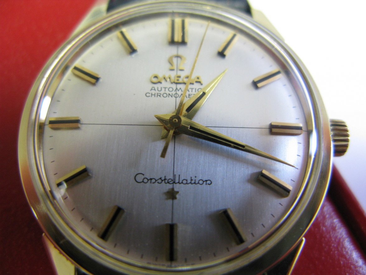

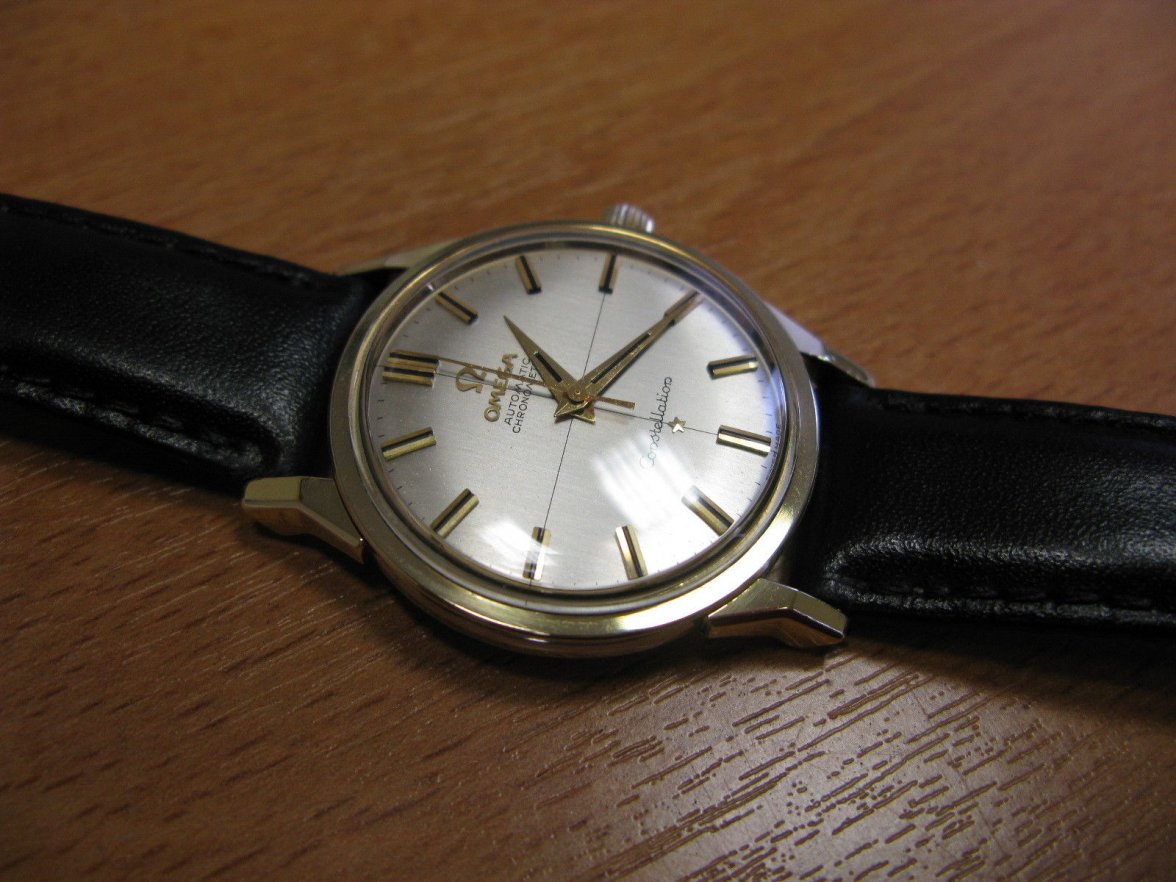

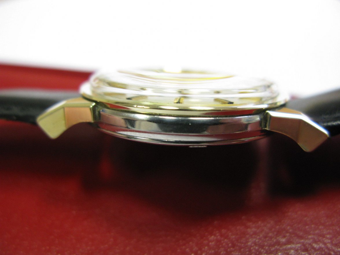

    Its a two tone gold capped 551 with dog leg lugs, crosshairs but non pie pan dial, I'm not as crazy about the pie pans as everyone else seems to be, but i do love the crosshairs.
    The things that worry me are.

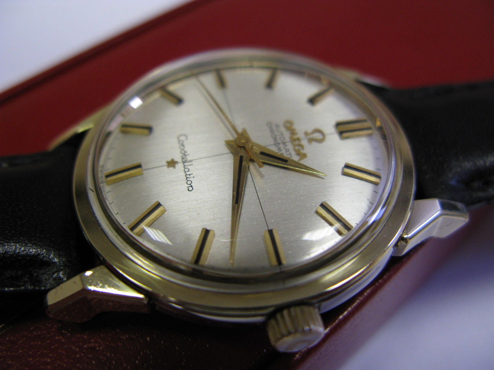

    1) Are the lugs the correct shape for the case? I thought the underside should be more chamfered.

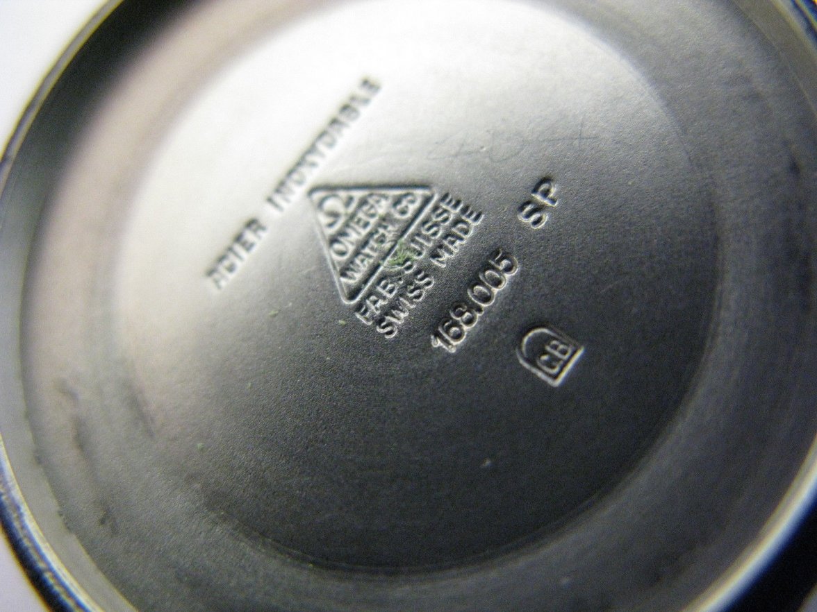

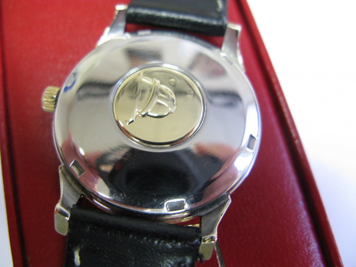

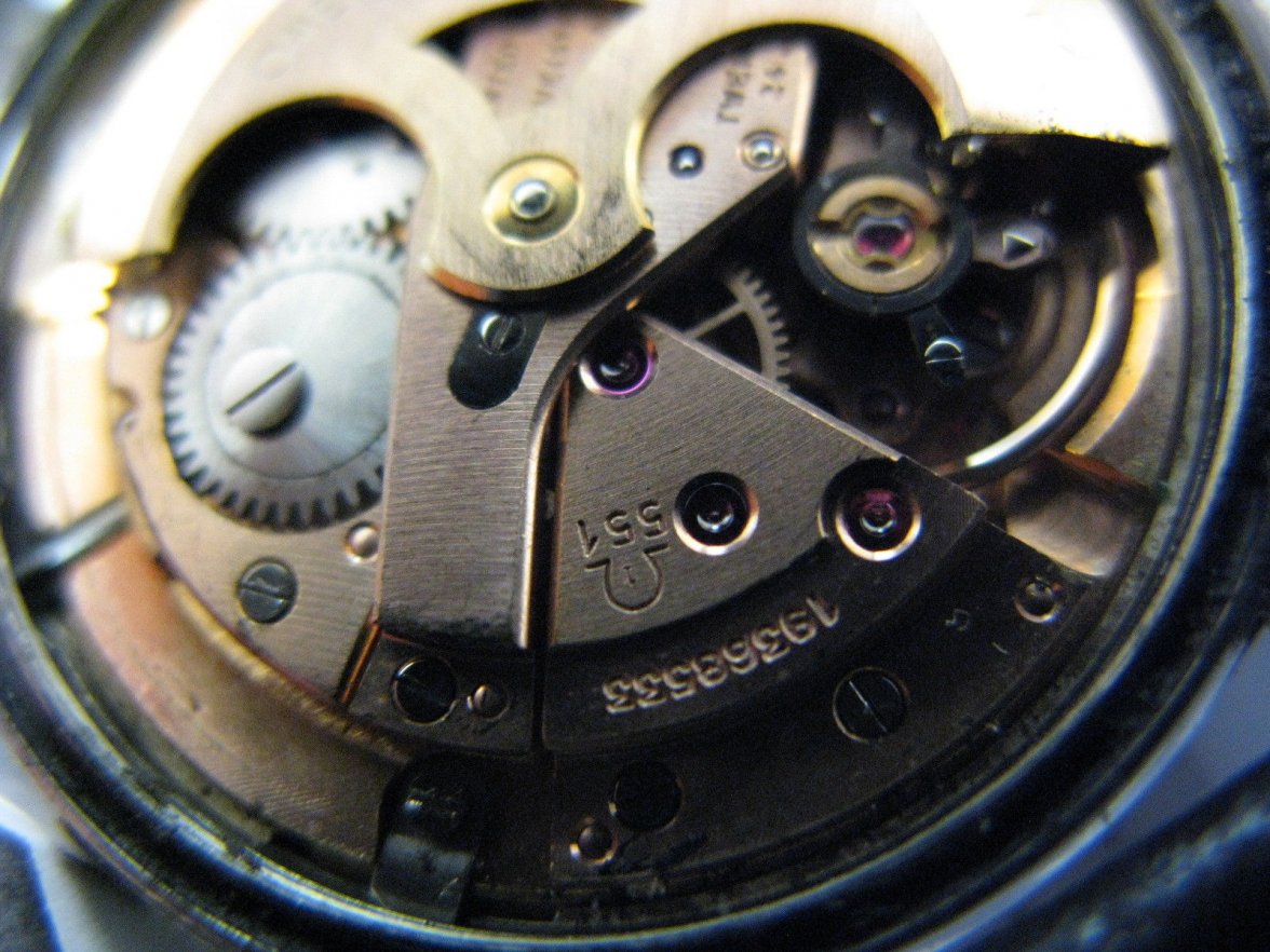

    2) The inside of the case back is stamped 168.005 SD. After searching this reference i came back with a pie pan dial date model with the later 564 movement. Also the back looks quite new and doesn't have any machined swirling that i would have expected from a Constellation of this era.

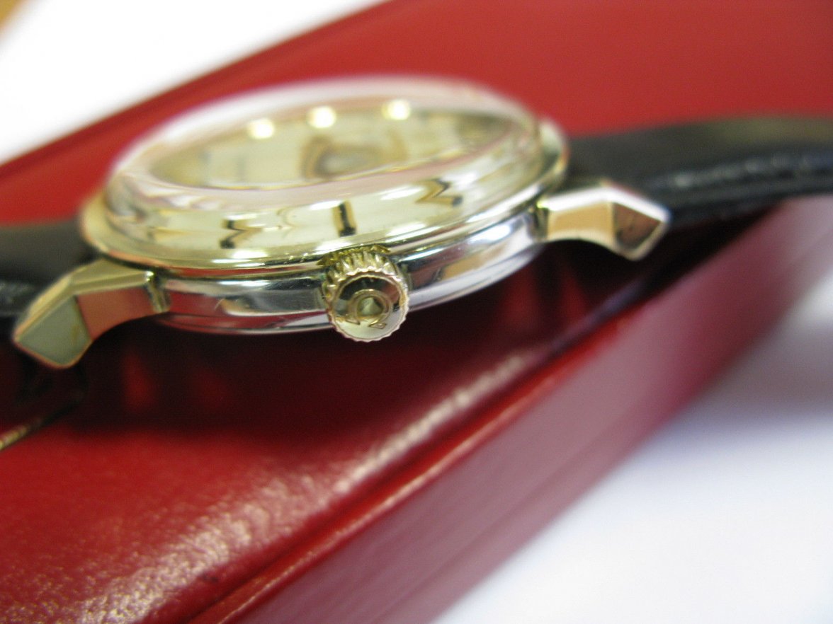

    3) Is the crown original or should it be a 10 sided one?
    I've added pics to make it easier to access, the price is £695 or about $900. $_57 (1).JPG $_57 (2).JPG $_57 (3).JPG $_57 (4).JPG $_57 (5).JPG $_57 (6).JPG $_57 (8).JPG $_57 (7).JPG $_57.JPG
    Anything else anyone can add would be greatly appreciated.

    how many stars are you counting on the backside? ;)
    Boudica likes this.
  3. Boudica May 29, 2016
    10
    Ah I've just realised that they have stars on the constellations, I really am new to this vintage game... Do they all have this as a 100% rule?
    There does appear to be on spot type thing.
    Could you enlighten me to the meaning of this marker? Is it a franken watch with a different case back or just a outright after market copy?

    The gold capped cases all have lug shape like that.

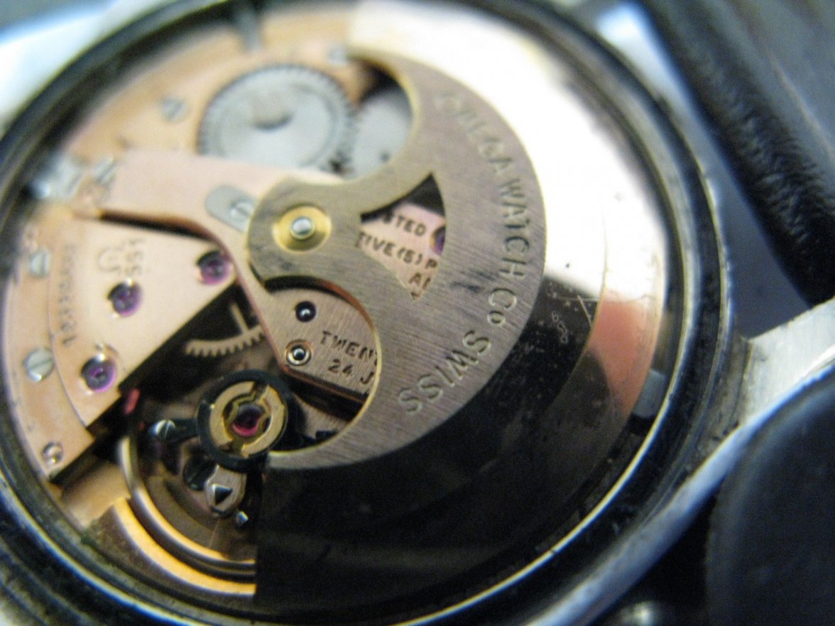

    It's either wrong case back for the watch, or wrong dial and movement for the case. Both are franken.
    The original has been discontinued. It had usability issue anyways.
    Boudica likes this.

    Those lugs are pretty much exclusive to these Constellations. With luck and patient, you can find an all correct one in decent condition for about the same price. With different lug styles, many other vintage Omega good capped models can be had for much less. Many other Swiss brands also cost less as well, like Longines...
