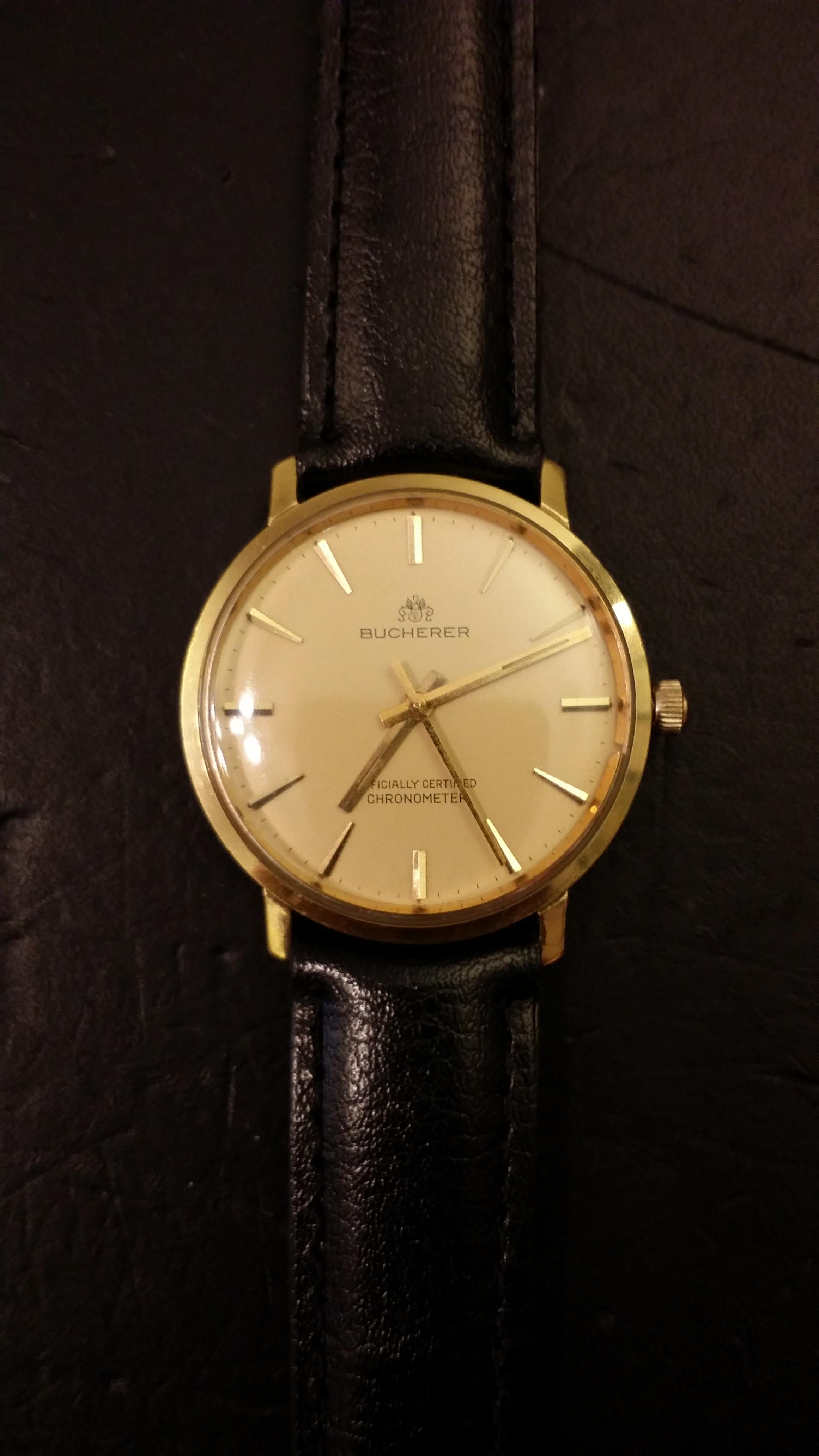

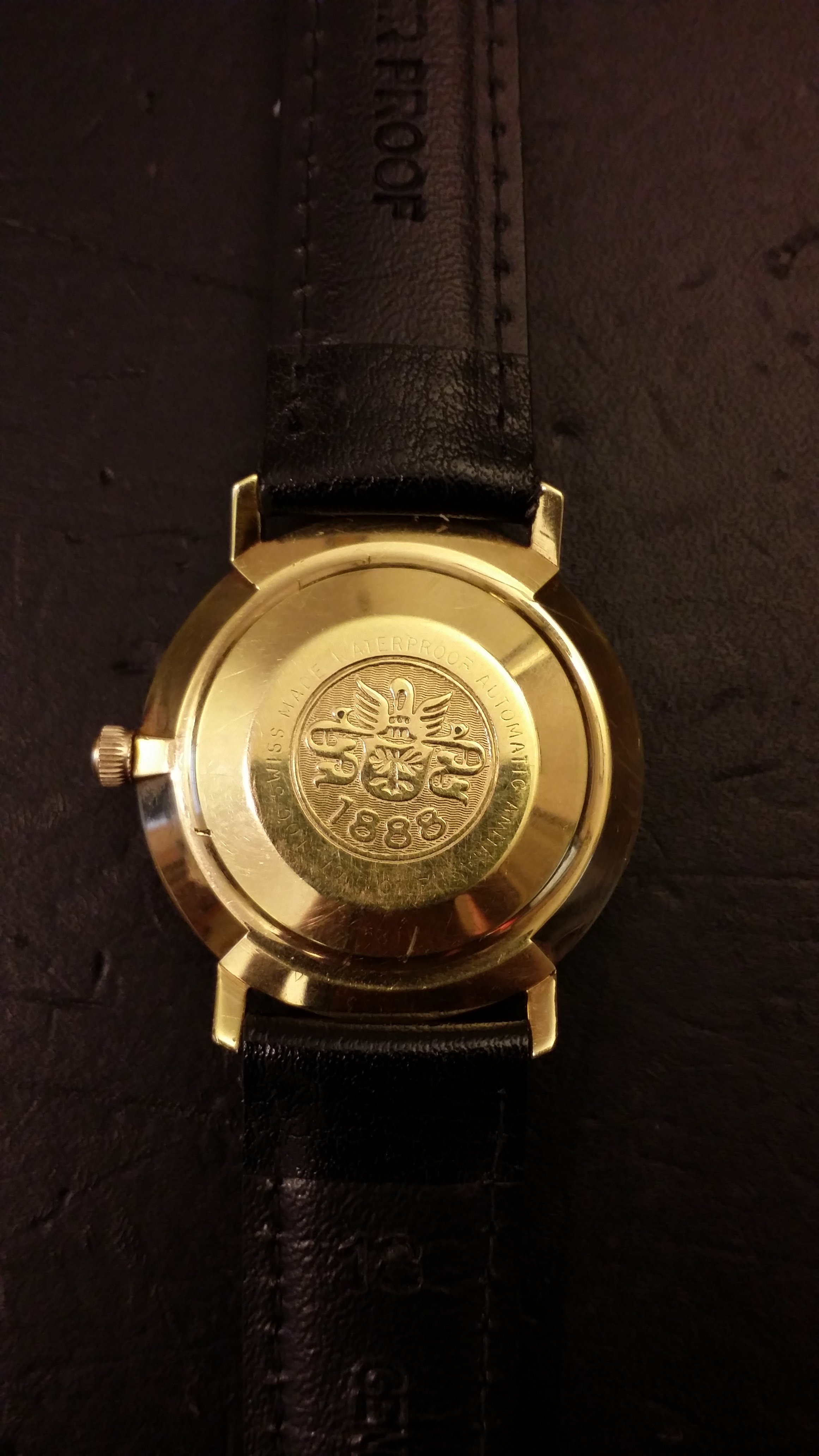

    I bought a vintage Bucherer certified chronometer a couple days ago.
    Cons:
    - Advertised as 38mm, was 34mm
    - Claimed recently serviced and keeps good time.....timegrapher shows +74s/Day, 5.8 BE, so no not recently serviced, maybe never.
    - This is a top opening case....has loose poly crystal and bezel (almost like wrong crystal..too thin to capture case edge tightly. Some resistance when pressing on, but comes loose too easily).
    Pros:
    - Very attractive watch
    - Virtually perfect Dial and Hands
    paid only $140.
    Question: do I keep this and find right crystal and service the movement(at least regulate it), or return it and be done with it?
    Thanks to all!!
    BTW, does anyone know how to remove this movement (no slot in case for crown stem to slide out, so does crown just pull out?

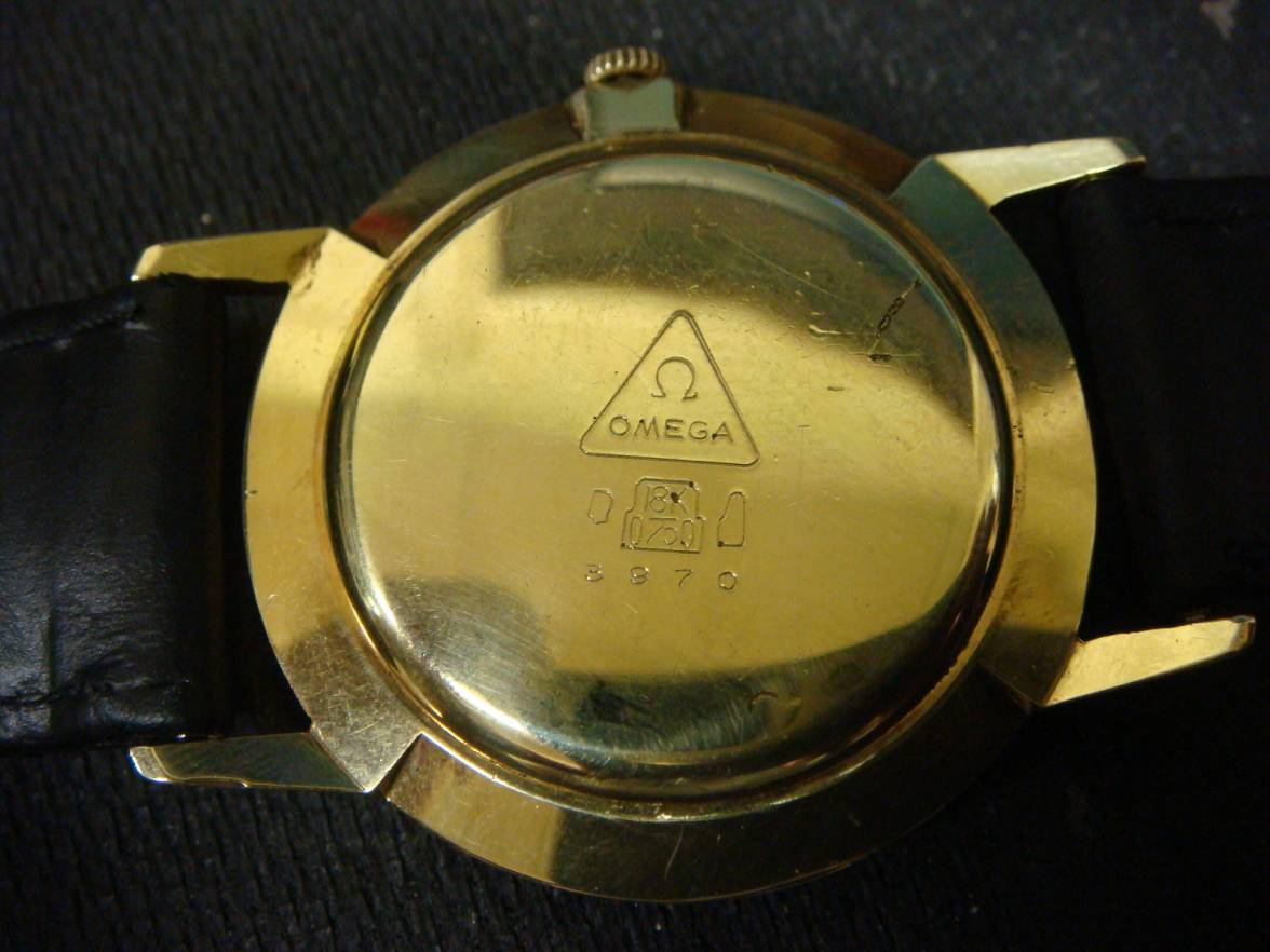

    I always worry when I see that style of caseback
    Caseback on a fake seamaster.........

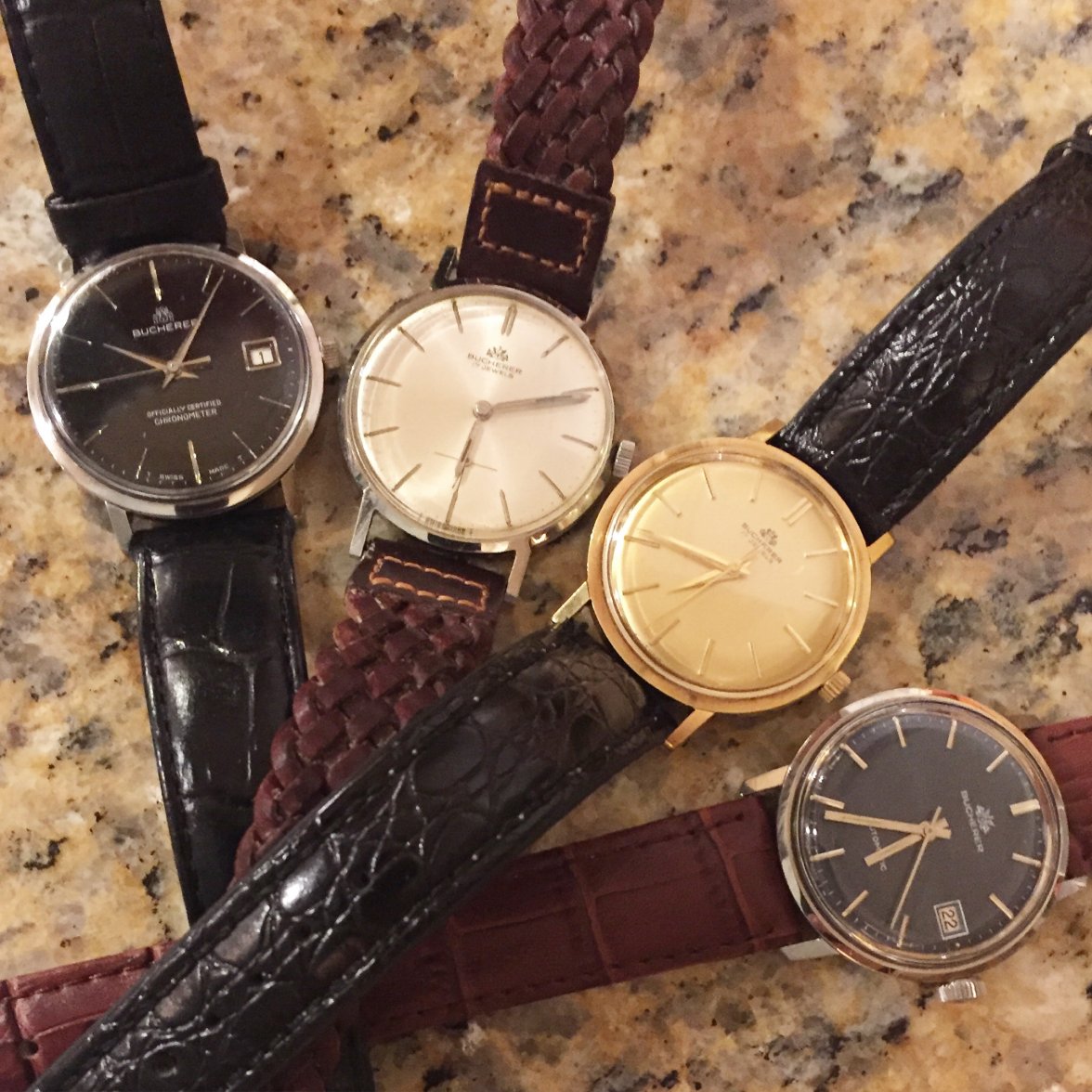

    i happen to like the Bucherer watches. Great quality watches for little money. My four musketeers.

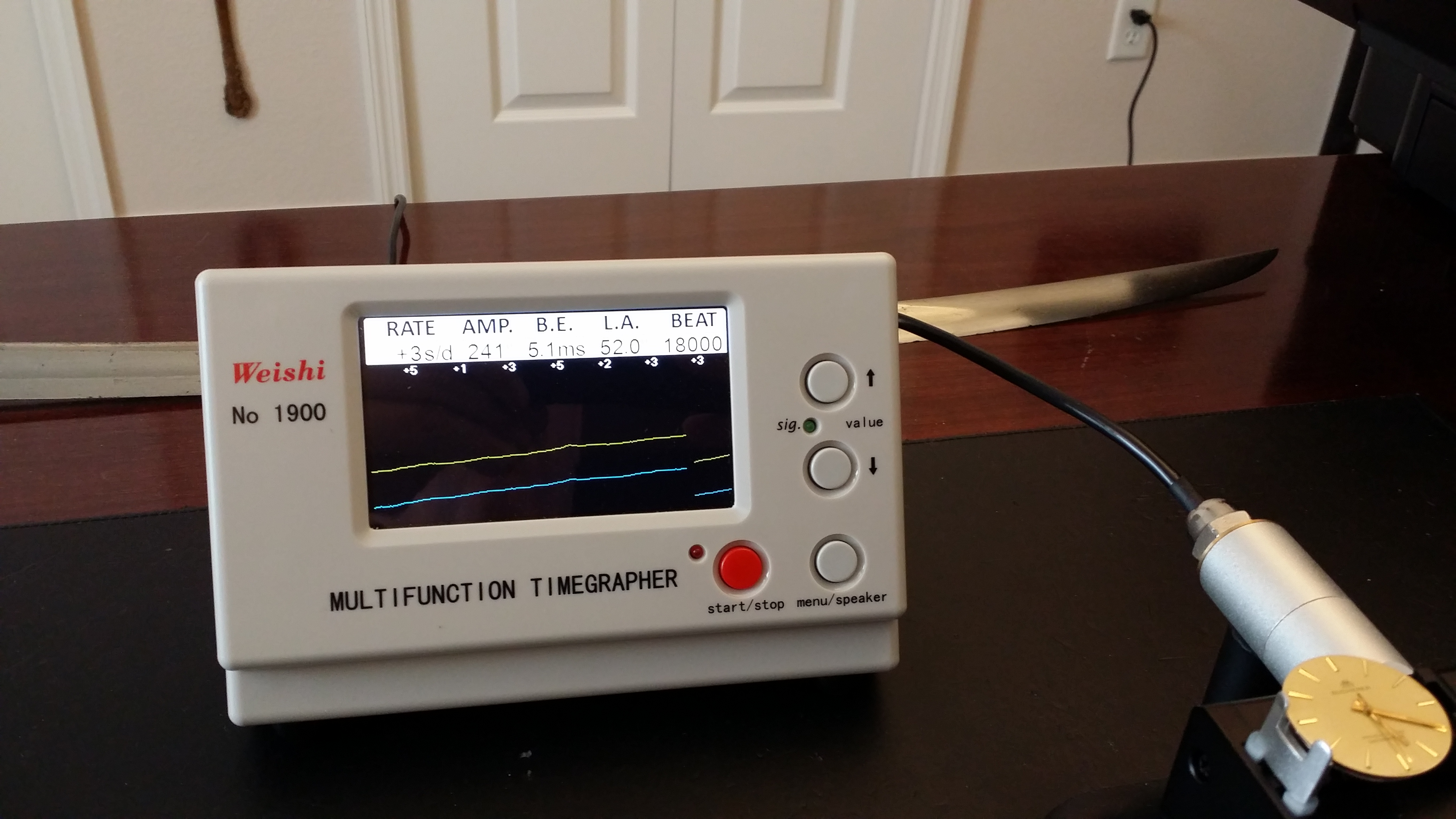

    UPDATE: Decided to keep it. Removed crown (never removed a 2pc...gently, gently!..used tweezers, worked like a charm) and removed movement...spotless clean. ETA 2520...regulated it to 3secs on timegrapher.(as shown).
    Still needs a service but I can live with what I've got for sure.
    Found correct crystal for $8 at flea market from retired watchmaker. Couple hours spent fixing both issues and now I'm good to go.
