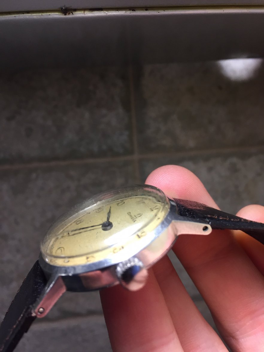

    Following on from the Fab Suisse Discussion, I've got a very unusual Omega I have just been given by my fiancé for Christmas.
    It's a 6B/159 Omega White faced mechanical watch.
    After a short amount of research, I believe it to be a 40s/50s era Air Ministry watch.
    Oddities however:
    It doesn't seem to have a full serial number on the back, only the pre-cursor 6B/159 - missing the following numbers giving details of year of manufacture.
    And more strangely ( and the connection with this article) IMPORTE DE SUISSE below the 6. Why would a British military stamped aircrew watch have a French law imposed expression on its face?
    It was purchased from a small antique shop in my village in Suffolk where I live. The home of the Allied Air Forces during WW2.
    Any comments or thoughts would be great. It was purchased for me as I'm a military aviator myself and it's history is very interesting!!

    What is the diameter of the watch and do you have a picture if the movement and inside of the caseback? This would help giving some info.

  4. mac_omega Dec 26, 2016
    3,161
    6,700
    Sadly it is missing the center second pinion and hand and friction spring...
  5. omegastar Dec 26, 2016
    1,836
    5,322
    Typical ! RAF watch with the missing center wheel module. I am interested in that crown, can you show more please?
  6. Syrte MWR Tech Support Dept Dec 26, 2016
    7,384
    20,738
    Hi Terry,
    I hate to disappoint concerning a present which you should rightly cherish considering it comes from your fiance.
    At the same time if we tell the truth in response to your query, this is not a British military, RAF or Air Ministry watch.
    it is a civilian Omega watch from the 1930s-1940s and from the French market whose back was later engraved to make it look miltary.
    It differs from a genuine military watch in several key aspects.
    1: You rightly noted that the engravings are missing some of the required markings, which must include below the 6B / 159 markings a serial number and a year of issue, for example XXXX/ 42;
    2/ you also rightly noted that it does not make sense for a British military watch to have "fab. Suisse" marked inside the case back (as it is a French market inscription), and that is a clear giveaway.
    The dial, hands, crown, and case are not the ones found on the military watch (with famously long curved lugs) this one seeks to emulate (you will find several examples posted on this forum, like the one below which is mine).
    However it is a pretty watch and so you should feel free to enjoy it as a present from someone you love. It's all that really matters.
    Best regards,
    S

  8. Terrymusgrove Dec 26, 2016
    9
    Syrte,
    Thank you so much for all the information. It's nice just to know it's history. I do love it either way, so not disappointed. Plus, it's nice that it's a bit different. Haven't seen that many that say Importe de Suisse in the 6 o'clock position.
    The only other thing is you said it's missing the second hand and mechanism. Obviously this is different to when it was made, but do I risk damaging it, using it as is. Currently it works and keeps time well without.
    Thanks again for all the information.
    Omegastar, here is the crown... unmarked: image.jpg
    Syrte likes this.
  9. Syrte MWR Tech Support Dept Dec 26, 2016
    7,384
    20,738
    Glad you feel positive about it, others will probably know more, whether about this particular watch model or the technical question.
    (Omega and some other brands did not mark crowns in the 1930s and early 1940s.)

  10. François Pépin Dec 29, 2016
    1,531
    1,081
    You can use it as is - it is an advantage of the indirect central sec. But if you want to add the missing parts, they are not difficult to find - with a donor movement - except maybe the correct hand.
