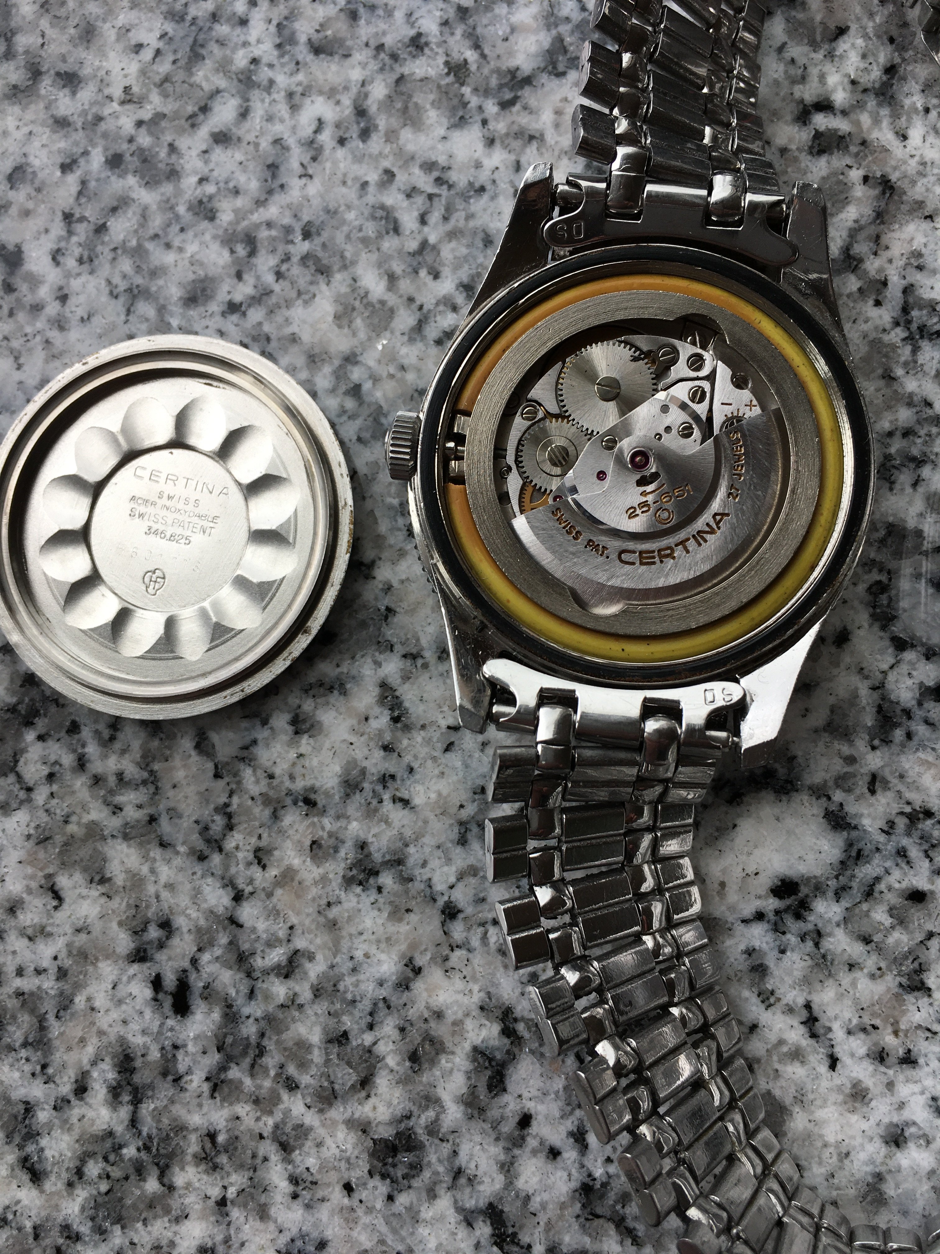

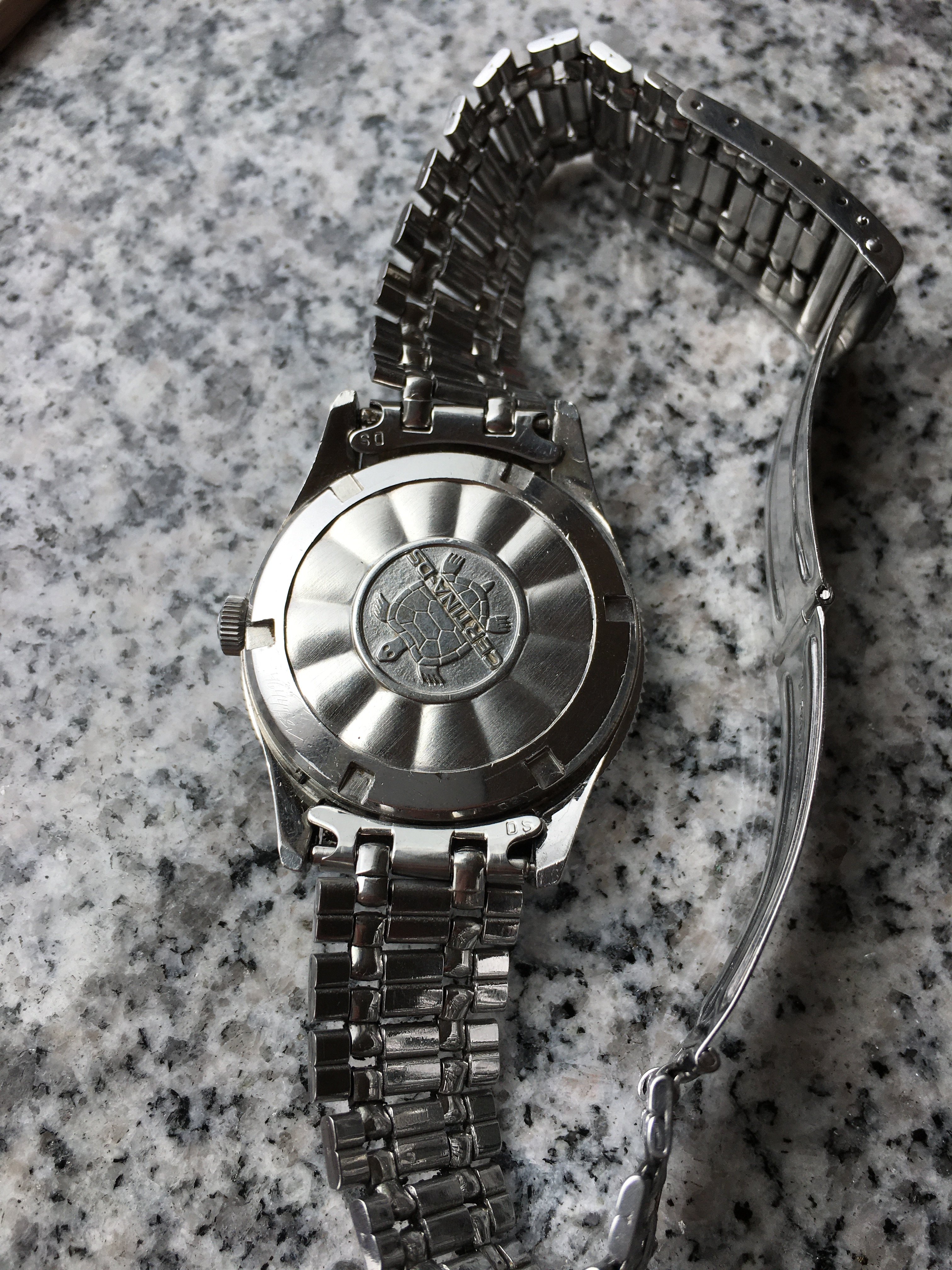

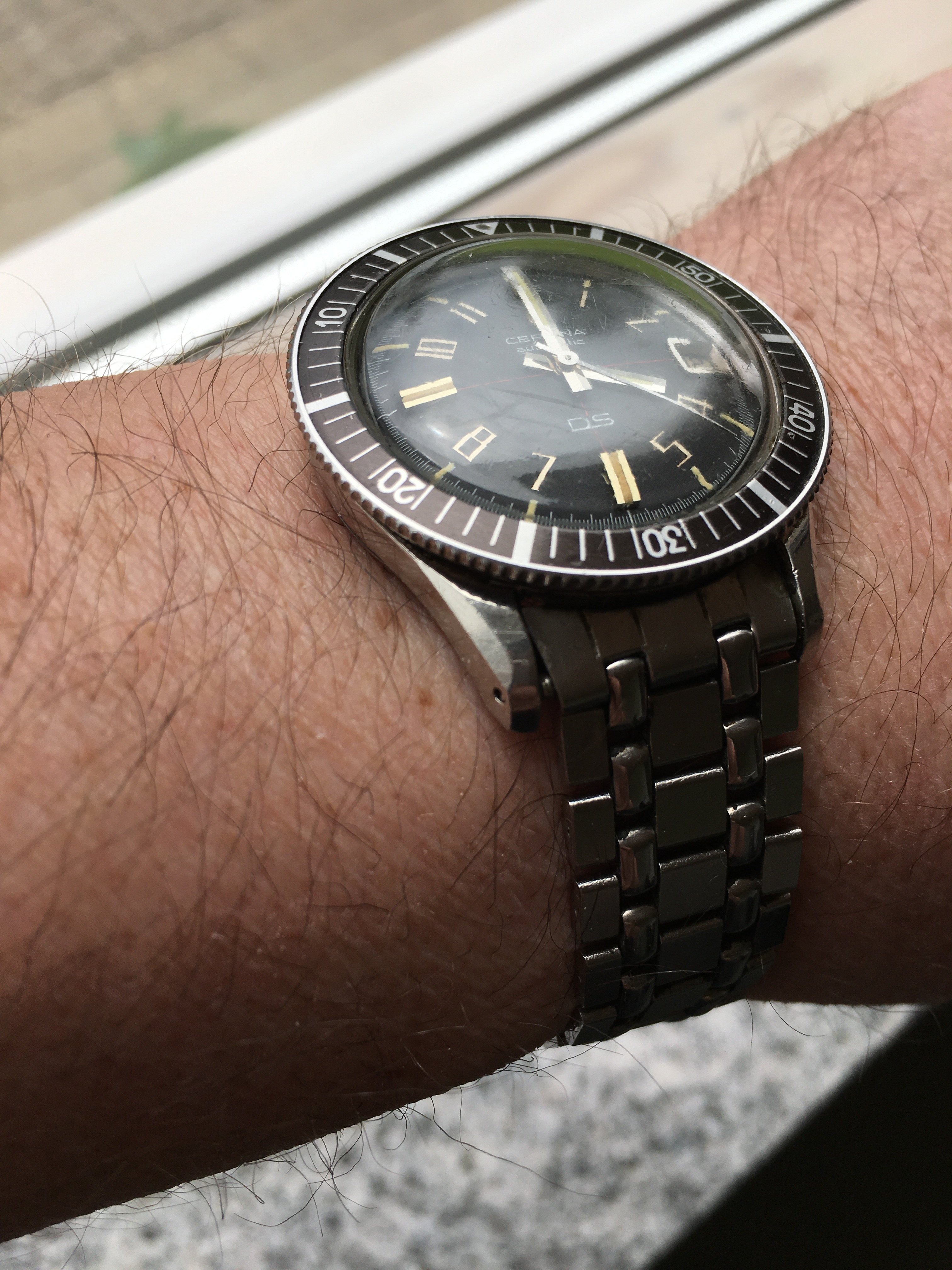

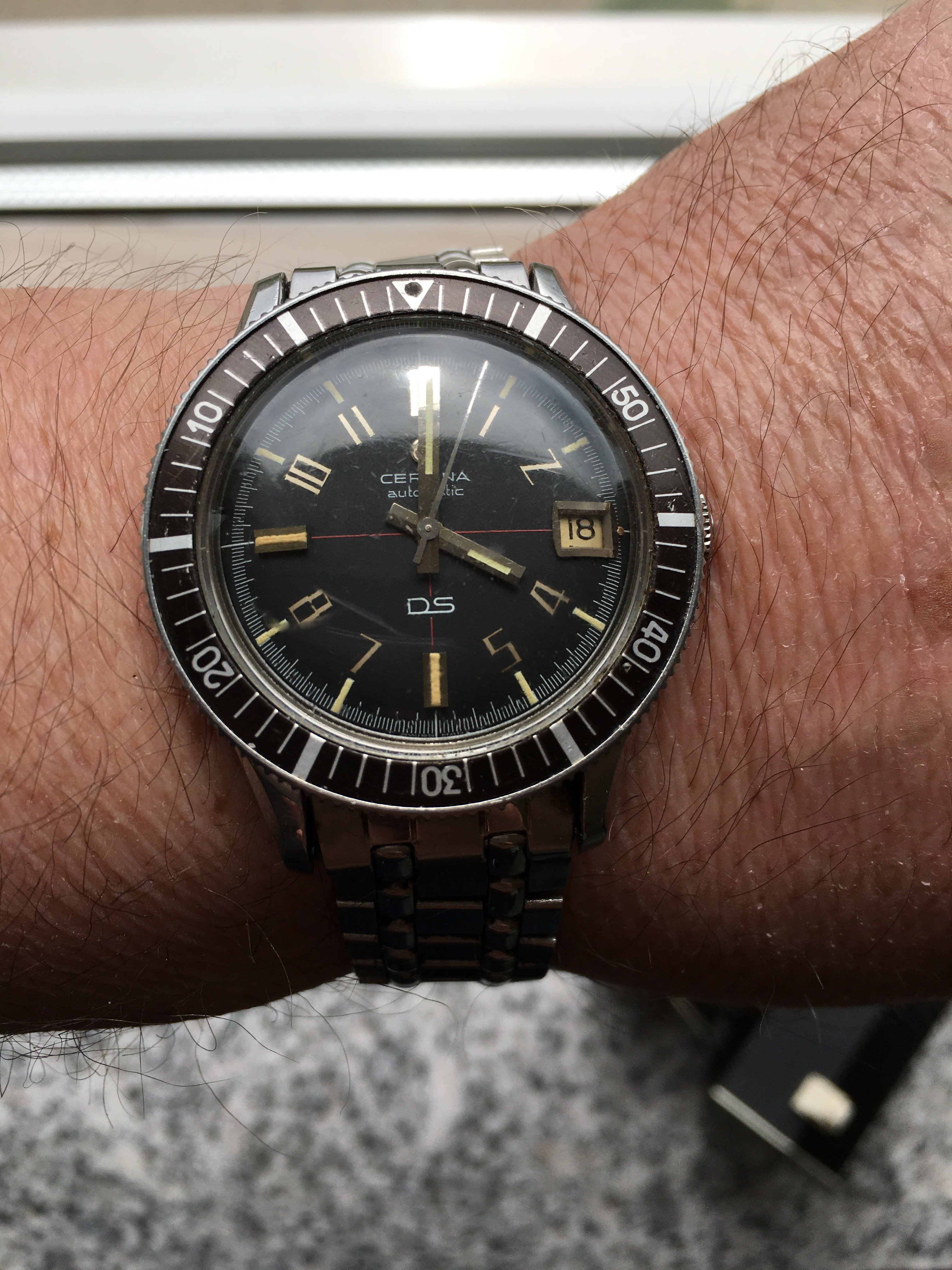

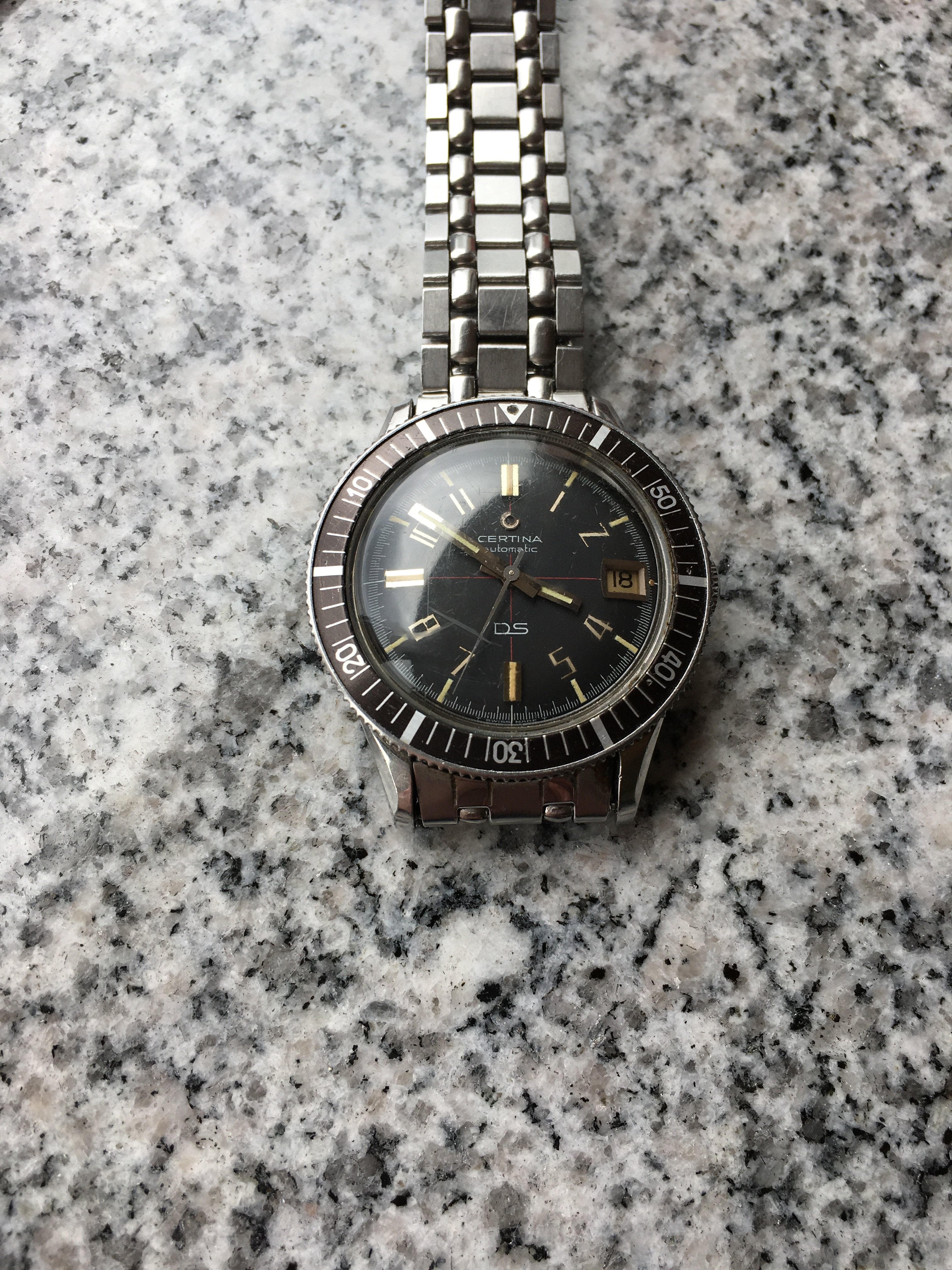

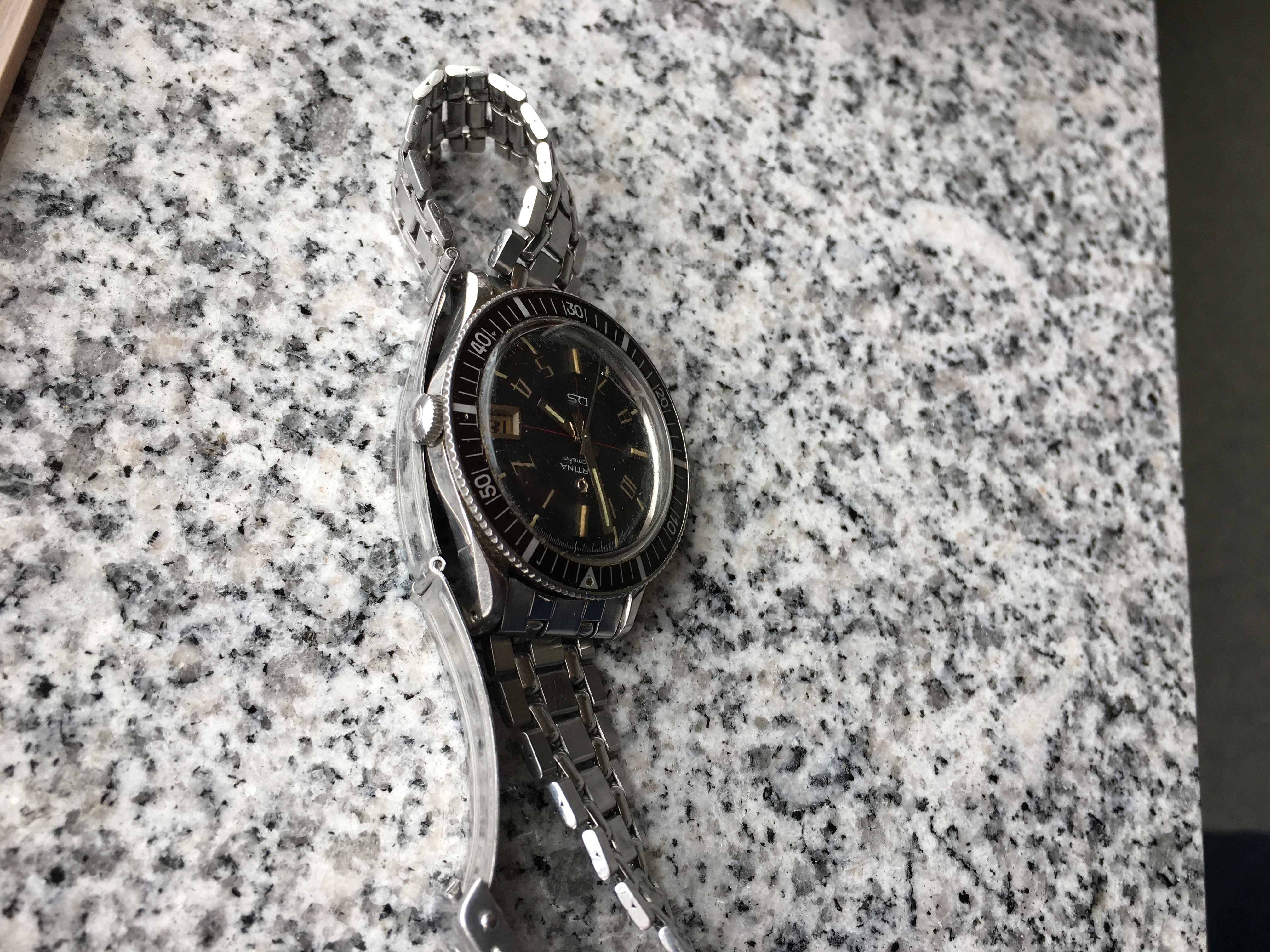

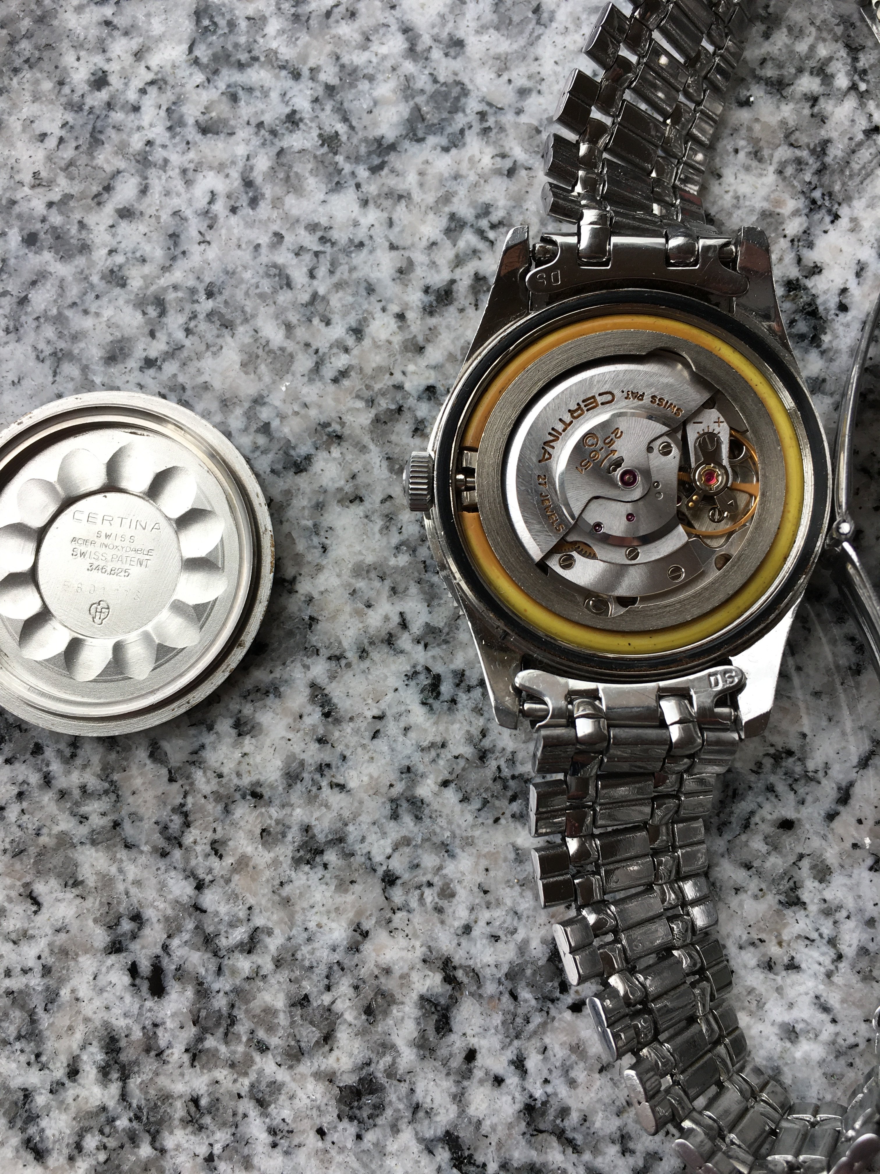

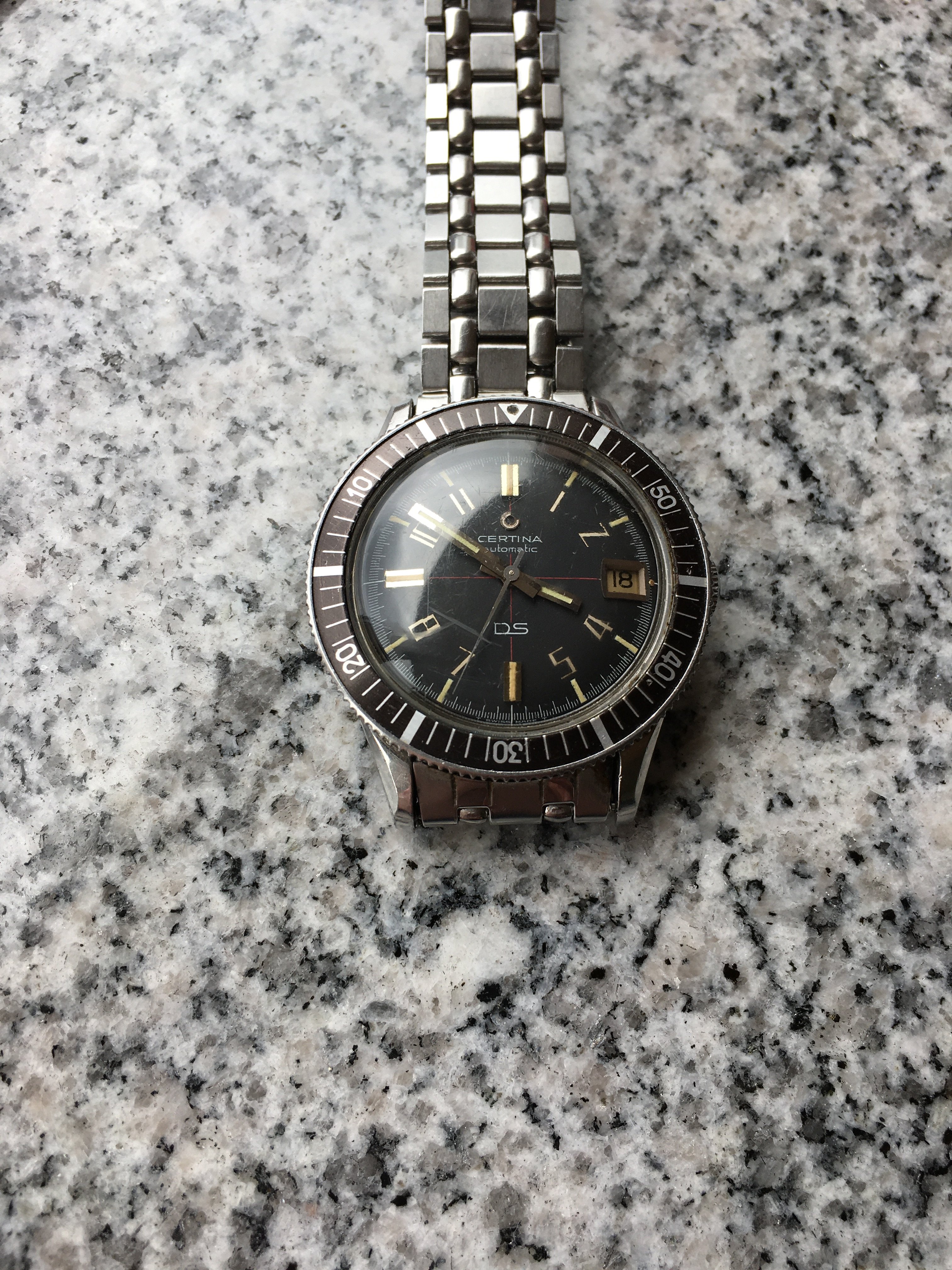

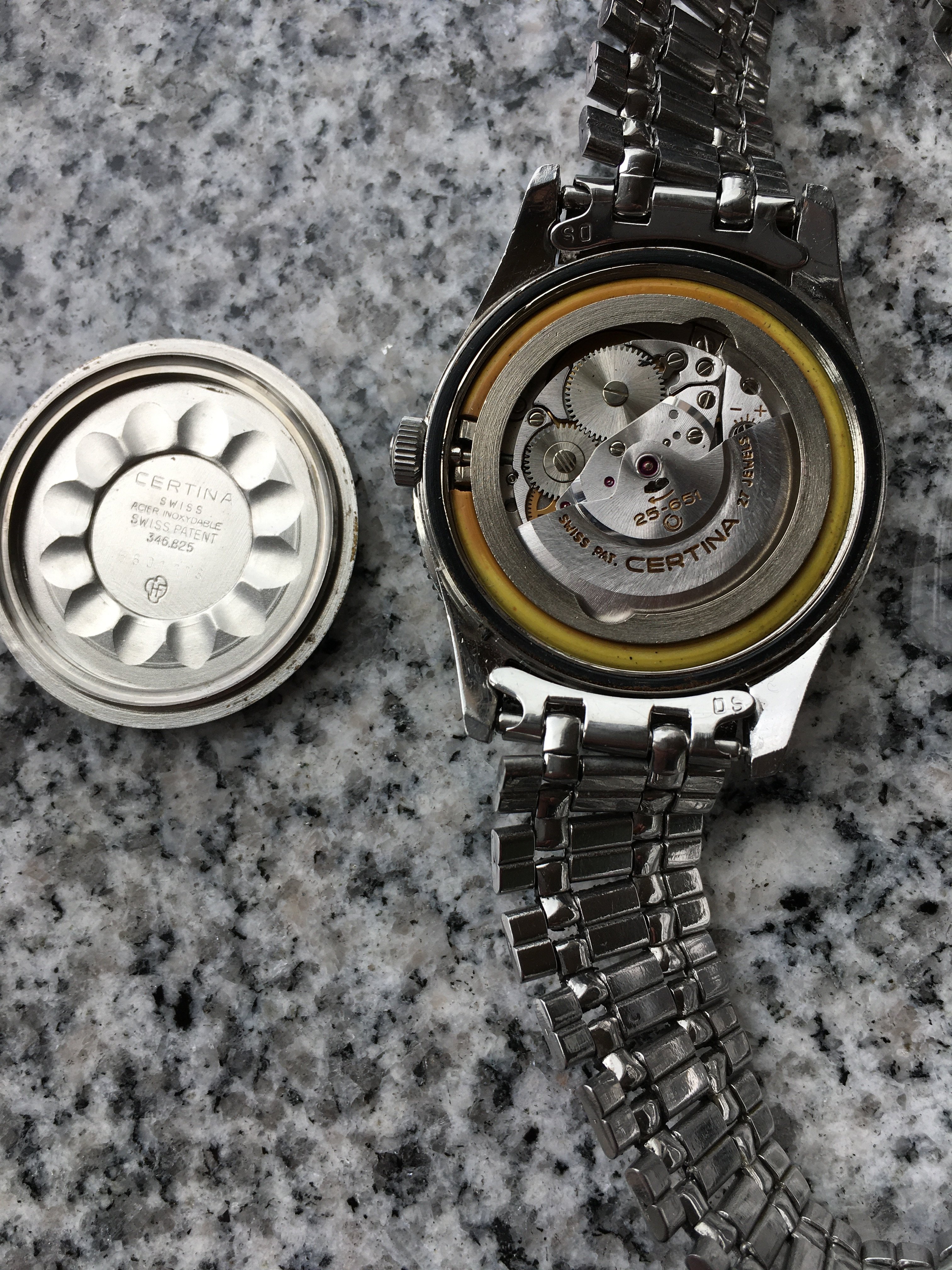

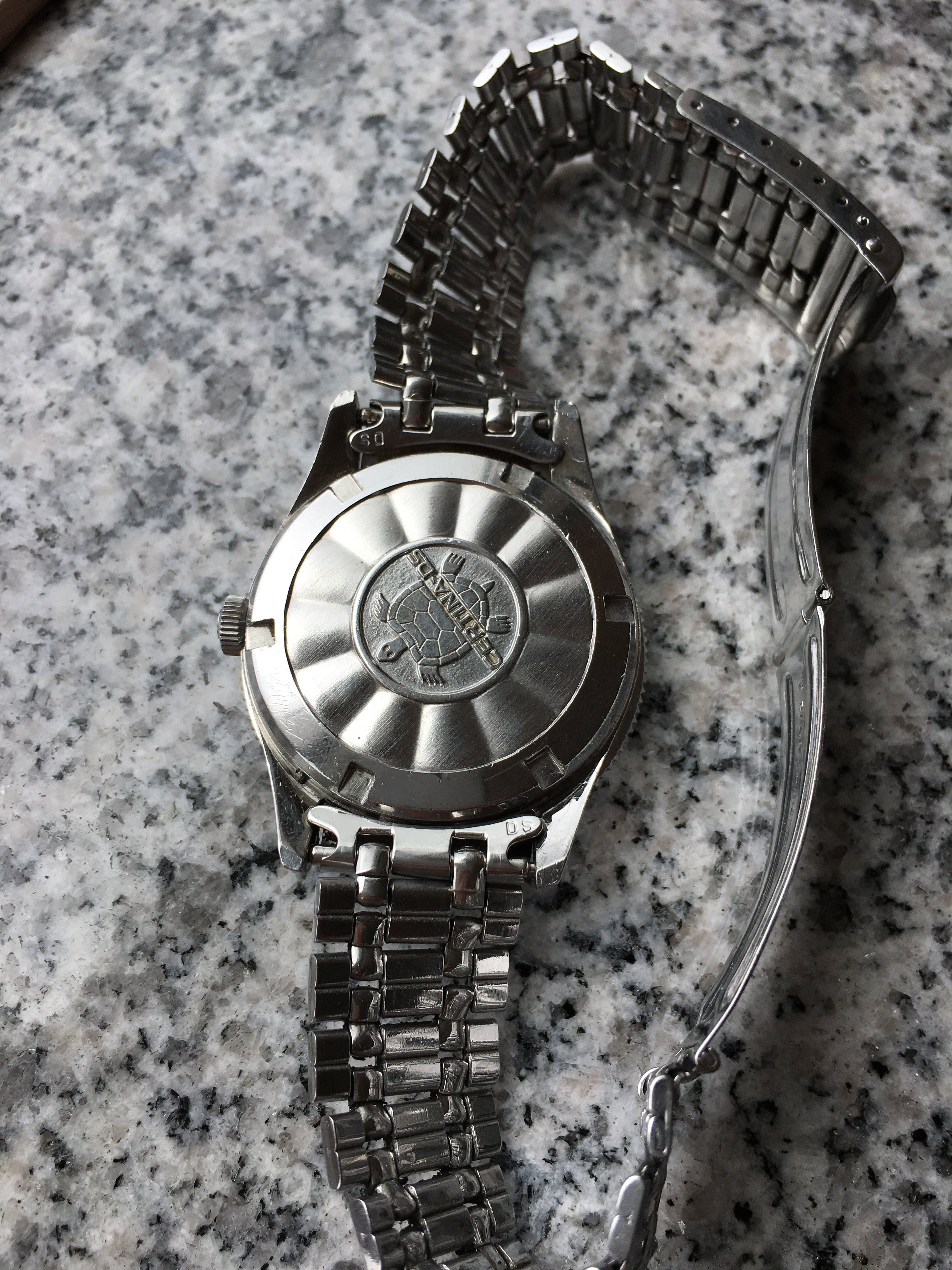

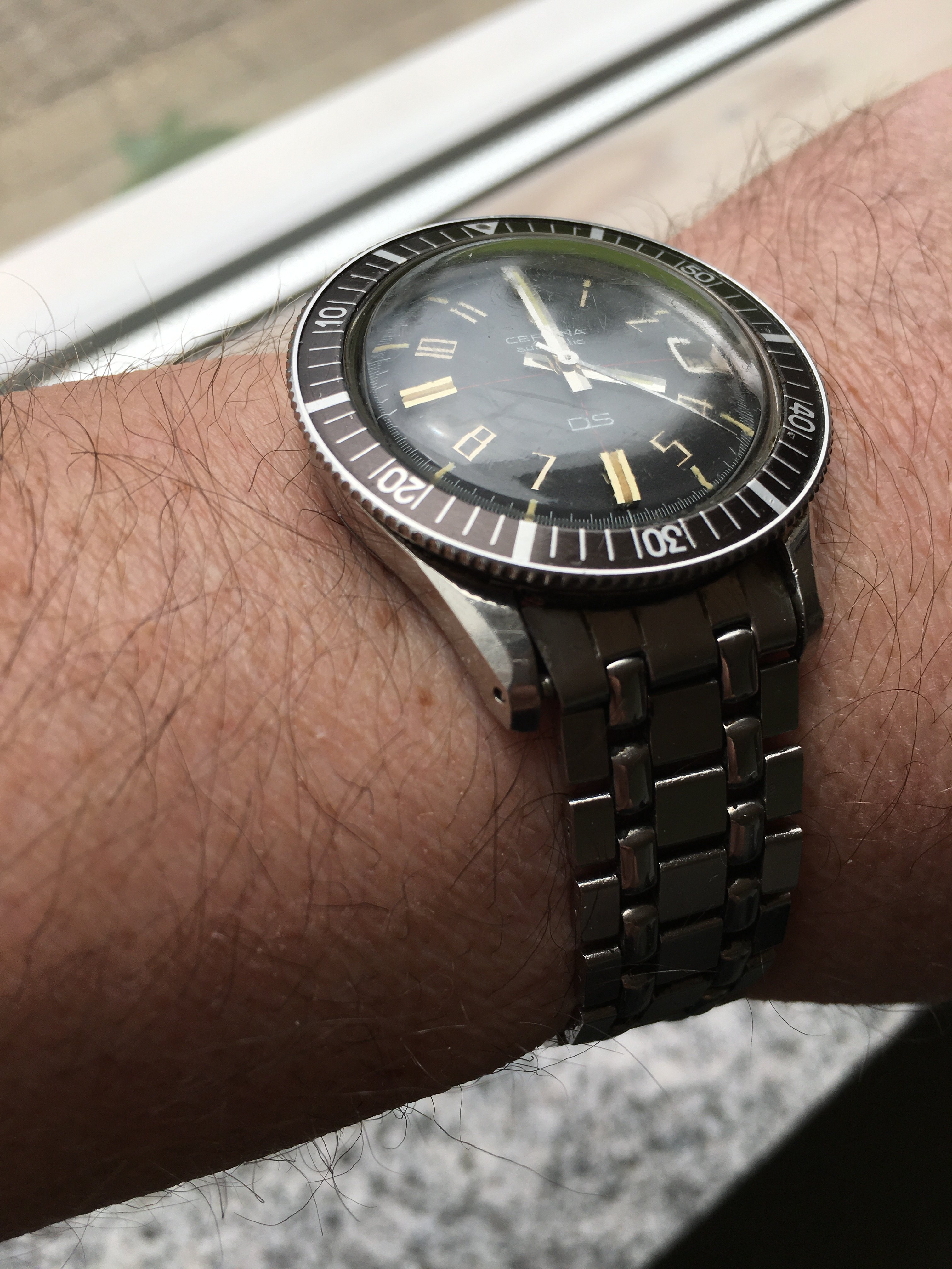

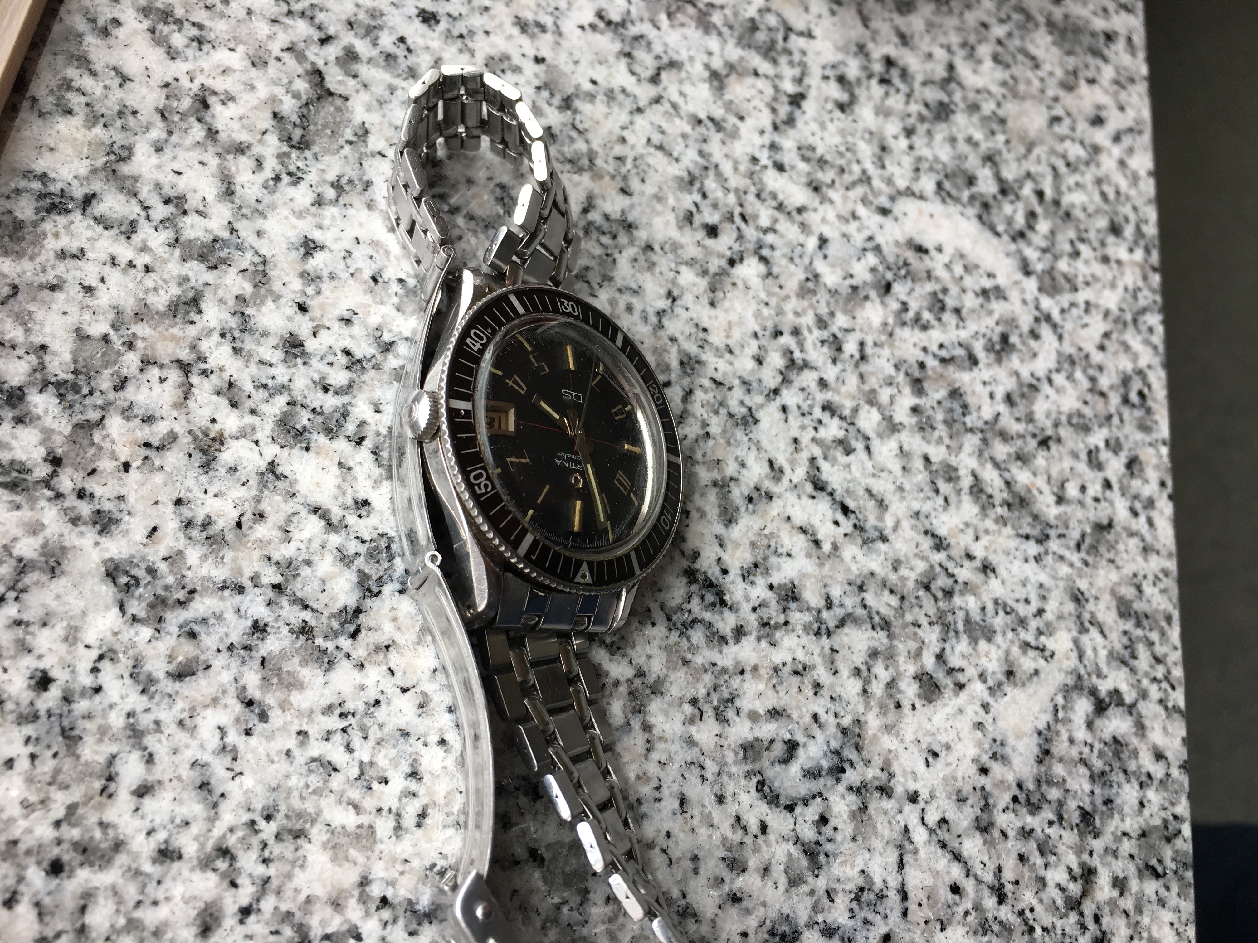

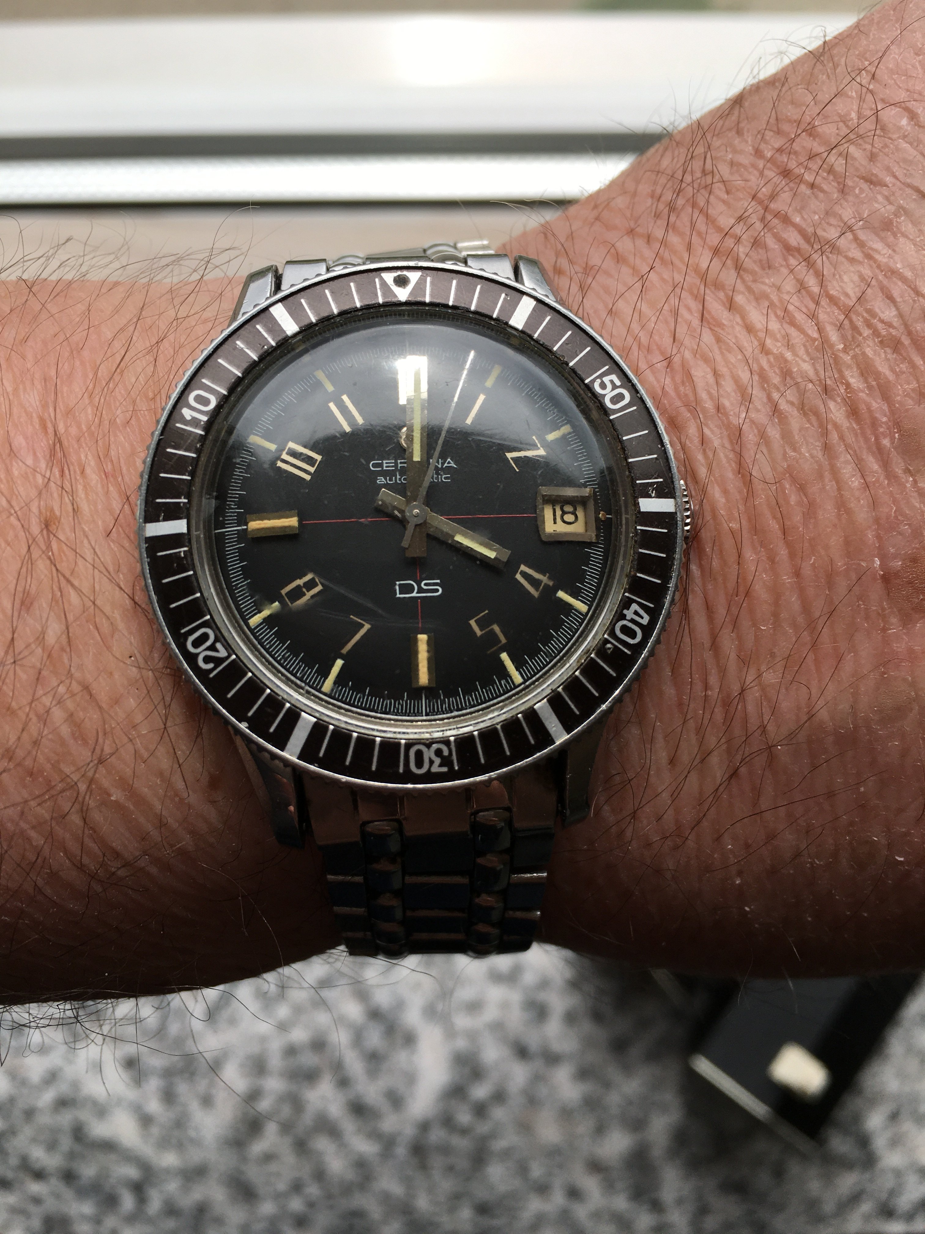

Hi all,
The Certina below was up on a local auction. It didn’t went cheap and I might have over paid, but no harm done, as I have the option to return it, if you guys tells me it’s a piece of crap Never had one in my hands before, which certainly is a mistake as it’s actually pretty cool. Please tell me it’s as original as I think it is
My own observations:
Great dial under the old crystal (sorry for the bad photos, but it’s not easy to get good ones through that crystal).
Lume a little puffy with the 12 - 6 - 9 markers a bit darker than the rest. Also, the 12 - 6 - 9 markers has a thicker lume. All lume glows equally and faint within 30 sec. OK, or relume?
Very nice case for its age?
OK bezel, though the “pip” lume is gone. There’s no “click” function when turning it - there should be, right?
Crown - I see different types online, so not sure if original?
Date wheel a bit off.
GF bracelet marked 2/66, which I guess makes it original to the watch?
Is it possible to buy new crystals or should I try to save this? In general - is it hard to get parts to these?
On to the pics:
Thank you 😀
9,588
27,706
Hi mate.
I was one of the underbidders, though not the one with the next highest bid - I suspect he was Swedish 😉
Everything looks correct, the dial and tritium especially are very good. The case is not perfect, but very nice, as is the bezel. Crown I believe is correct. Crystals are available (generic dive crystals are much, much cheaper and nearly identical), but fairly expensive. The bracelet is in good condition, better than the average one out there.
The date change on the Certina calibers are probably their weakest point, you can either buy a cheap donor or find the parts on eBay, they are usually available.
Price-wise I would say that you paid around what I would expect. Not a bargain really, but a fair price - especially considering the condition 😀

Just what I needed - thank you Troels, very kind of you 👍 Beers on me, should we meet one day....😀
Glad you were not the next highest bidder - always happy to beat a sweed 😜😁
9,588
27,706
If you need something in Aalborg looked at, just PM me and I will go to the auction house and check it out 👍

That's my favourite Certina. Looks all ok for me . I had 2 over the last 30 years. There is a spring, that adjusts and centers the date. Your Watchmaker might be able to re position the date disc. If not, plenty of donors and parts as well. Enjoy!

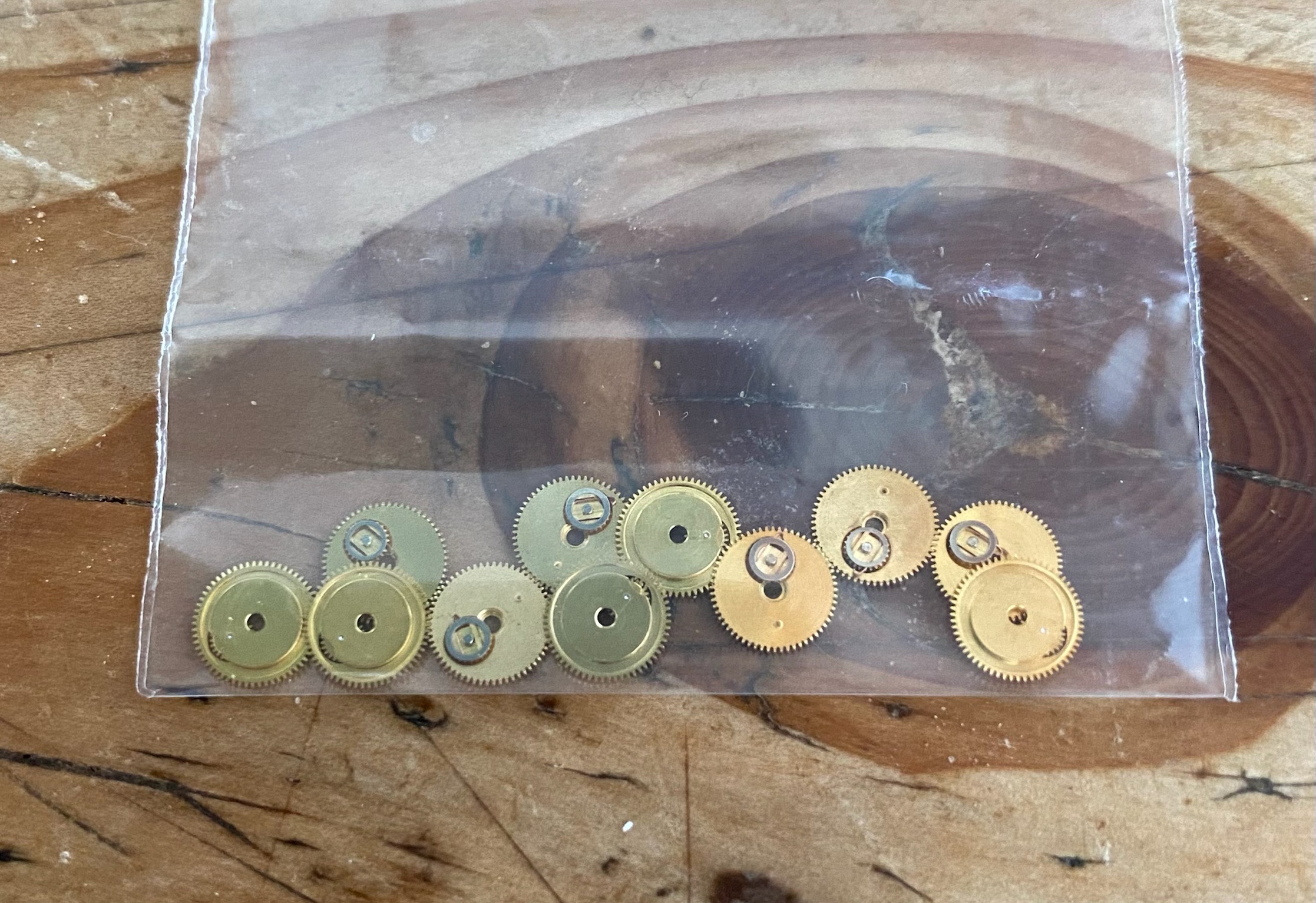

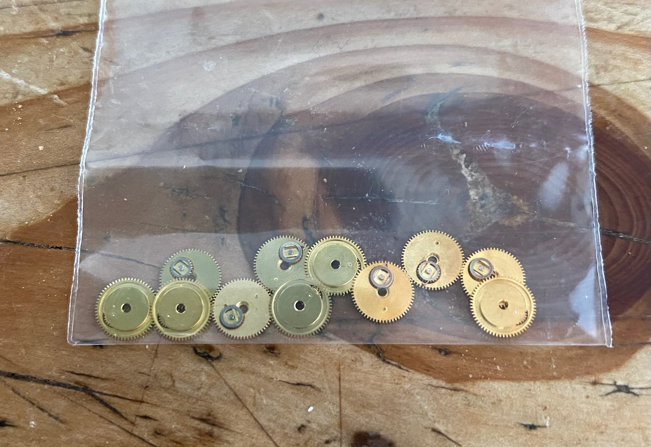

If the problem is in these tiny little date-changing wheels in the 25-651 cal: I recently bought a few (NOS, I was told) and could probably do with less. Just in case.
1,206
3,646
If it fits my watch I'll be happy to buy one from you 😀
Thank you.
