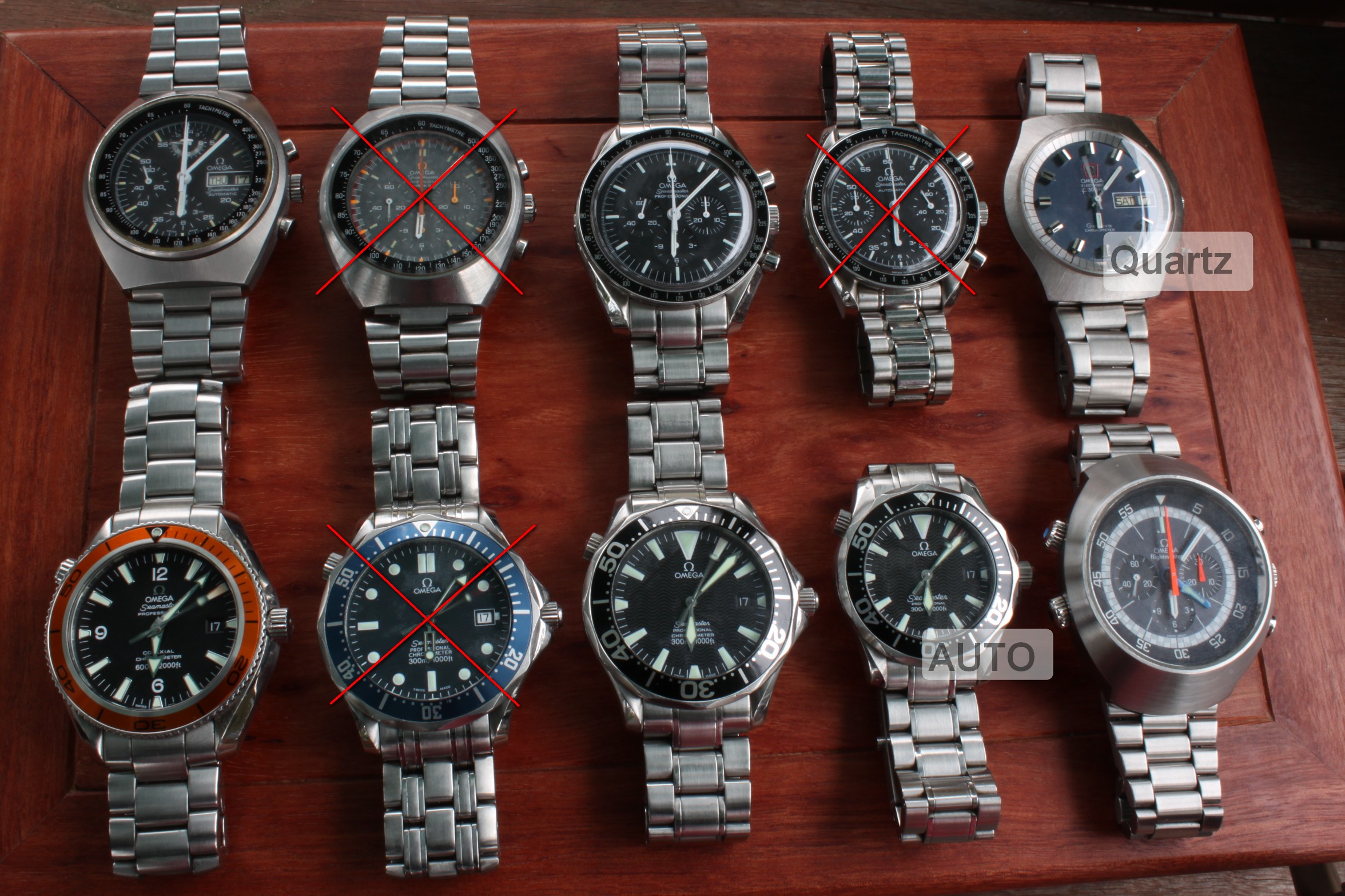

With specific reference to Al's post, I look at my own present collection / dilemma. (X means Sold.)
To be honest, I got into watches like I did some substances. A little too quickly, so now, being the owner of these, what do I do. Sell up, as I honestly can't afford to maintain the mass I have accumulated as I would like to?. Sit them in my box for 10 years and hope for the best? Keep my favored, sell the rest?
These are serious questions that I am sure not I are just pondering.
These are just my Omegas', add a couple of Heuers, a Pam.. etc etc.
Hopefully seen as not hi jacking, but adding to Al's great thought provoking thread
EDIT. flightmaster Cal 911 was overhauled around 2 years ago
Speedmaster Pro 3570.50 was overhauled, under warranty some 2 years ago.
Seamaster 2254 was calibarated some 2 years ago. Service stated unnecessary. New second hand.
