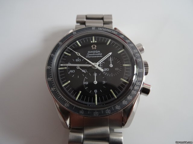

    I came across this '69 example of a 145.022 while "surfing" the net for Speedies
    rest of the images and description at http://xurl.at/d4w
    This looks like a mint example and priced to match - but is it all it should be? It just looks a little too clean to be true. I think its even the original dal and hands for a '69.
    Anything to discuss here - positives or negs? Opinions please?
    The email I received from the Swiss seller stated:
    Pay in my Swiss UBS Bank in Switzerland. No PayPal, no Creditcards, no Checks.
    Why not, eh? ;)

    Not a '69, probably a '68 with the applied logo and long indicies and movement no. If so, the bezel is wrong, should be a DoN.
    Case has been polished and the lume looks dubious but could be original.
    I'd say it's a watch tarted up by a dealer to look better than it actually is.
    If it's a '69 Youre after, these are a fairly common vintage ref and a number of examples have aged very well. Either with original dials, hands, bezels etc in very good condition, or even faded to a beautiful brown.
    This is no where near as nice as the dealer would like you to believe it is and the price, quite frankly is rediculous.

    most likely a 1968 sold in Jan 69 - thus should have a DON bezel
    luminous plots color is not attractive to me...
    And the asking price is far too high

    As the other guys have said, way too expensive and it's incorrect.

    That box is pretty nice though...

    To me, when the ad says "with B&P," it implies original box and warranty papers, neither of which are present here. Maybe I'm over-interpreting, and it just means "a box and some papers."

    If it were the original box and papers, the seller would go out of their way to mention ORIGINAL BOX & PAPERS several times in the listing. Some sellers will even call correct box & papers original. Caveat emptor - which really translates to buyer's wallet emptied.

    I didn't pick up on that! Certainly does make you wonder just how original that box is. Geordie sold his original lunar box on eBay a few weeks ago and it made £460
