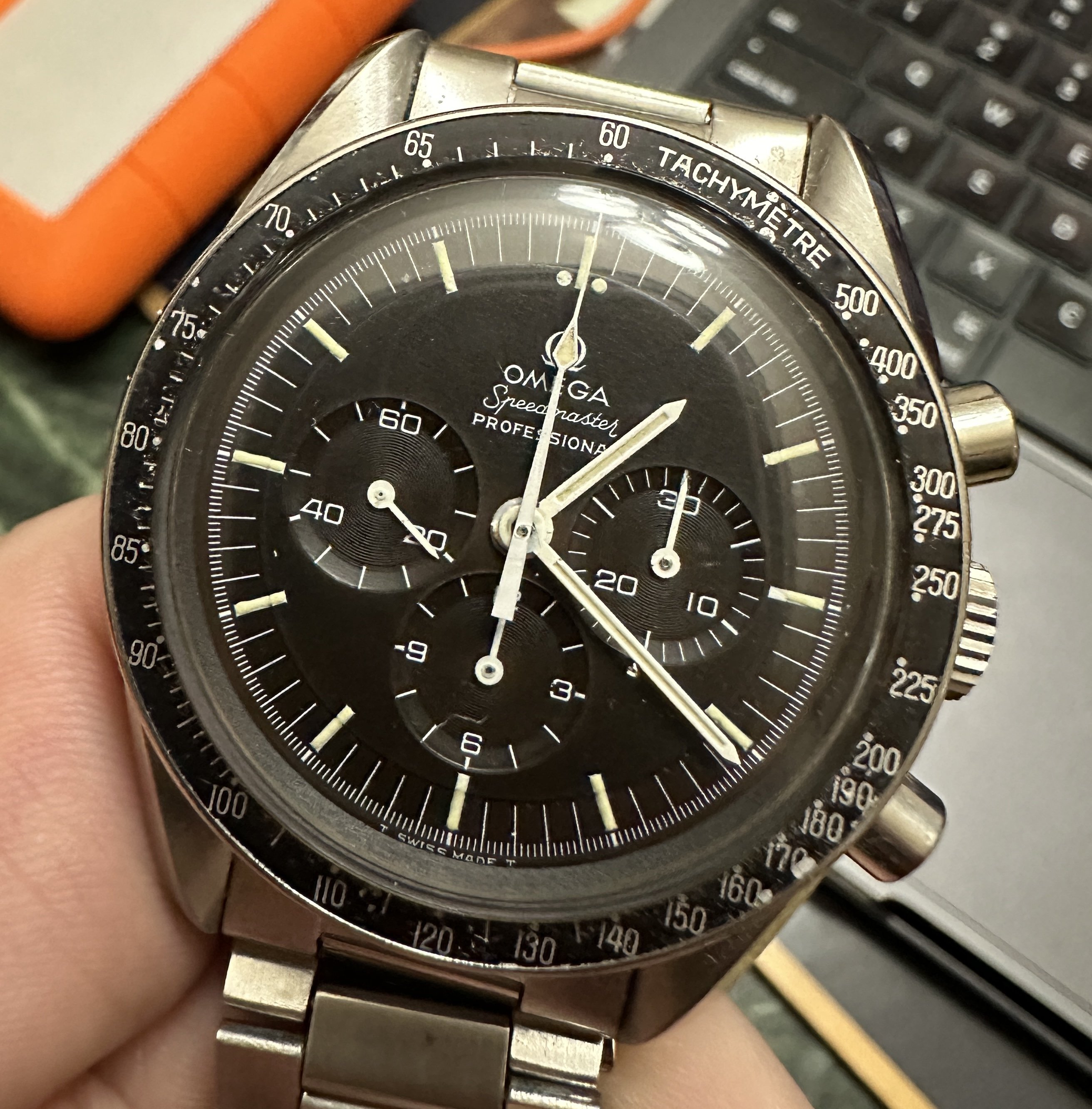

The one in the photo was a Speedmaster. The photo was taken in 1973, so I know the watch dates from before that time. Here is what I saw when I looked at the watch (my poor photos attached, I apologize for the quality and the dust on the watch. I should have brushed it off a bit before photographing. It has been sitting in a box in a closet for at least 15 years):

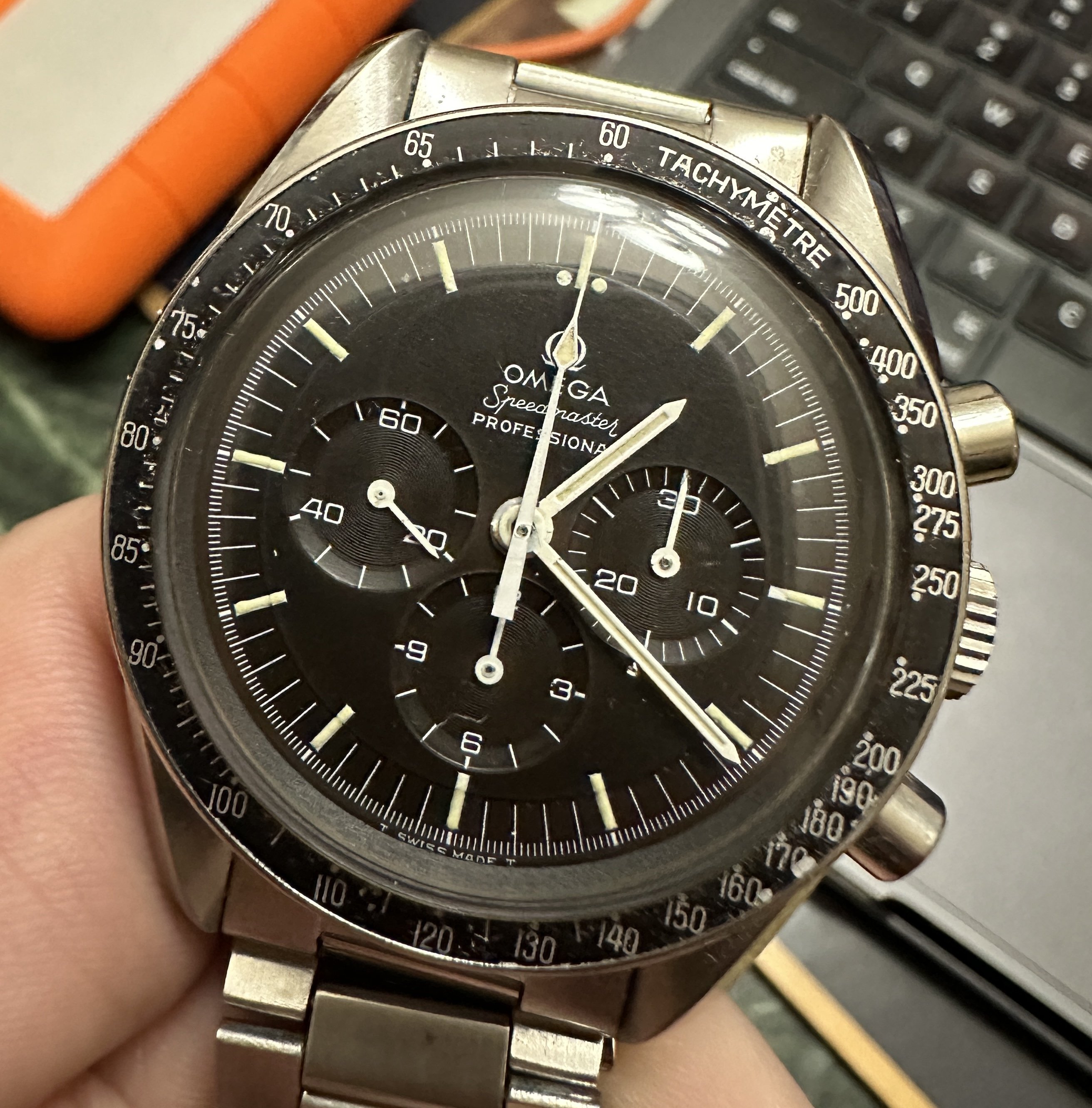

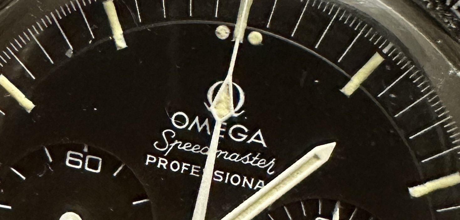

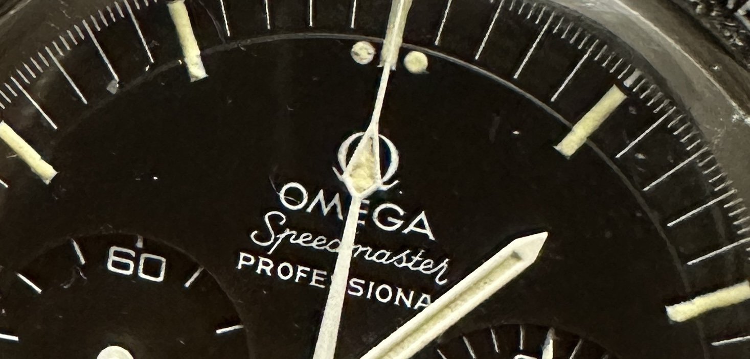

(1) A step dial with painted logo (I tried to get a close up showing the step, it is more obvious in person);
(2) A DON bezel showing honest wear.
(3) A square end chrono hand.
(4) "stick" hands.

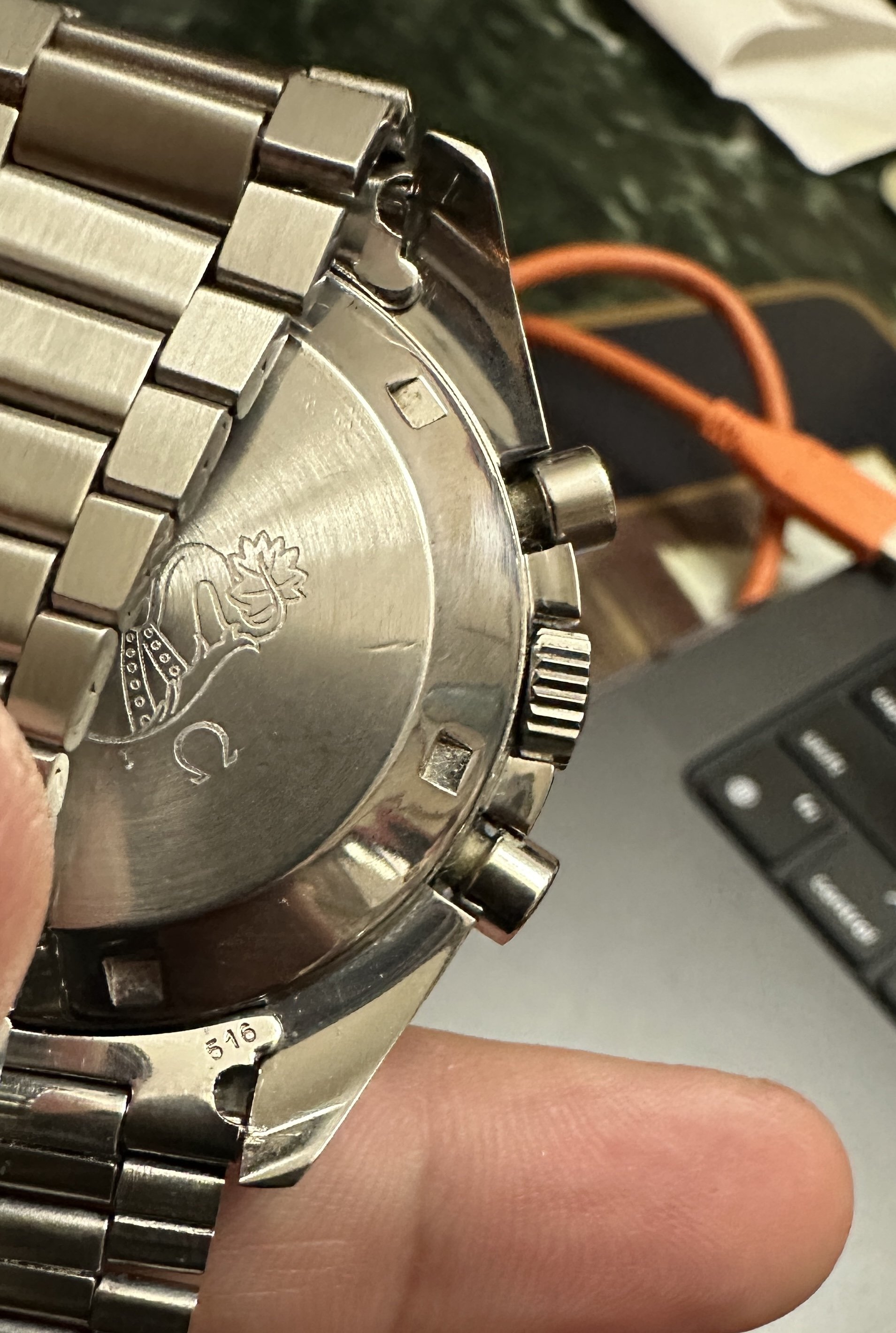

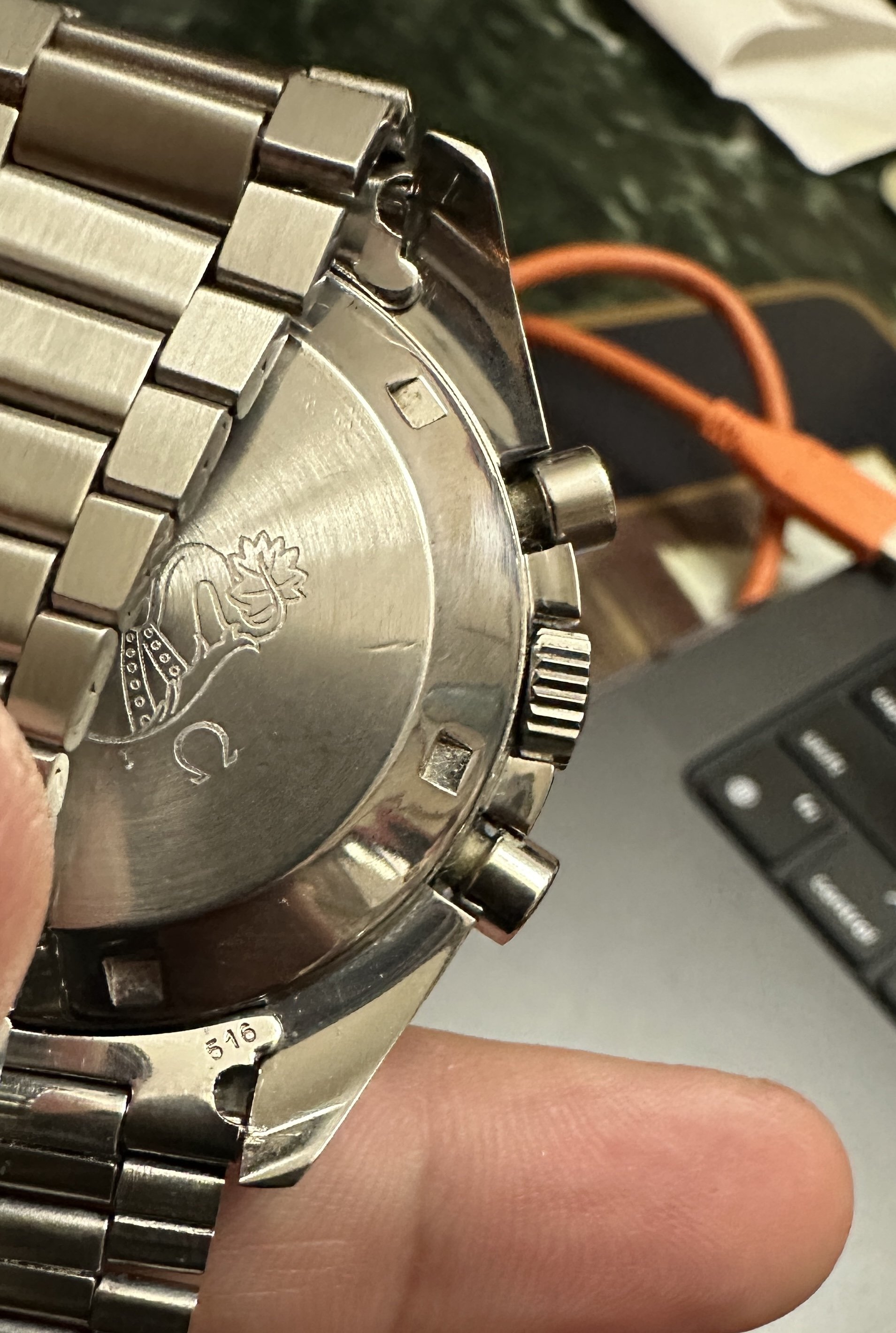

(5) hippocampus on back

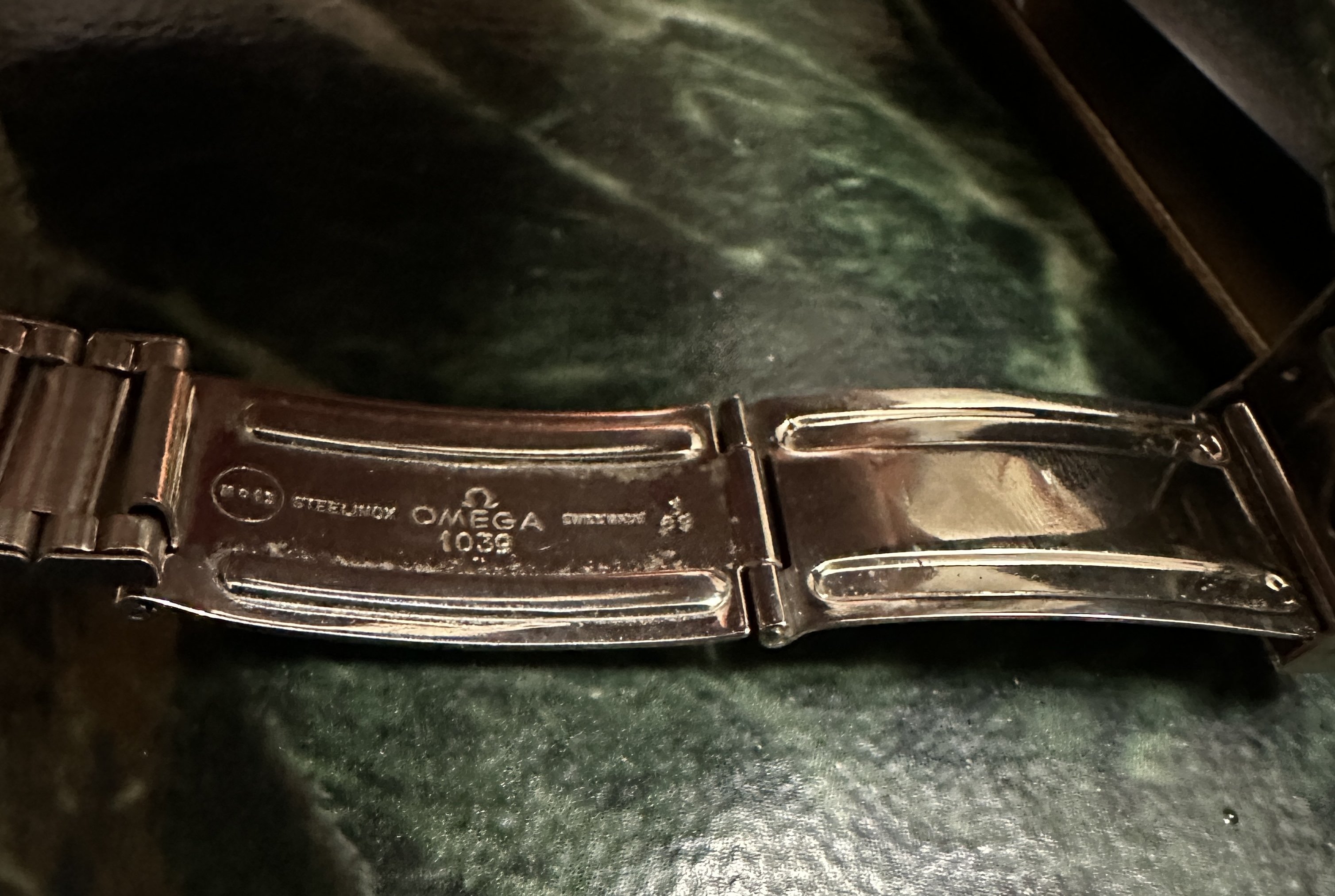

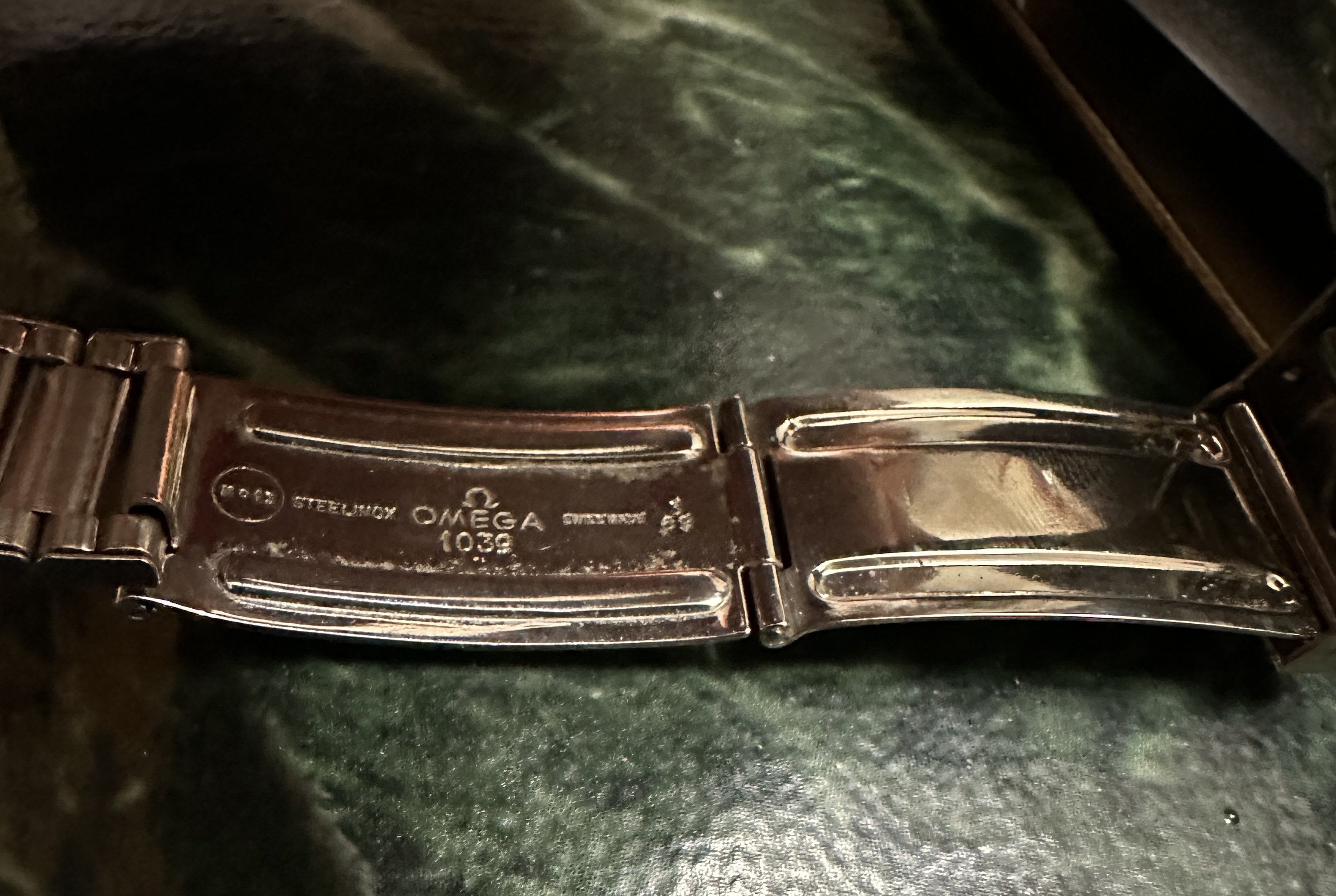

(6) A 1039/516 bracelet (with another, sealed NOS 1039/516 bracelet)
(7) I am not *quite* sure how to tell if the crown or pushers are service items. My friend says her husband had the watch serviced in San Francisco over the years, but she doesn't recall anything ever being "broken" on it.
I don't have the tool to open the back (nor would I feel comfortable doing so even if I did) so I can't check the serial number. But based on the above, my somewhat novice guess from reading Speedmaster 101 is that its probably a 145.022-69 (specifically because of the DON bezel + painted logo).
Does that seem accurate?

I’m no expert on the -69 reference but if it were me looking at the watch using the Speedmaster101 info and the e-copy of moonwatch only, pretty sure I’d come to the same conclusion. I’d wait for those who are more familiar to chime in, but other than opening up the case back, I'd say you hit the nail on the head.
24,798
55,079
Absent any unexpected weirdness, your reasoning is correct.
3,602
7,819
Agree with above well described looks all original and well preserved.

high grade early 145.022-69
In terms of very early 861’s this is the best I’ve seen.
