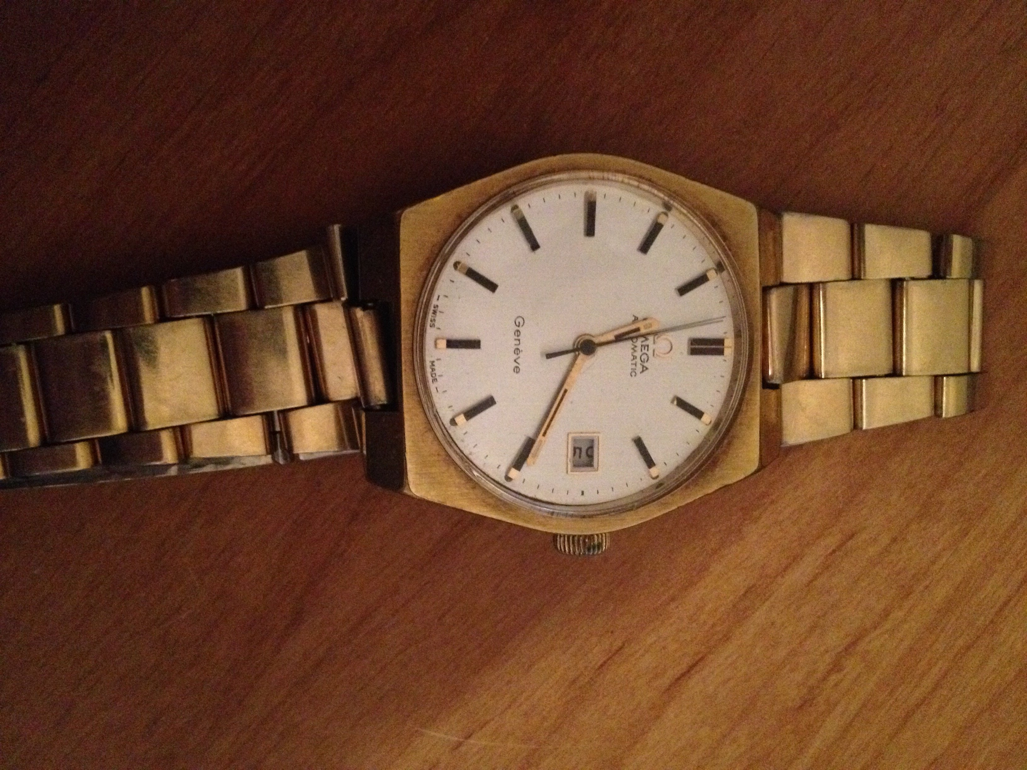

Hey Guys,
My grandfather bought this Omega for my father at pawn shop in the mid 70s. Any help identifying the model would be great! I know I need to take the watch to a watch shop to have them open the back to see the serial and model number but if you can identify before I do that it would be great. He never serviced it and I'm curious about the value before I spend money on the servicing.
Thanks in advance!
33,531
38,205
Its an Omega Geneve Calibre 1481 in gold plate from the early 1970s reference MD 366.0822 , probably 350-550 as yours is probably one of the nicer examples around of that model, most have had plating worn or polished off and edges softened but that one's nice and sharp.
The movement is a bit of an odd duck, shared with Tissot and not really mentioned that often as they didn't make them for long.
Worth servicing only because it is in quite nice shape case wise, has the bracelet and has a nice dial too.

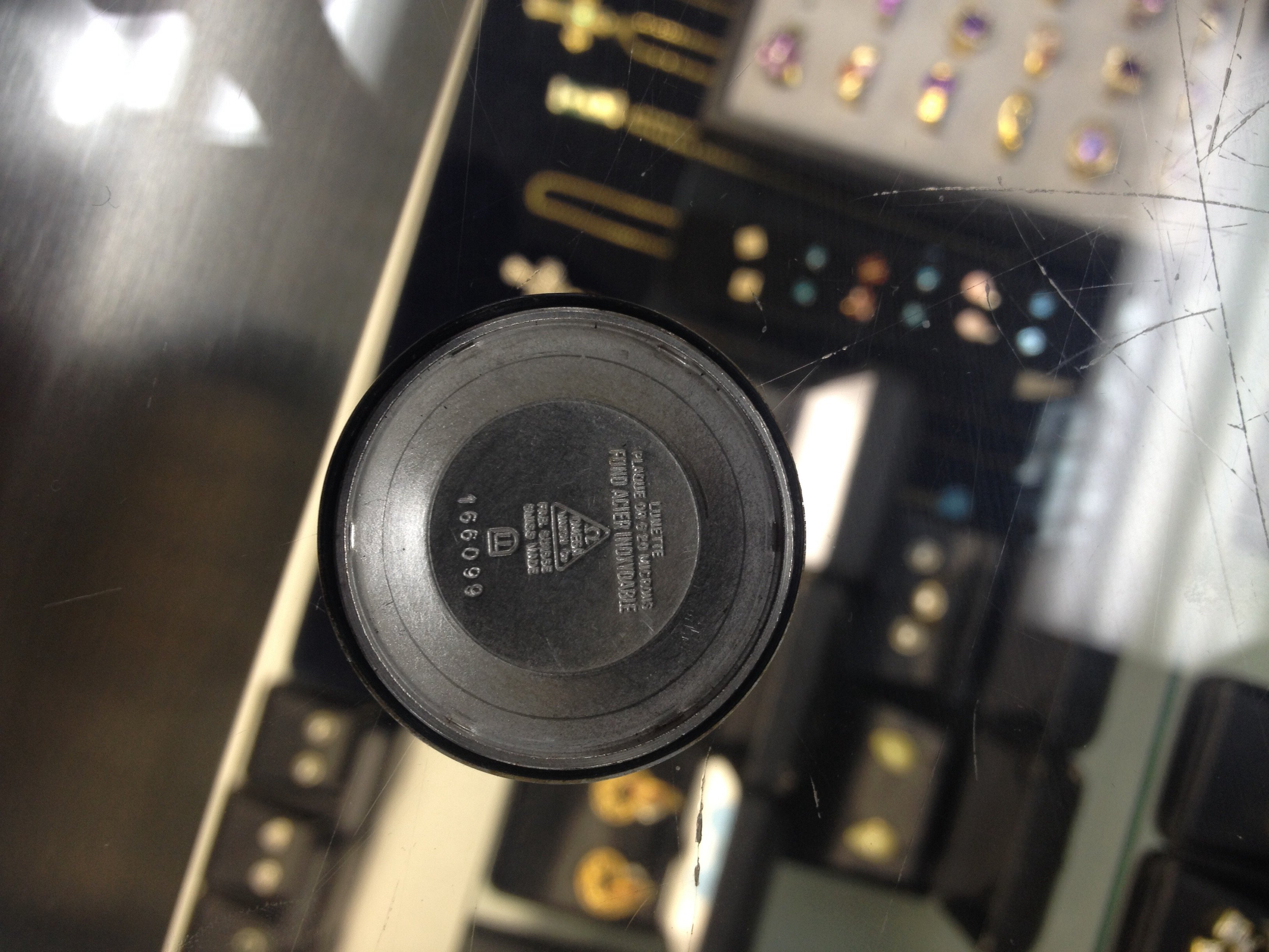

Here's a pic of the case back. Also I have a pic of the movement but it has the serial number on it. Is that OK to post? # is in the 33,000 range which i believe dates it to 1971. Please let me know if i should post the inside pic and if this gives us any additional information.
thanks!!
33,531
38,205
I think that should be the case number, 166.099 being used by several while MD 366.0822 is the specific reference for this watch in gold plate as you have it.
