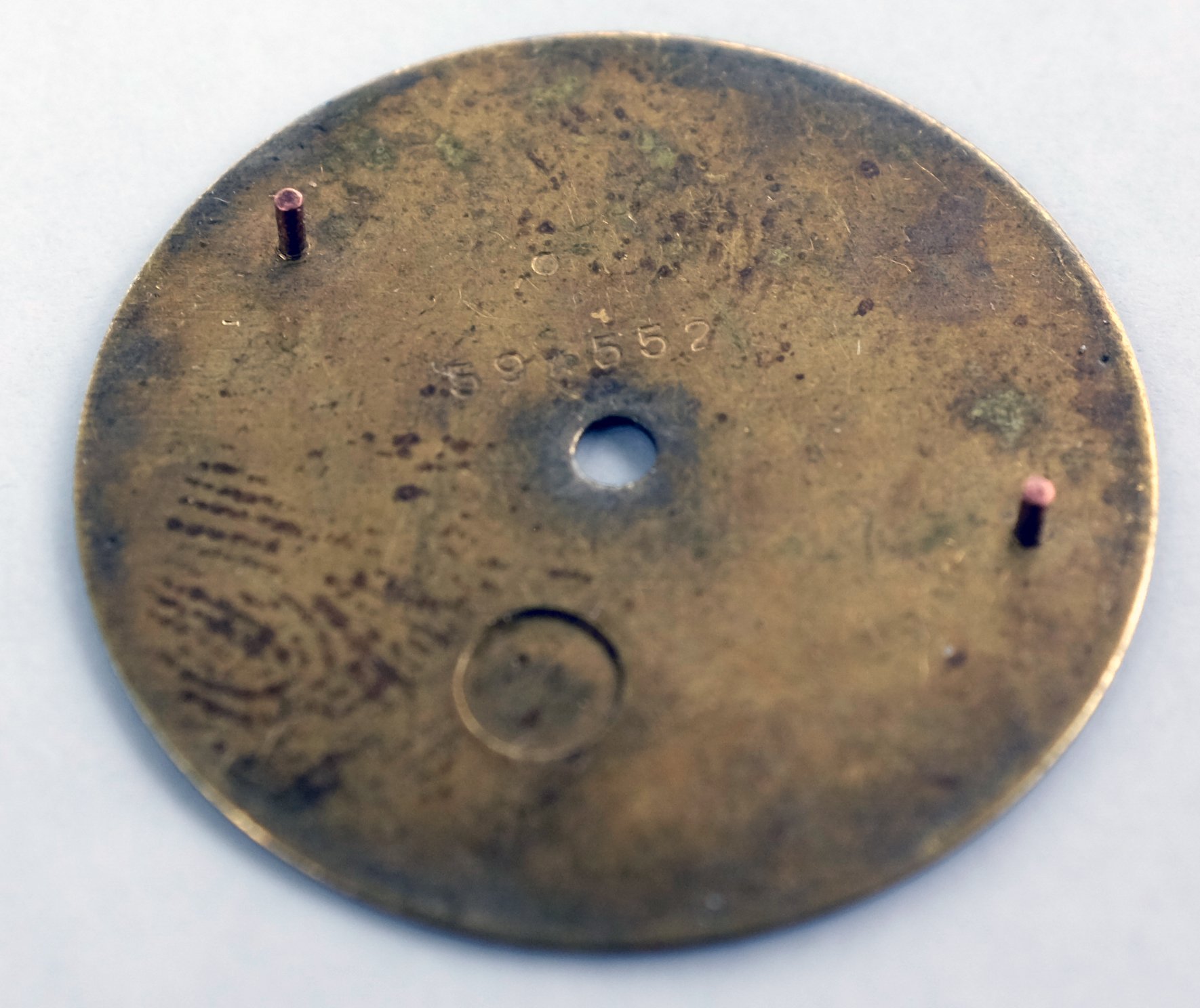

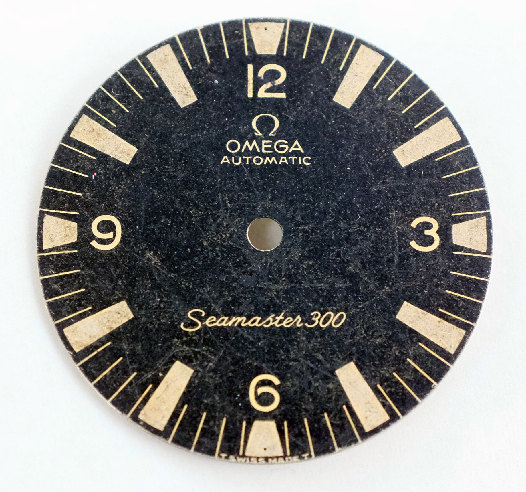

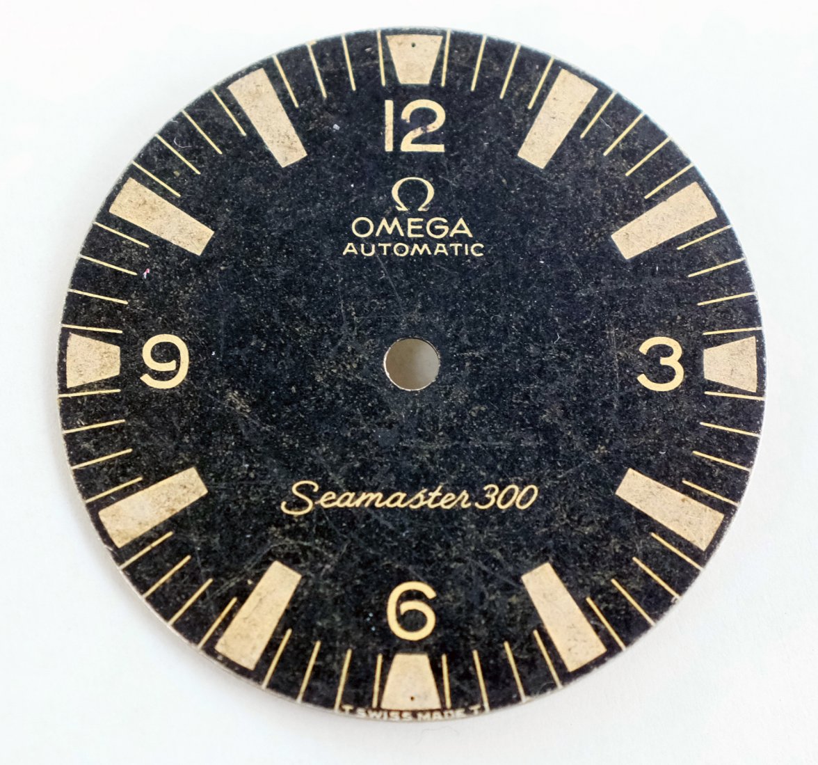

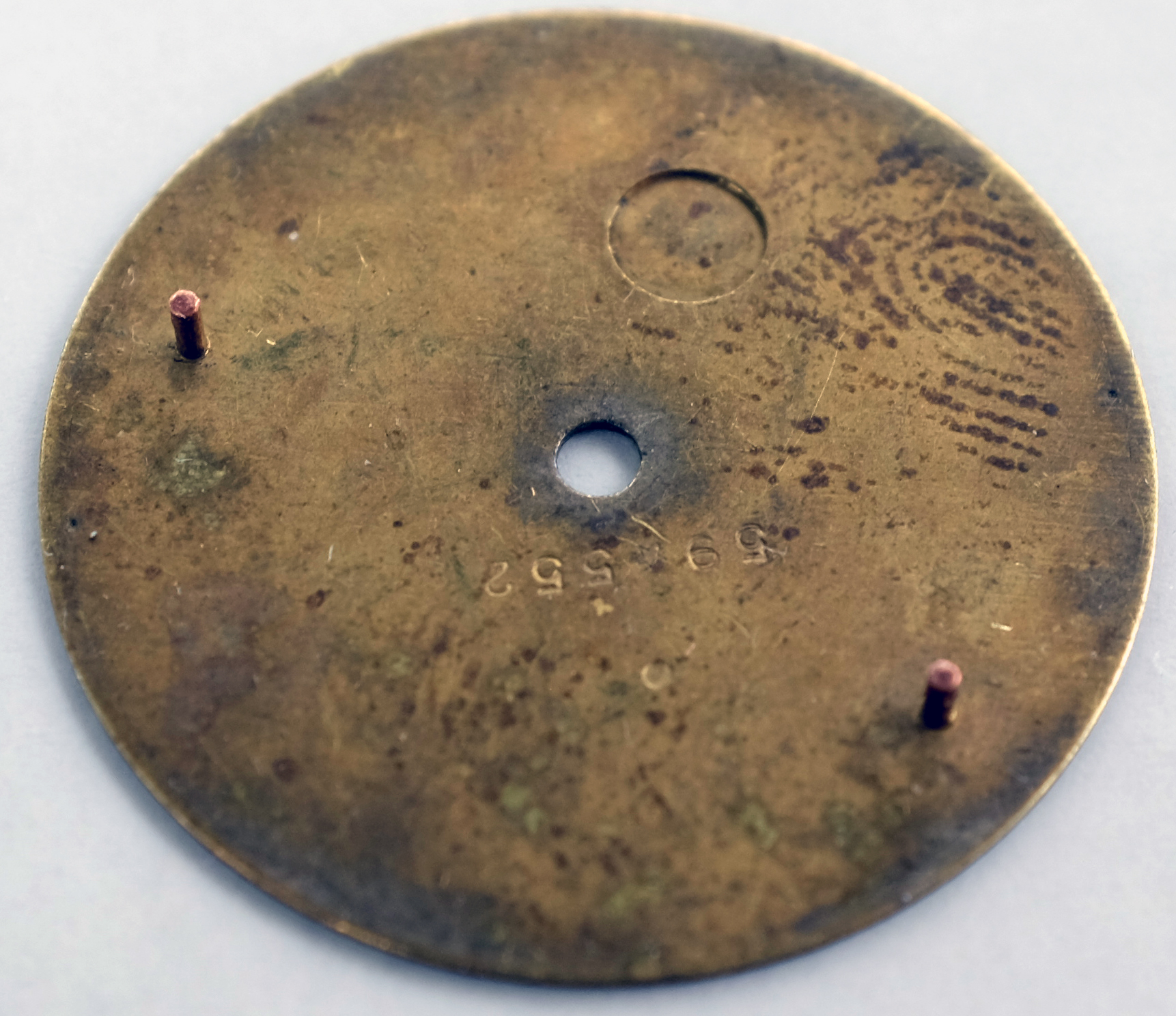

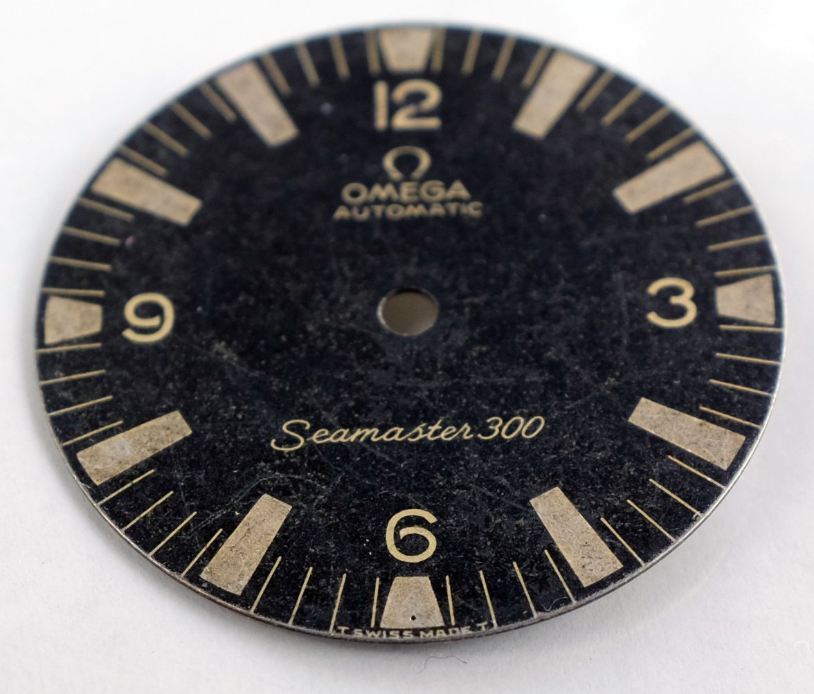

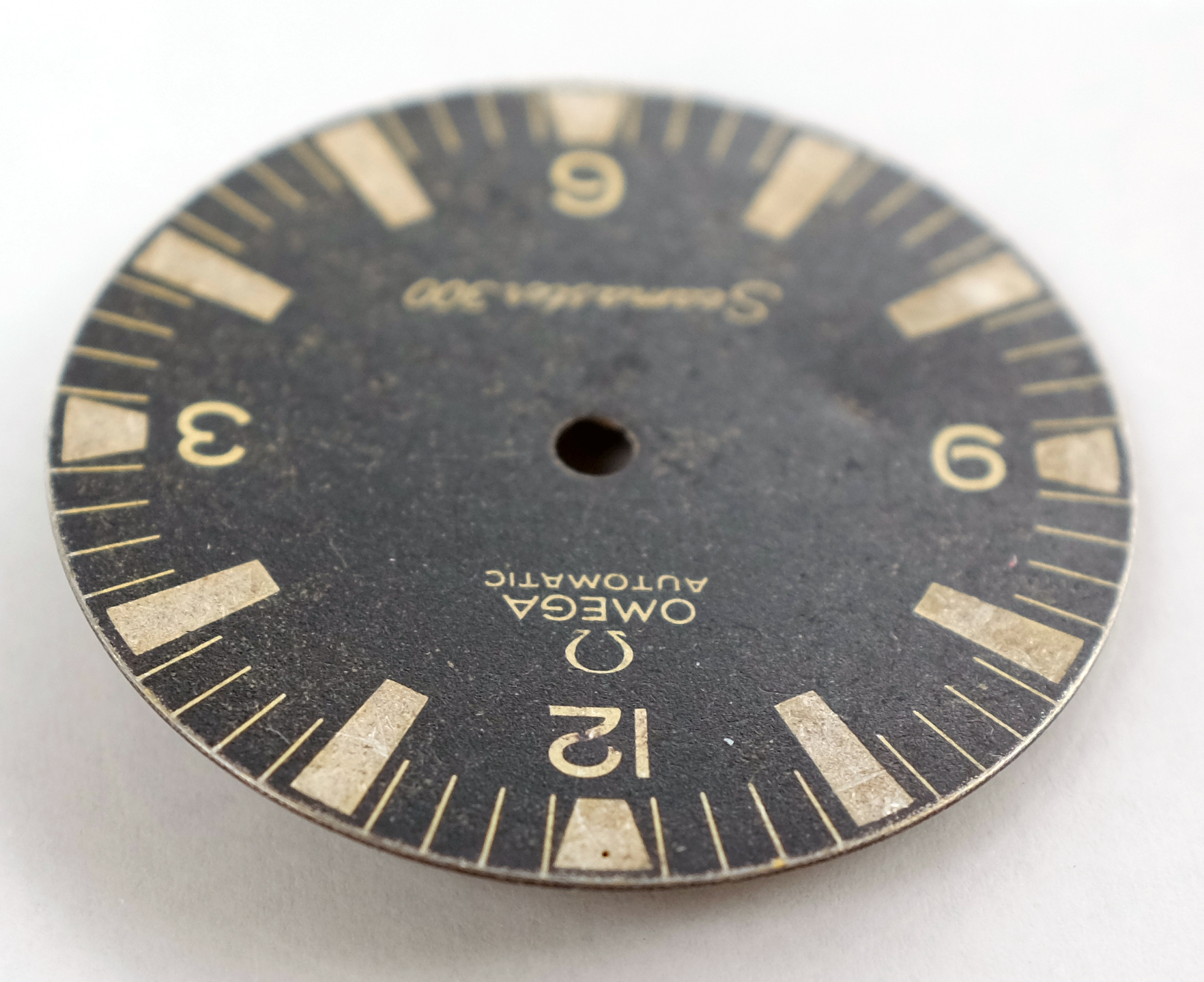

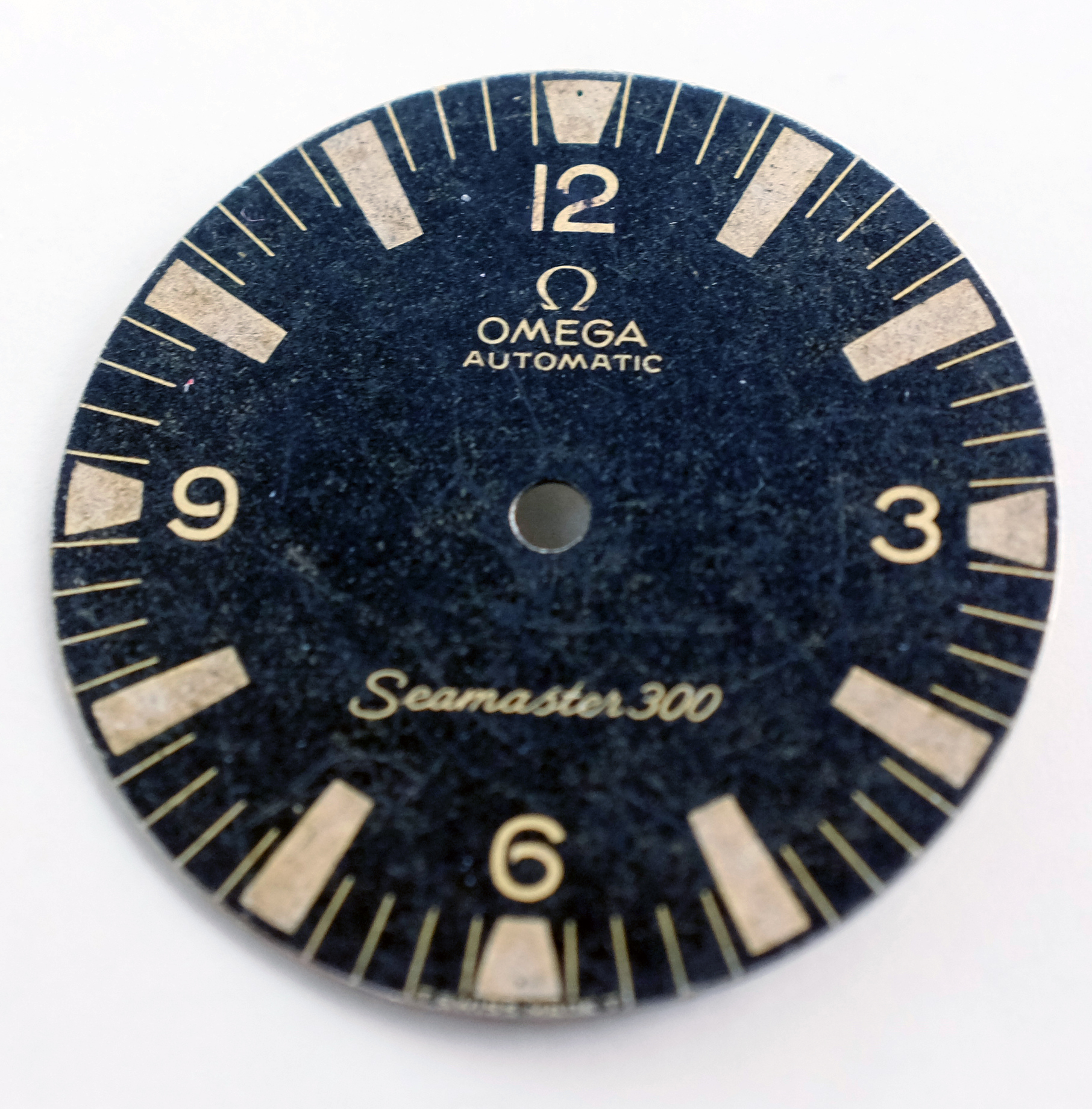

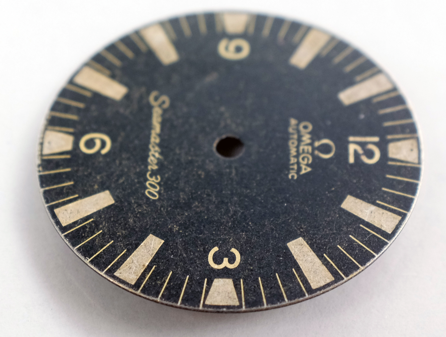

    Hi Guys.
    A couple weeks I posted this thread with a very poor photo to ID this dial...
    https://omegaforums.net/threads/help-id-this-dial-please.70136/#post-882936
    Now I have the dial in my hands I have taken some clear pictures. I was hoping someone here can lock down the specific details of the dial as I know there are a number of variants...
    The number (and symbol) stamped on the back is... 5 9 (STAR) 5 9 2
    Here we go..

    I guess my first question is, is there any difference between a 165.014 or 165.024 dial?
  4. Omegist Feb 18, 2018
    356
    469
    The 165.014 dials in this design are marked “Swiss Made” only - without “T”
    IMeasure likes this.
  5. IMeasure Feb 18, 2018
    77
    61
    Thanks for narrowing down the model for me its much appreciated!

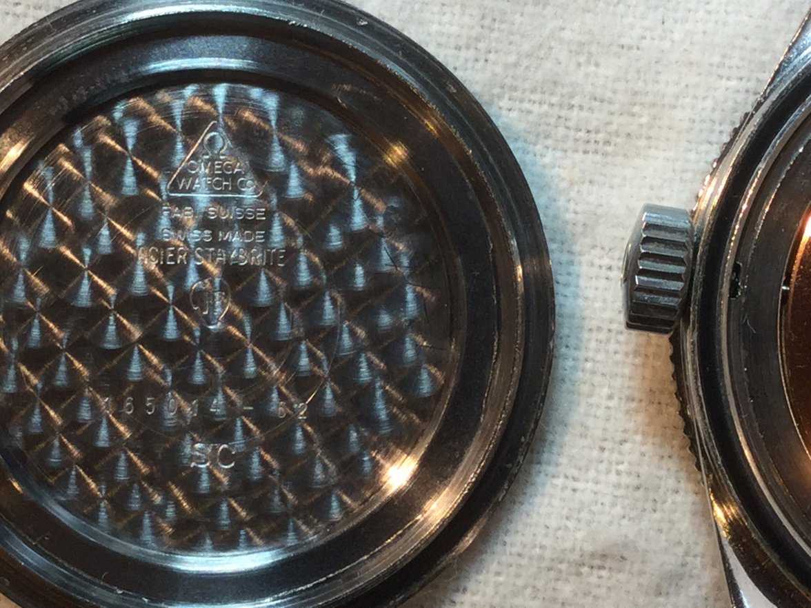

  6. gemini4 Hoarder Of Speed et alia Feb 18, 2018
    5,855
    16,584

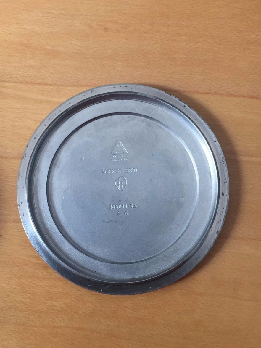

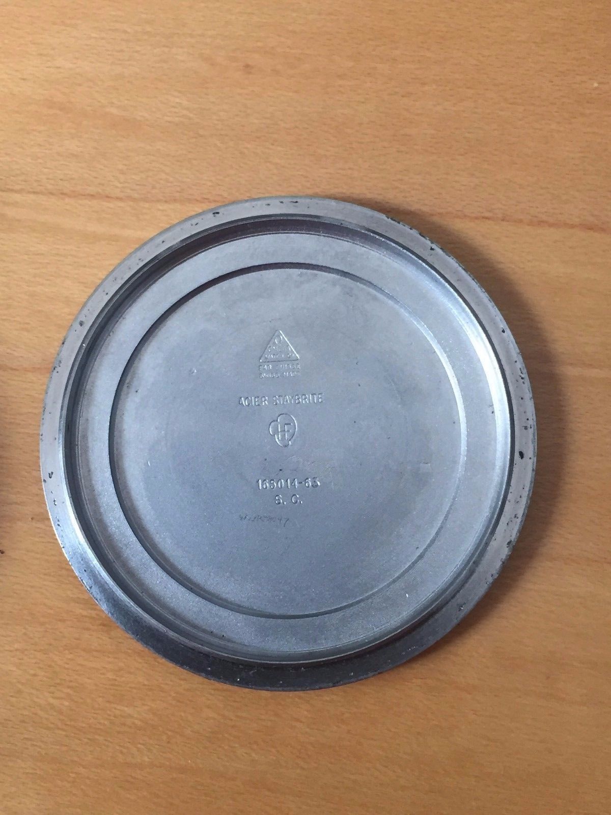

    I believe most 165014-63 and the 165014-64 are tritium and can use your dial.
    Perhaps some 165014-62 although mine has radium lume and the older 14755 type dial
  7. gemini4 Hoarder Of Speed et alia Feb 18, 2018
    5,855
    16,584
    Pet Peeve Alert. No dot in 165014 :whipped:
  8. IMeasure Feb 18, 2018
    77
    61
    You will havh to elaborate as I'm not sure what you are referefer too.

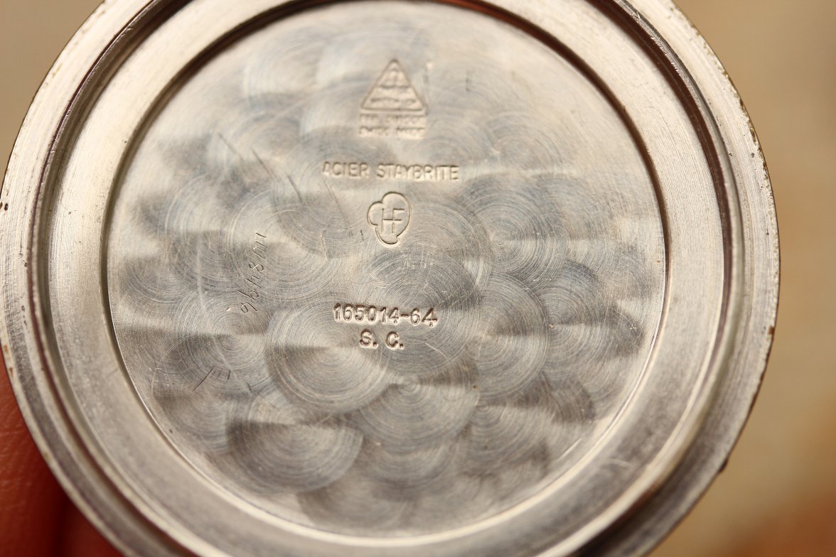

  9. gemini4 Hoarder Of Speed et alia Feb 18, 2018
    5,855
    16,584
    Your title refers to a reference 165.014........aka 165 DOT 014.
    There is no “period” in these references. 165014-62,63,64.
