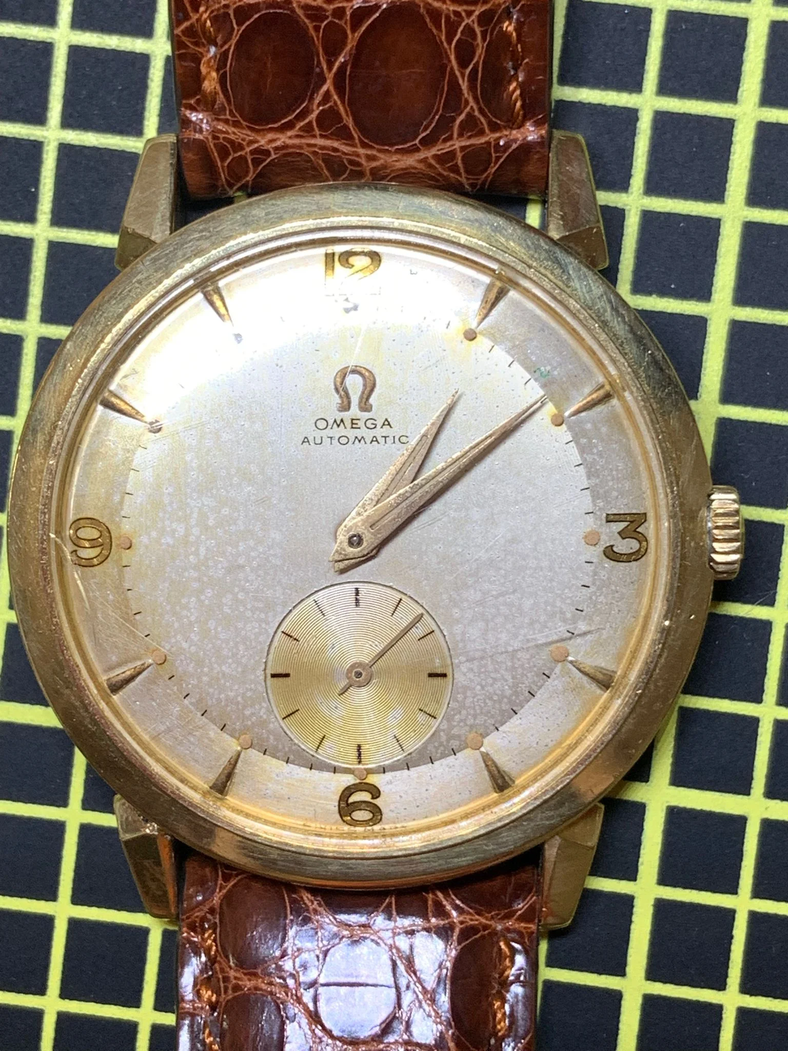

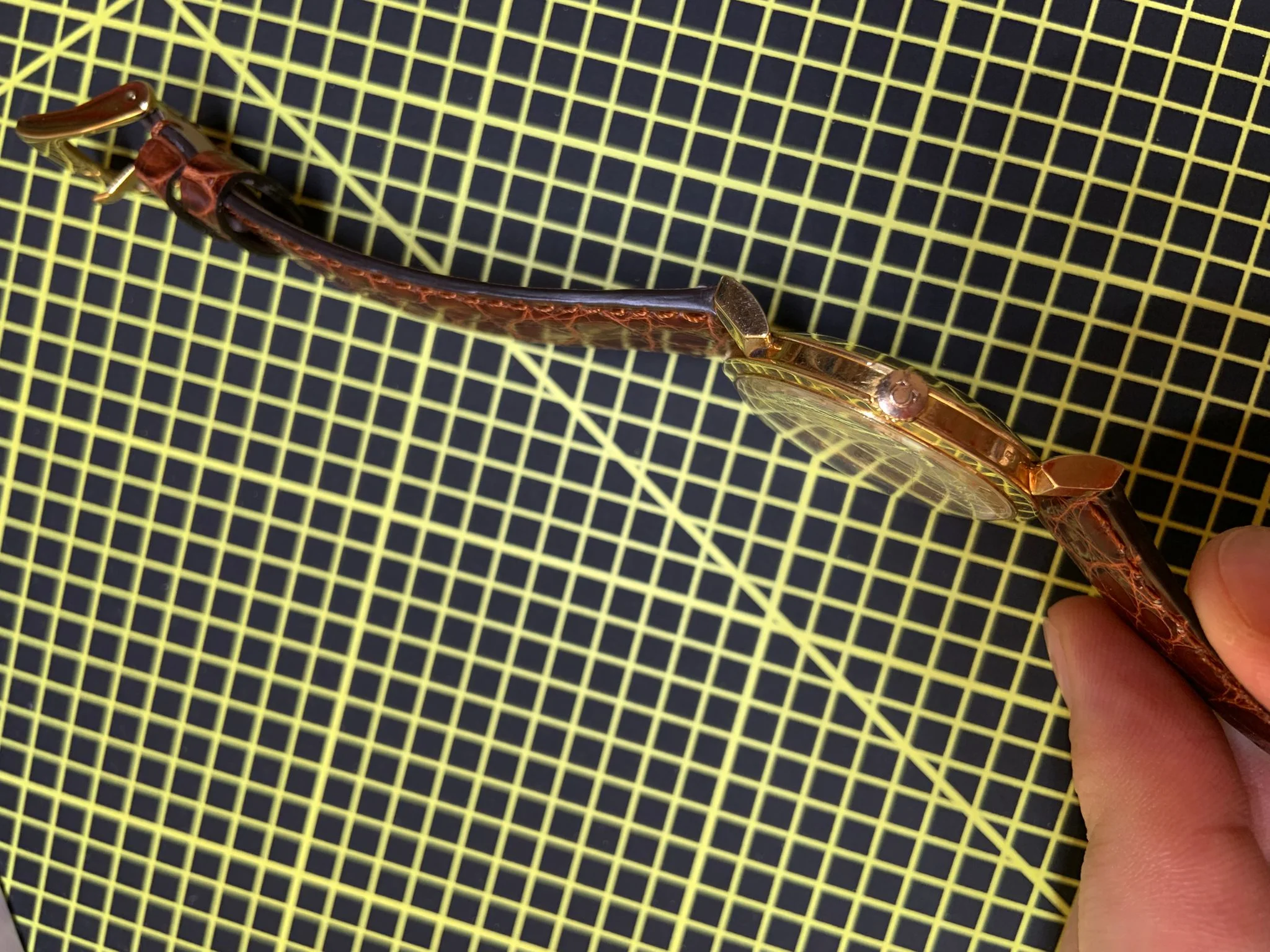

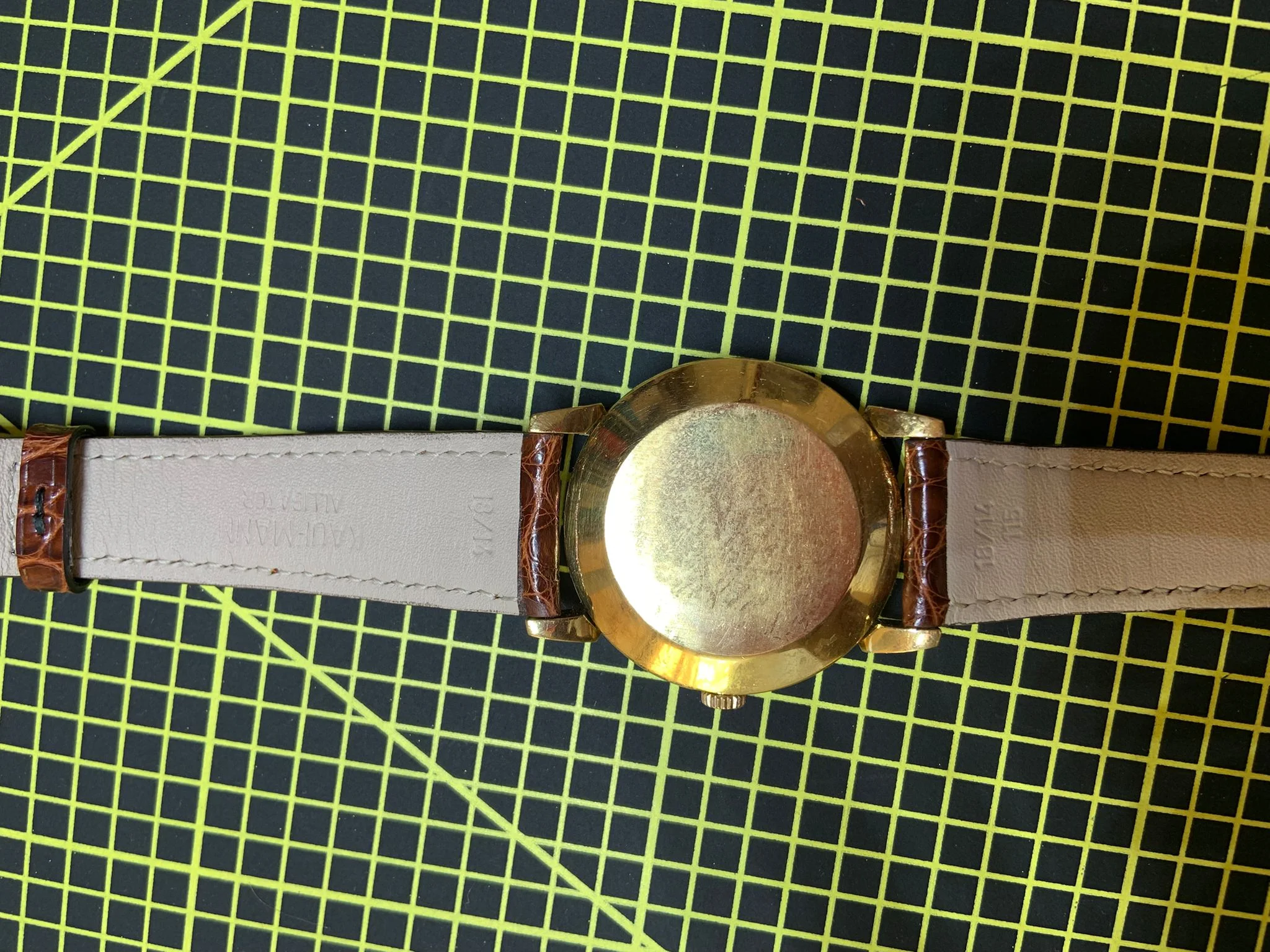

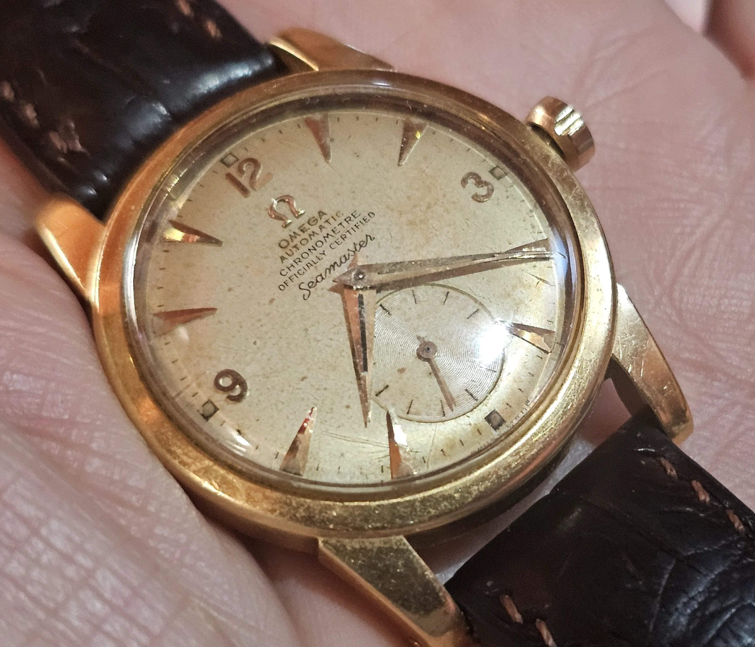

Hello Omega Forum,
i recently bought this Omega after only a small consideration cause i like the look and now want to know more about it.
What i know so far is:
18 kt Caseback and 343 Caliber (the Seller opened the caseback before i bought it, but i didnt make any photos, and after reading https://omegaforums.net/threads/vintage-omega-posting-guide.383/ , i will go to a watchmaker in some time to get it opened again and can post photos then)
18 kt Case (Helvetia Stamp on the Side)
I looked through the https://www.omegawatches.com/vintage-watches for caliber 343 and found no matches.
There is lume on the dial, which also doesnt match any of the watches i found while browsing for a bit.
Greetings Tobias

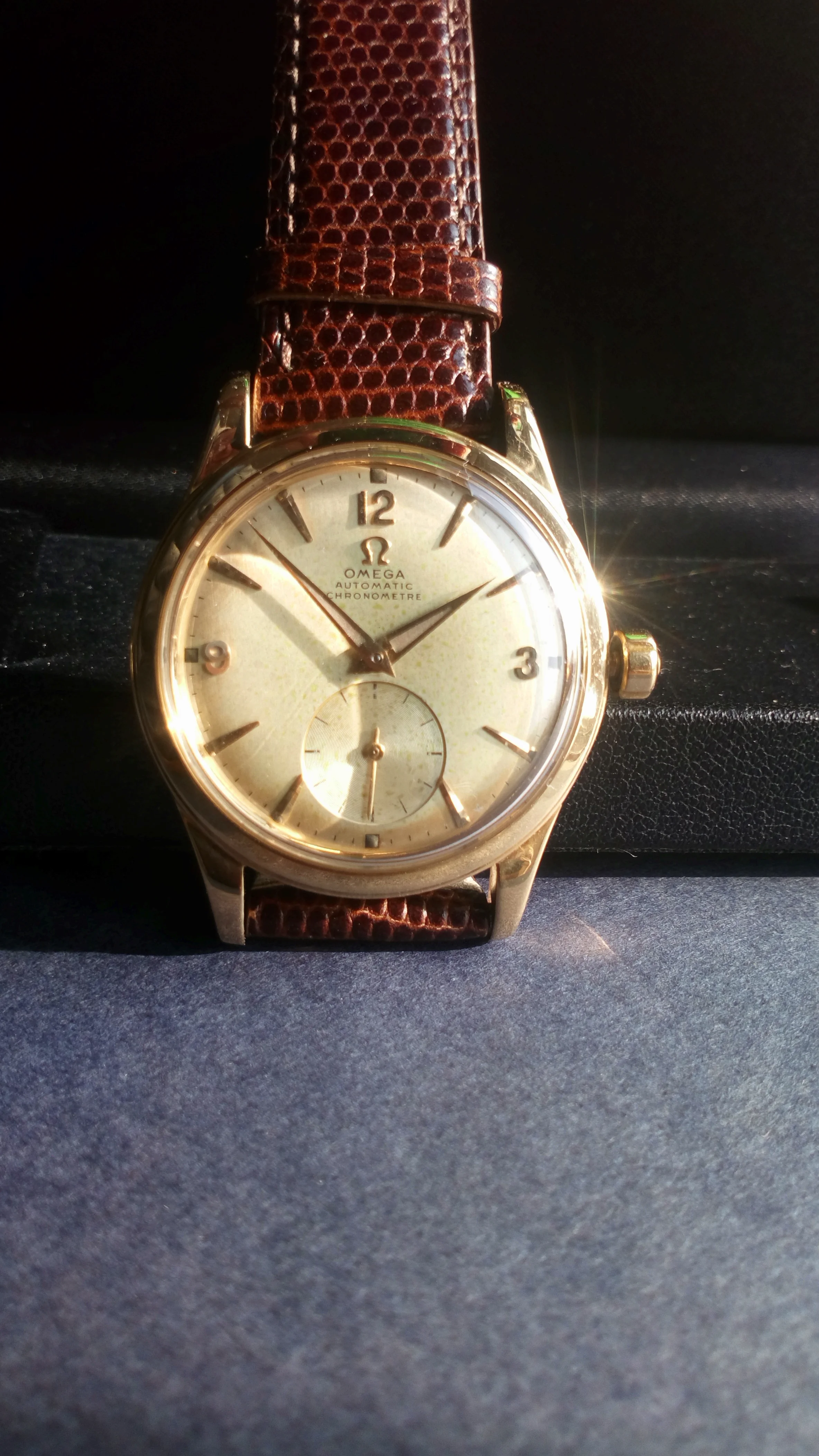

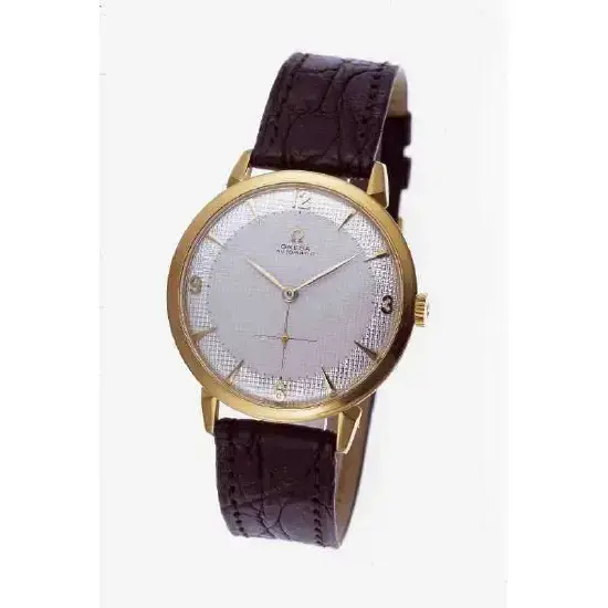

Hello, Tobias, and welcome. I was a little surprised you found nothing - I selected for cal 343 and found four matches: see this link to their website.
Only about 5,000 of this movement were produced, so it is not that commonly seen. According to the Omega Museum as well as the corporate site, it is associated with the Centenary and the launch versions of the original Seamaster (whose very earliest examples did not have the sub-branding on the dial). Here is what you're looking for.
It will be interesting to hear what you find out - good luck.
