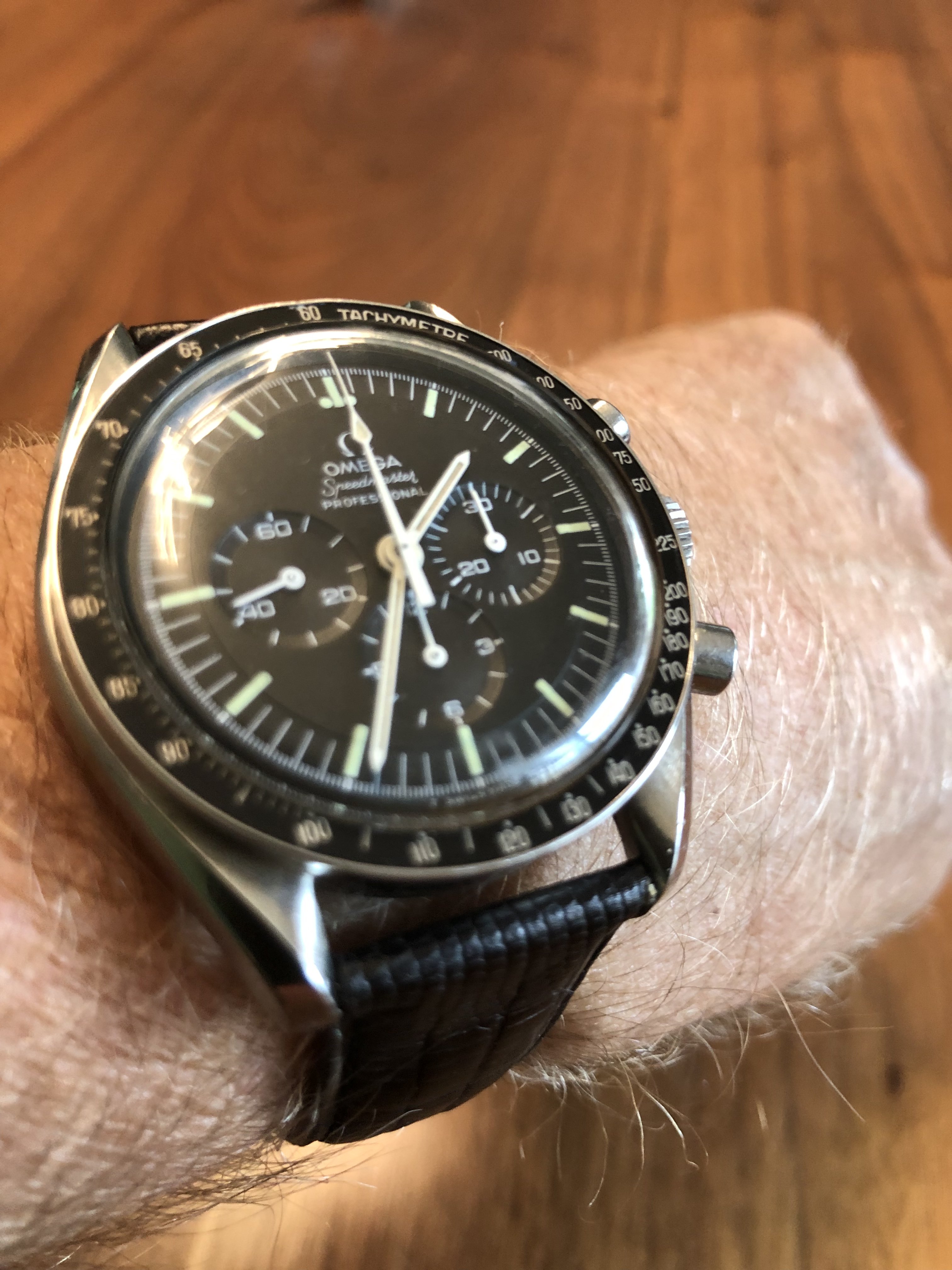

I didn’t know when I did it but I scratched the crystal on my Speedmaster 145 022 69 ST.
I hope someone can give me some advice on how to polish without ruining it.

Tape off the bezel with masking tape. Get a tube of PolyWatch and follow the directions. There are video tutorials on YouTube.
7,797
14,399
Those look like pretty deep scratches, start with Polywatch but you may need something stronger.

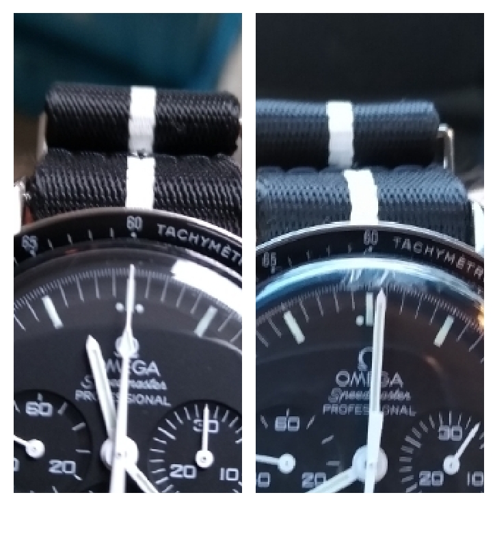

I had a small but deep scratch in my 1861 crystal (look above 12 o'clock - After on the left in the picture). You could feel it with your fingernail. Polywatch did a very nice job on it. . Let us know how it turns out and good luck!

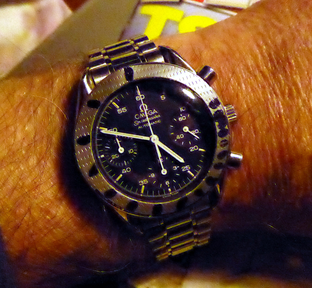

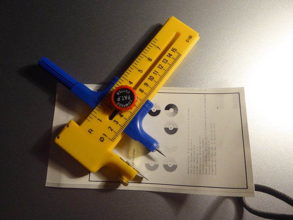

For effective bezel protection get one of these circle cutters from pretty much any hobby or craft shop, measure the bezel and take a sticky label (this is a discarded test page from my label printer).
Then your bezel is well protected -- no, I don't usually use gorilla tape, it was just handy at the time.

Nice tip. Out of curiosity, what purpose do the marks on the tape serve?
Just an old photo. There was a discussion a couple of years ago about obtaining a tachy bezel, this was my DIY version.

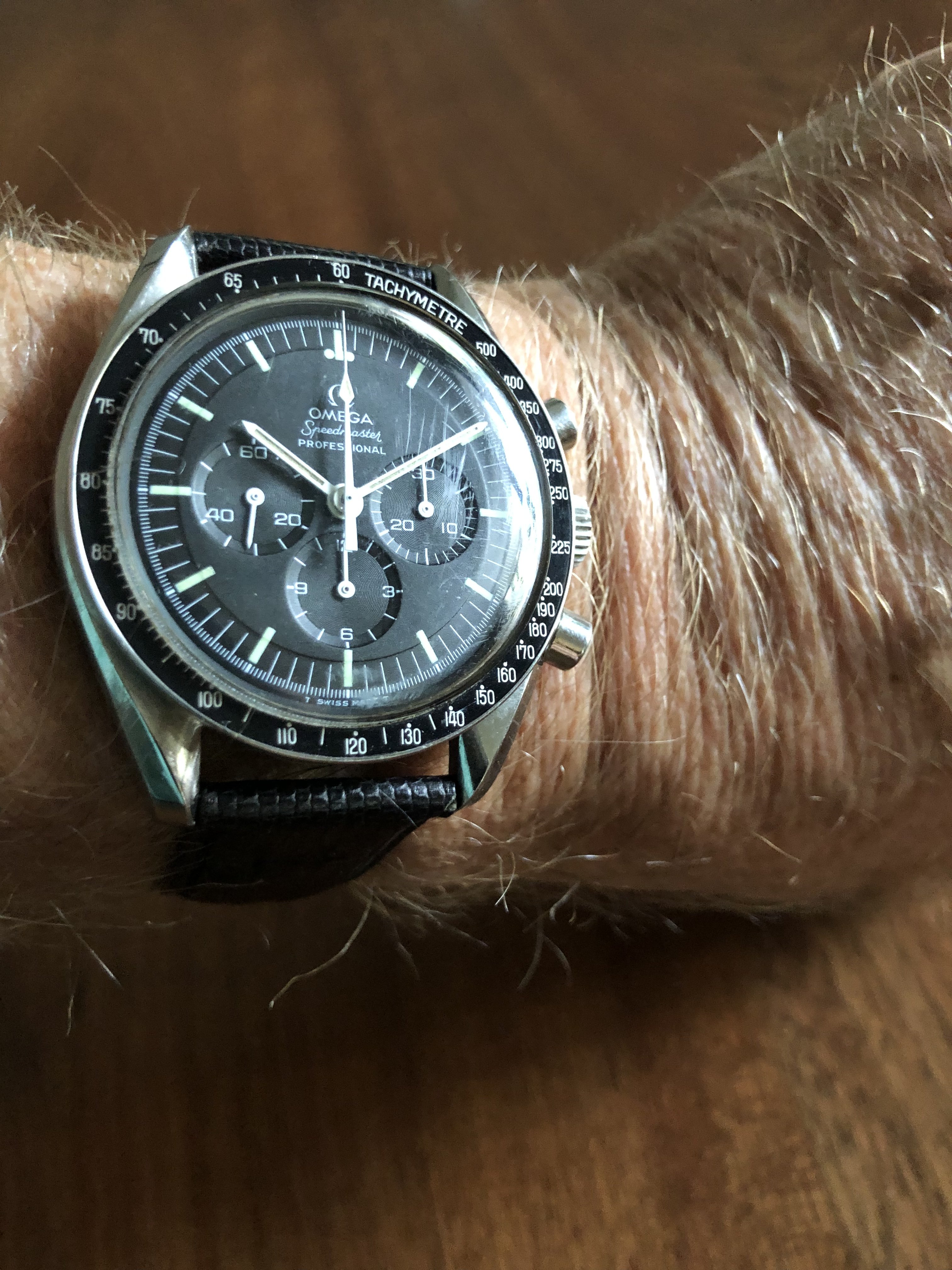

Wanted to follow up with and THANK everyone who jumped in to help me with my scratched crystal. Ordered the PolyWatch and followed the directions on the tube and just to be sure, watched a couple of YouTube. First time it worked really well. Here are before and after photos.
Again, Thank you all!

It's good stuff! Should be in the toolbox of any Hesalite owner. Glad it worked out. Looks great and beautiful watch.
