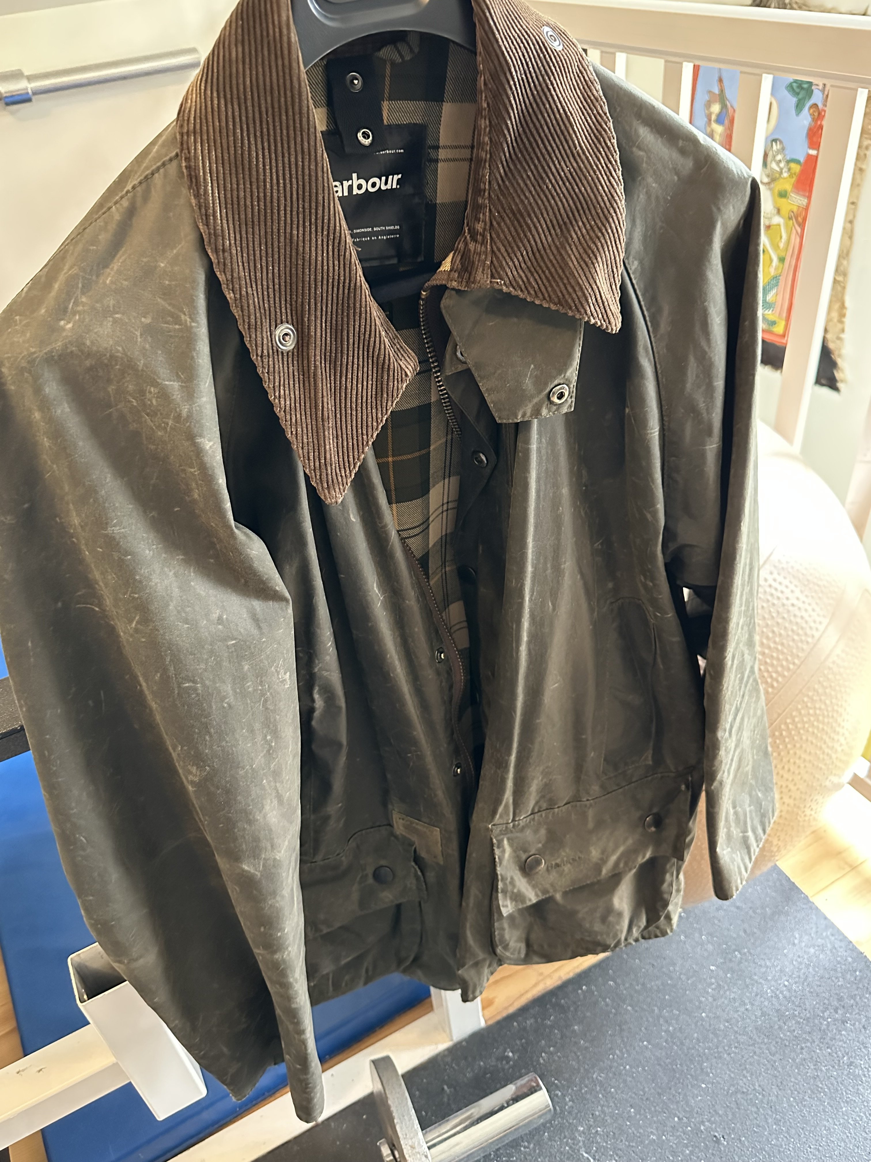

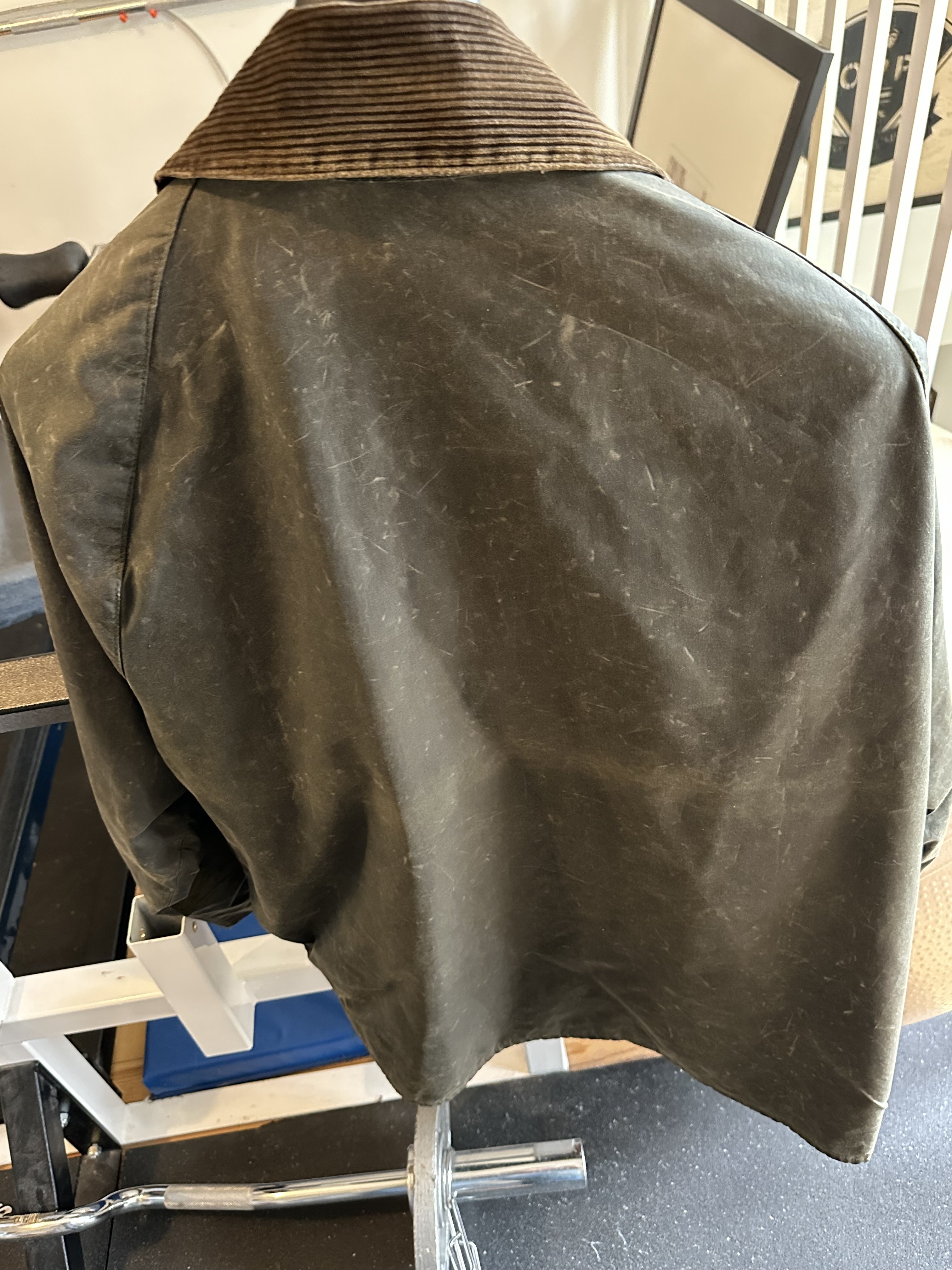

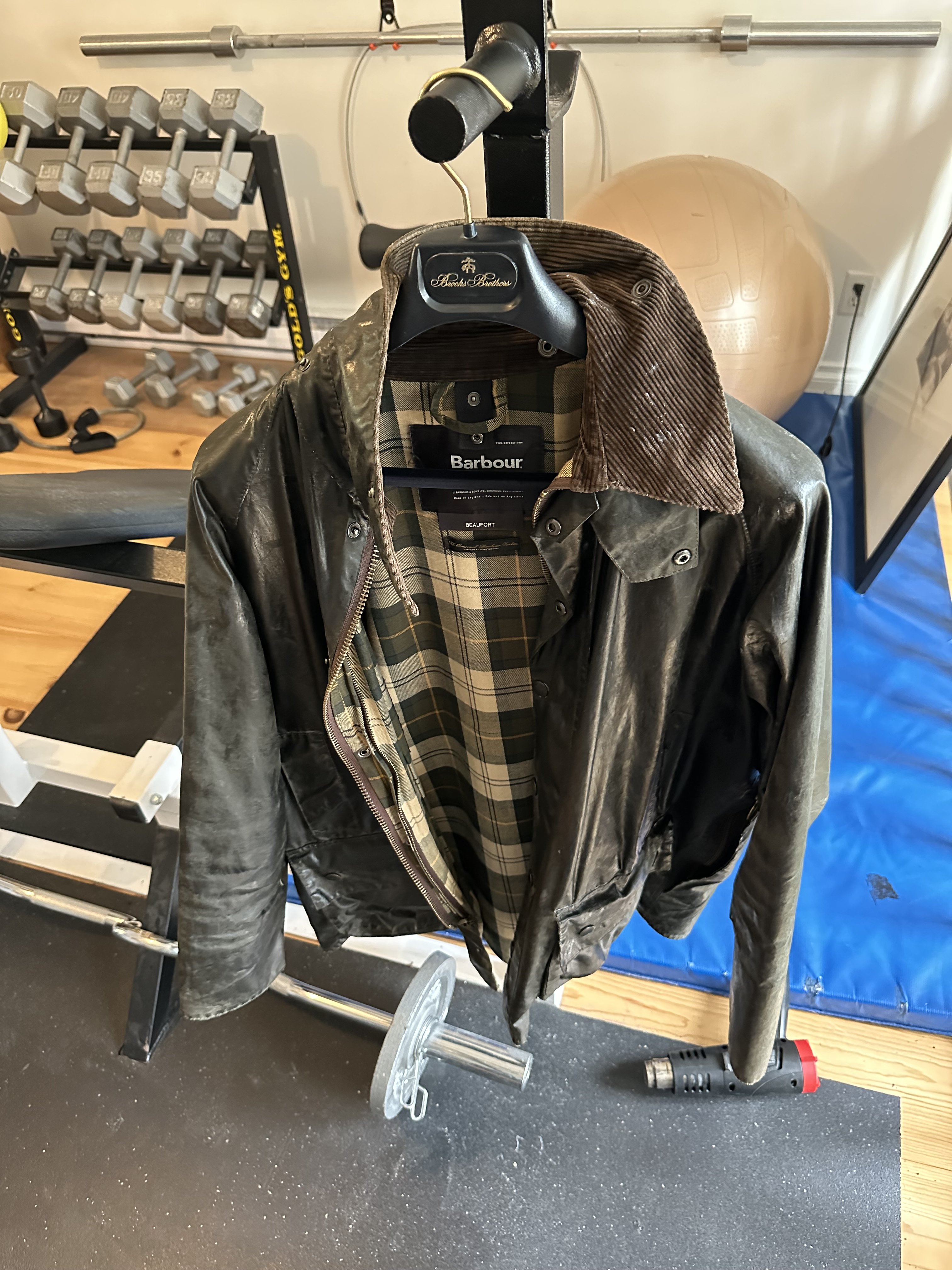

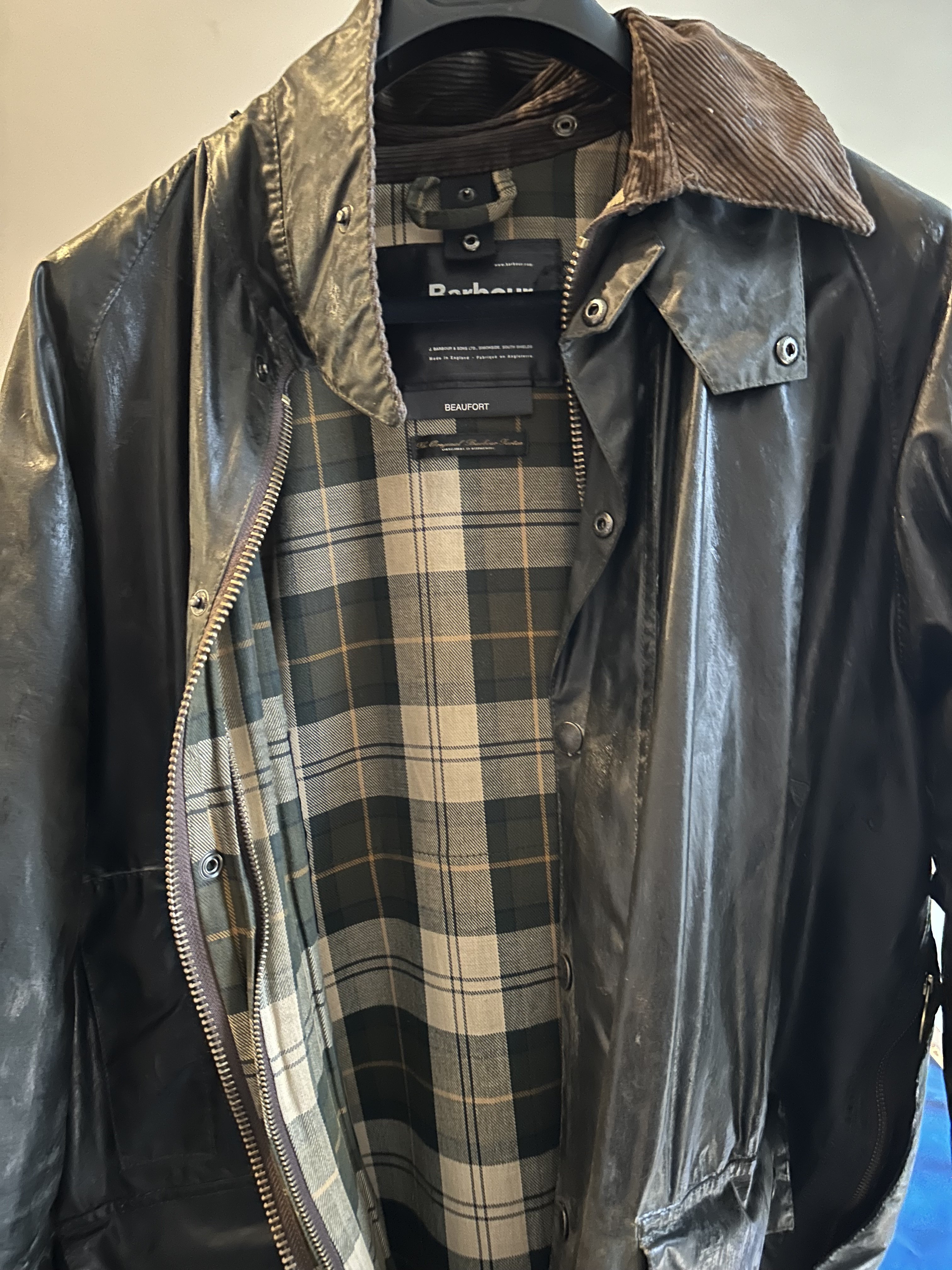

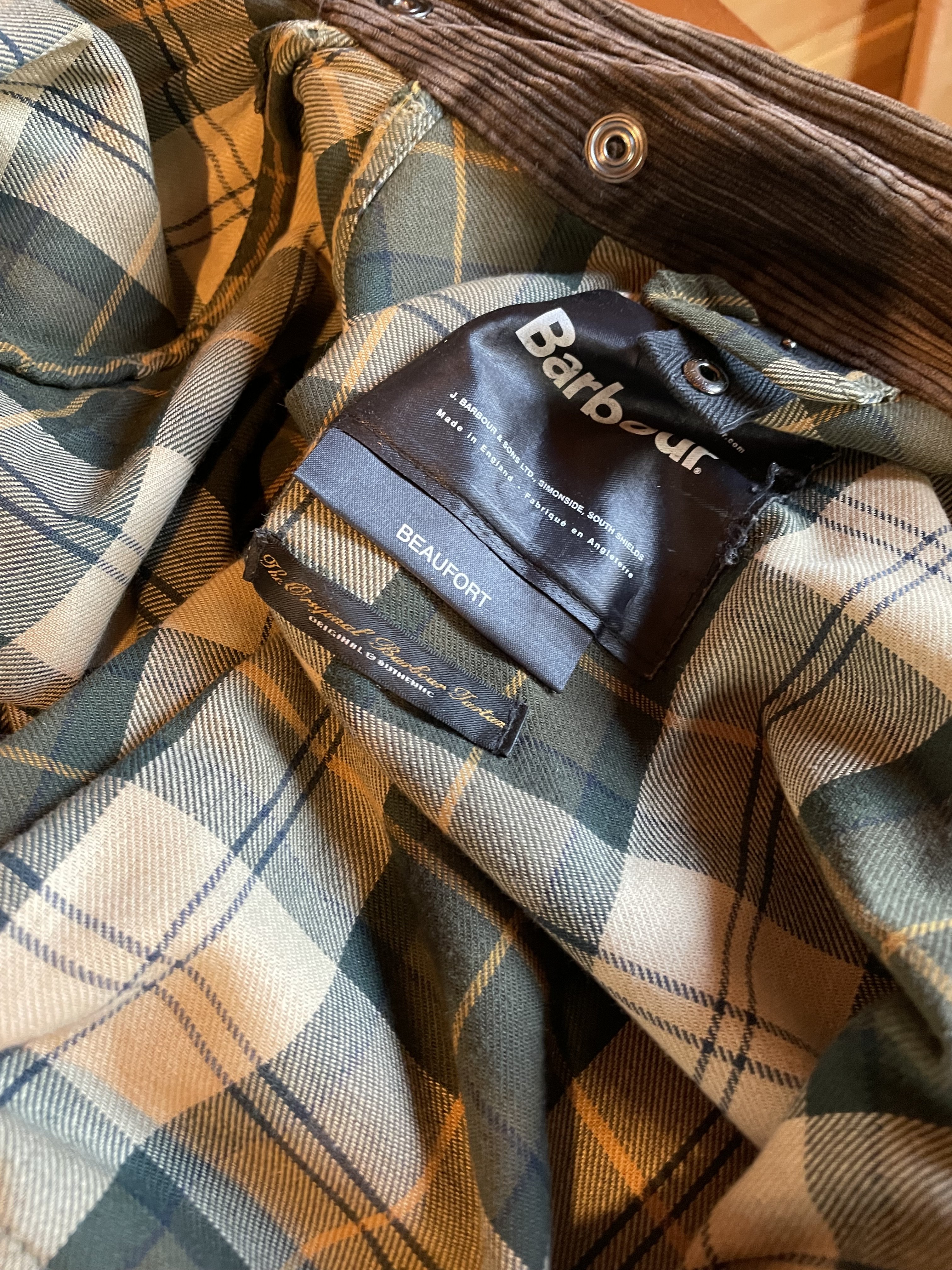

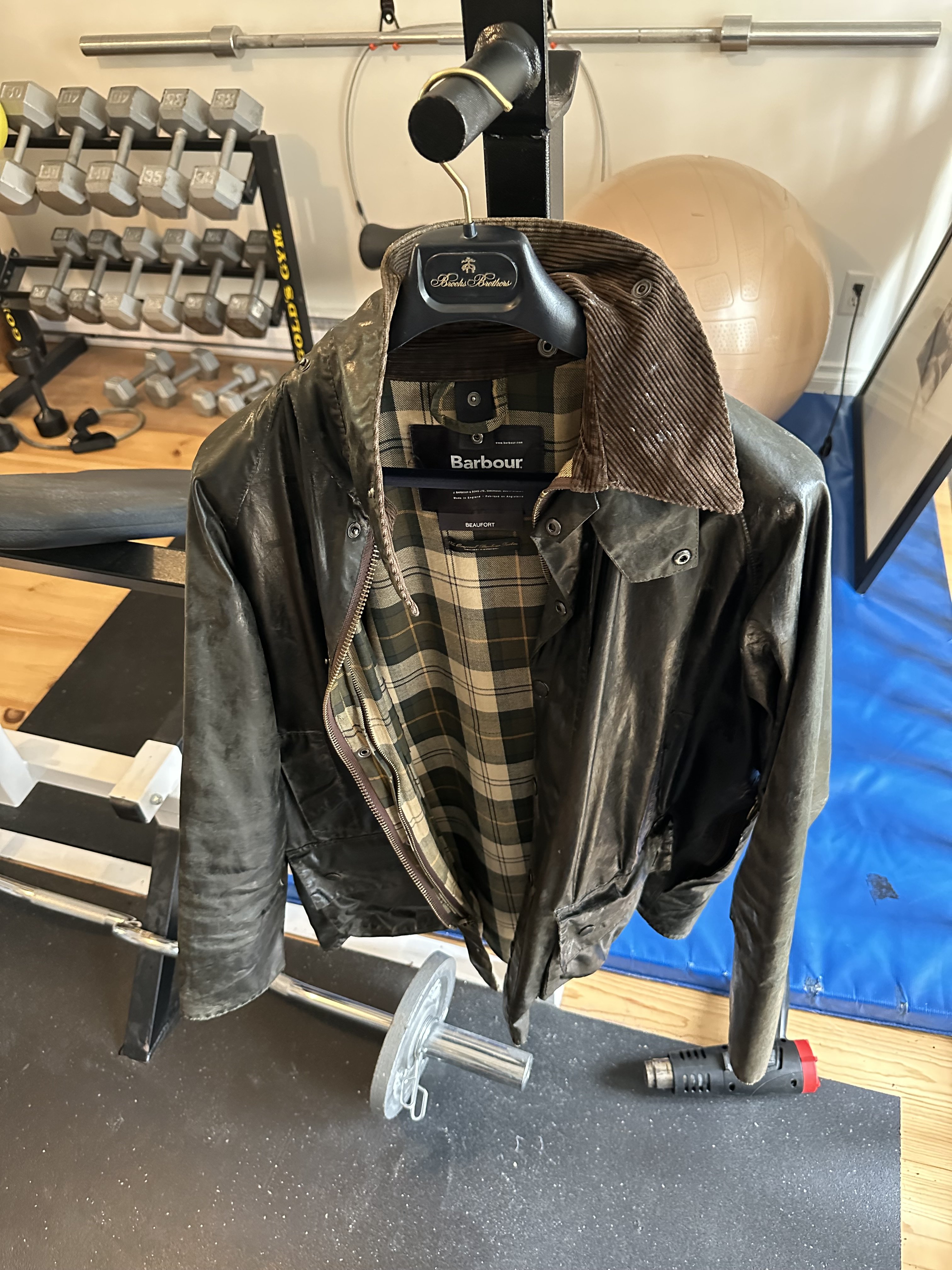

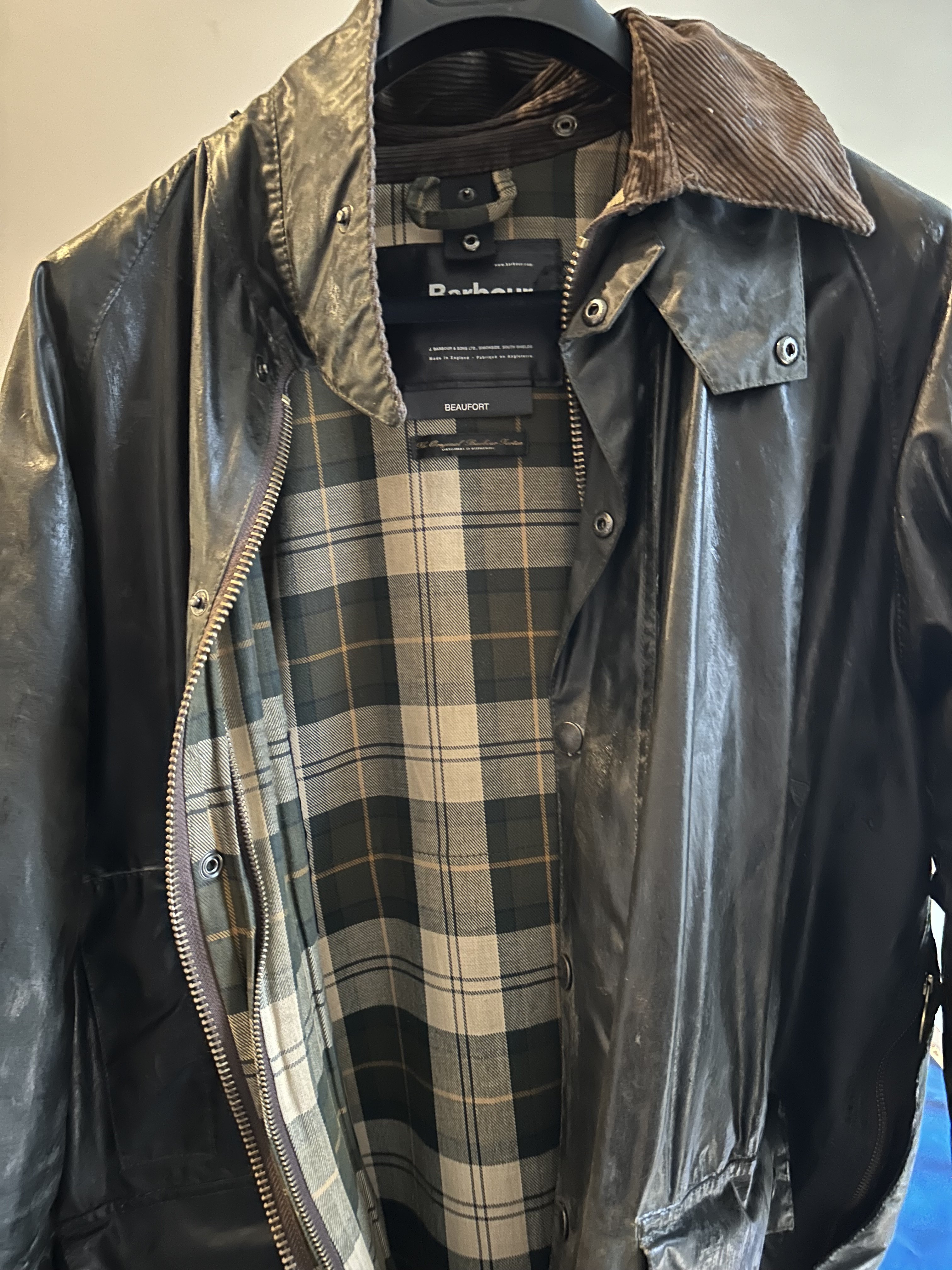

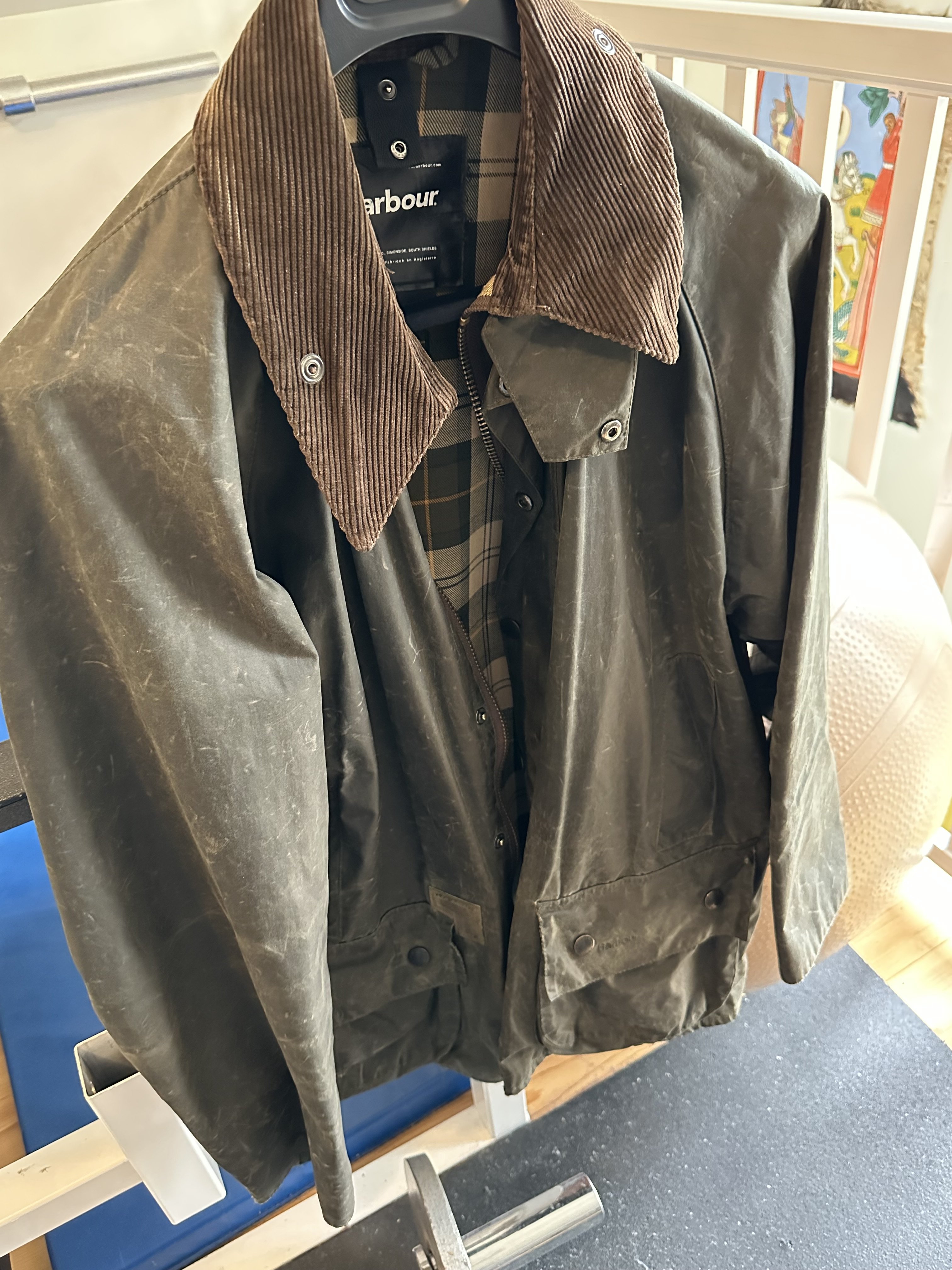

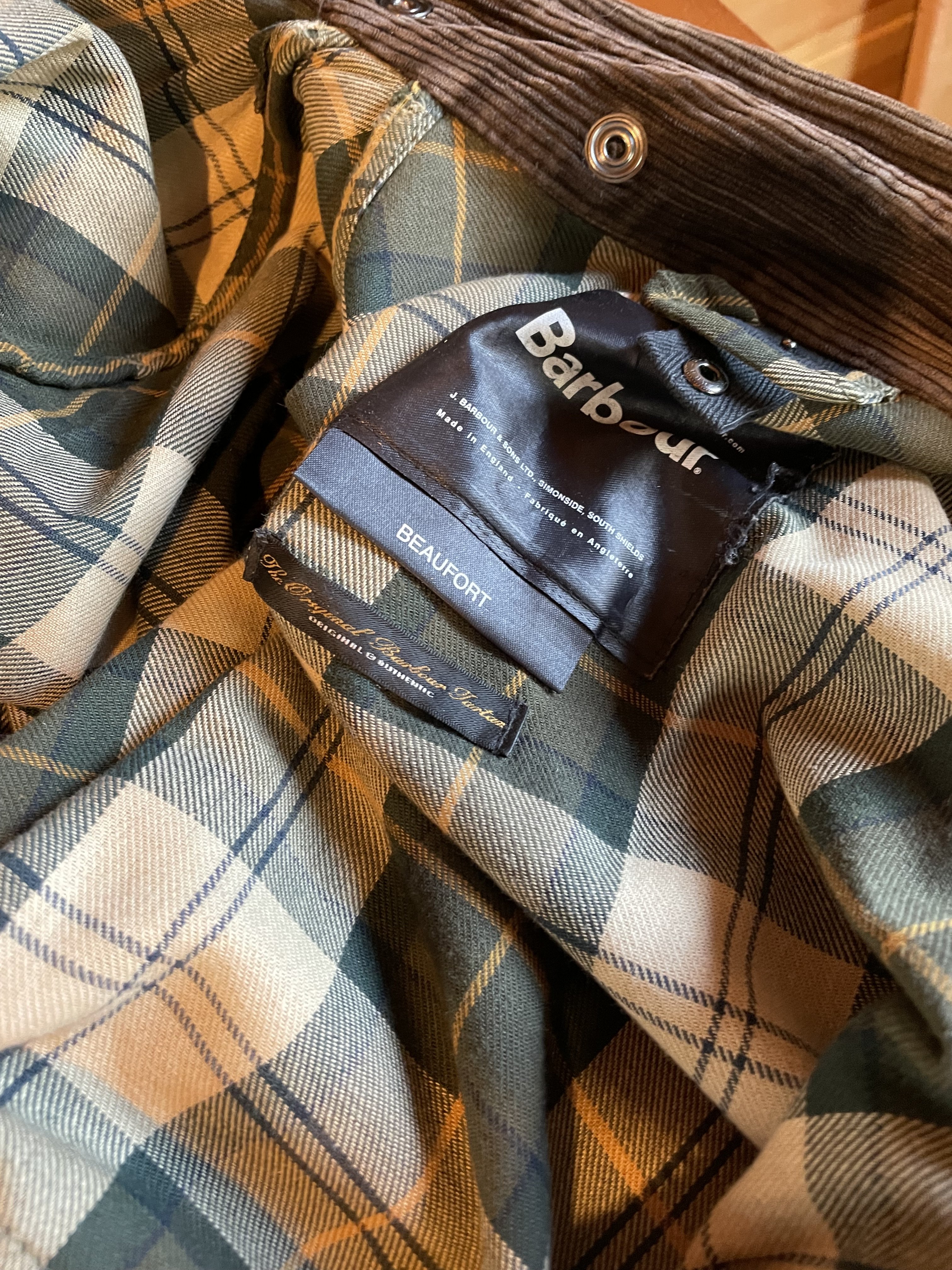

My wife bought a Barbour Beaufort for her vintage hobby. She has a booth at a local market with her best friend.
The jacket was inexpensive and in need of some care. Sending it to Barbour was the best option, but I was cheap labour (and likely broke some Barbour recommendations).

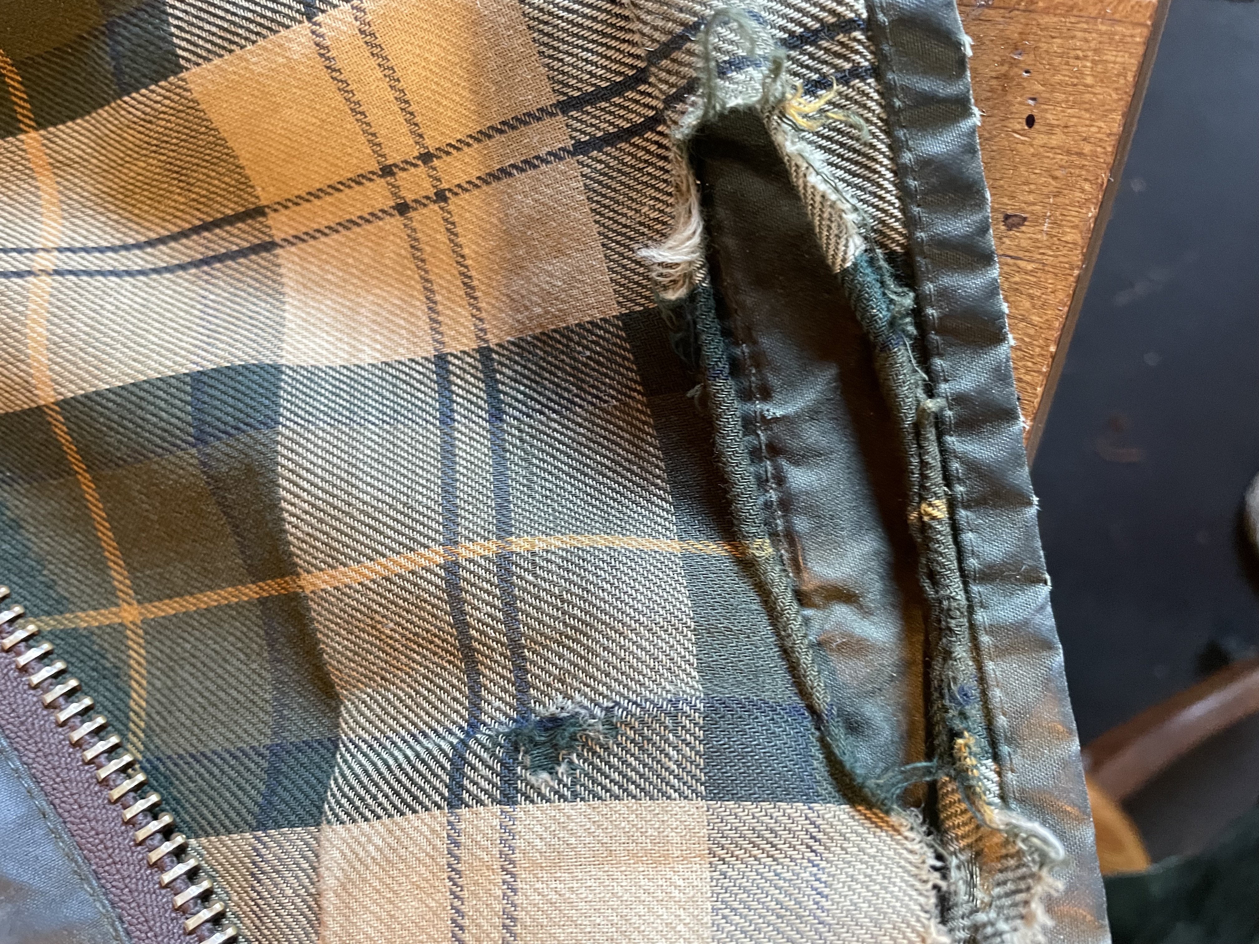

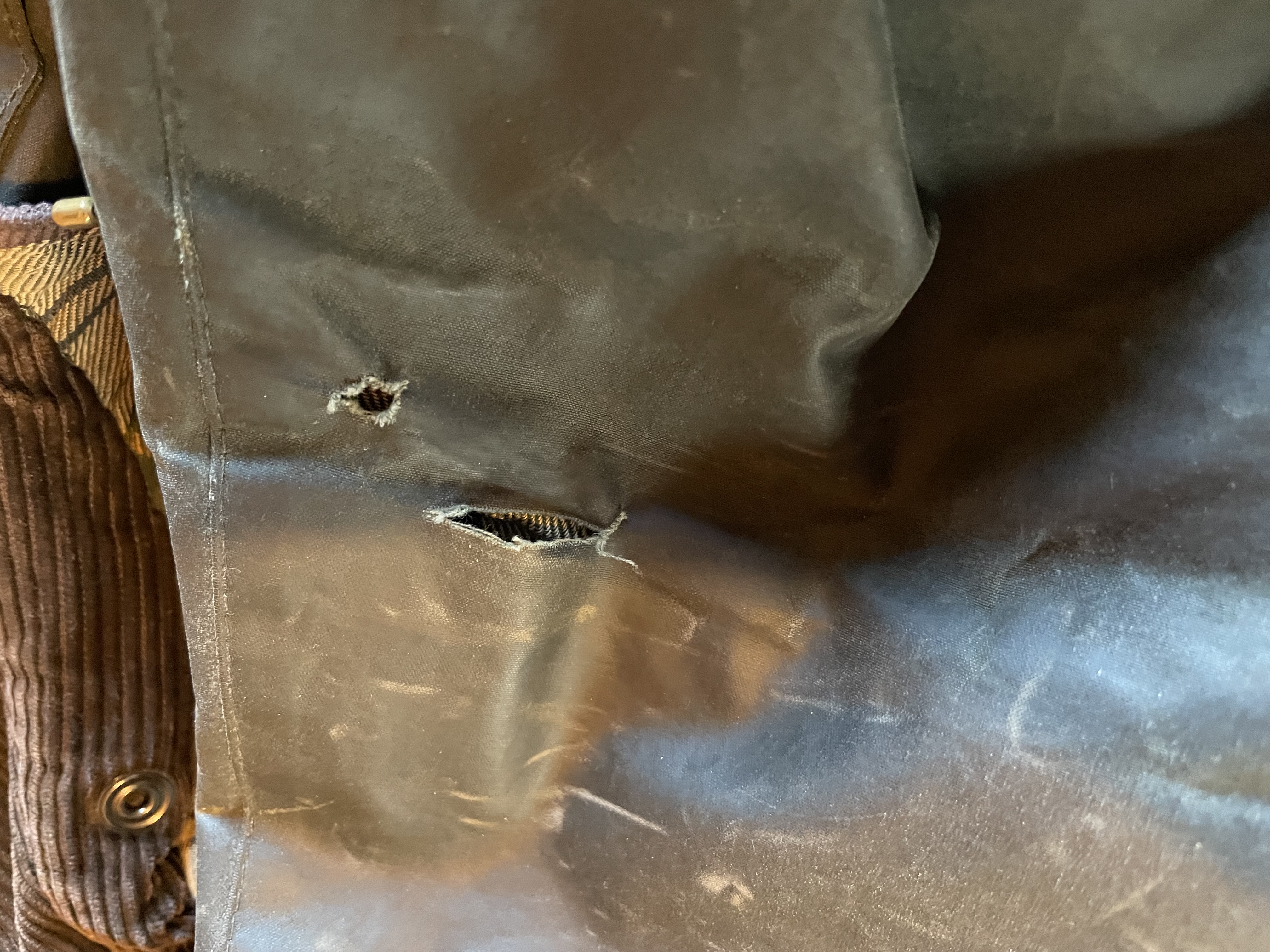

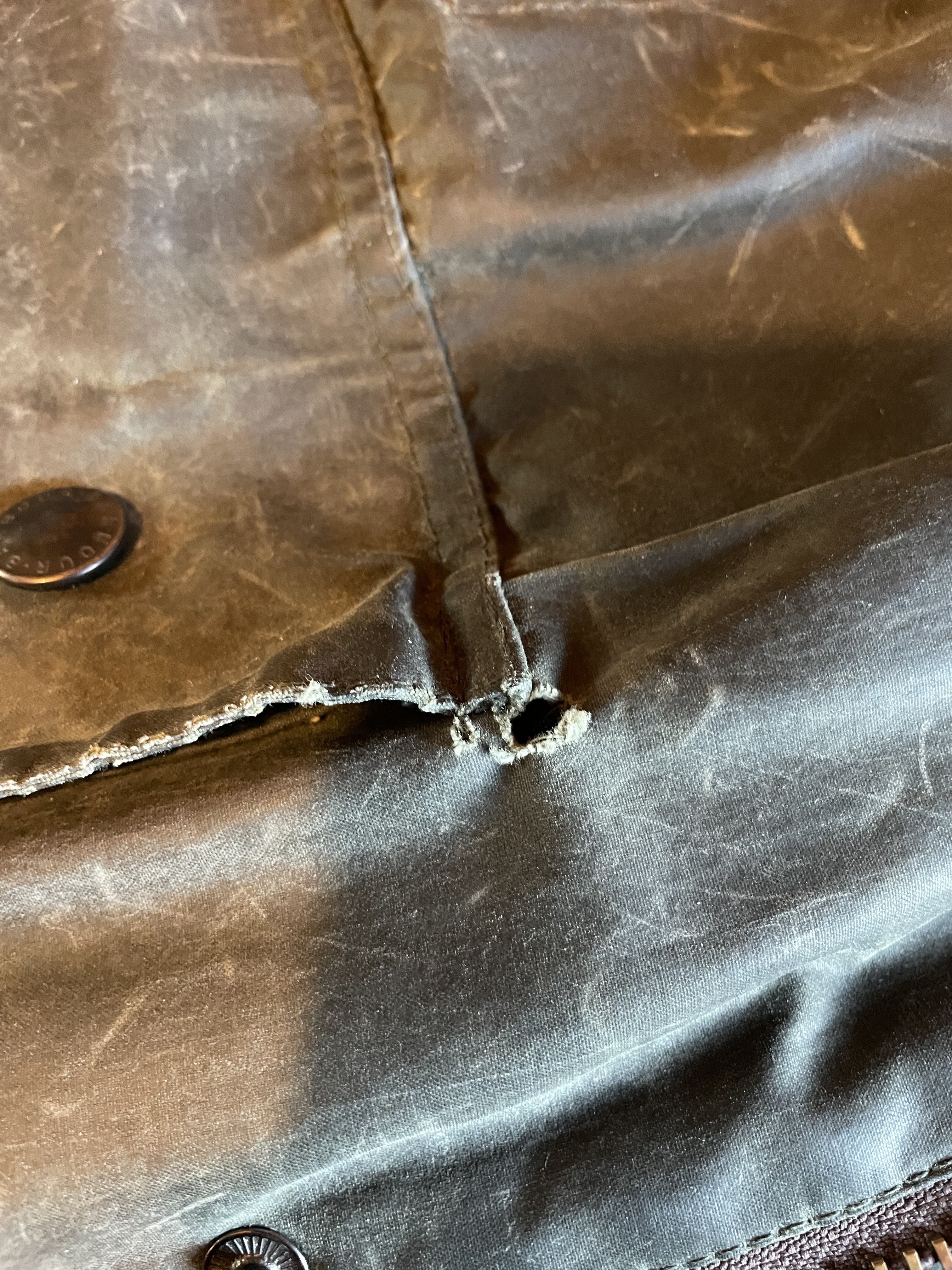

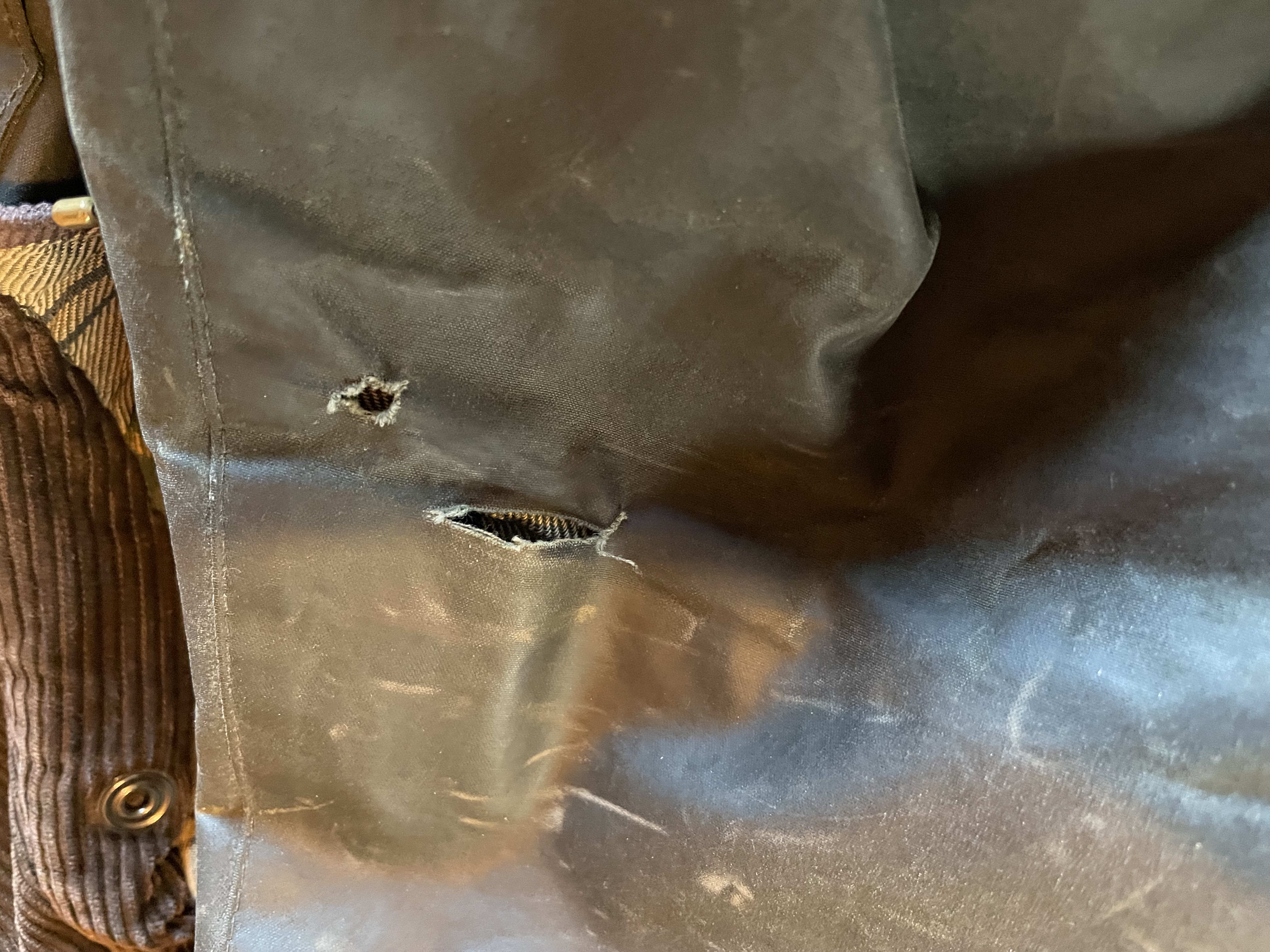

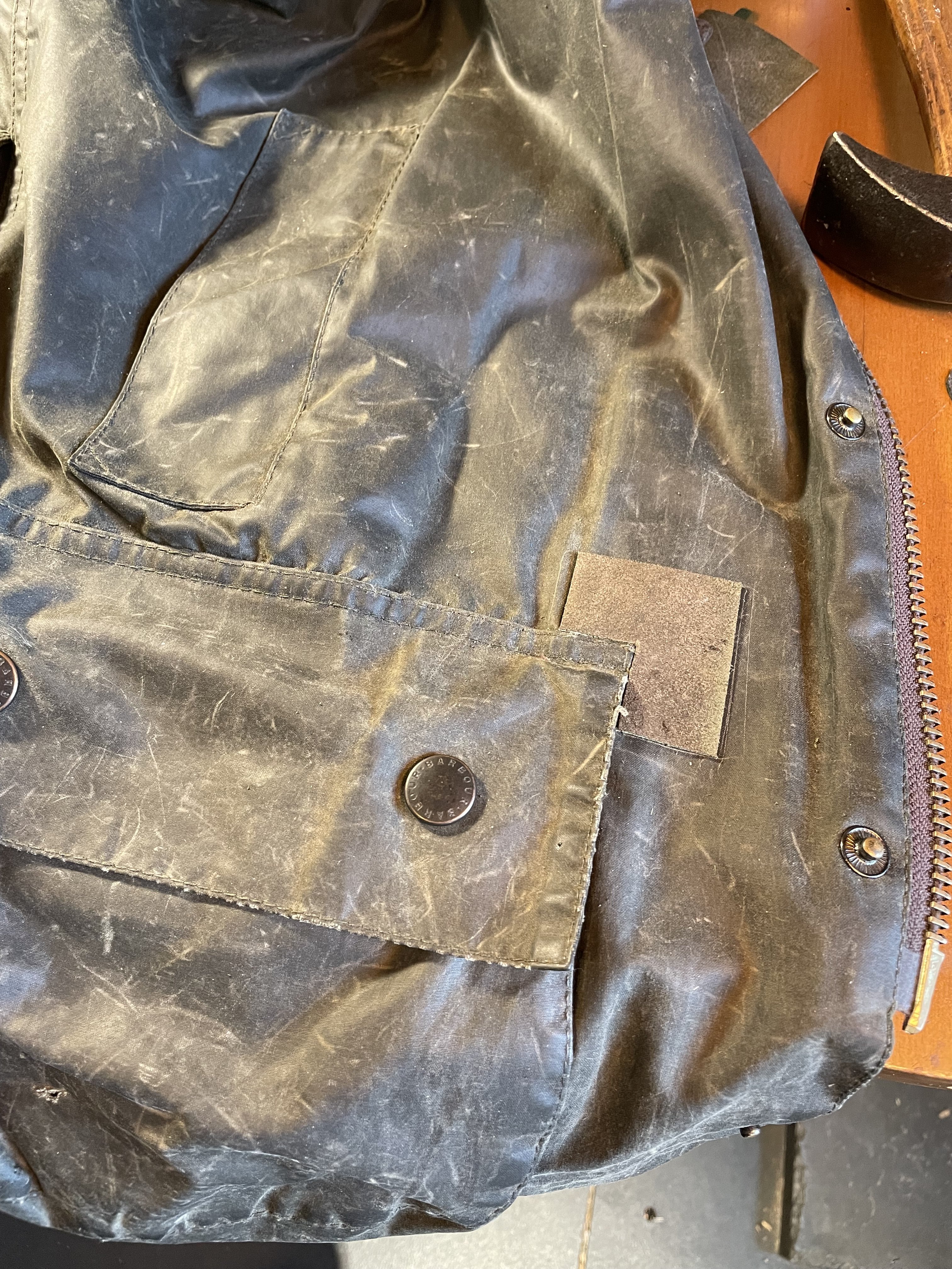

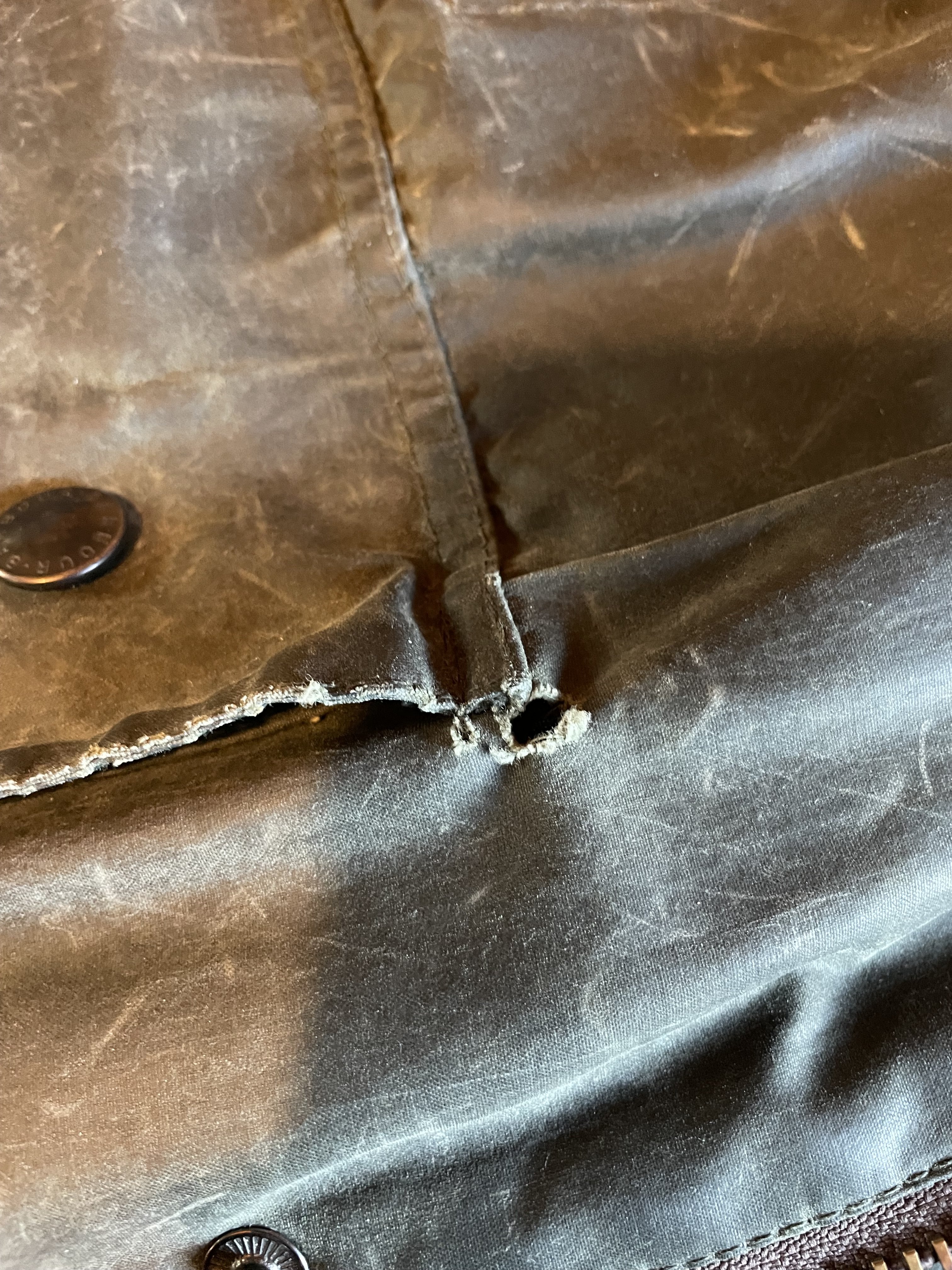

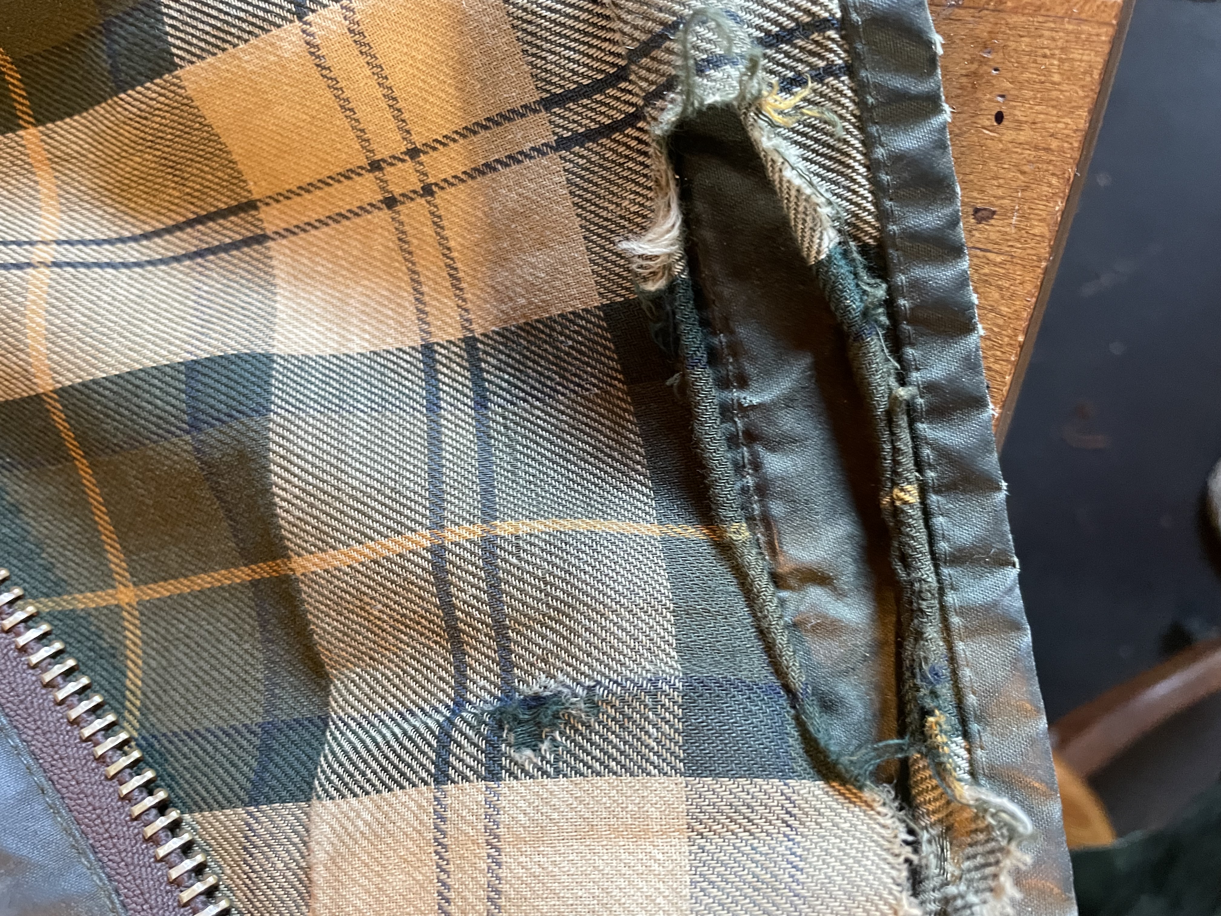

The jacket on arrival. Holes and tears near the pockets are common and prone to getting worse. Holes in the sleeves also. The liner had a 5 inch tear. This did allow me to access the inner shell to repair the tear near the pocket.

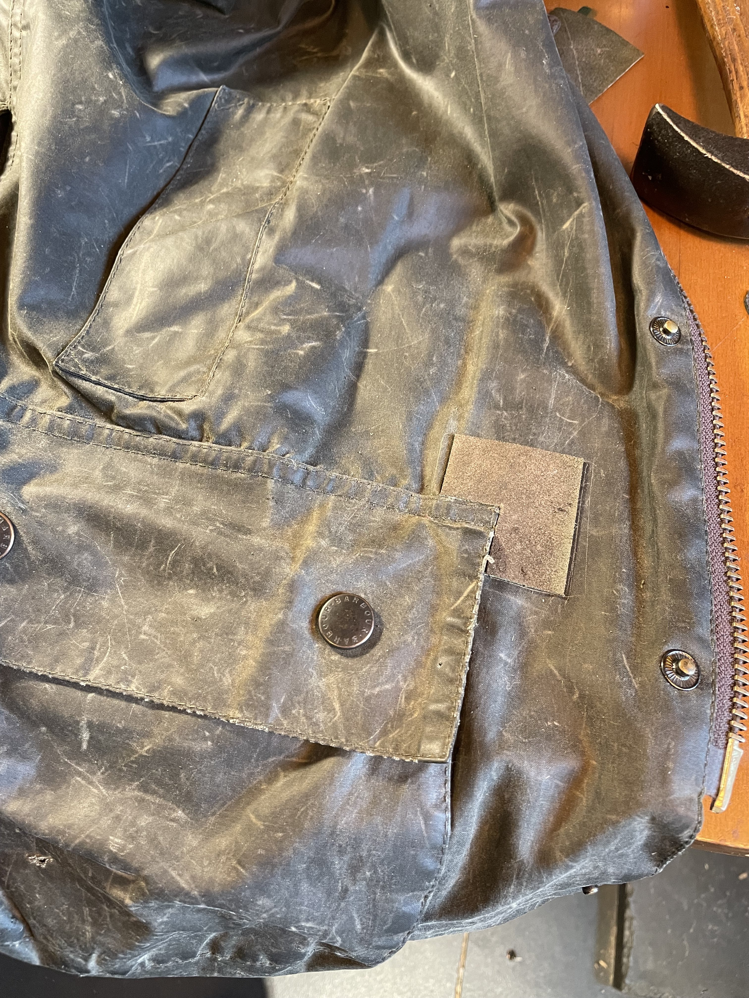

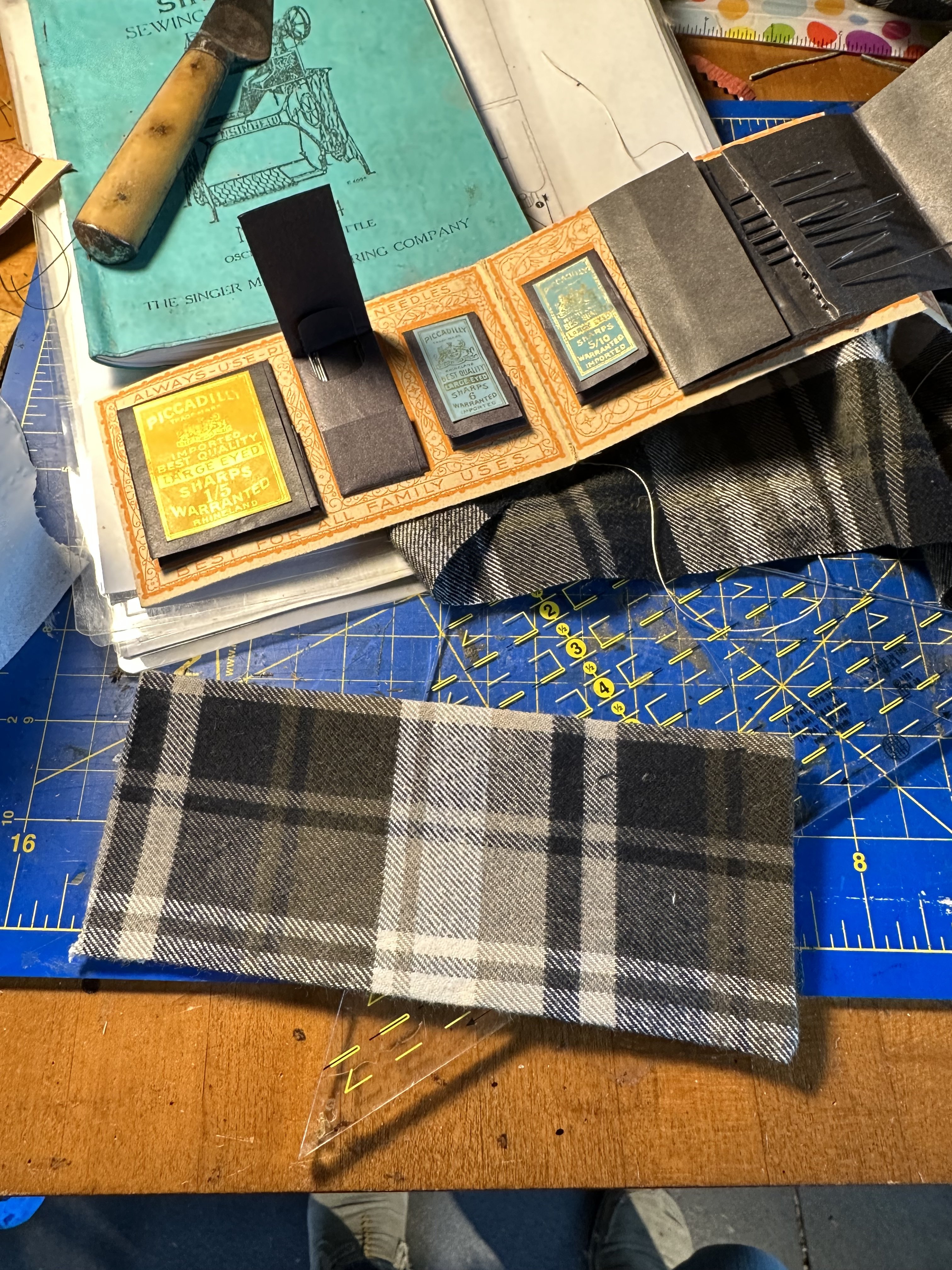

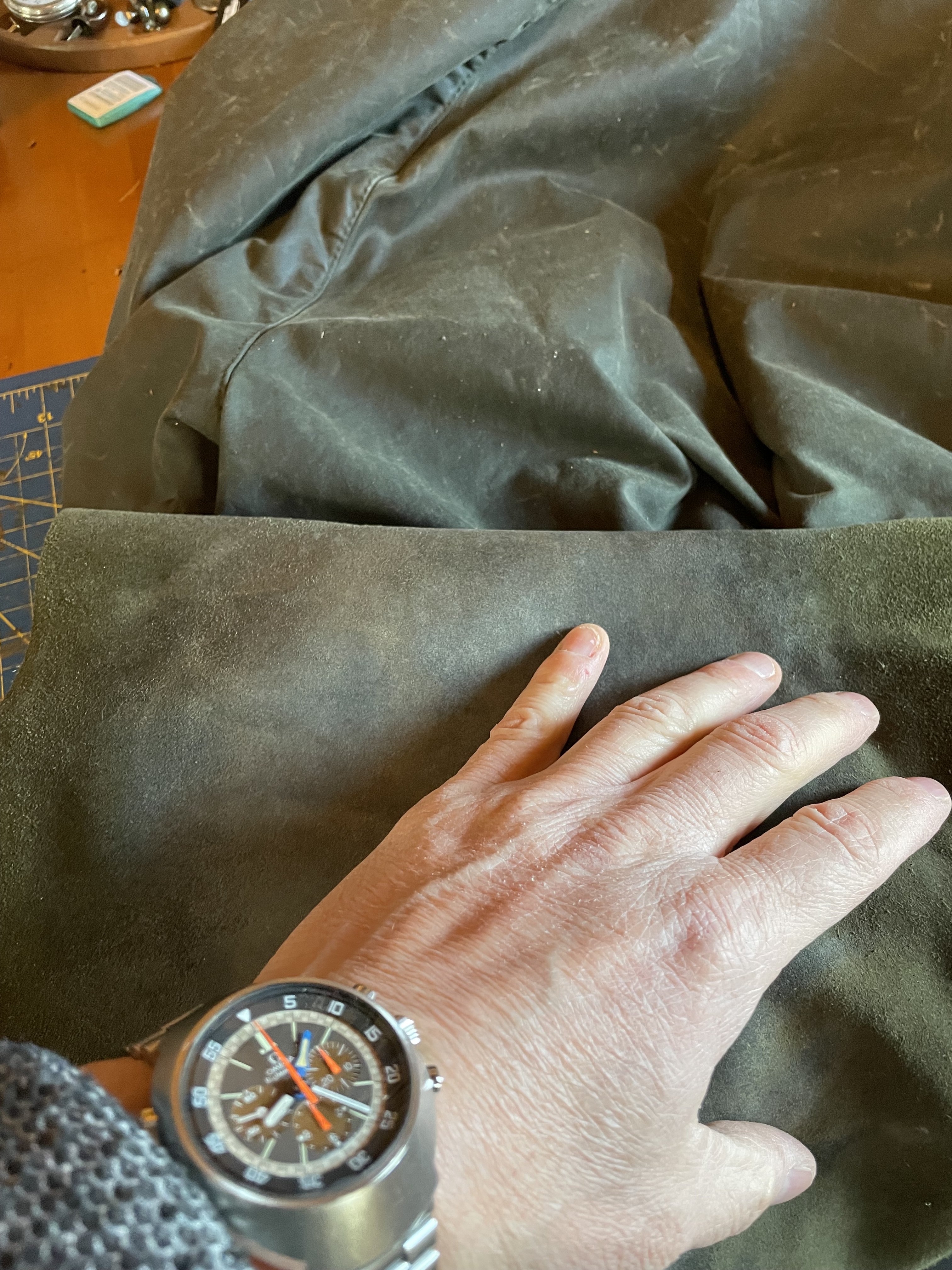

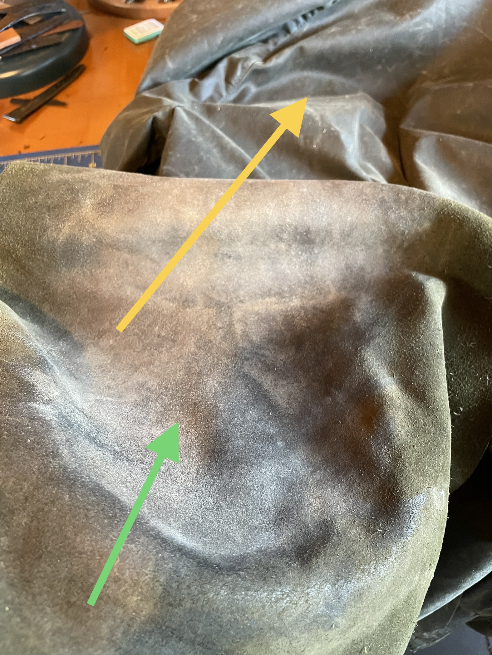

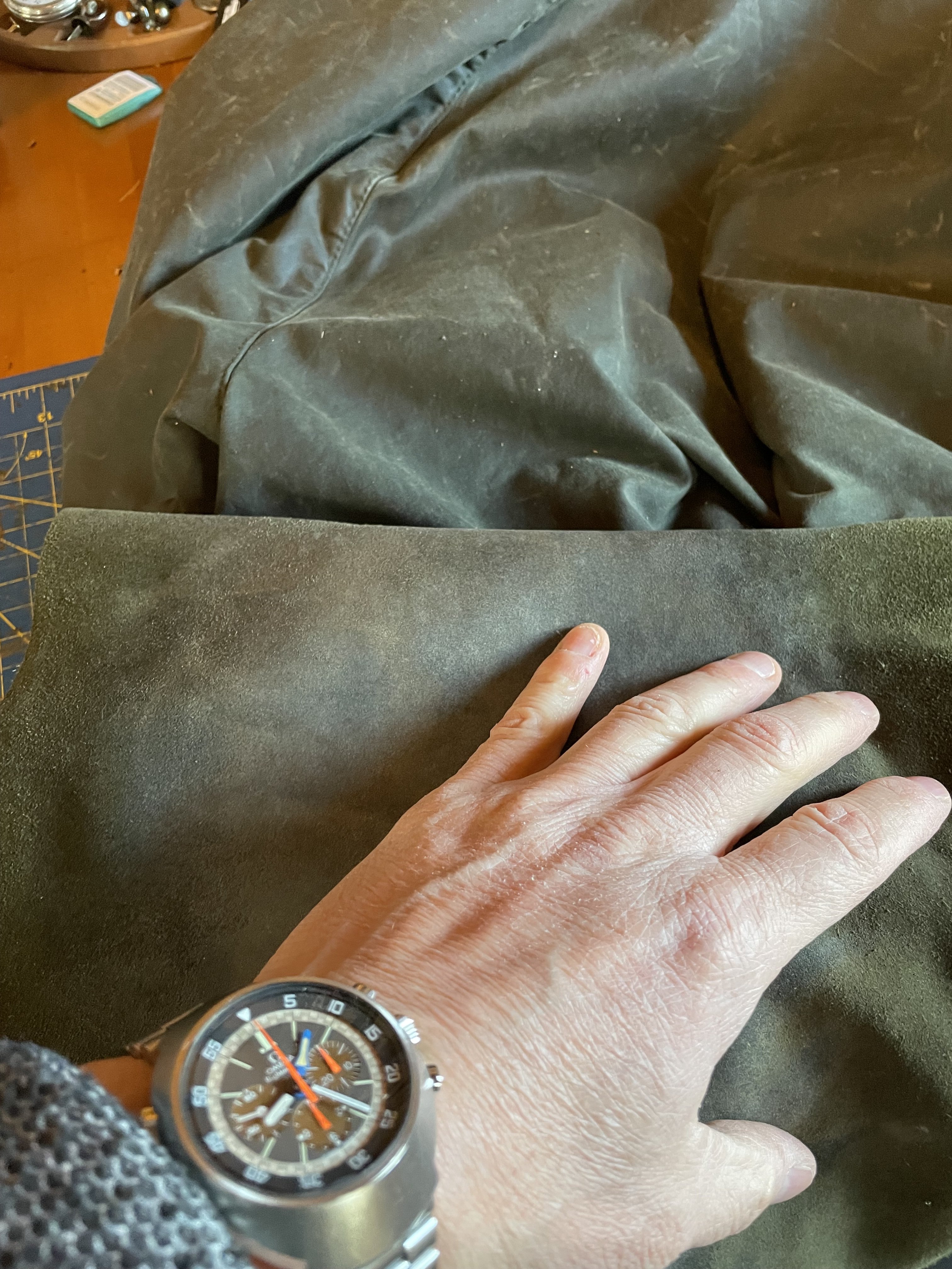

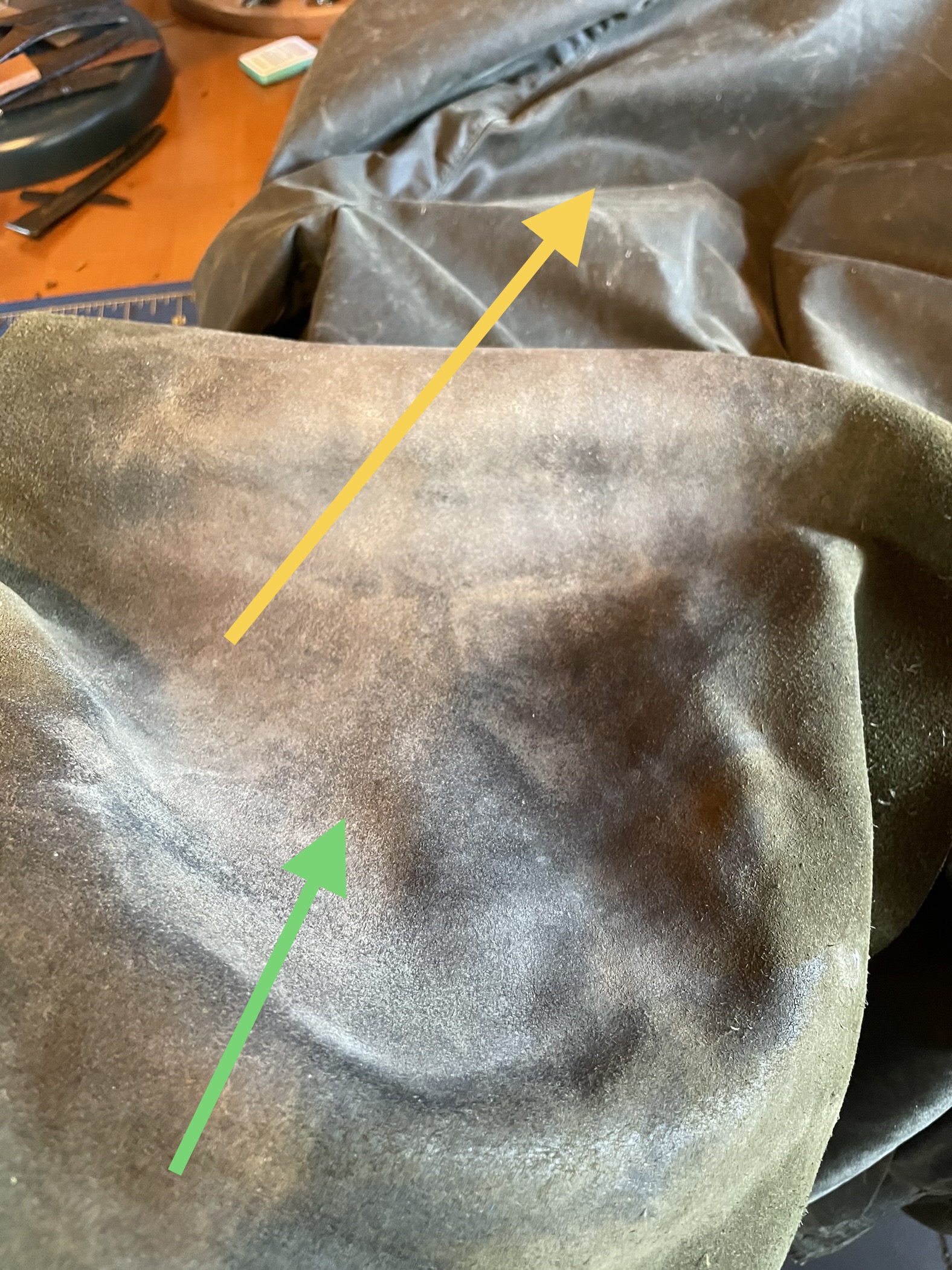

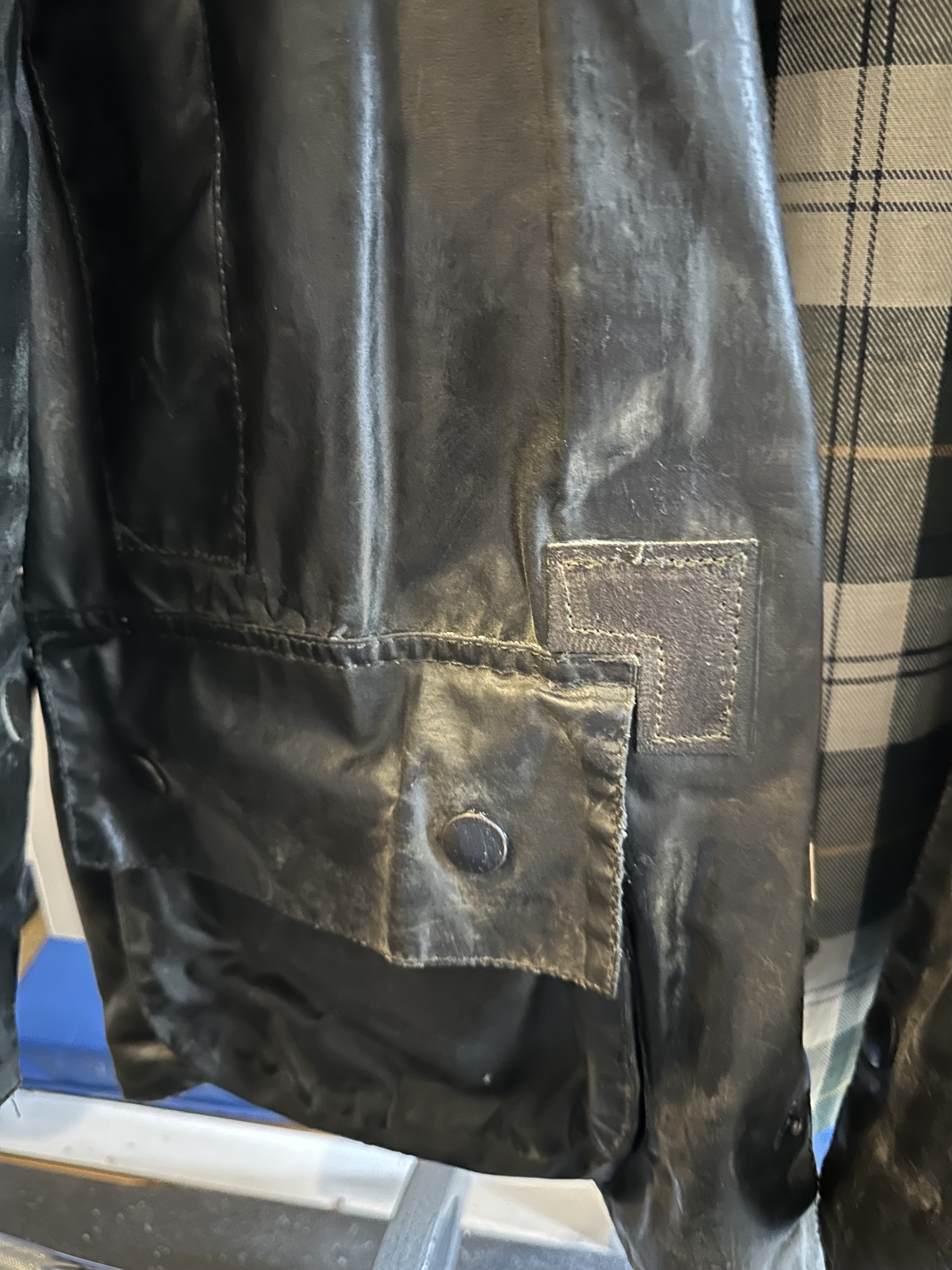

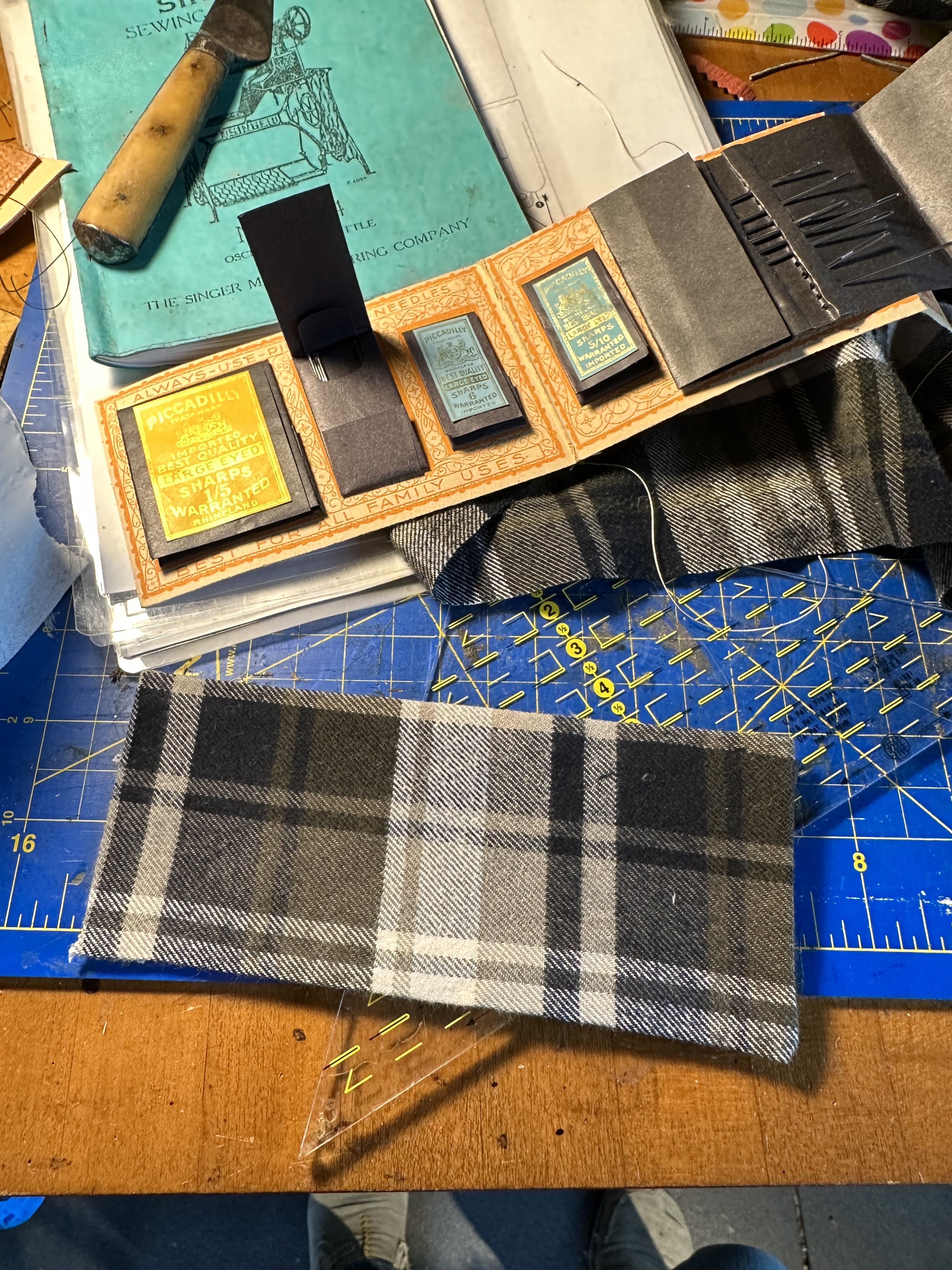

I have some old green suede from motorcycle chaps. Glad this is written text because however you pronounce « chaps », some asshole inevitably corrects you. The green arrow shows the worn chaps and the yellow arrow shows the jacket. Not a bad match for patching material. First watch shot. The watch will get involved again later… I cut two patches for the pocket tear. One on the inner shell, glued, and one on the outer shell. The patch will be visible, and I am fine with that. I have a new waxed Belstaff if I want a new and tailored look. Yes, I like this Barbour better and am keeping it! The Belstaff… not bad but a bit too « slim ». I am slim too, but am in my early 50s, so the more relaxed Barbour fits better.

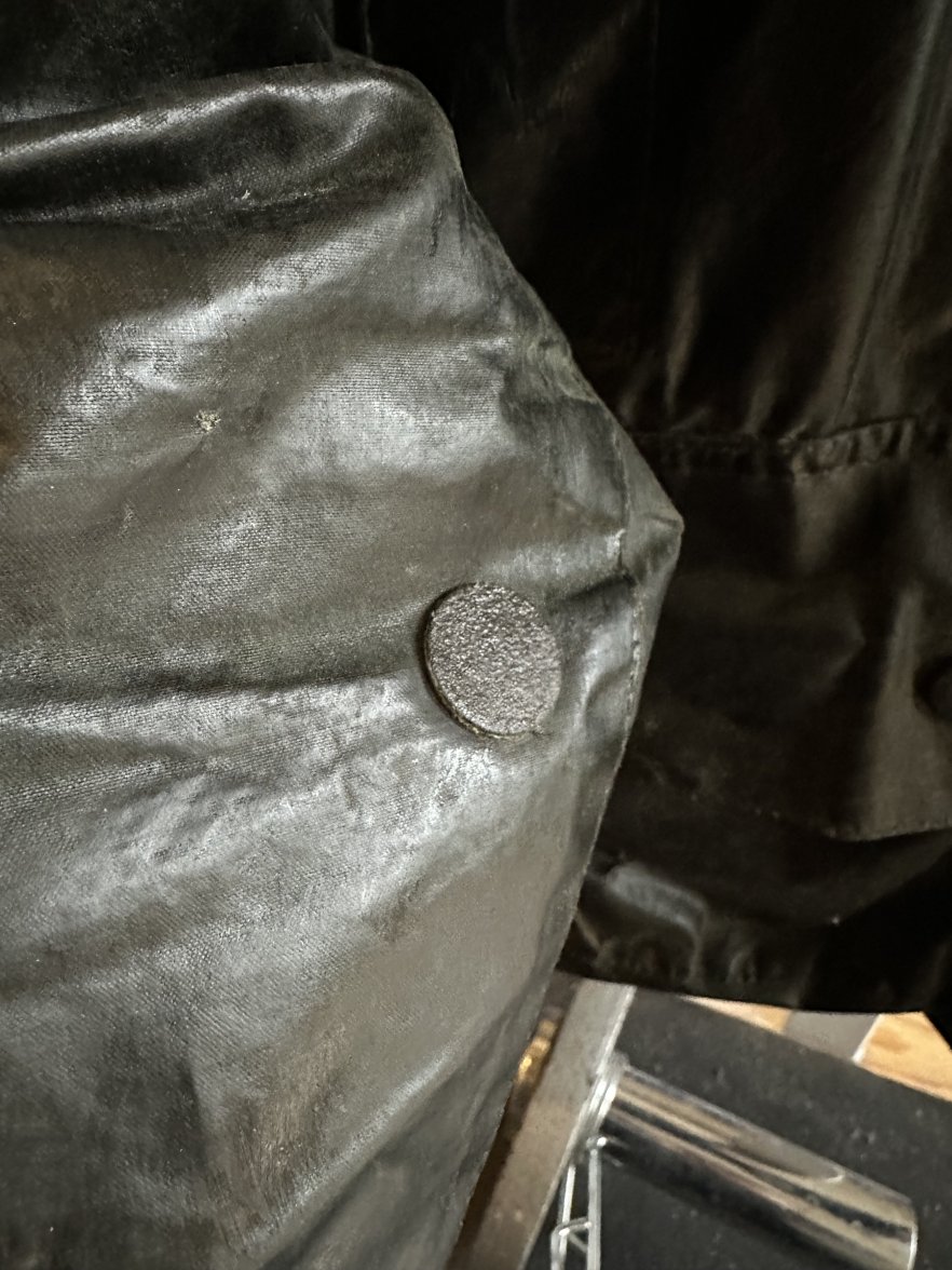

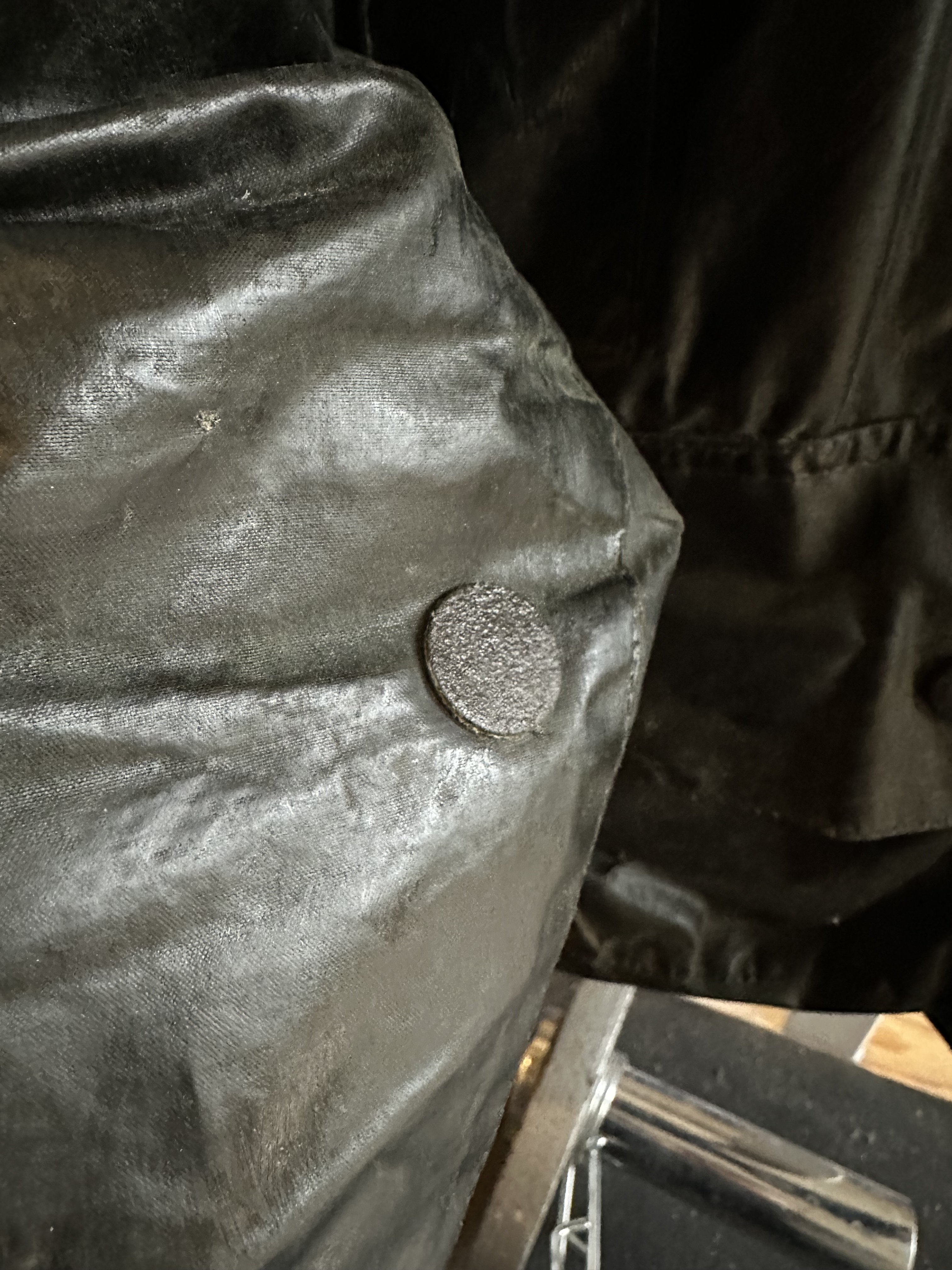

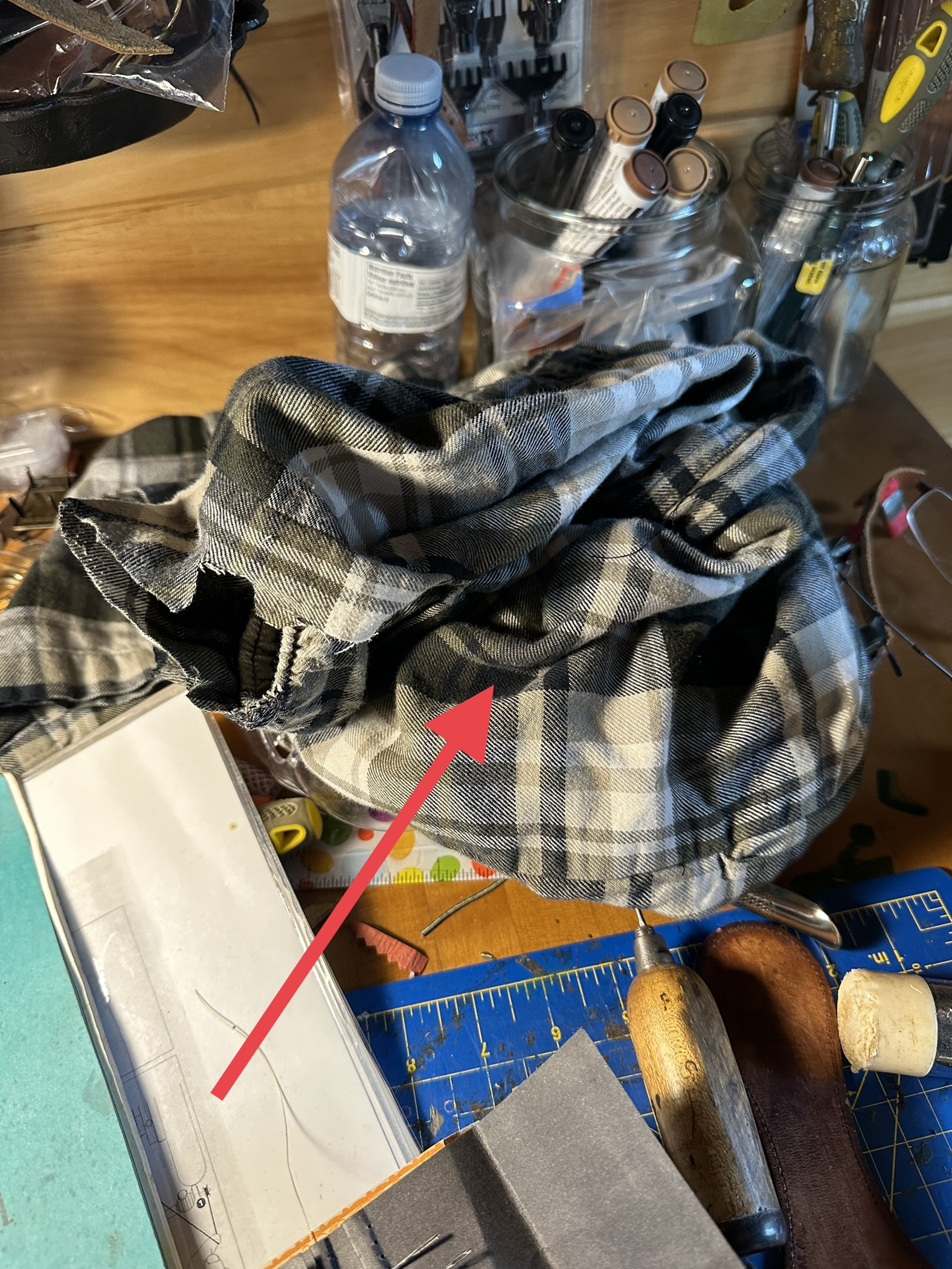

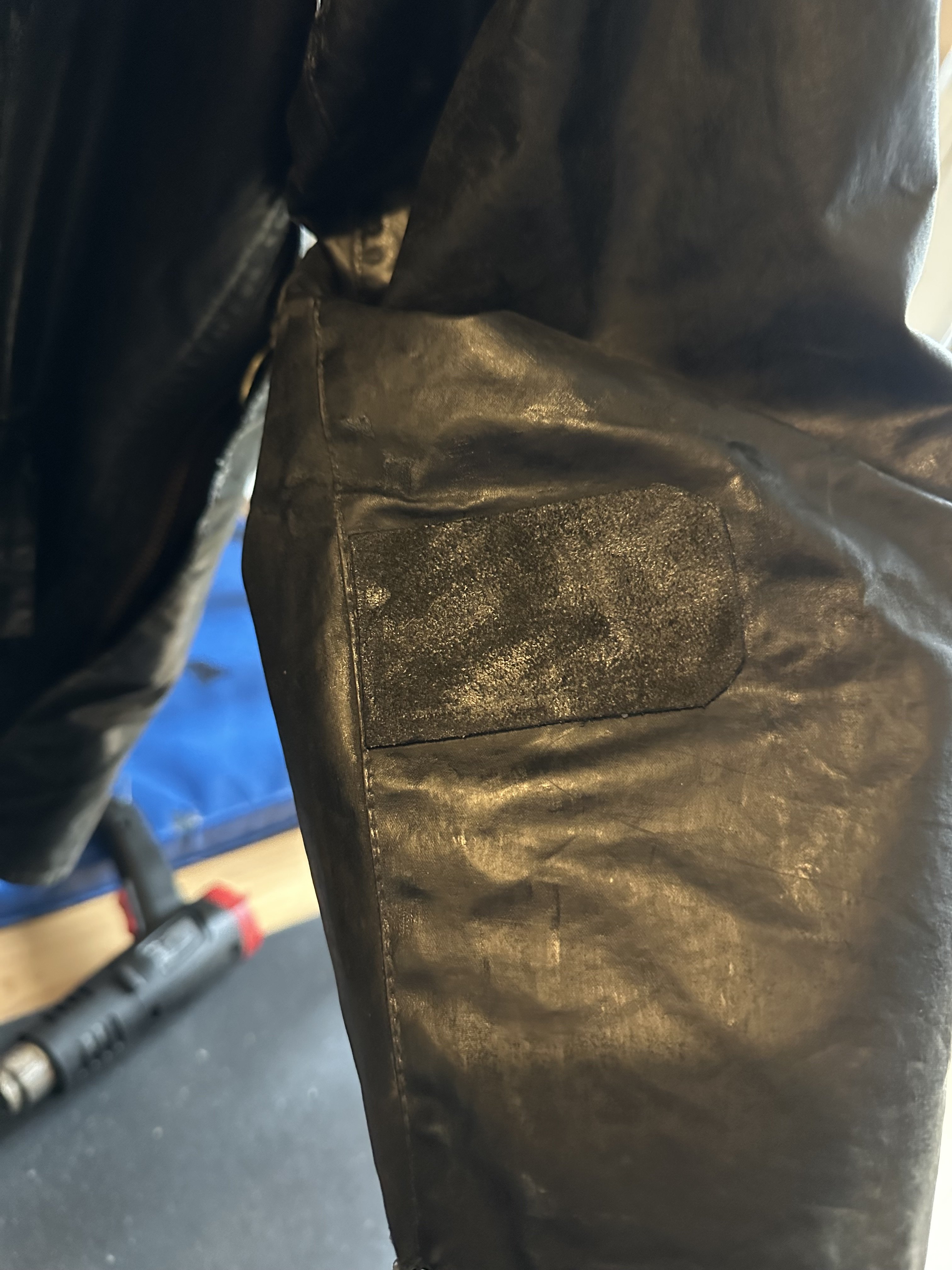

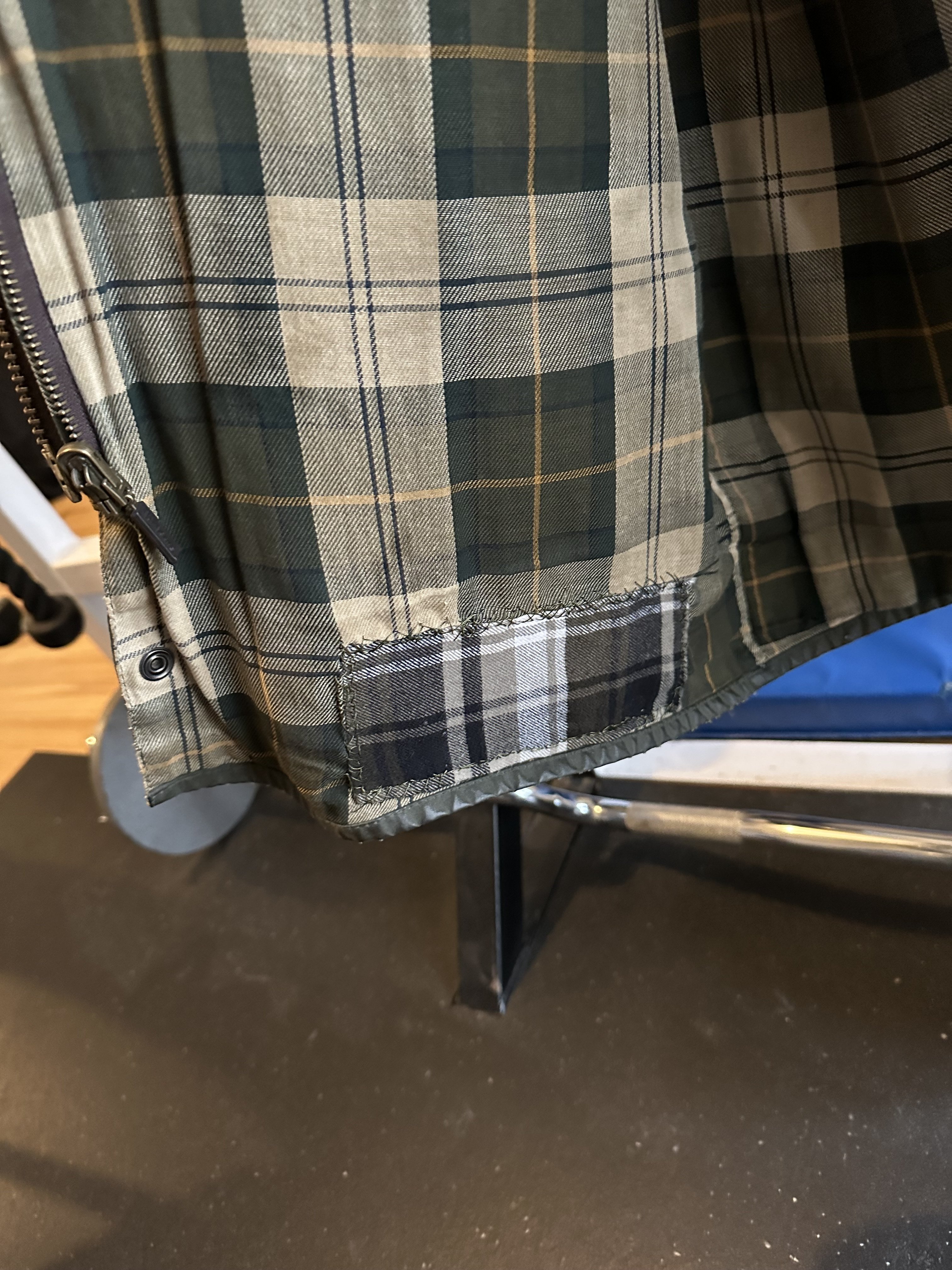

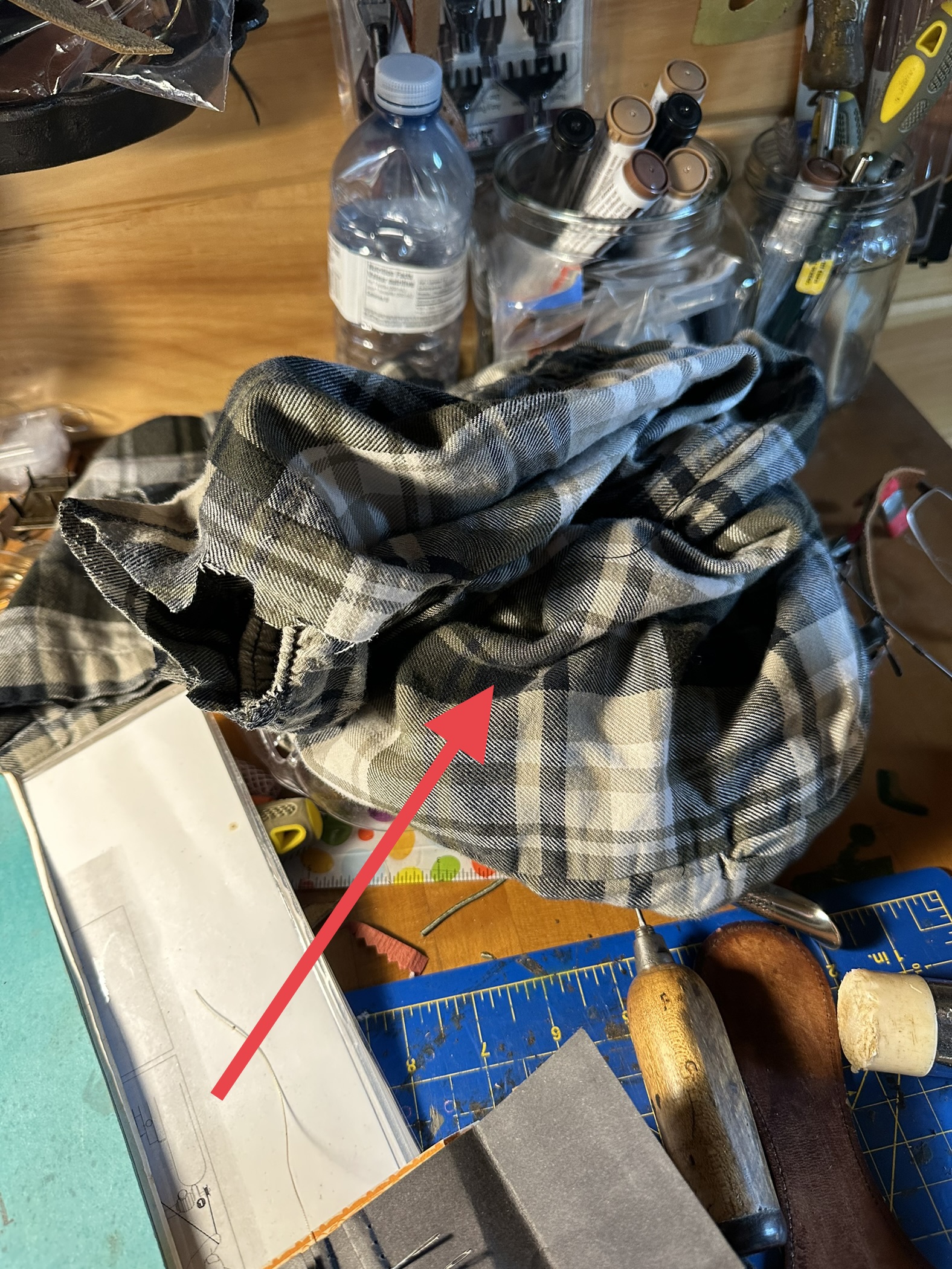

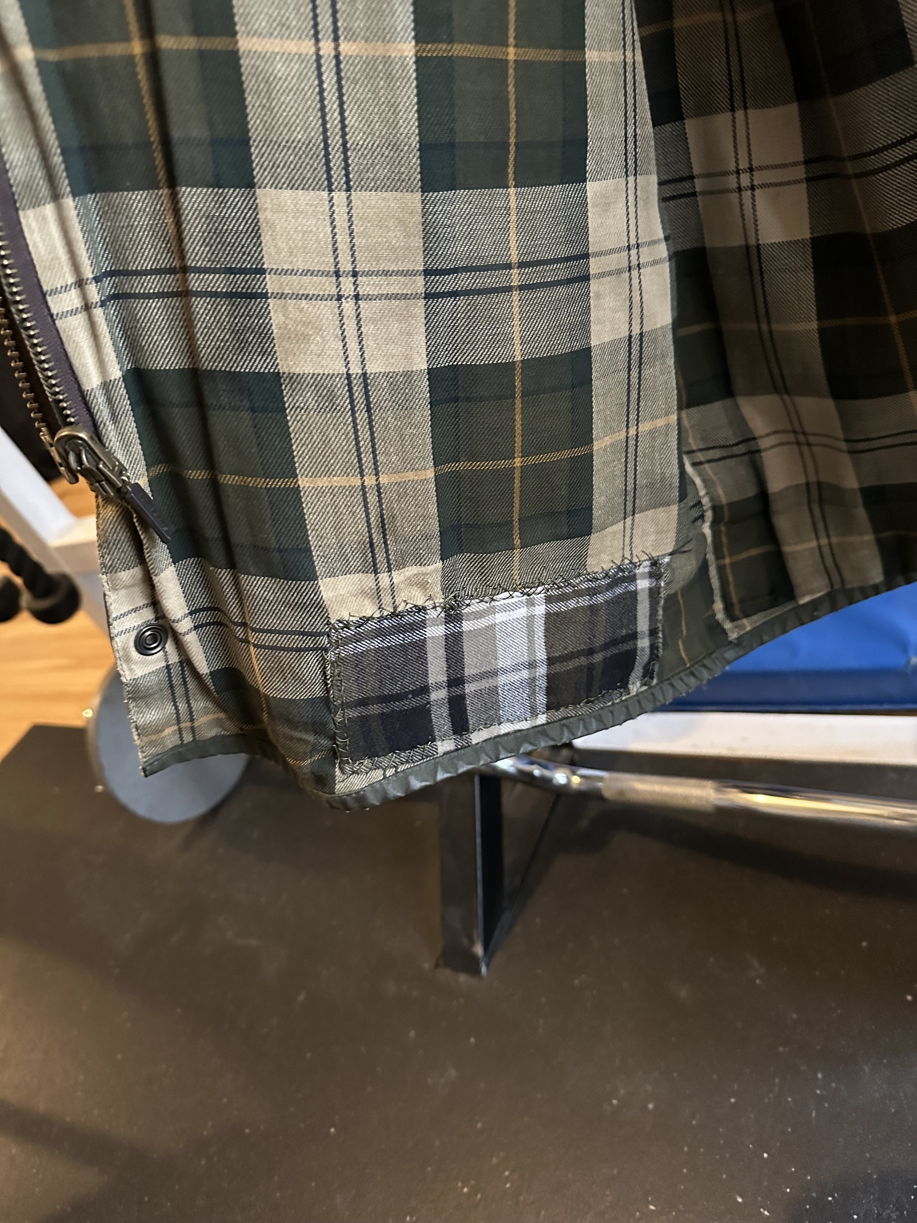

The red arrow shows a pair of cotton pyjama pants from Goodwill. I cut out a patch, ironed it and stitched the folded sides. This will cover the tear in the lining. Photos of the patched pocket, liner and sleeves to follow.

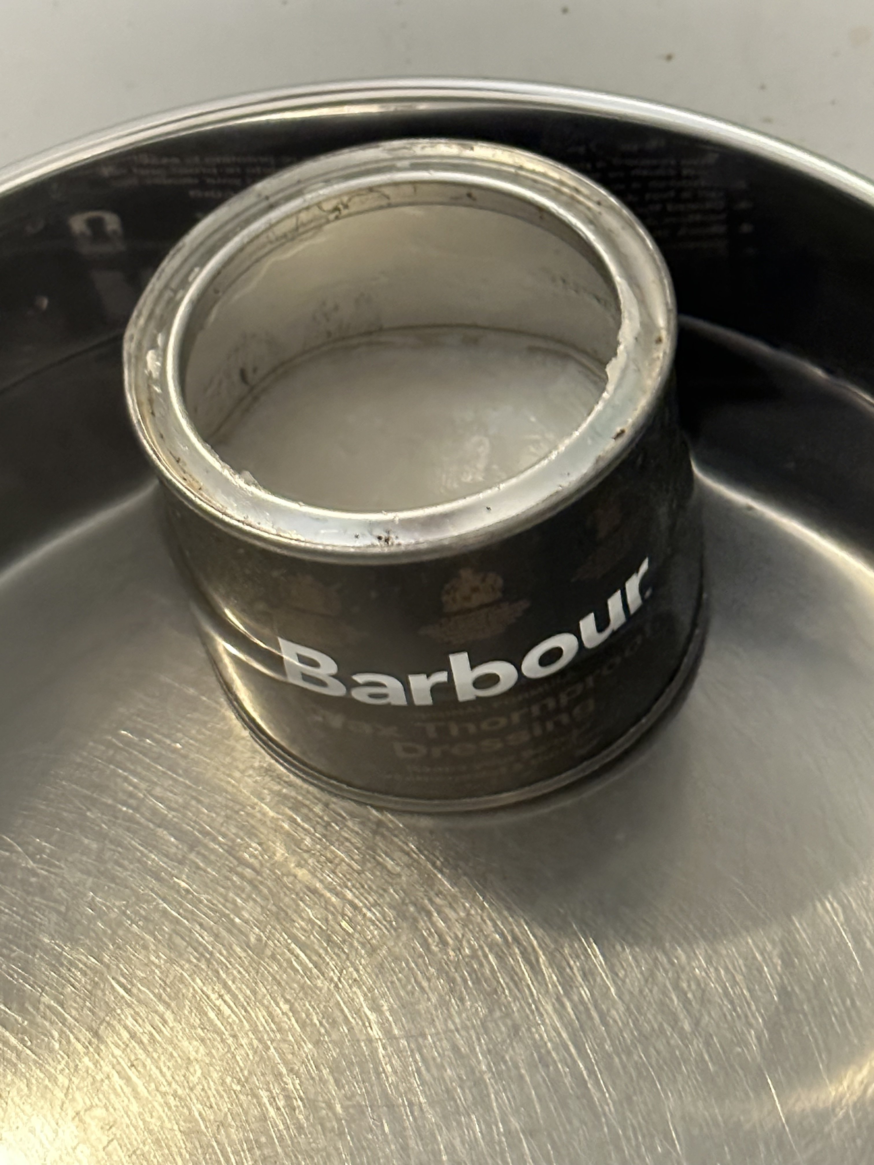

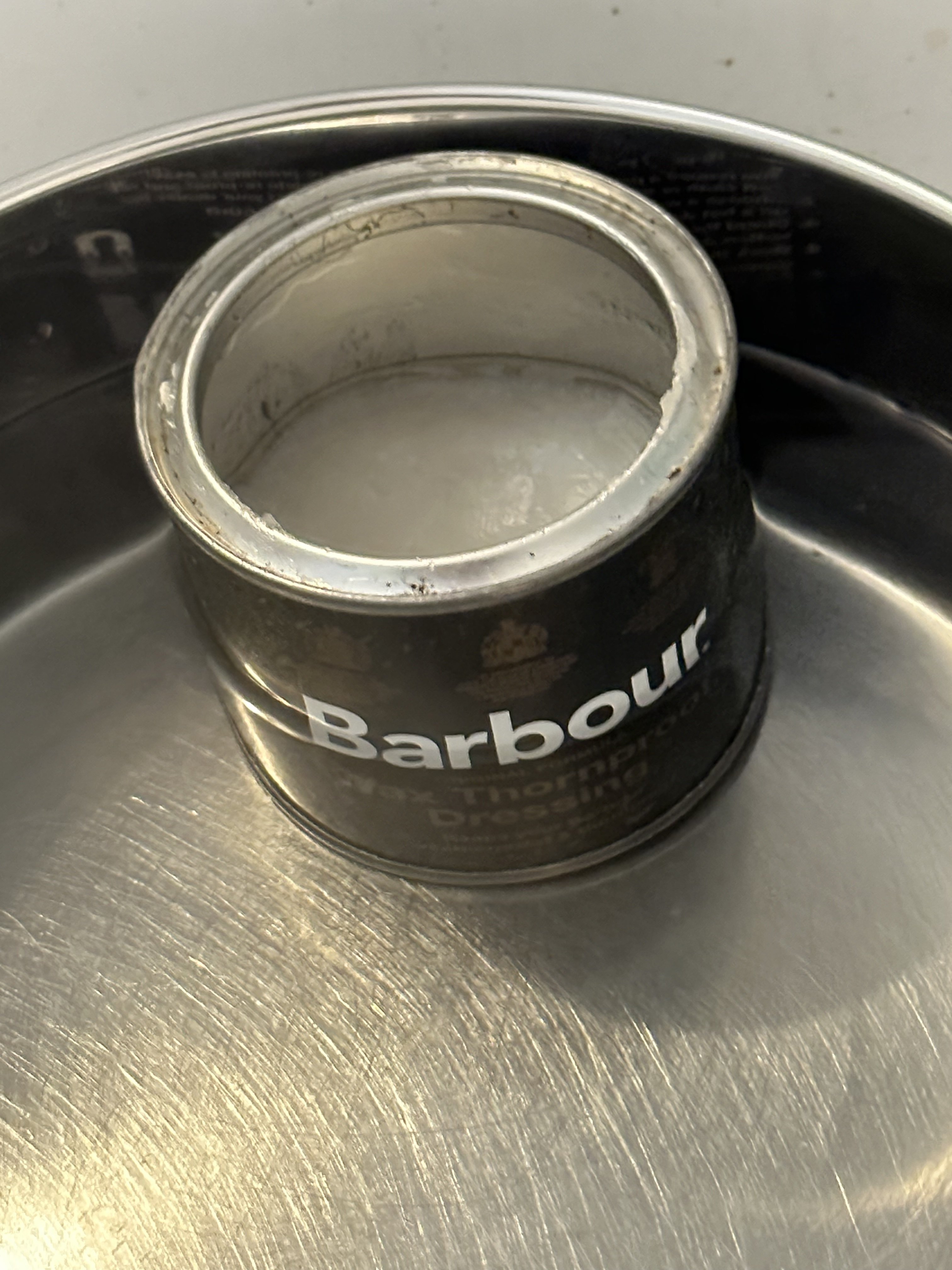

I had some leftover wax from a jacket that I fixed about 15 years ago… The wax tin is inside a pot of boiling water.

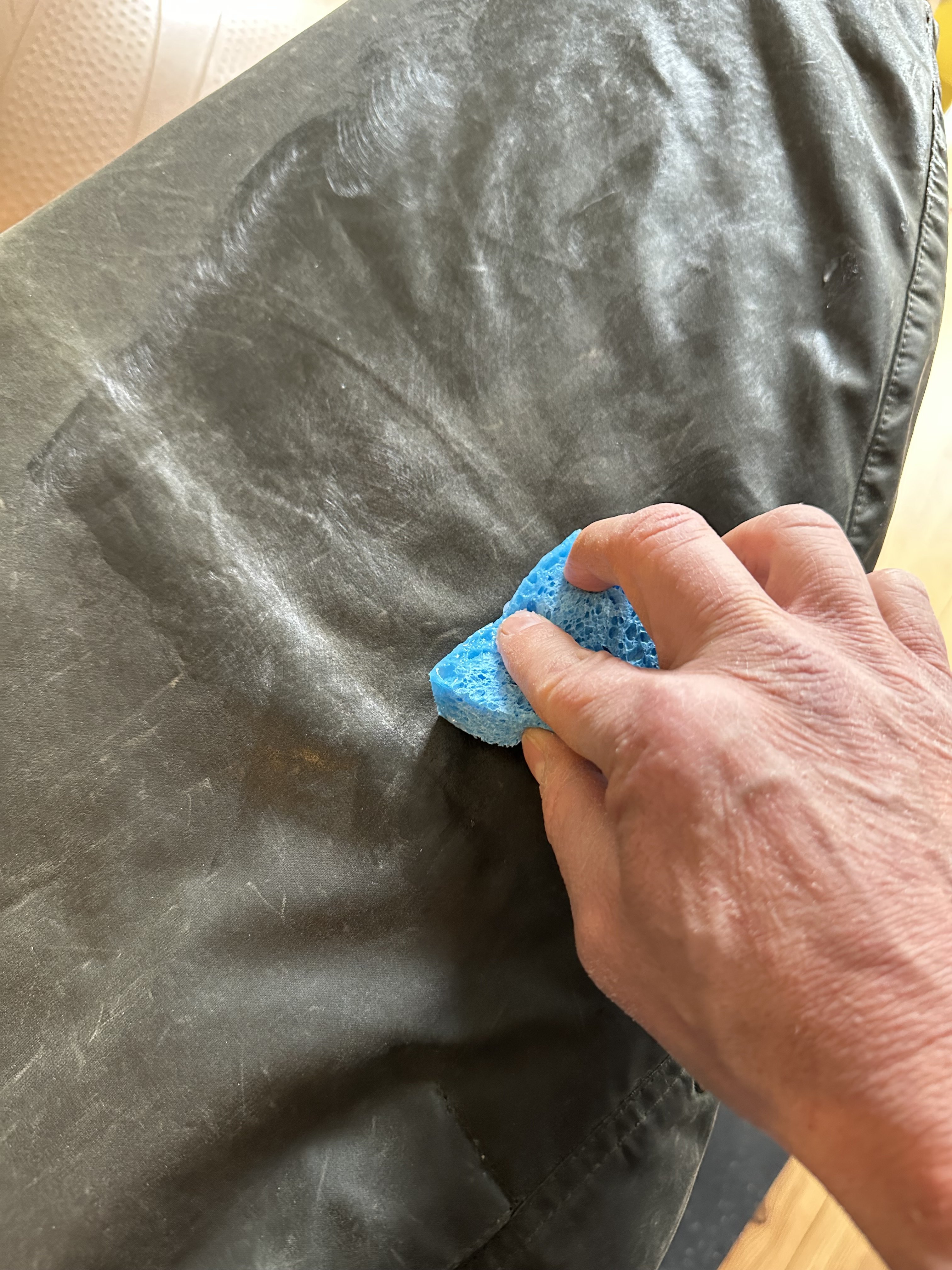

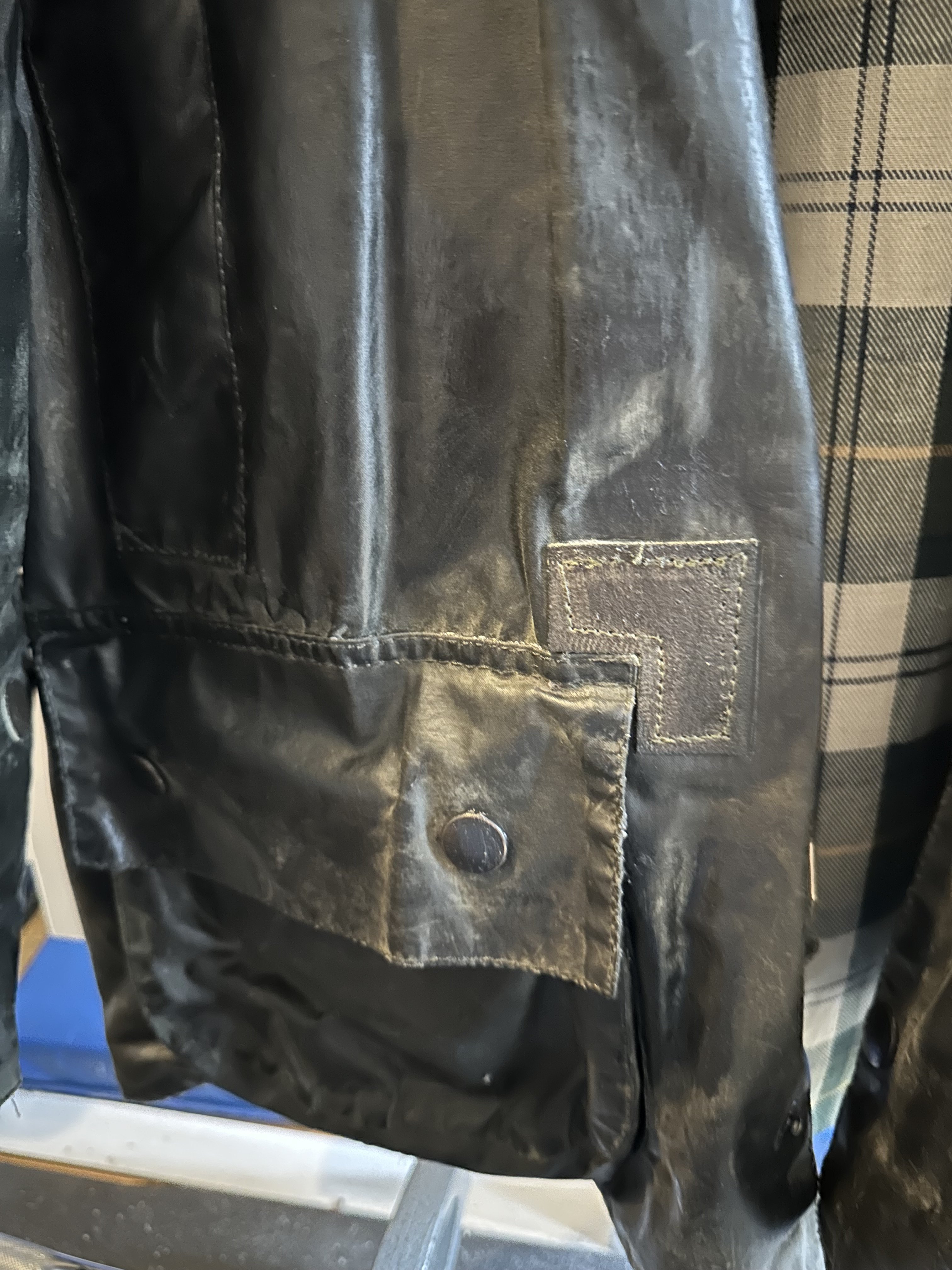

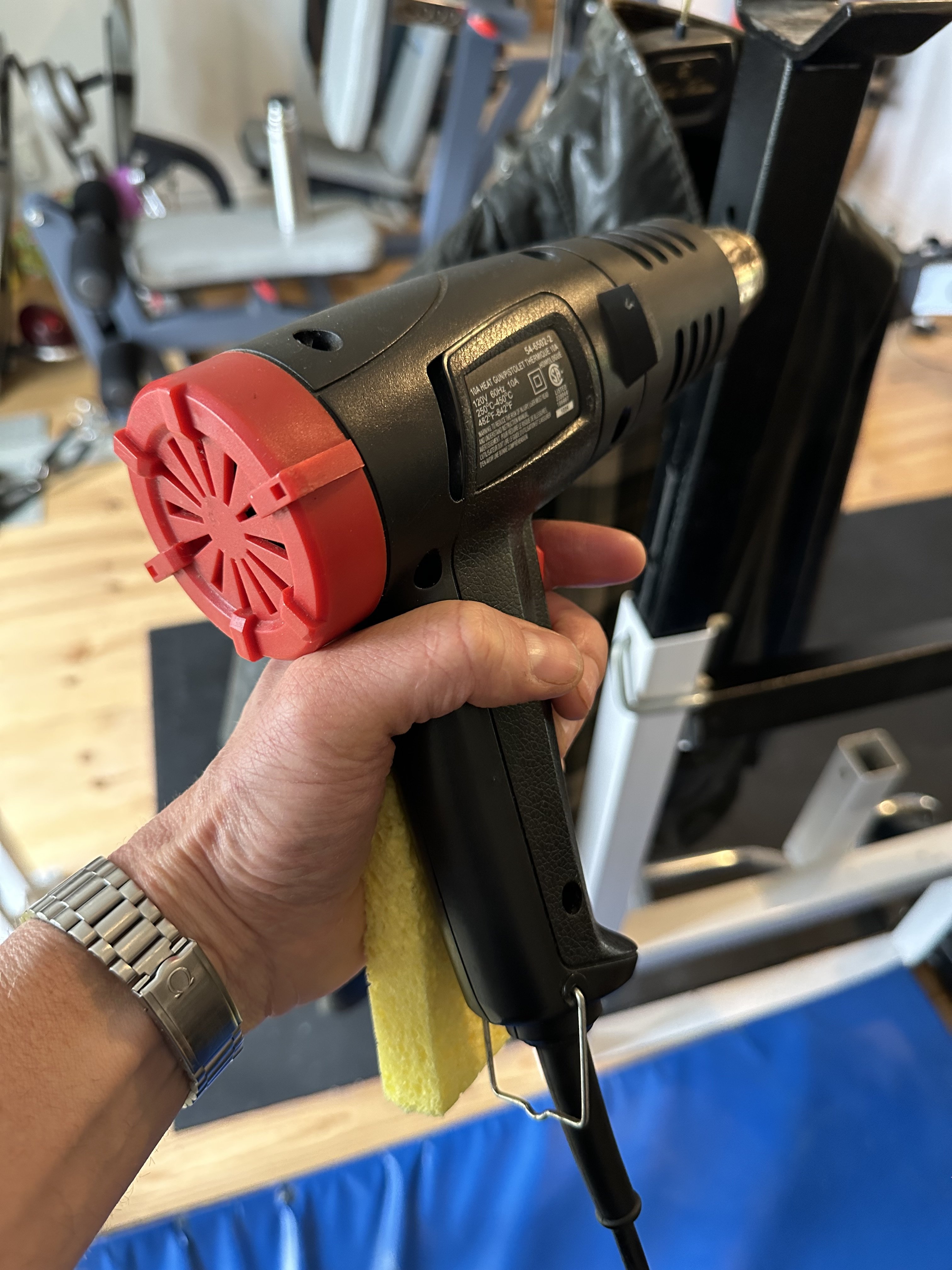

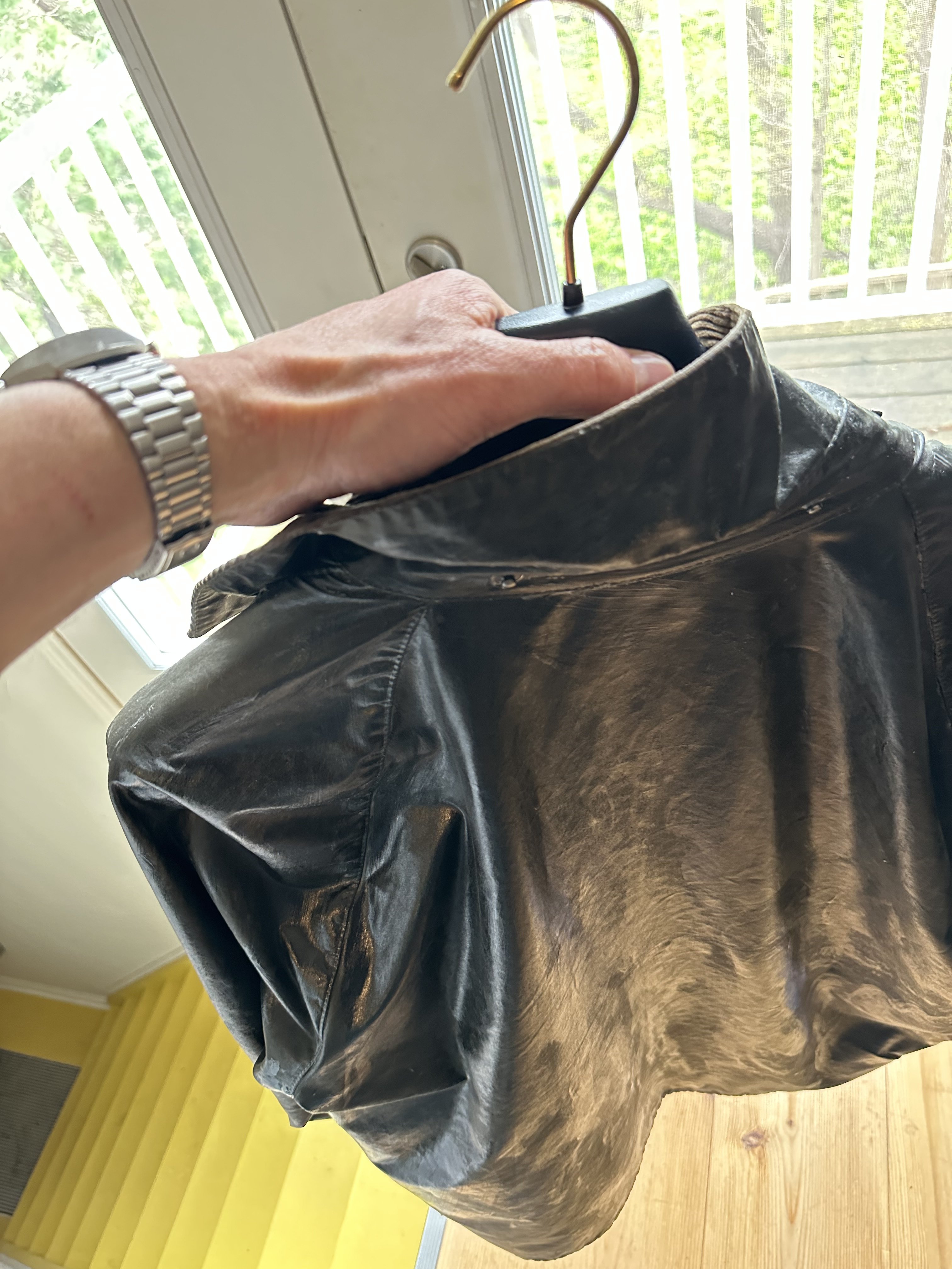

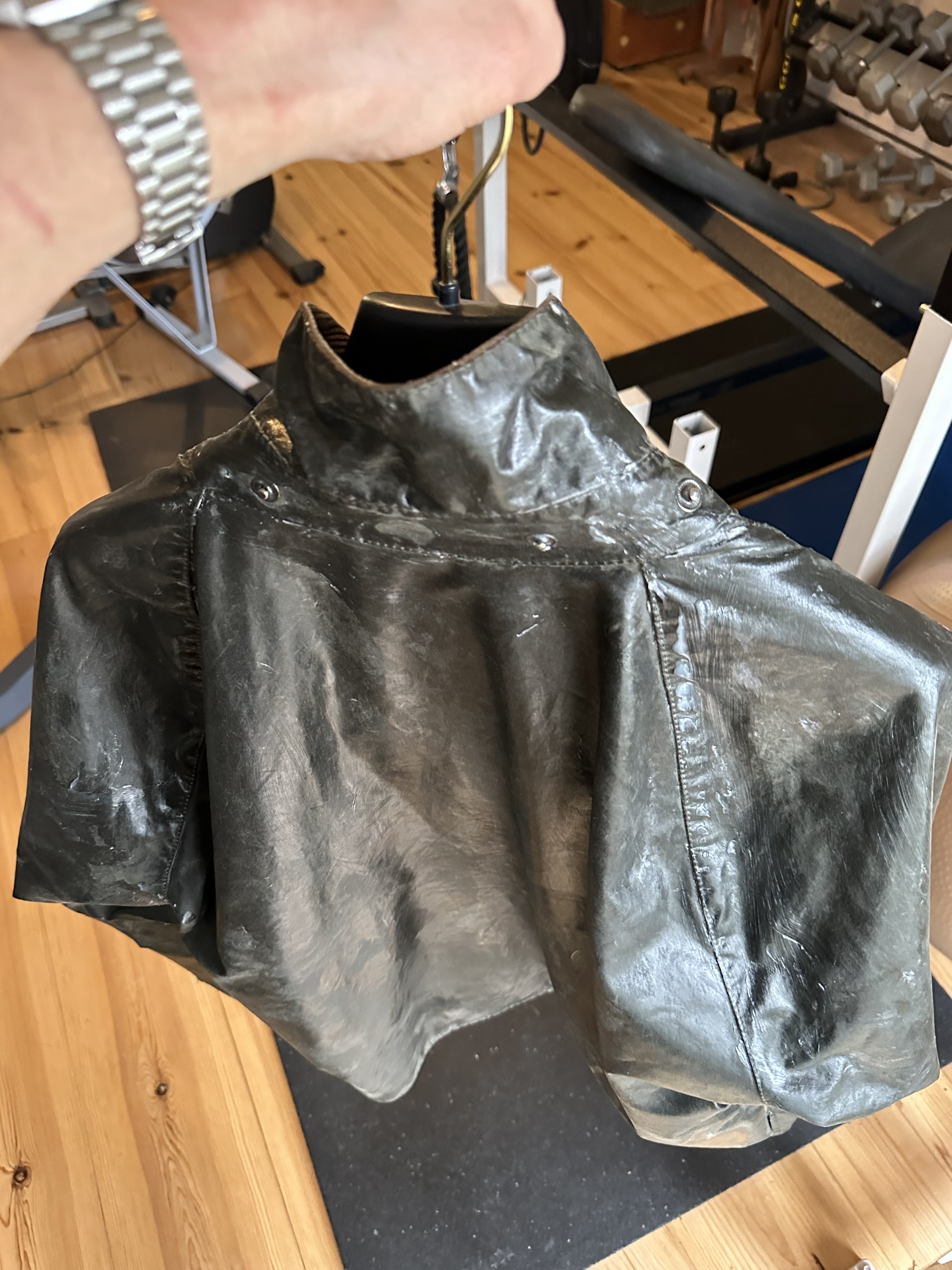

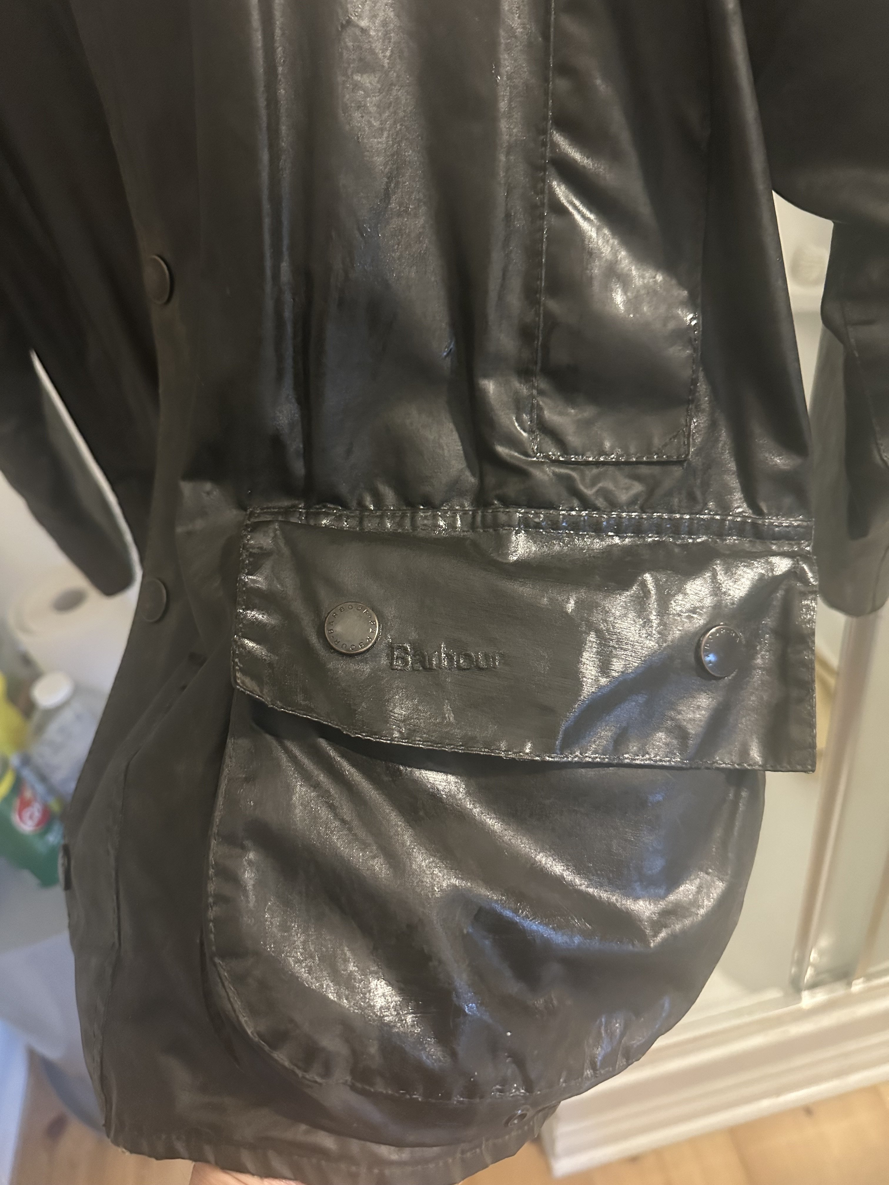

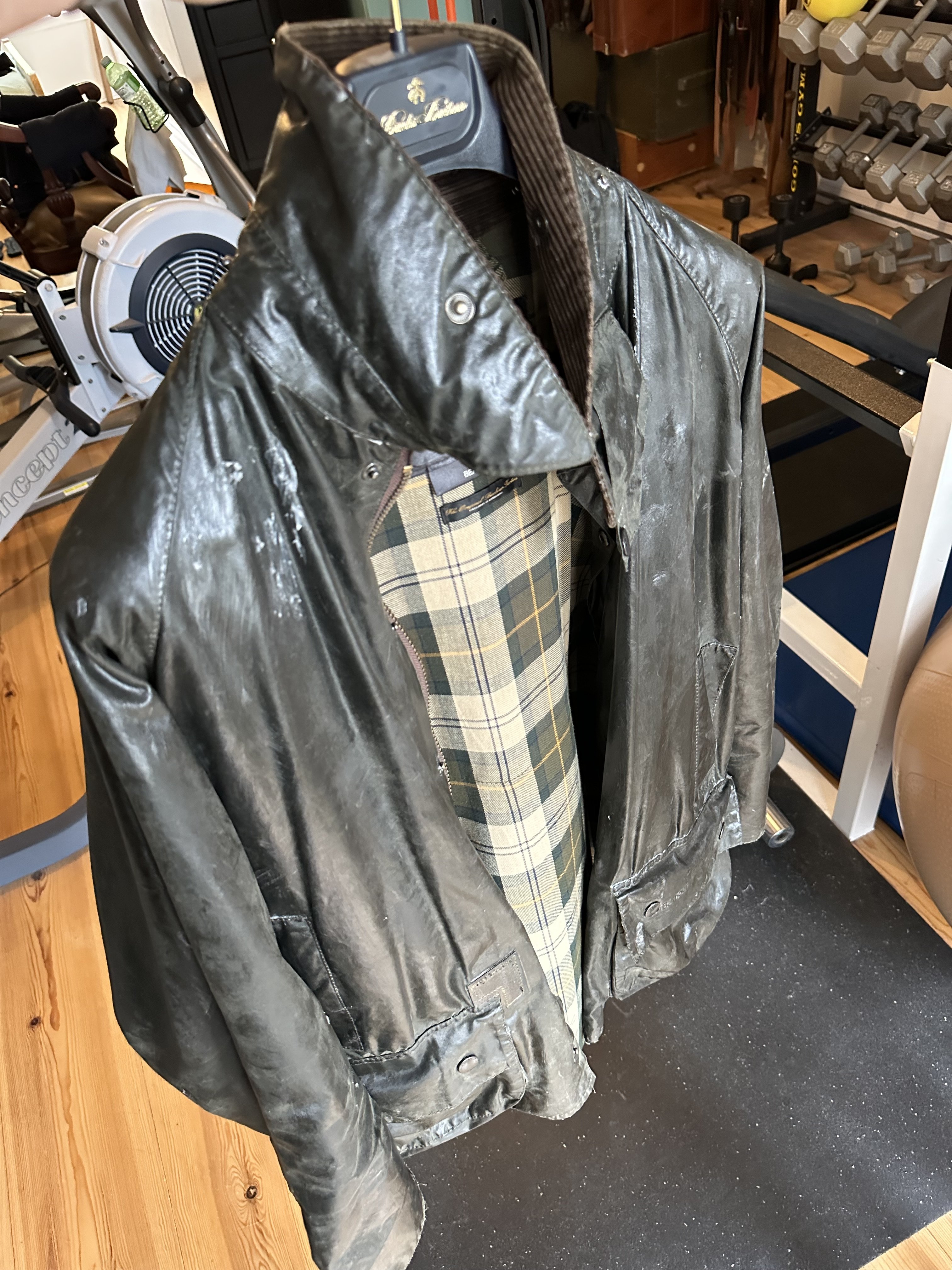

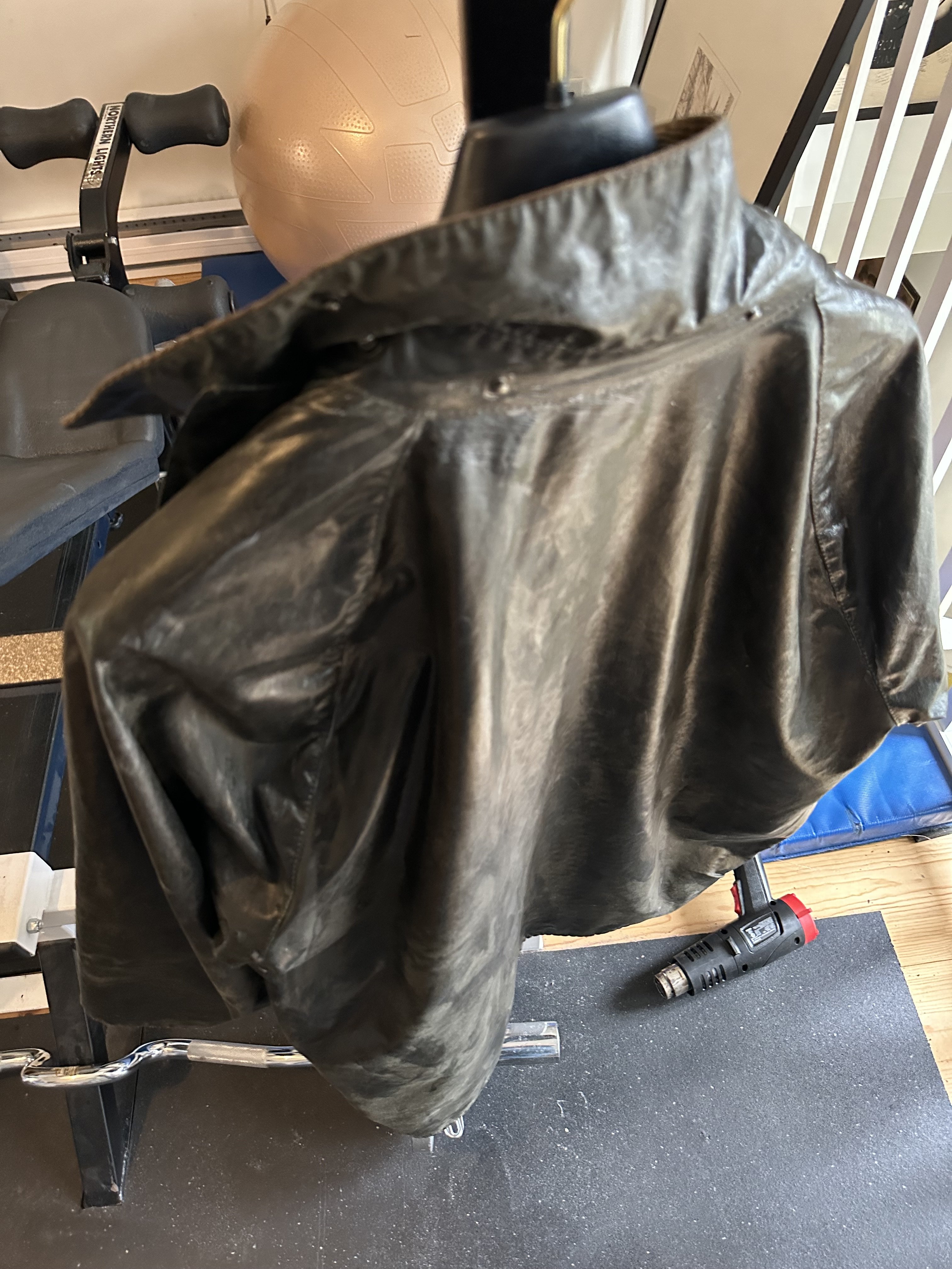

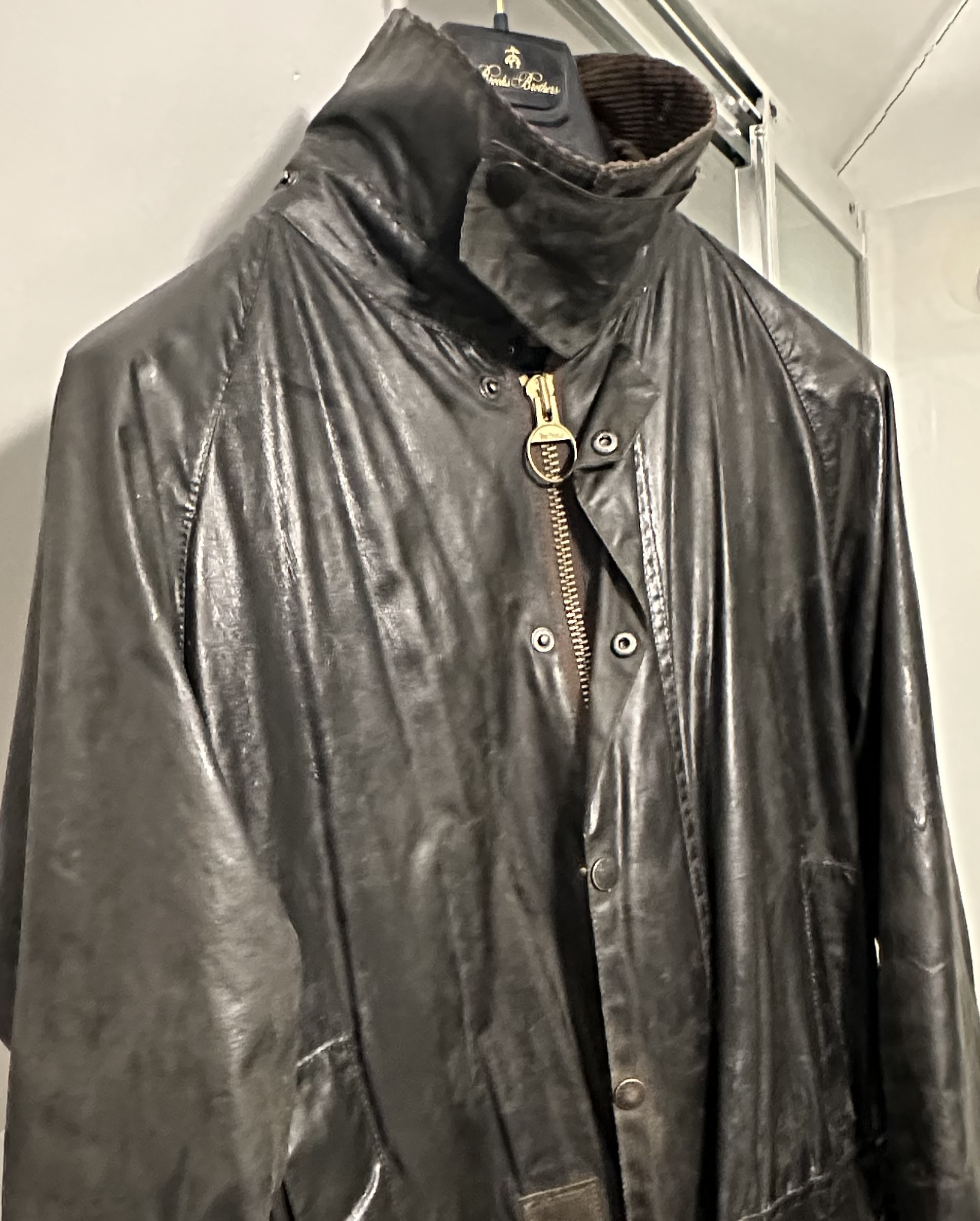

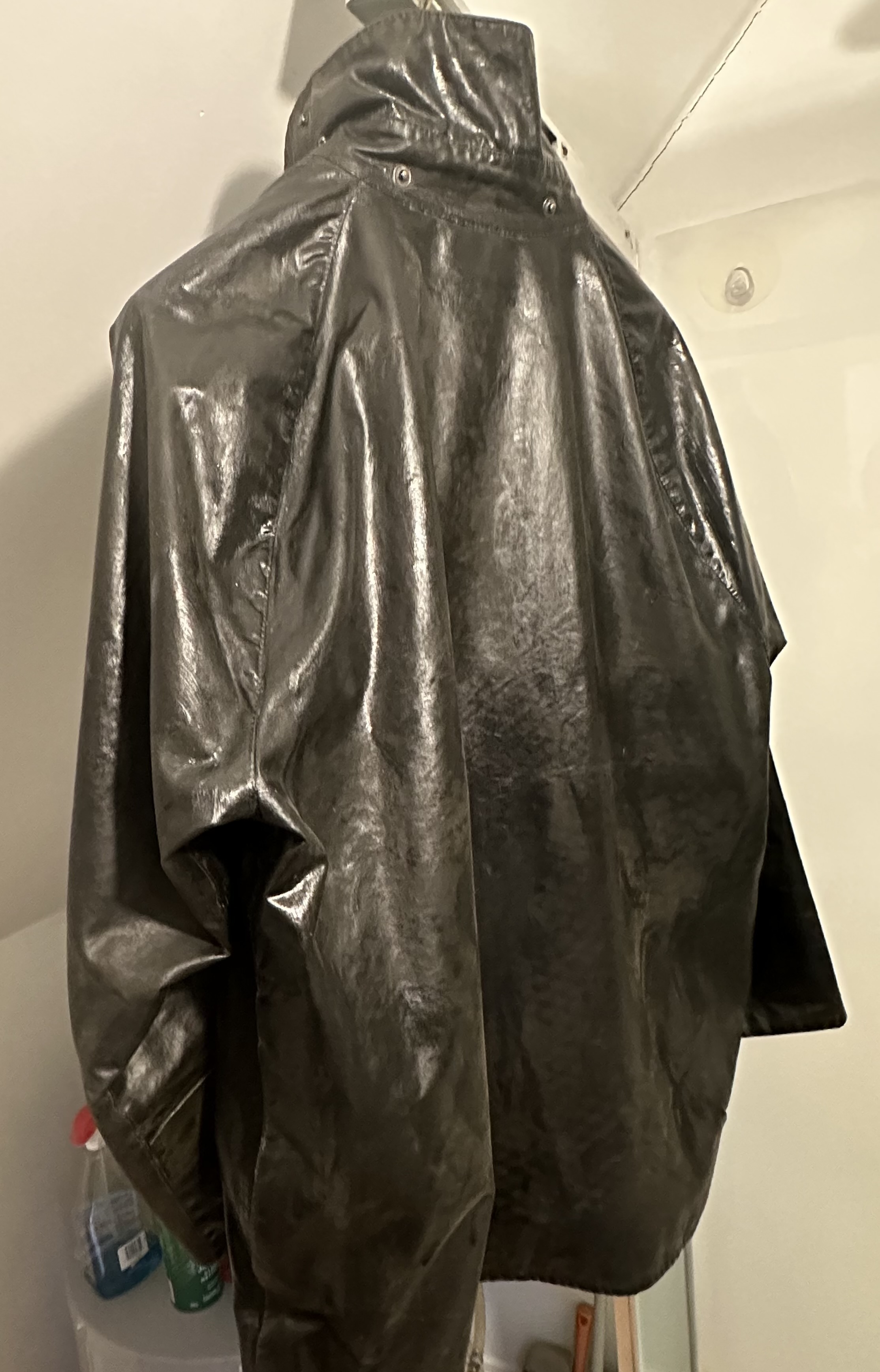

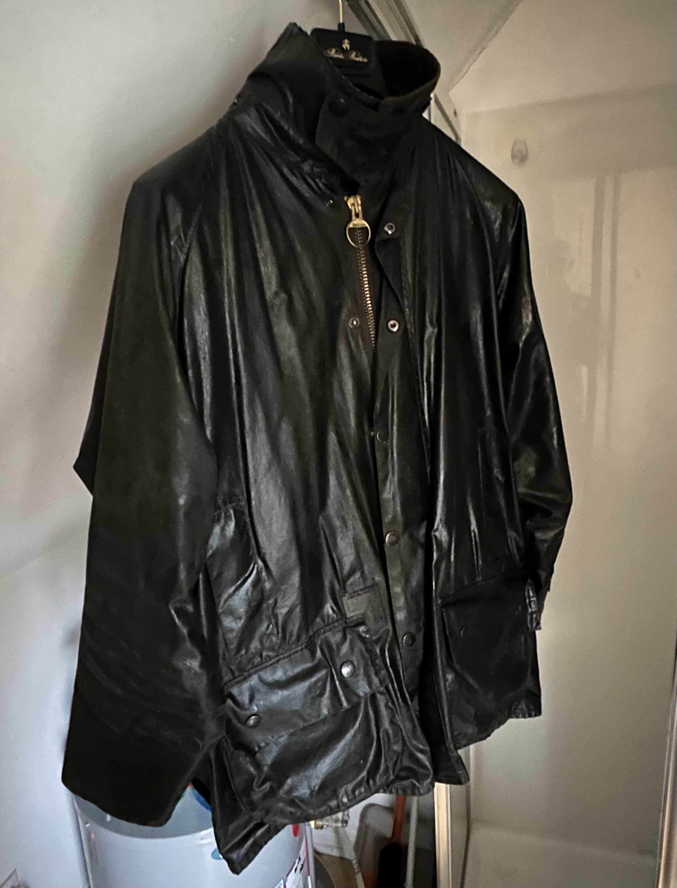

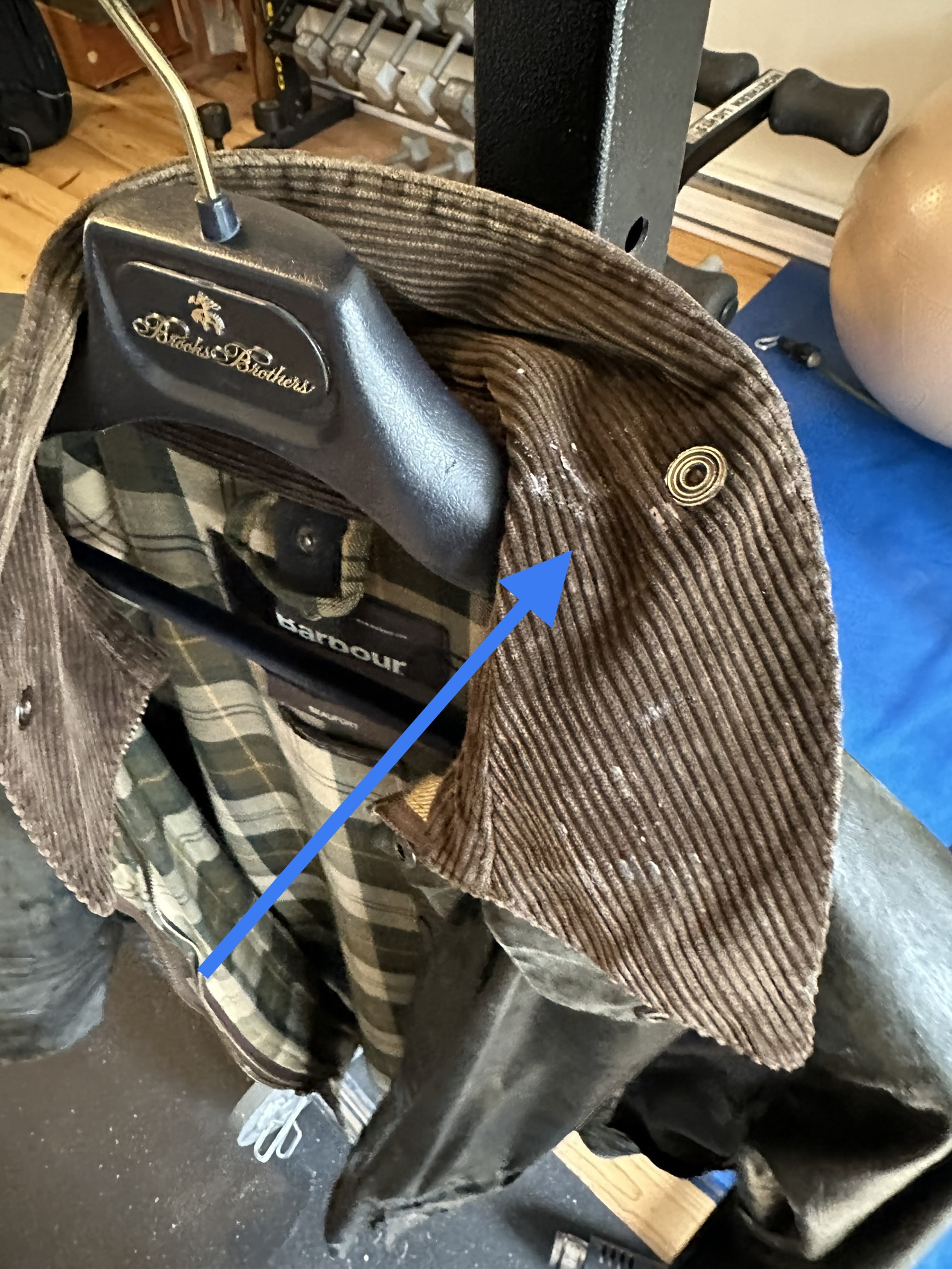

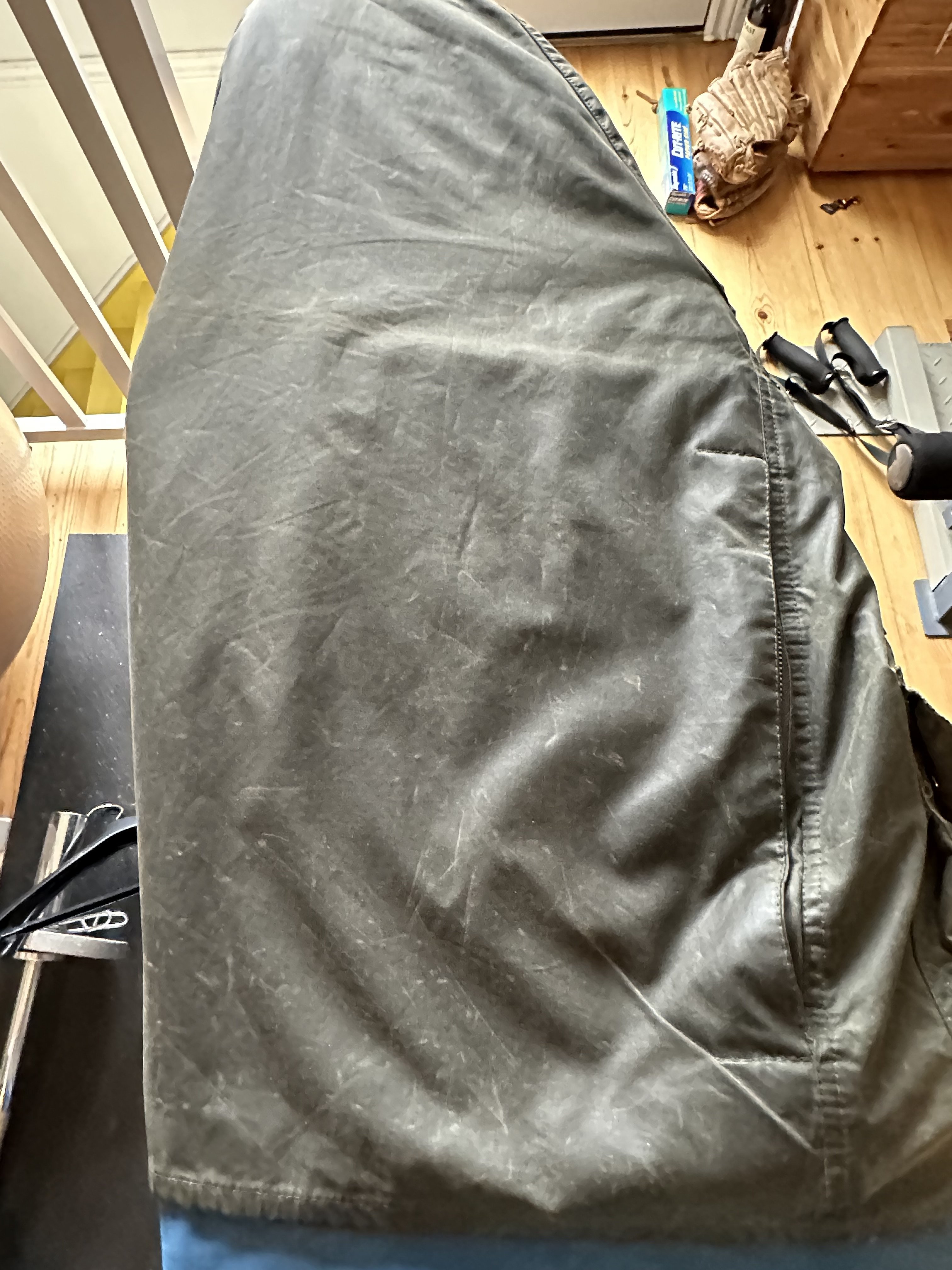

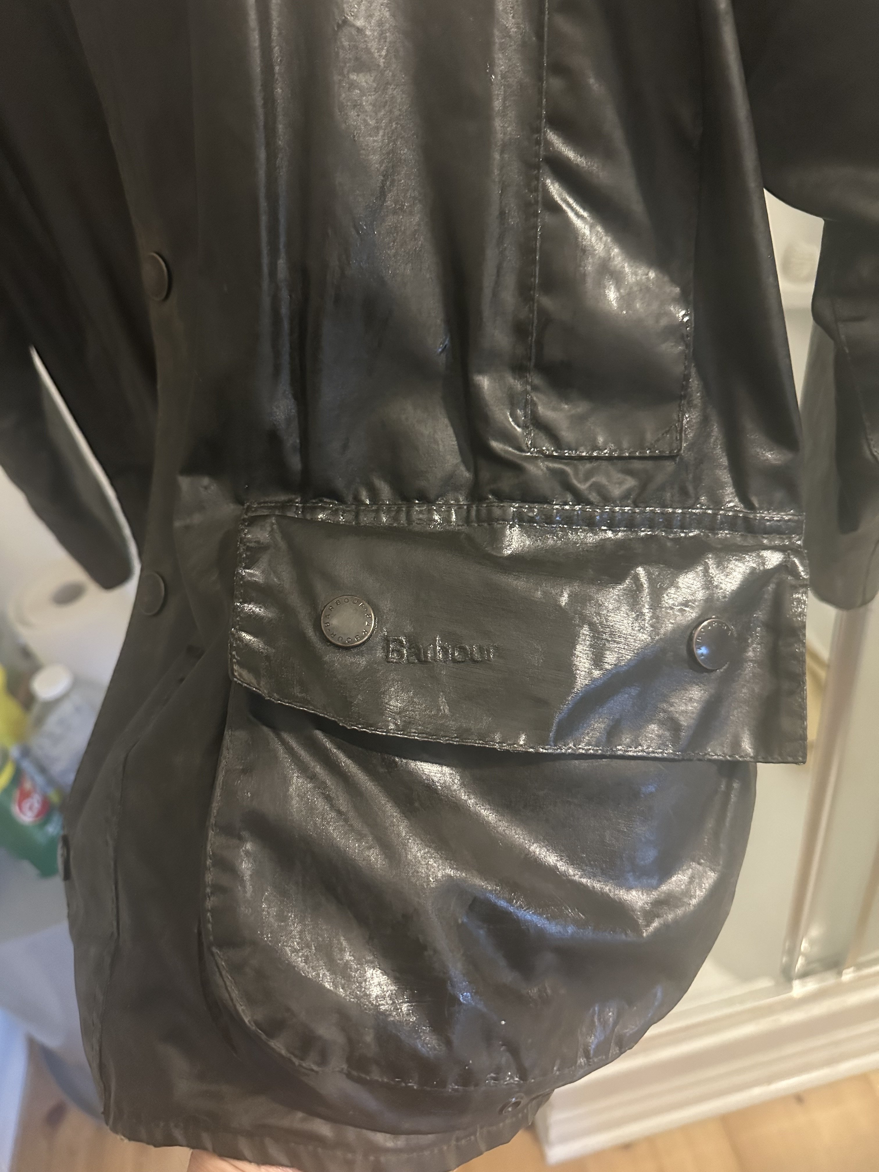

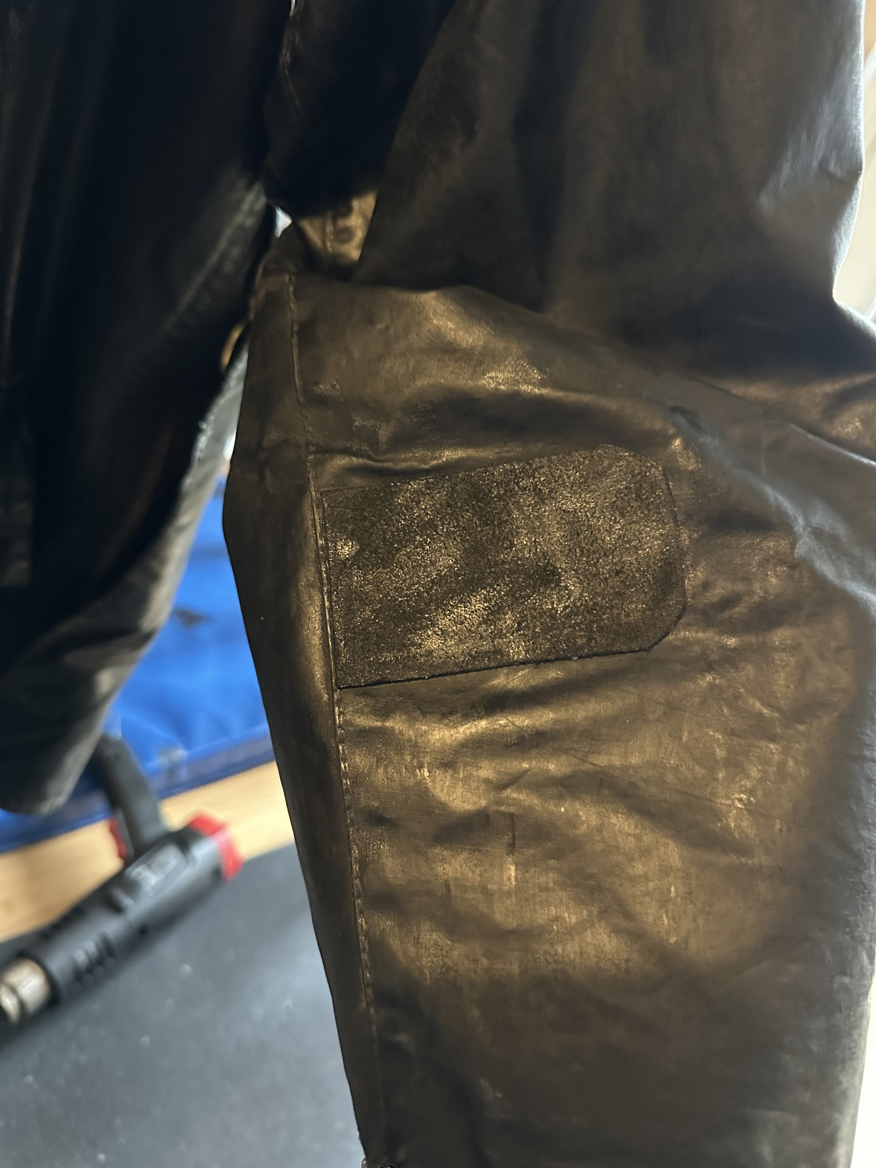

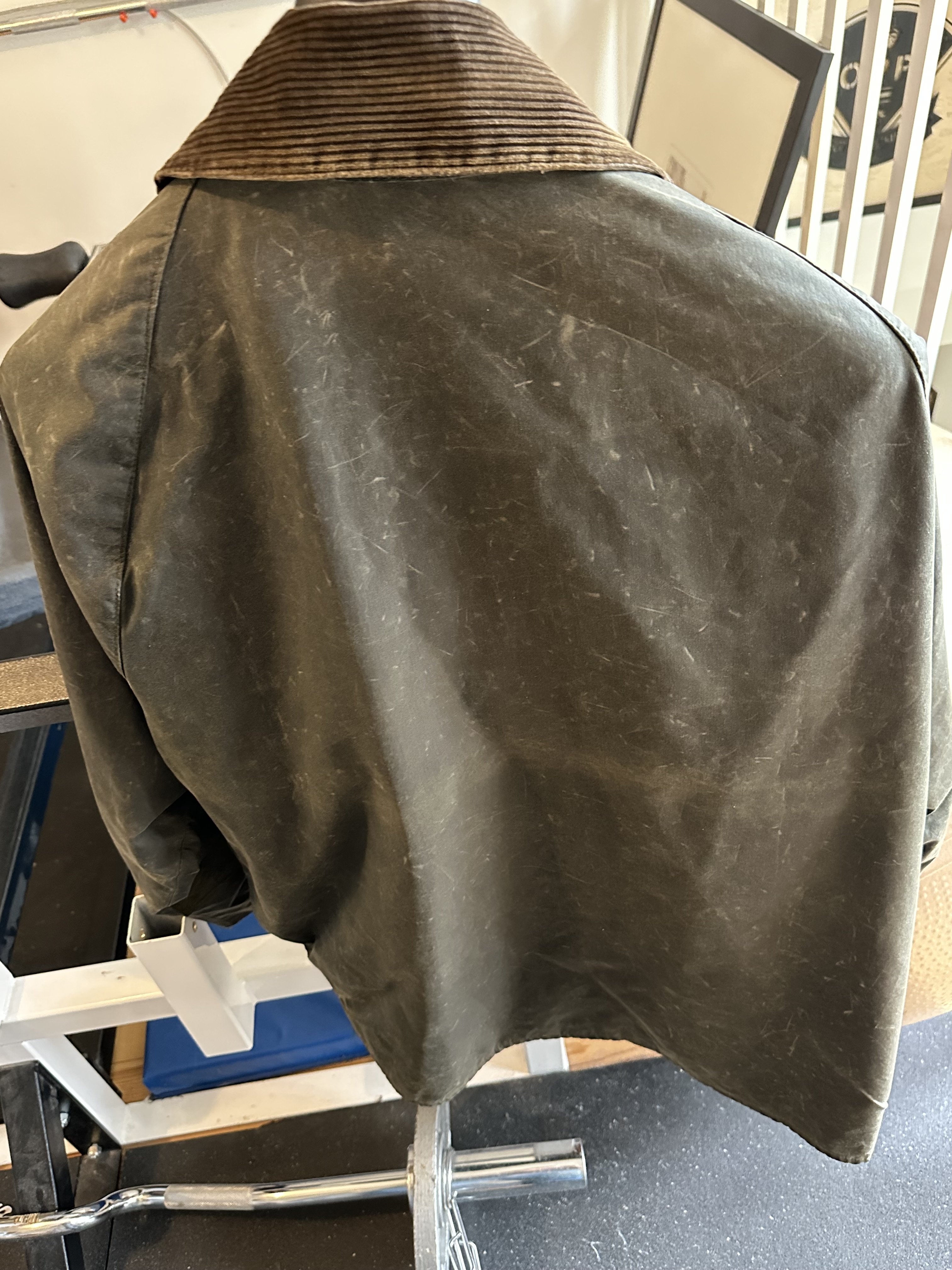

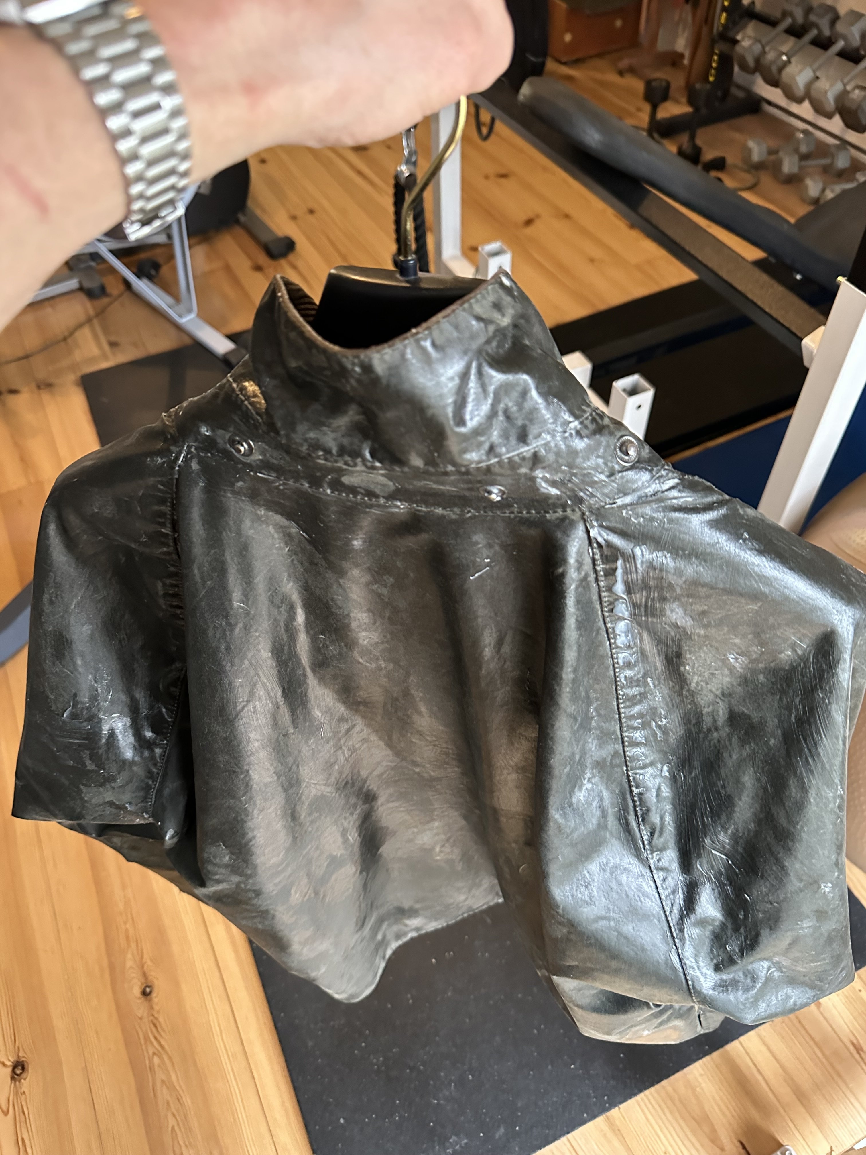

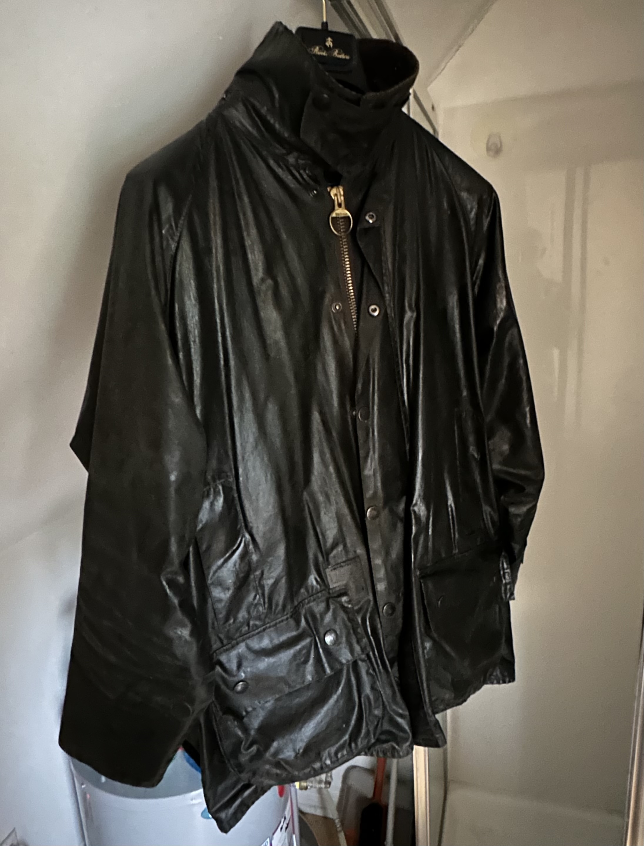

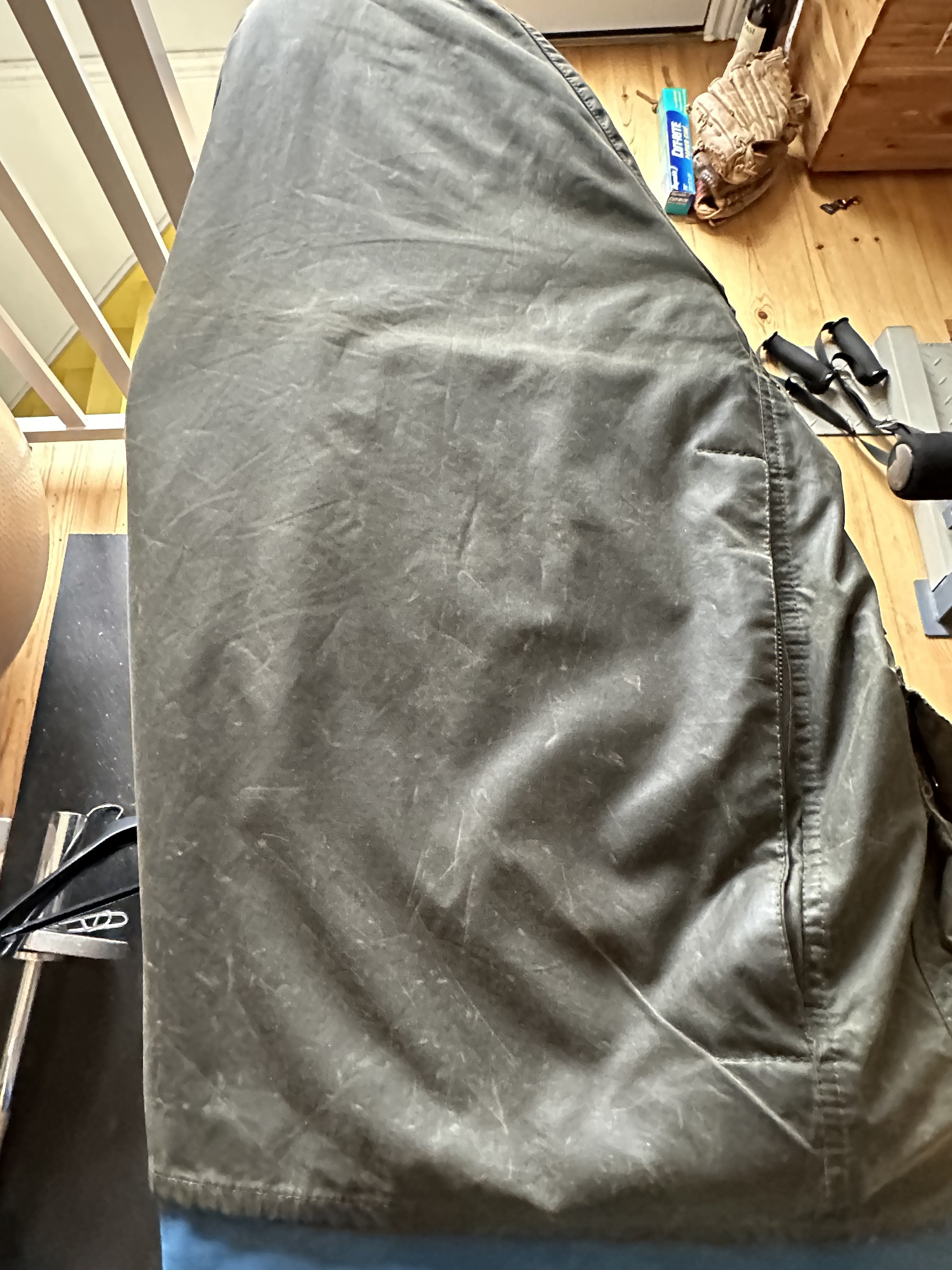

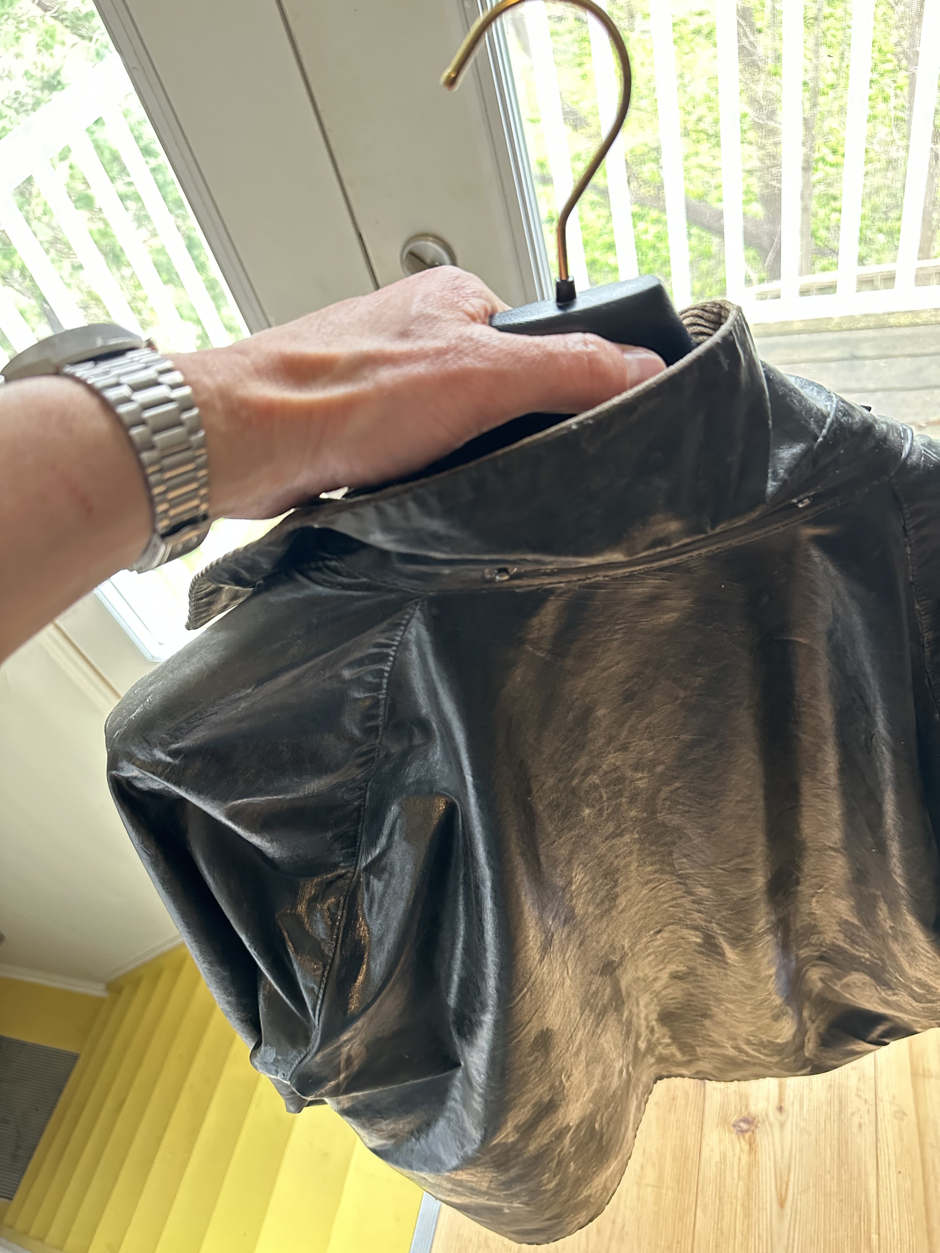

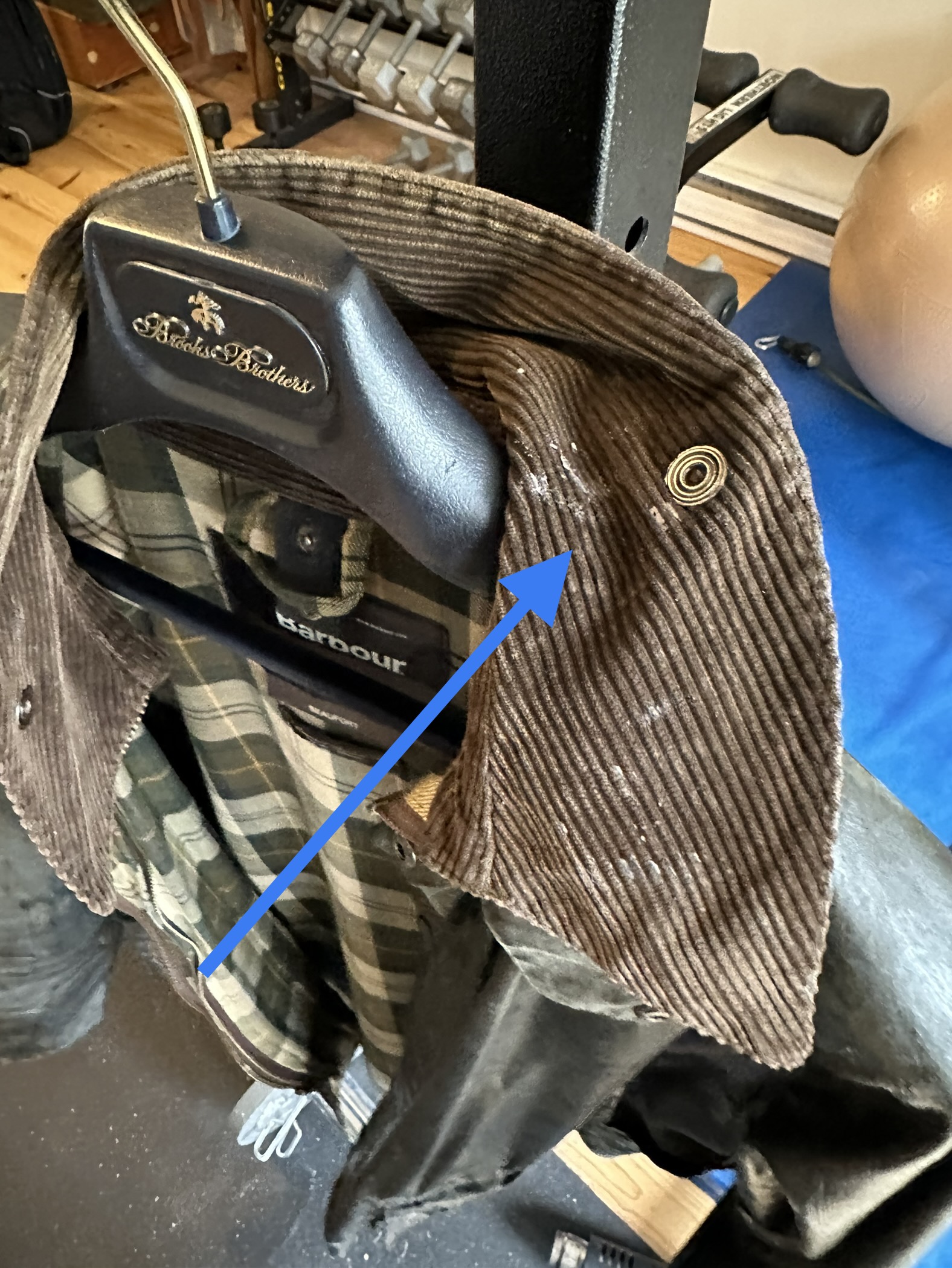

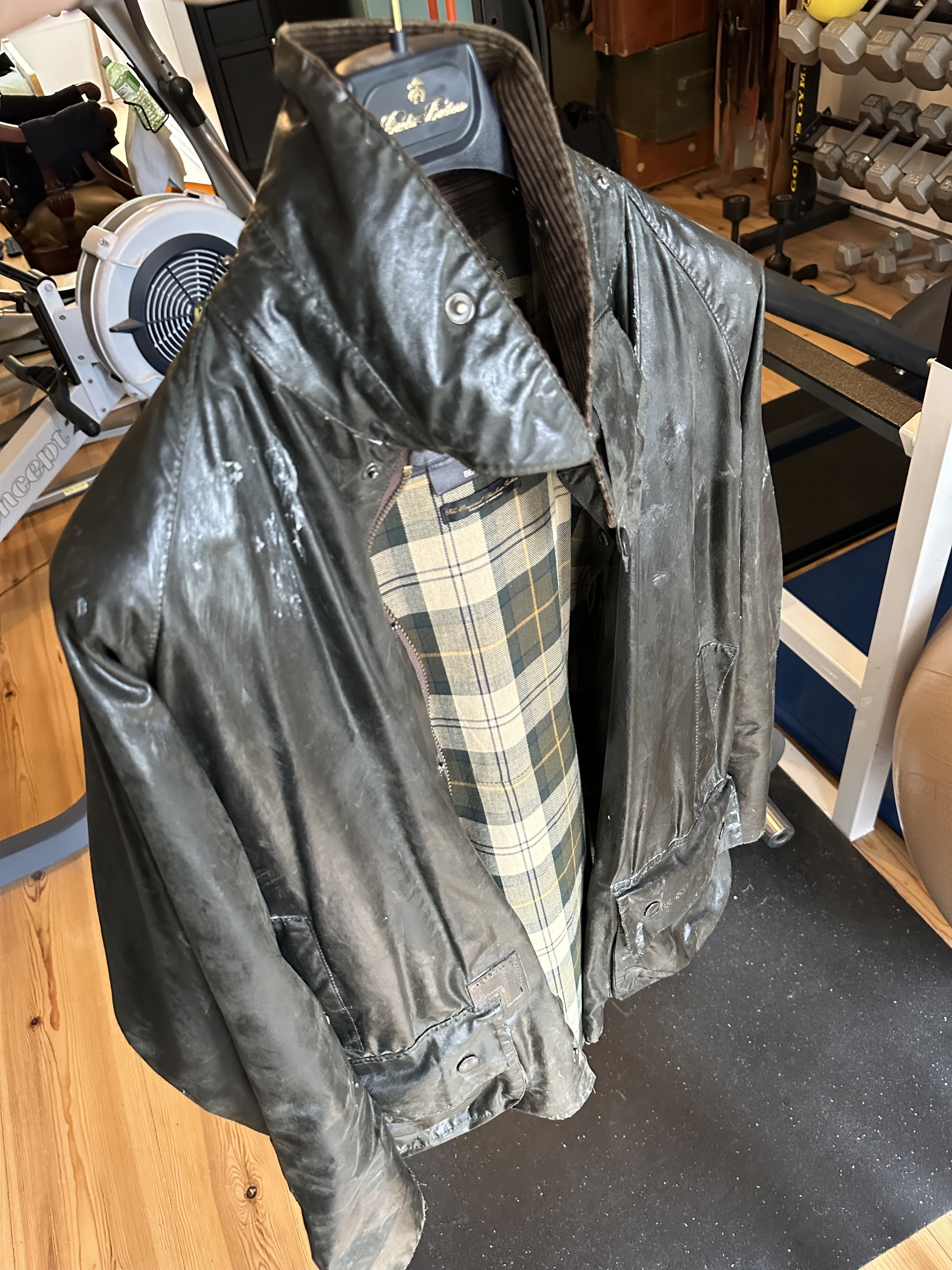

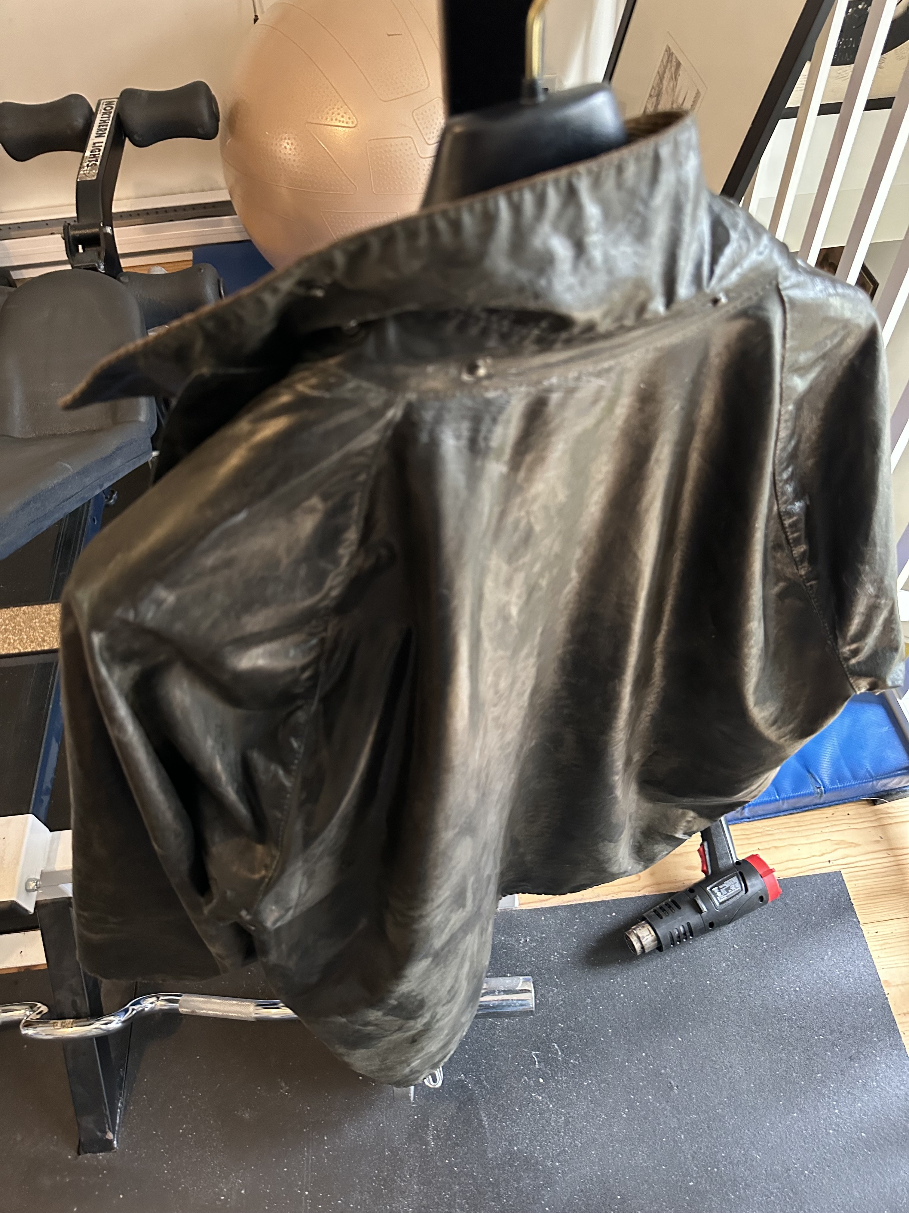

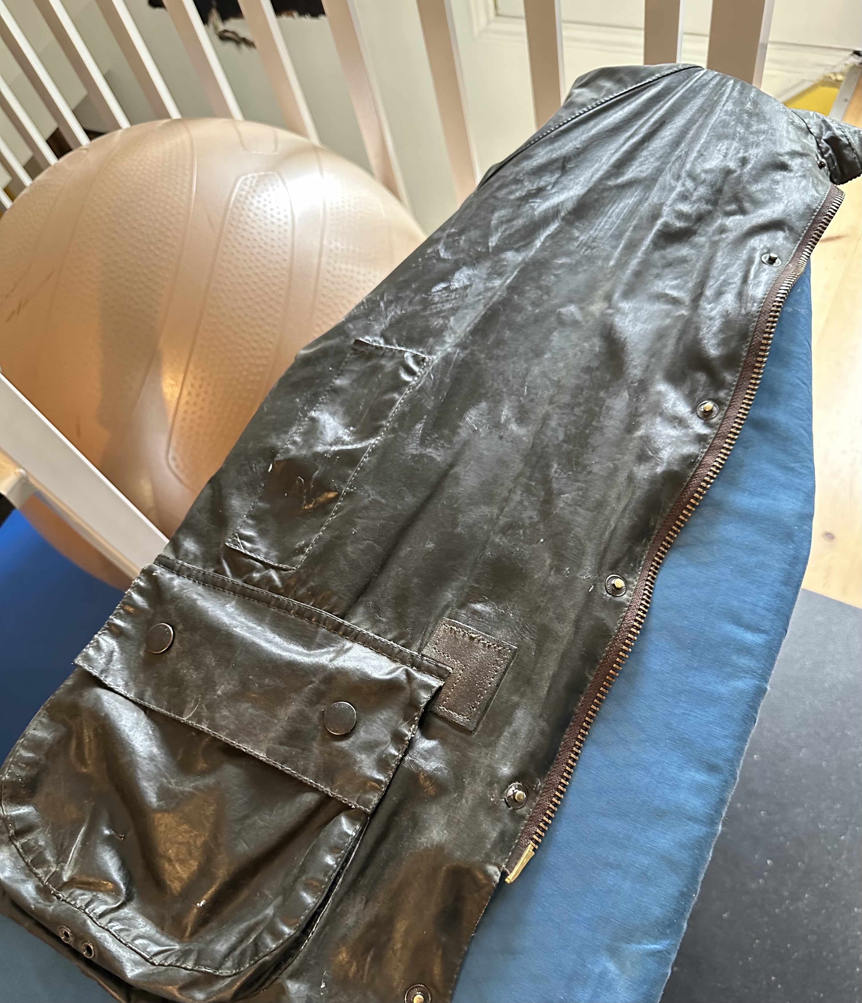

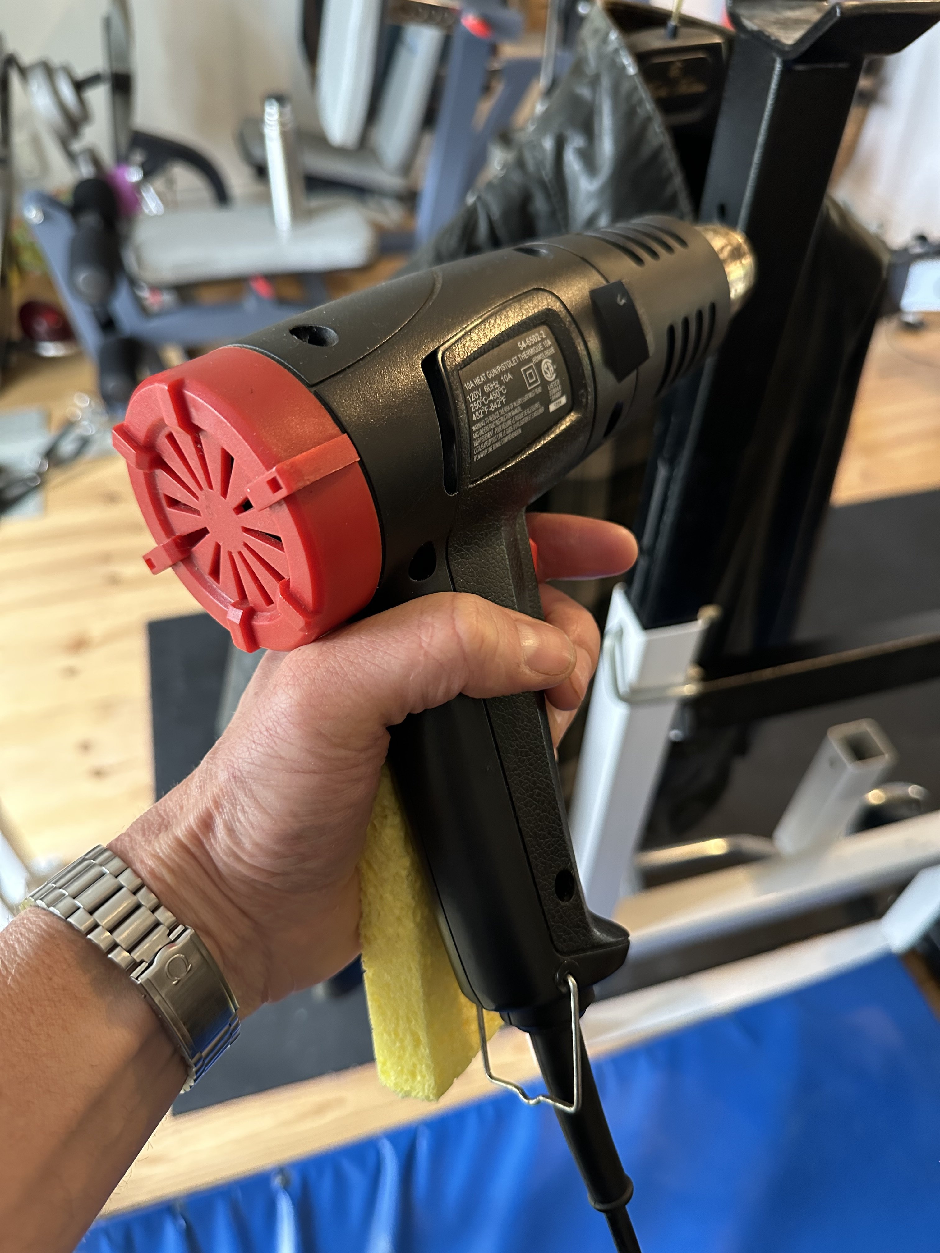

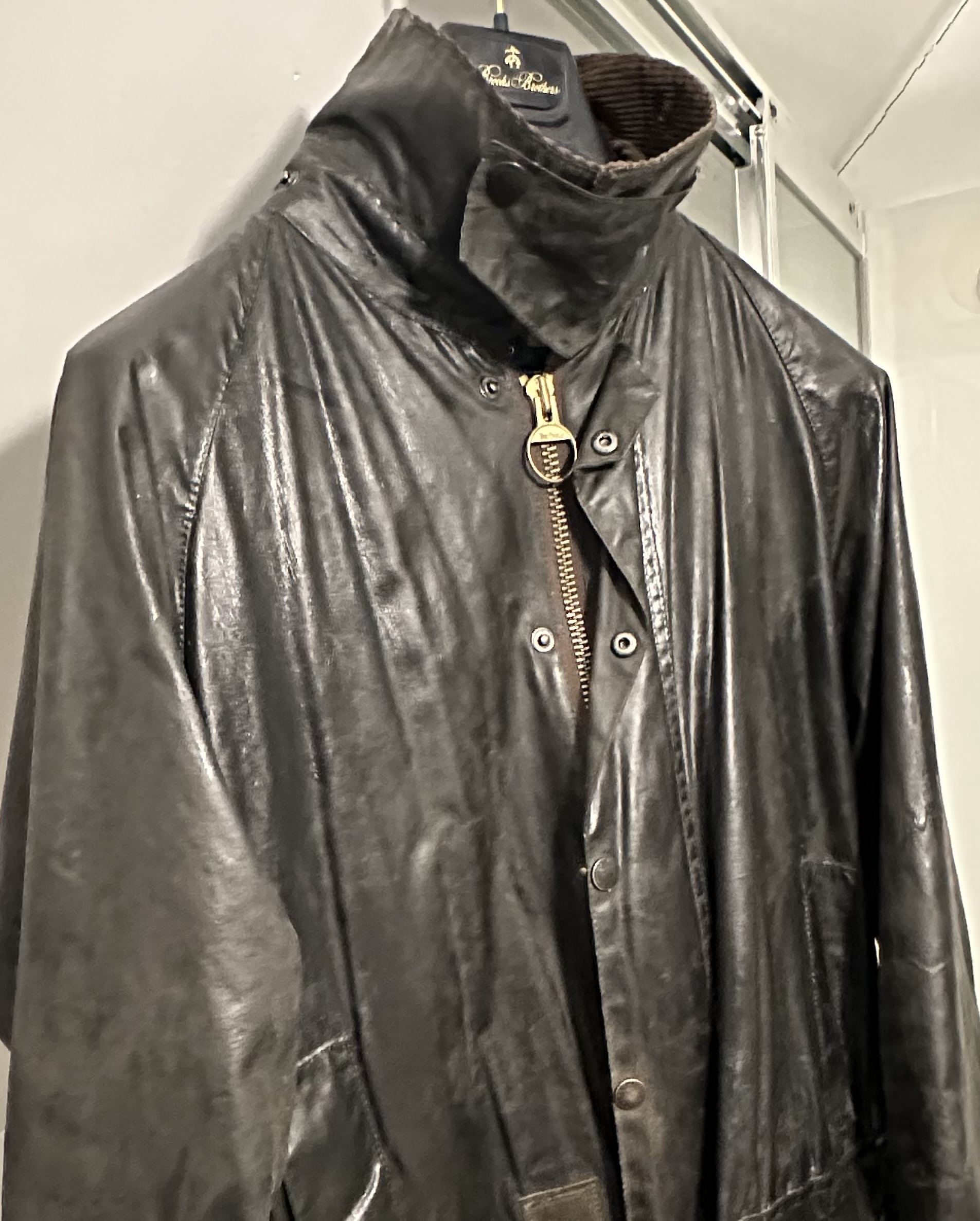

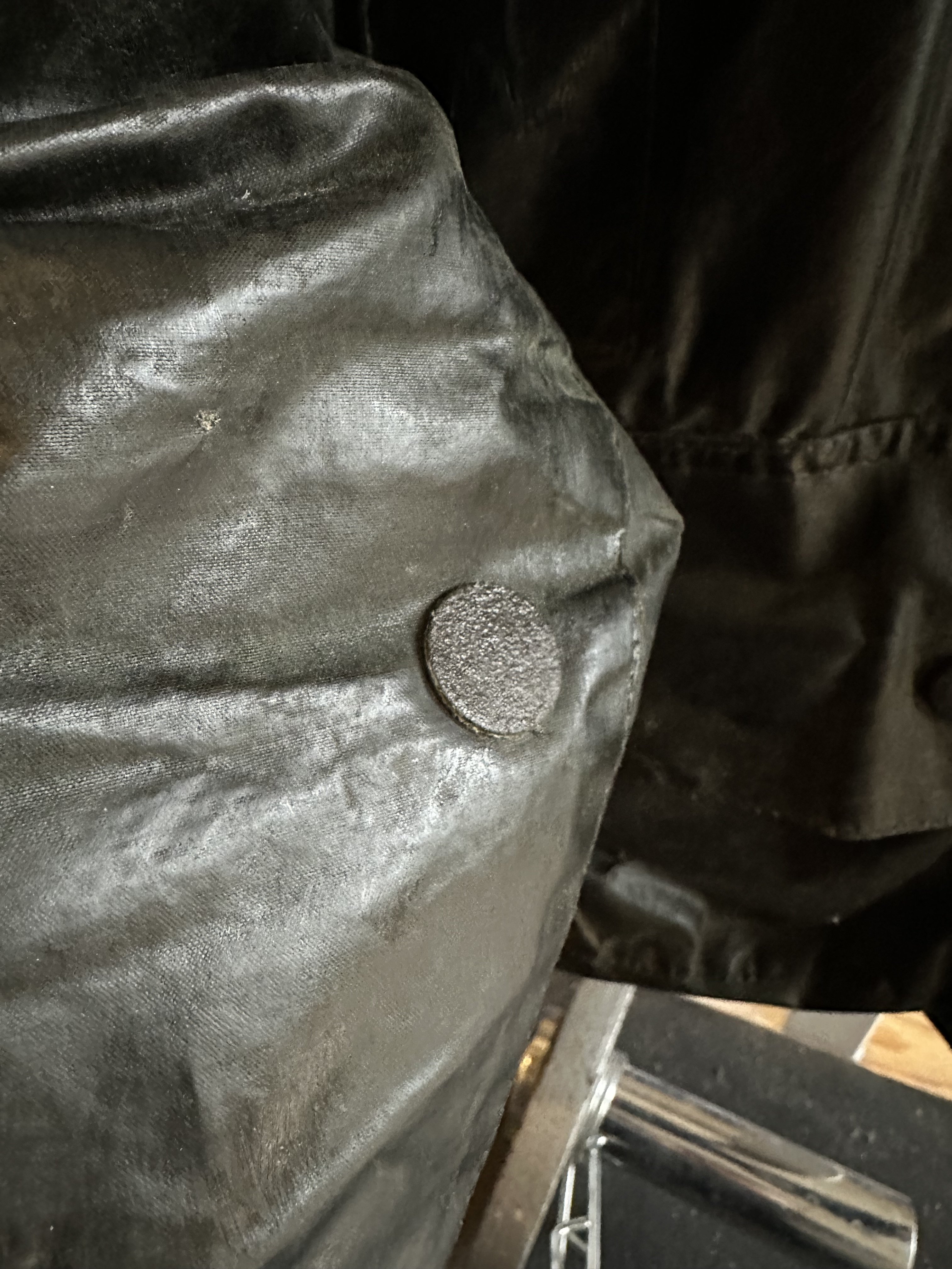

Jacket ready for waxing… I used an ironing board. Applied the wax with a sponge. Once waxed, I used my heat gun to work in some of the thicker gobs of drying wax. I worked the wax into the seams and onto my patches. You will see my pocket and two sleeve patches, plus my lining patch. Not perfect, but not bad for an old raincoat. My watch got covered with wax. This flightmaster has experienced worse in its fifty years of existence. I got just a little bit of wax on the collar. After sitting for about ten hours, it rubs out.

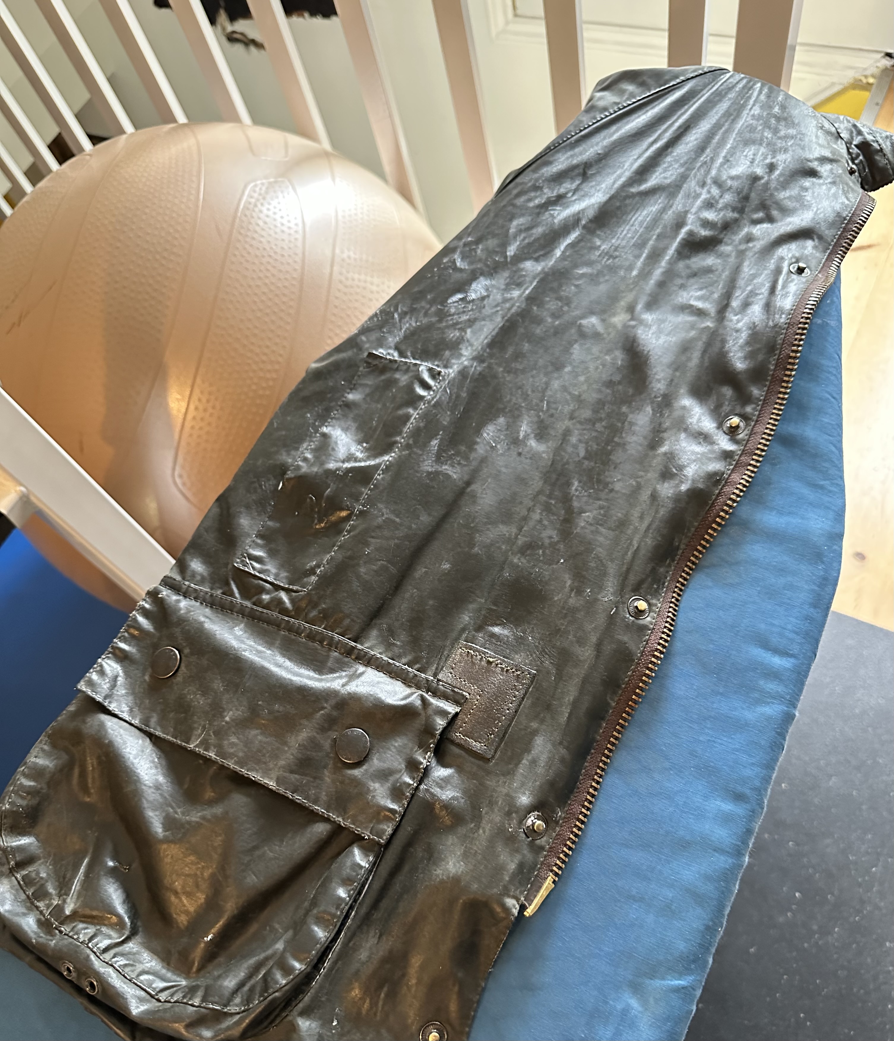

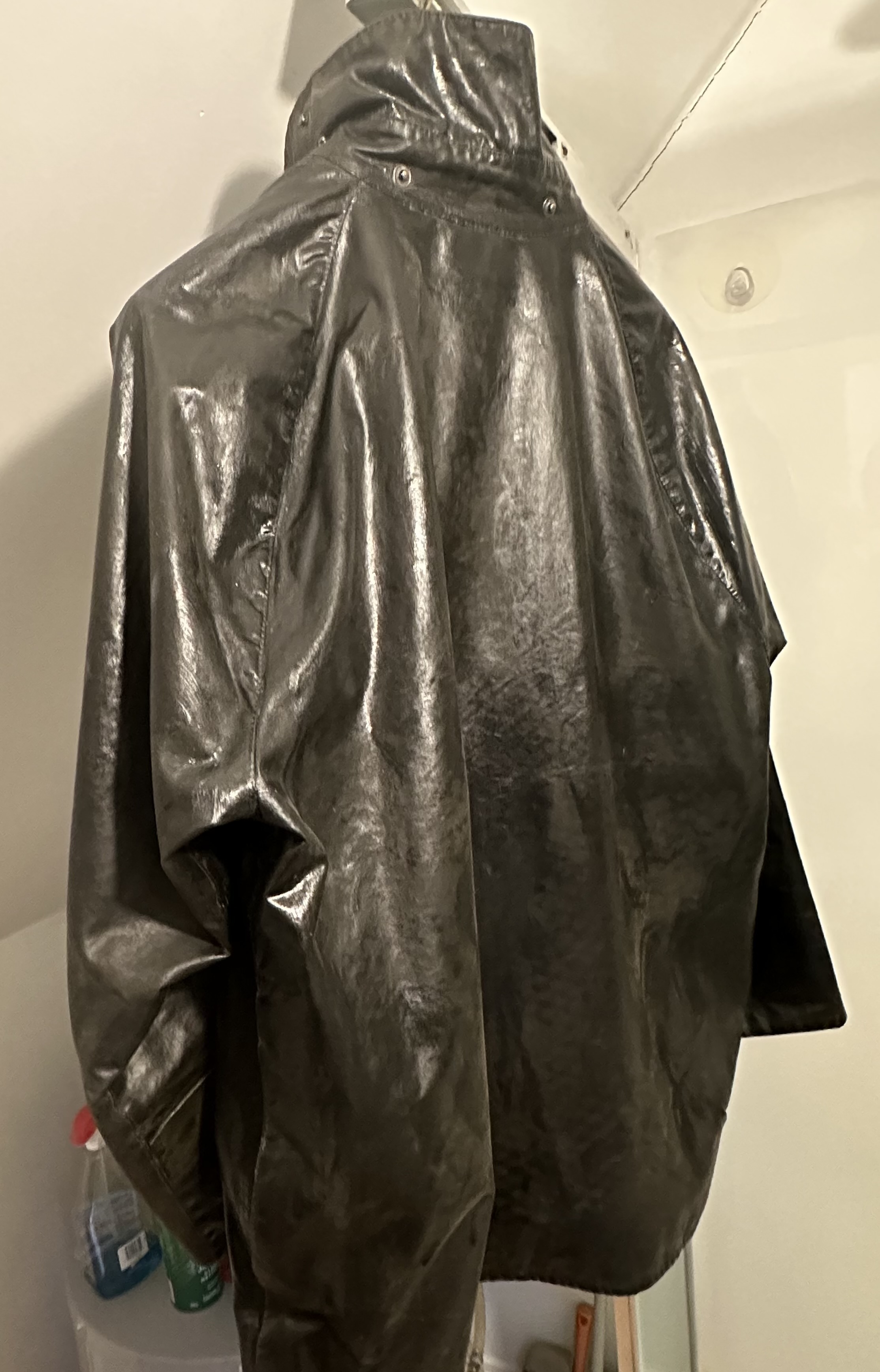

I took the heat gun to it again after a dozen hours to even out the wax. Letting it dry some more and hoping to wear the jacket tomorrow if I need it. This was a fun project and I am pleased with the result. I am sure that a bit of heat gun touch ups will be made once I put it on.

Looks pretty cool too with the patches. Think I also need to locate my Barbour and give it a wax
The jacket was inexpensive and in need of some care. Sending it to Barbour was the best option, but I was cheap (and likely broke some Barbour recommendations).
I have some old green suede from motorcycle chaps. Glad this is written text because however you pronounce « chaps », some asshole inevitably corrects you. The green arrow show the worn chaps and the yellow arrow shows the jacket. Not a bad match for patching material. First watch shot. The watch will get involved again later… I cut two patches for the pocket tear. One on the inner shell, glued, and one on the outer shell. The patch will be visible, and I am fine with that. I have a new waxed Belstaff if I want a new and tailored look. Yes, I like this Barbour better and am keeping it! The Belstaff… not bad but a bit too « slim ». I am slim too, but am in my early 50s, so the more relaxed Barbour fits better.
The red arrow shows a pair of cotton pyjama pants from Goodwill. I cut out a patch, ironed it and stitched the folded corners. This will cover the tear in the lining. Photos of the patched pocket, liner and sleeves to follow.

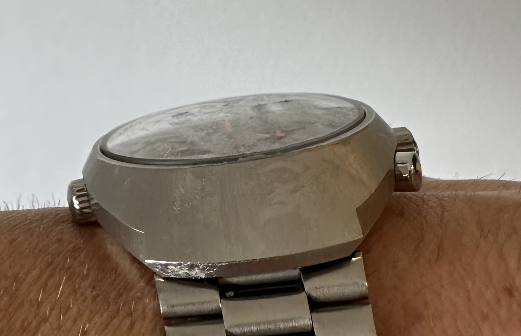

I got triggered….. need to see that watch shiny and safe again / my watch OCD kicked in.
Nice work on the jacket 👍

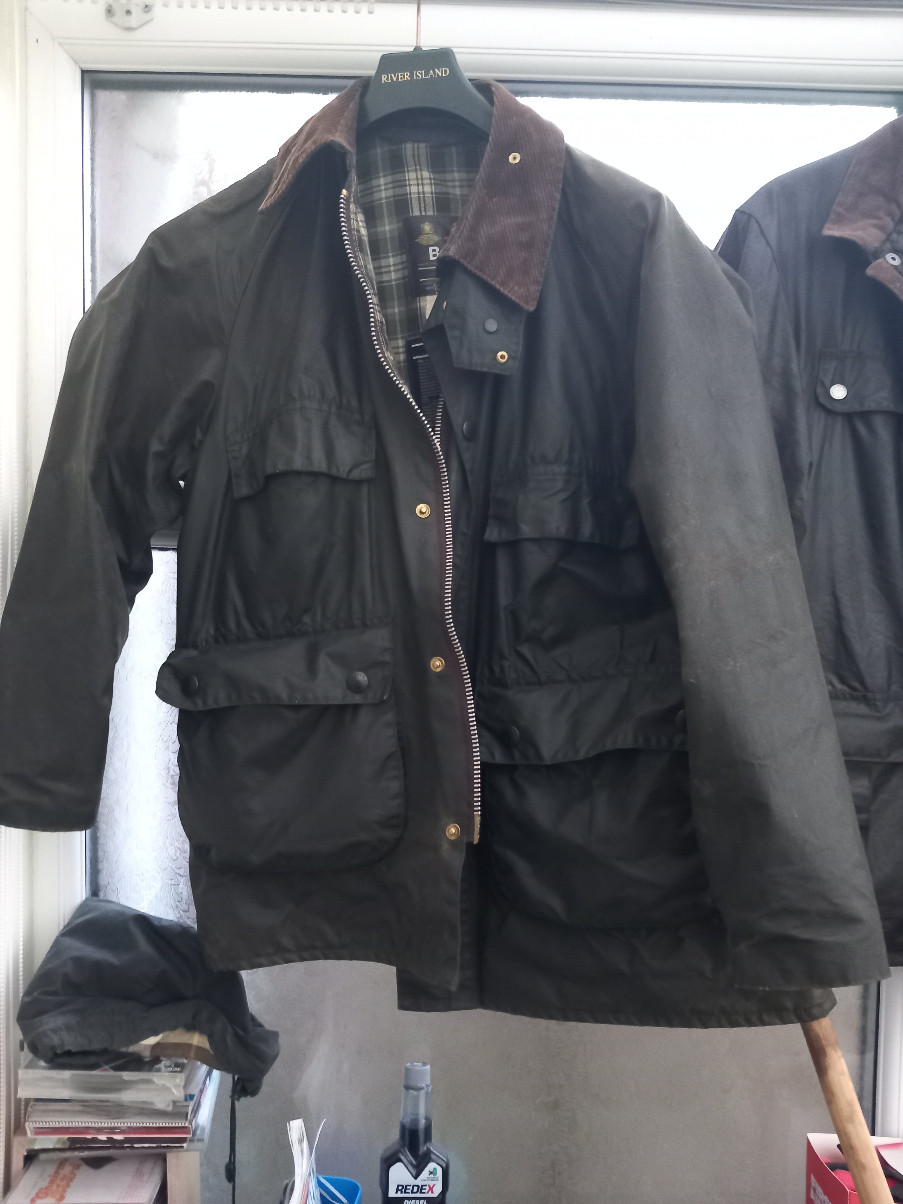

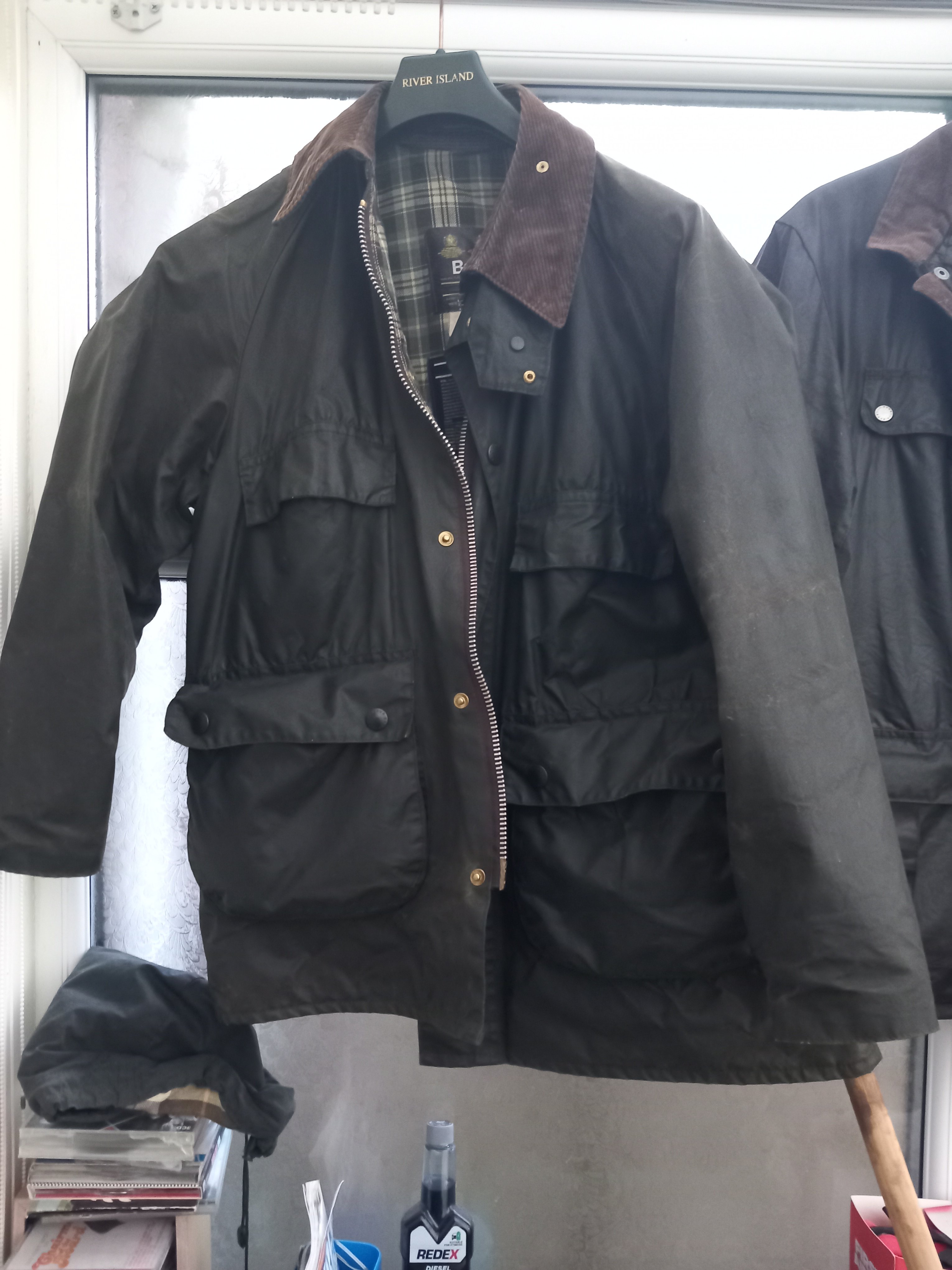

This is my oldest Barbour, a Bedale and just like the Beaufort and the Border, its one of Barbours traditional jackets and made in South Shields.
It was made in either 1988 or 89 and will probably outlive me.

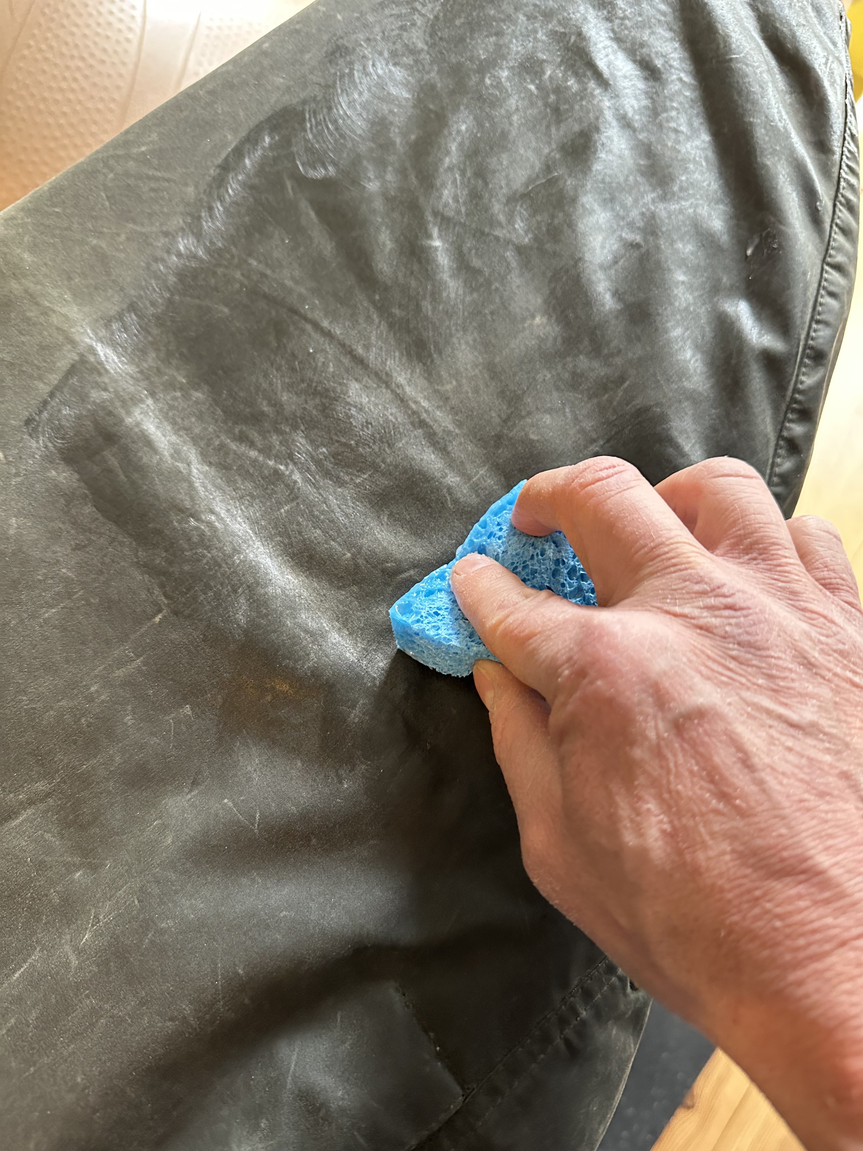

I've got 10 waxed Barbours and 6 waxed Belstaffs so have had plenty of practise with relaxing.
I use different sponges with mine as they get clogged up with wax and it doesn't spread as well when they're full of wax.
Once the wax is on I spread the wax around with simple kitchen roll and this method is the best I've tried.
Any globs of wax on the jacket gets the hairdryer treatment as used above.
I recently rewaxed 2 jackets with the old sponges that I'd kept because there was so much wax in them.
I've found the Belstaffs are easier than Barbours to rewax

For some reason the only tears in my Barbours are in the cuffs of 2 Dukes ??

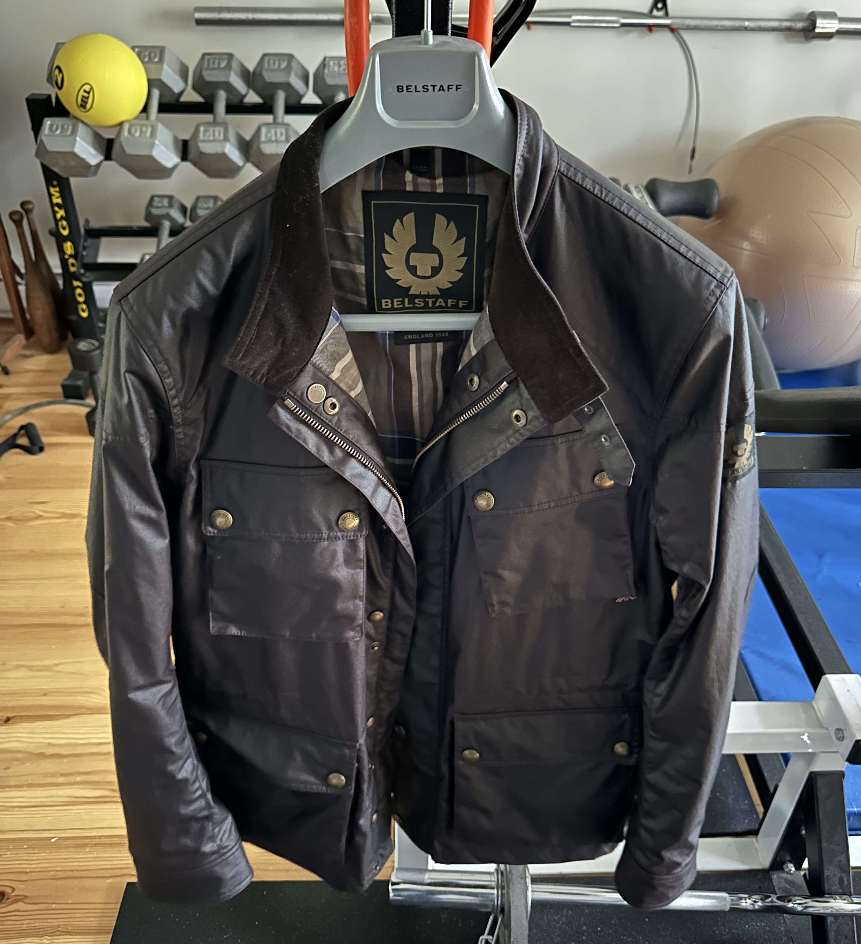

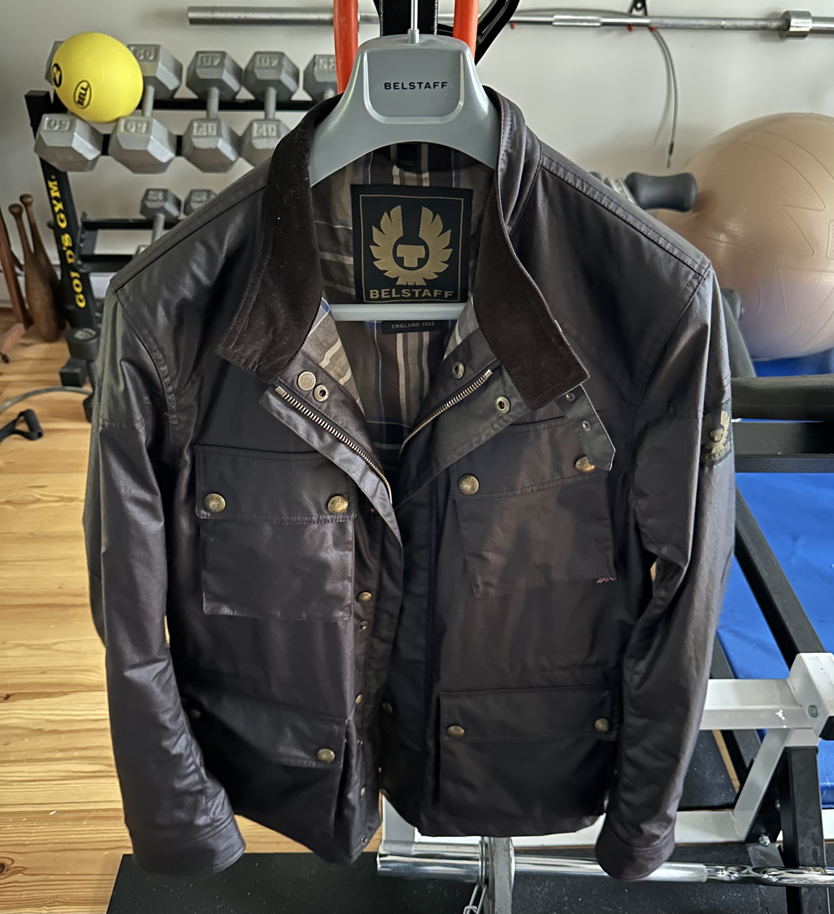

Is the Belstaff a Roadmaster/Trialmaster BTW ?
Thanks for the waxing tips! I have kept my sponges and will re-use them after reading your post. I have the trailmaster (pictured in my first post) and I also have a shorter Belstaff that looks like a motorcycle jacket with some padding. I rarely wear either one and bought them on the Mr. Porter website. The Barbour is a more relaxed fit. Trailmaster… hum? Almost sounds like an Omega product…
644
2,270
I hadn't thought of the Trialmaster sounding like an Omega product 😀 but I like it👍
Yeah just heat the sponge up with your gun, hair dryer or maybe the sun if it's hot enough and you'll be good to go.
I've overwaxed a couple of mine in the past and it's taken weeks to dry.
I don't get much wear out of my Trialmaster but the lighter ones, Kelland, Dunstall and Racemaster ideal at this time of year.

I like to rub out after sitting for ten hours as well.
