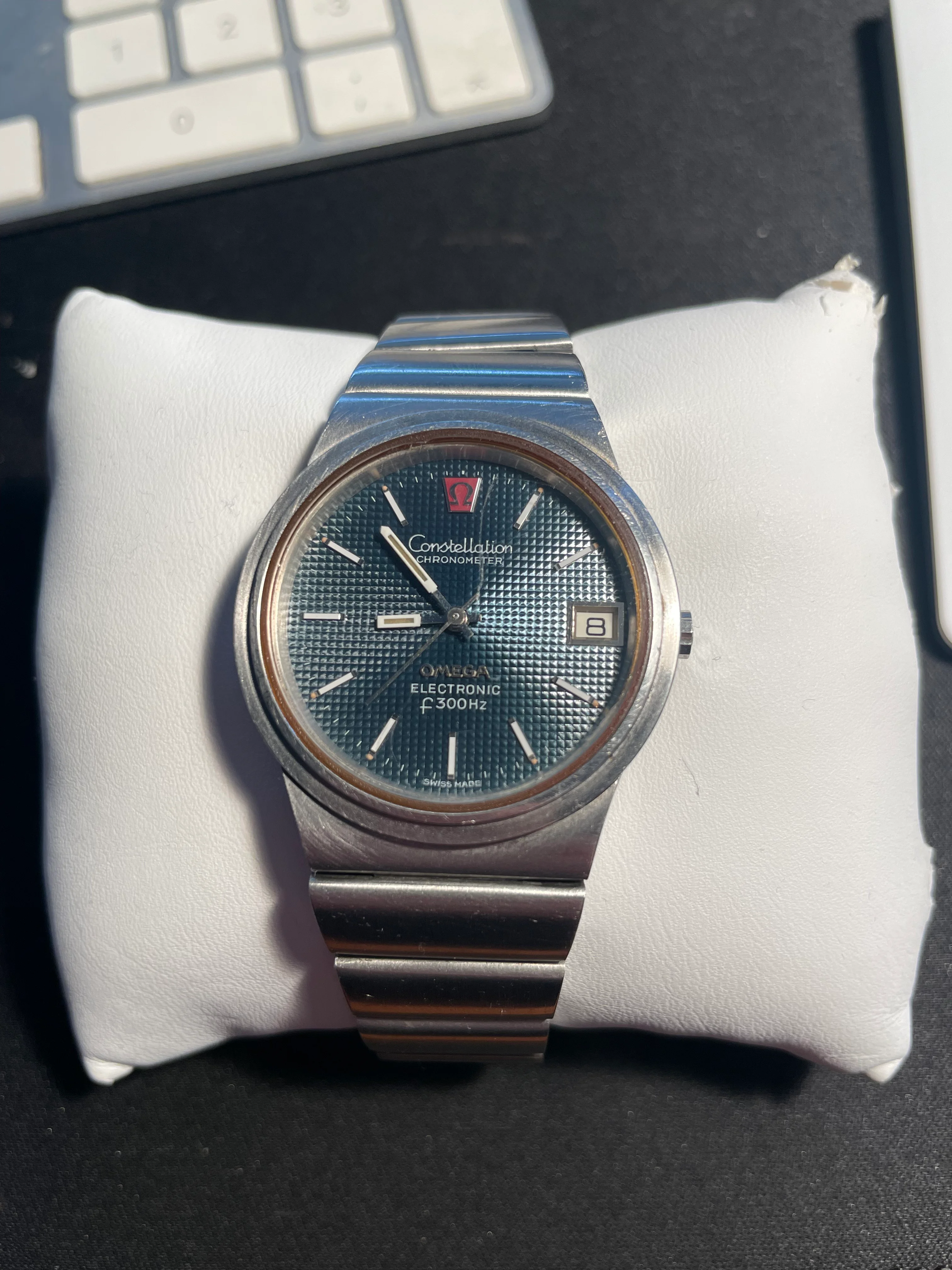

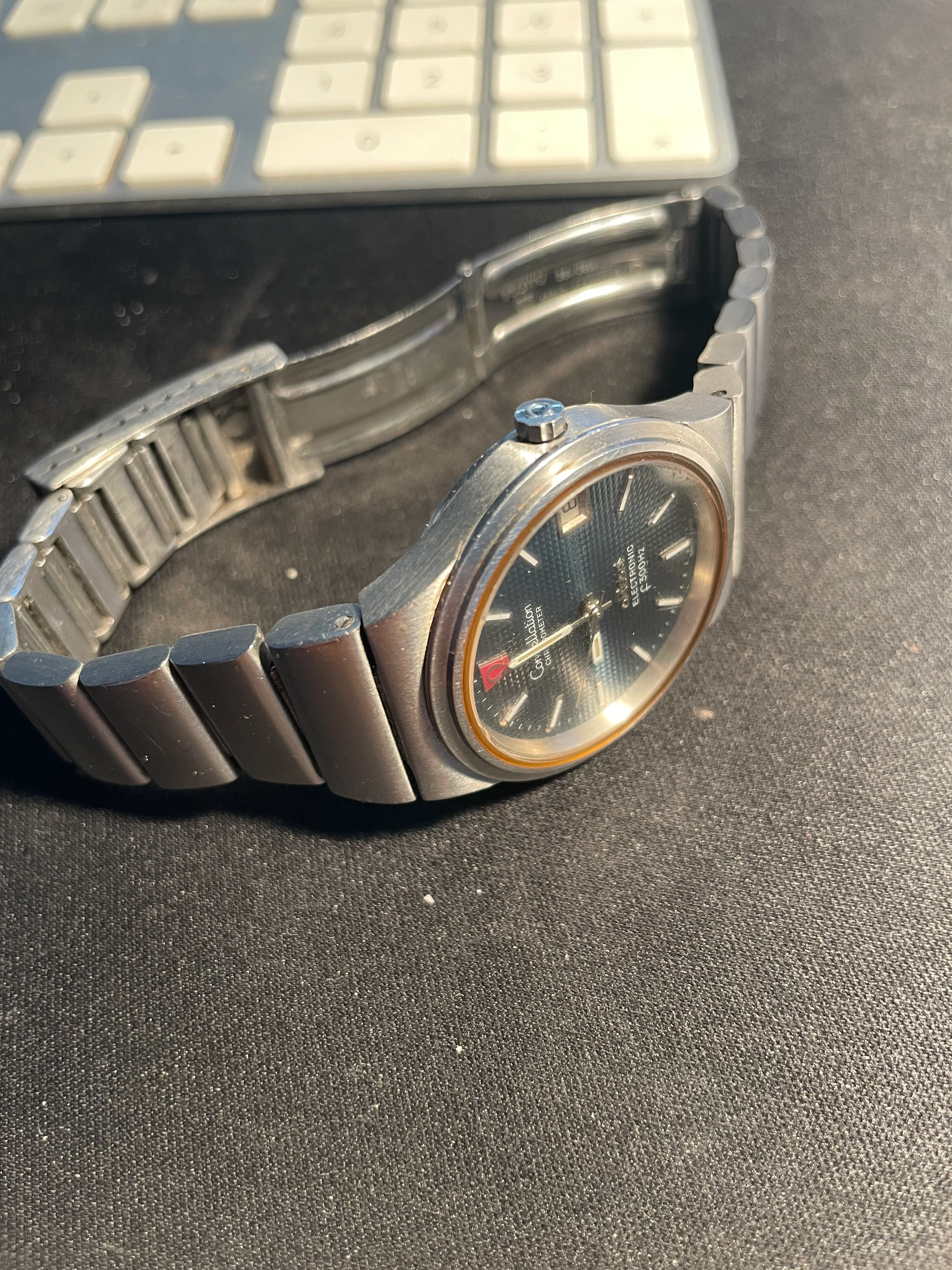

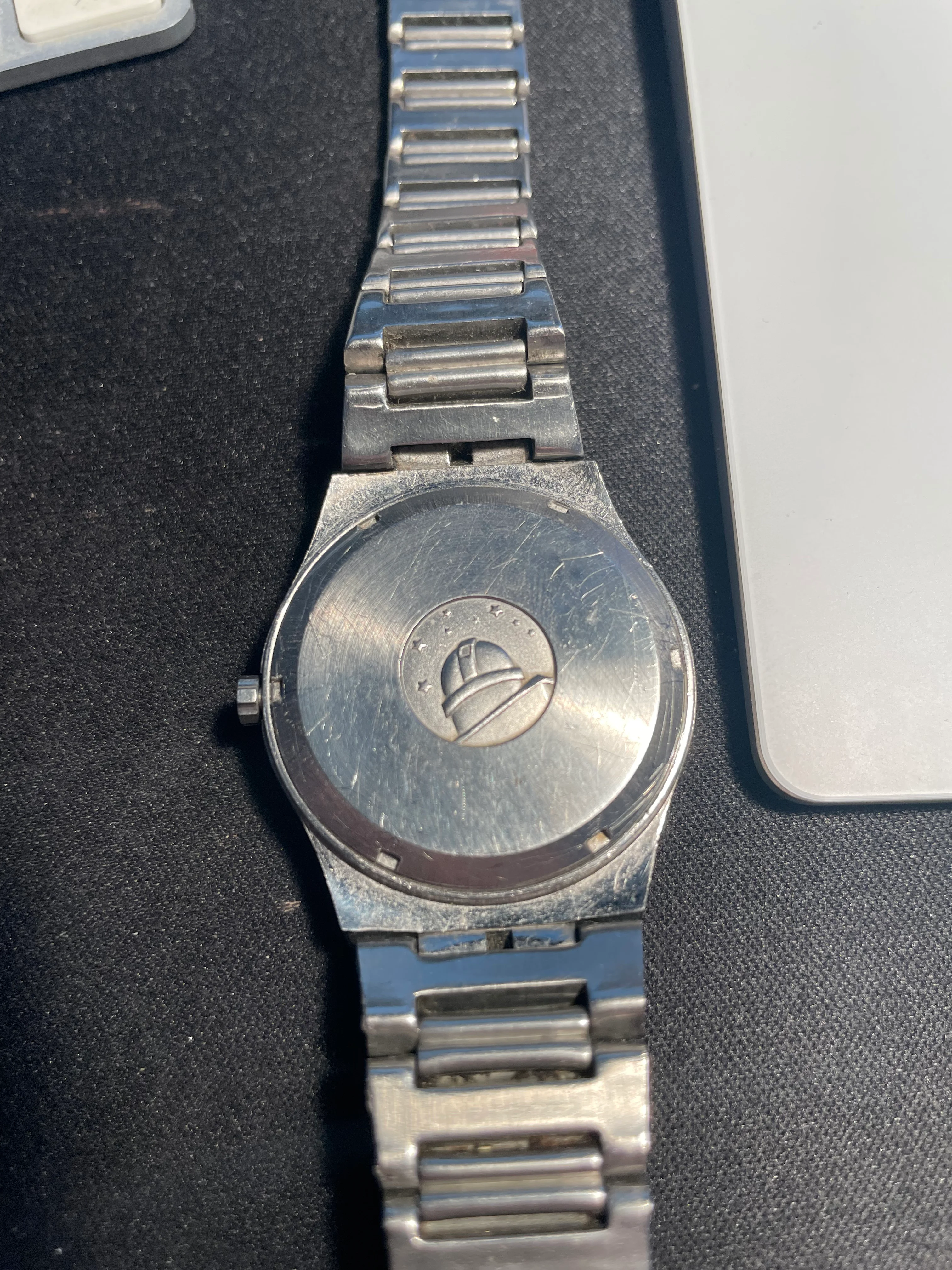

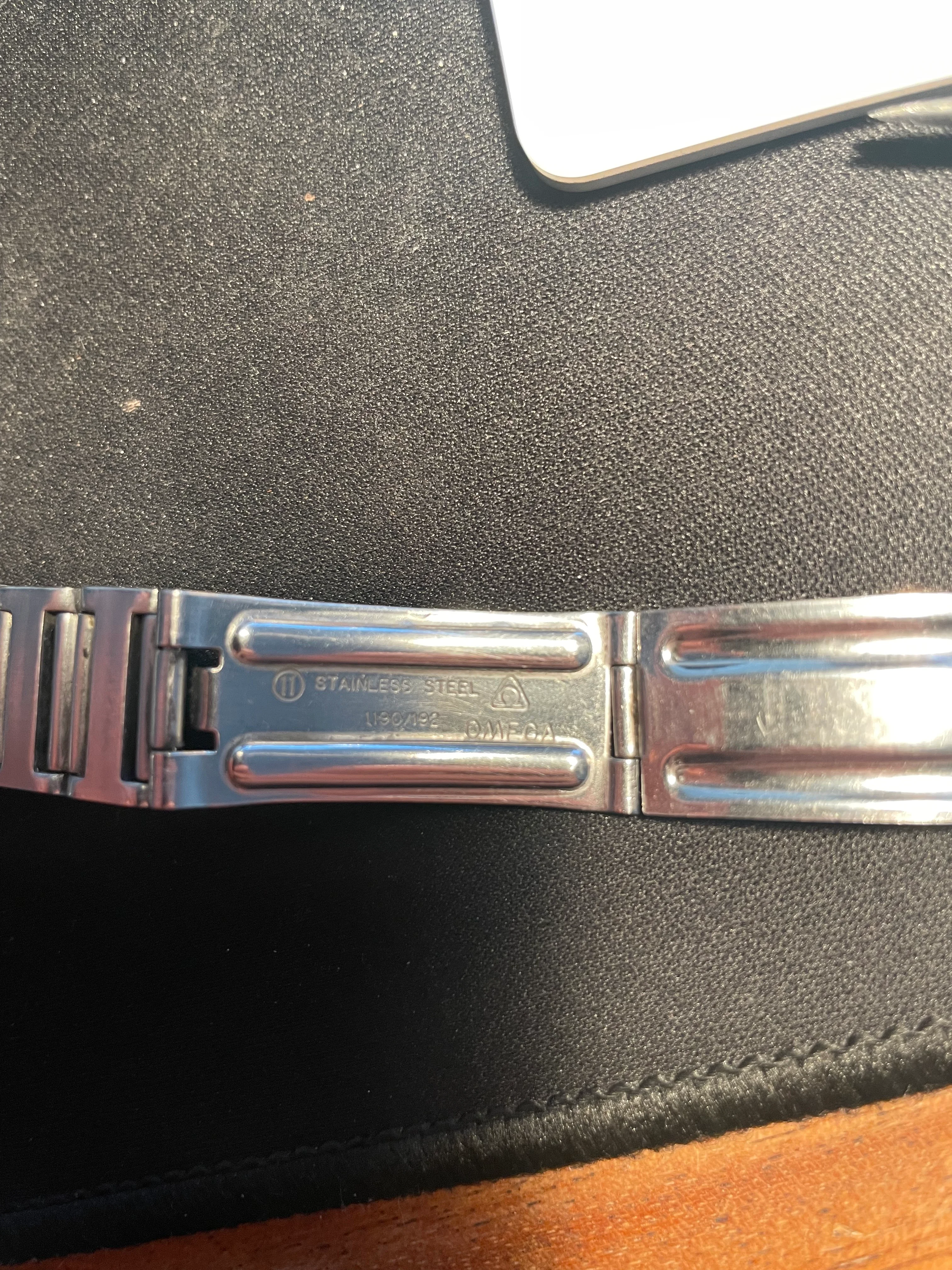

Hello all,
I bought a 198.0024 Omega Constellation, however I have not been able to find much information about it. I know that it houses an electronic movement by Bulova and that its from the early 70s but i haven't been able to find anything beyond that. It has a beautiful blue 'waffle' dial, but I couldn't find one similar without the weekday in that colour. The following are my questions:
- Is it original?
- How often should it be serviced? I have heard that the movement tends to be a little fragile.
- What is it approximately worth? (with box but without papers)
I am fairly new to the world of Omega and watches in general, so excuse my lack of knowledge 😀 Here are some pictures:

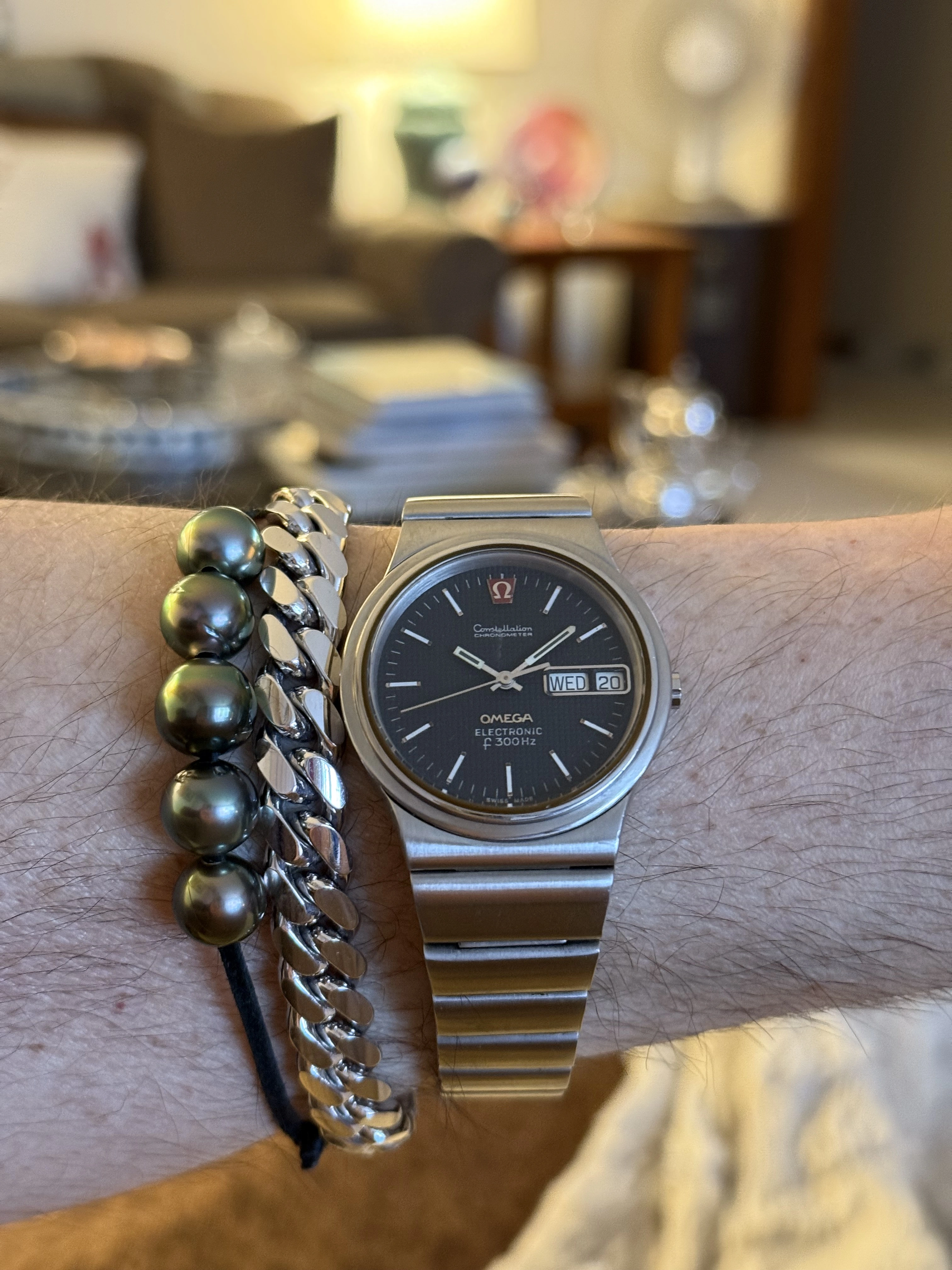

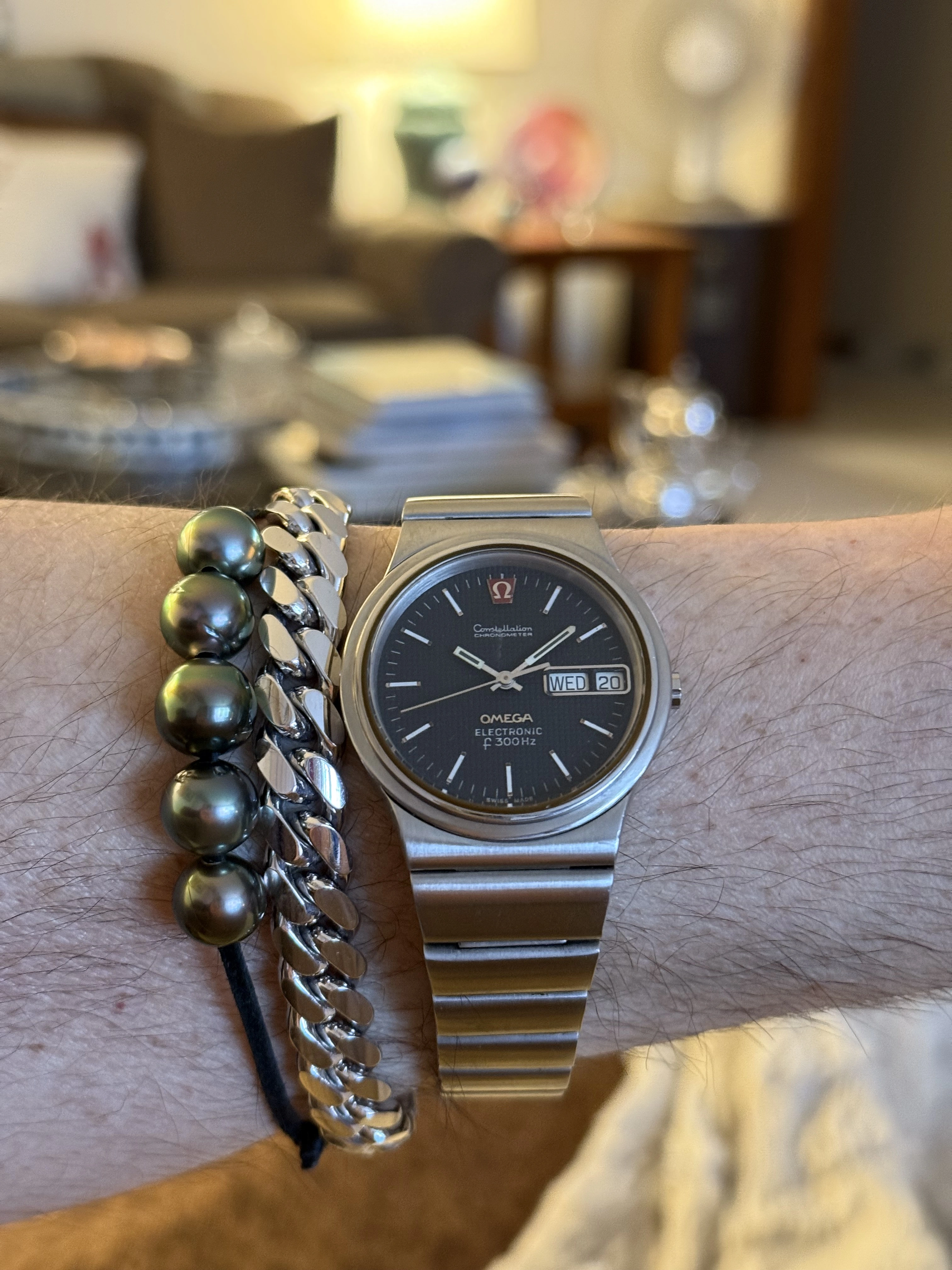

Looks original to me. I have its black-dialed sibling.
If it’s accurate it shouldn’t need servicing.
I paid $500-ish for mine in 2014.

Cool piece! The metallic blue dial looks lovely and tuning fork watches in good shape are worth taking care of for sure
It seems to be very accurate, it tends to only lose 10-15 seconds a week. Looks stunning in black as well!

Movement is not by Bulova. It is likely an ESA calibre 9162 which, like Bulova Accutron tuning fork watches, has a tuning fork of which you are aware. The calibre 9162 movement is often marked “Licensed by Bulova”. Similar to the Accutron, but otherwise quite different. Bulova owned the patent on Accutron movements, requiring the labelling. Value? Depends on what sellers are asking, and what payers are paying. I have two Omega F 300s, and an Eterna (Eterna Sonic, same movement). Total expenditure for all 3? $50.00 (Cdn.). But if you really want one, and you like it, and it runs, pay what you have to.

Echoing @dsio
Super cool piece and I’ve never seen the blue dial variant.
Hard to value these don’t come up that often, your not paying for a year of college for someone… not even a US junior college…
But something a lot of collectors would love to have. Welcome to the weird world of watch values.

These are worth about £400 to £600 UKP over here.
I love a hummer, I have four Omegas with 916x movements. I also have an Omega Electroquartz and a Bulova Spaceview. And of course a large stack of batteries...
I didn’t know that, thanks! Seems like you got a good deal, though 😀

That is a very cool looking watch, it almost looks like it's missing a bezel though. In fact I would have sworn it was with the crystal standing proud like that, until the second pic of the black one below it proved me wrong. Maybe I've just gotten too used to my Speedmaster's bezel and everything without one feels naked now.
haha yeah it would have to be a very small bezel, since its only a 35mm case
