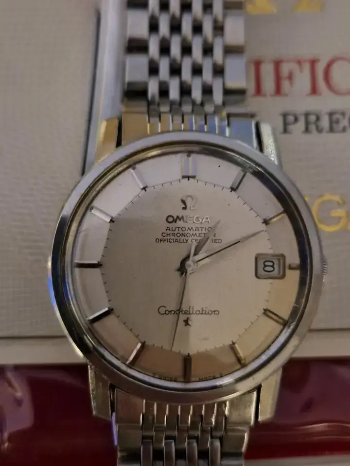

Pretty standard 168.010
Endlinks are too small, seems like the minute hand has been exchanged

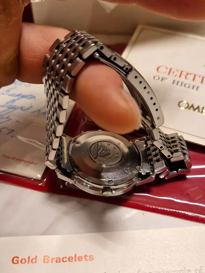

Case back damage here?

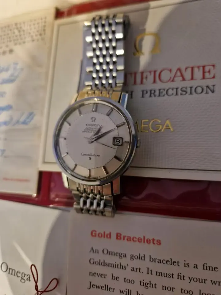

Do all the boxes correspond to the reference?

Everything looks more or less correct.
Sales receipt coincides with the movt serial.
Boxes are period correct.
The bracelet is definitely too narrow (18mm)
There is the damage to the rear.
Likely a replacement crown.
Correct dial with some spotting.
The minute hand does look a bit black, like a painted insert, but could just be lume that has gone very dark.

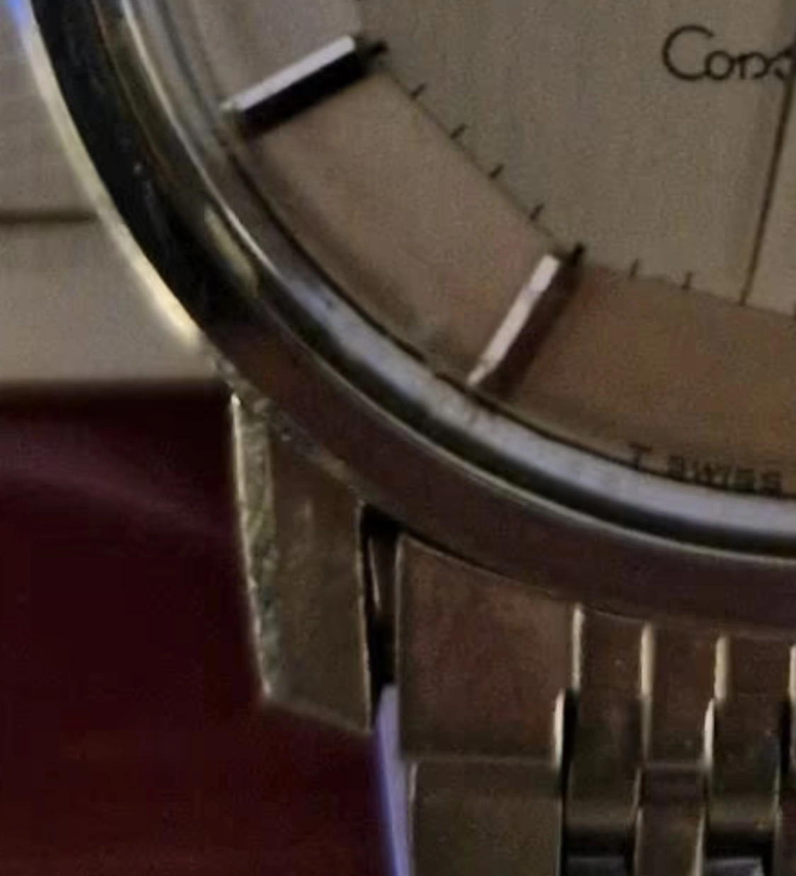

The case looks reasonably well defined still but the lugs seem to have had a hard life.
