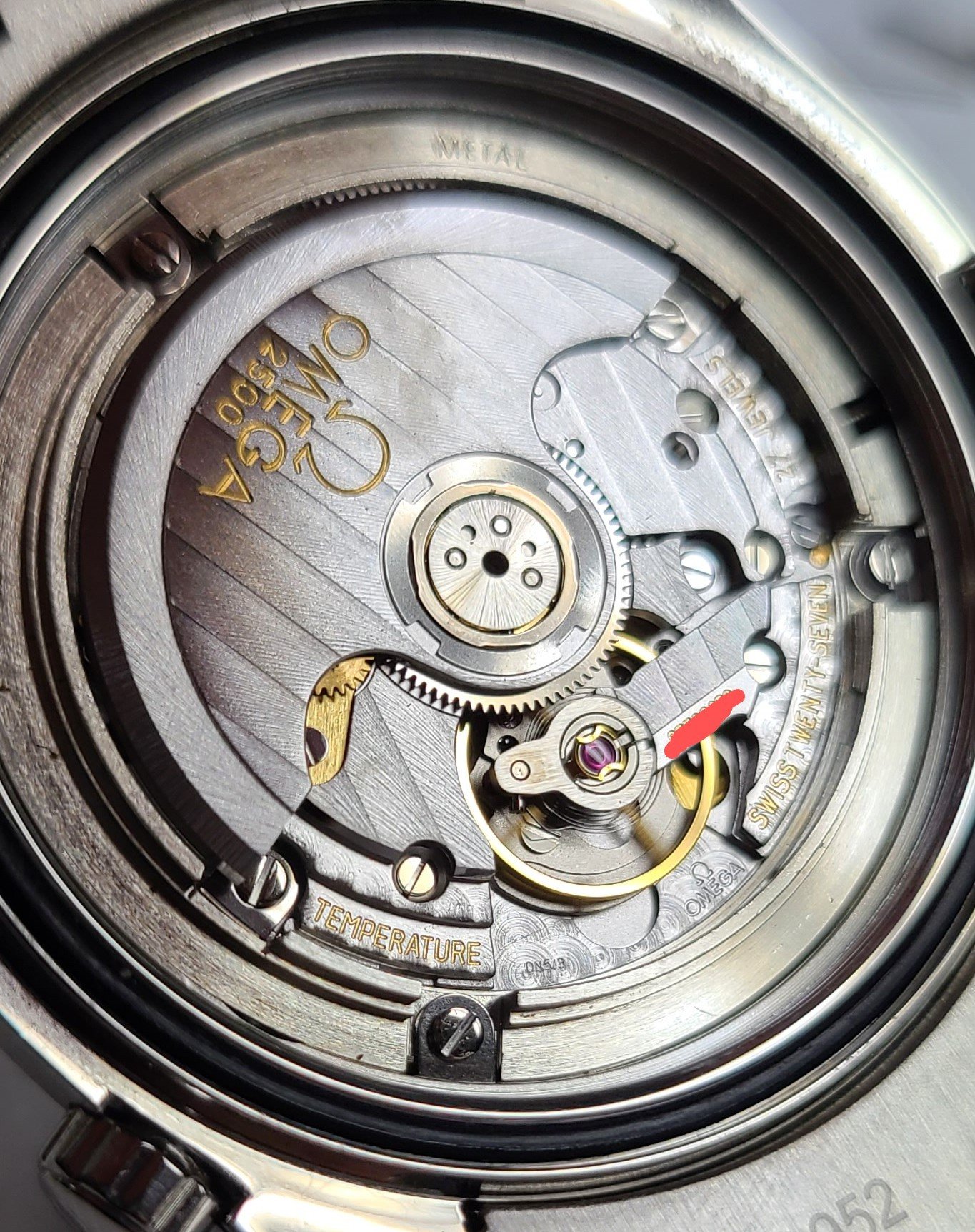

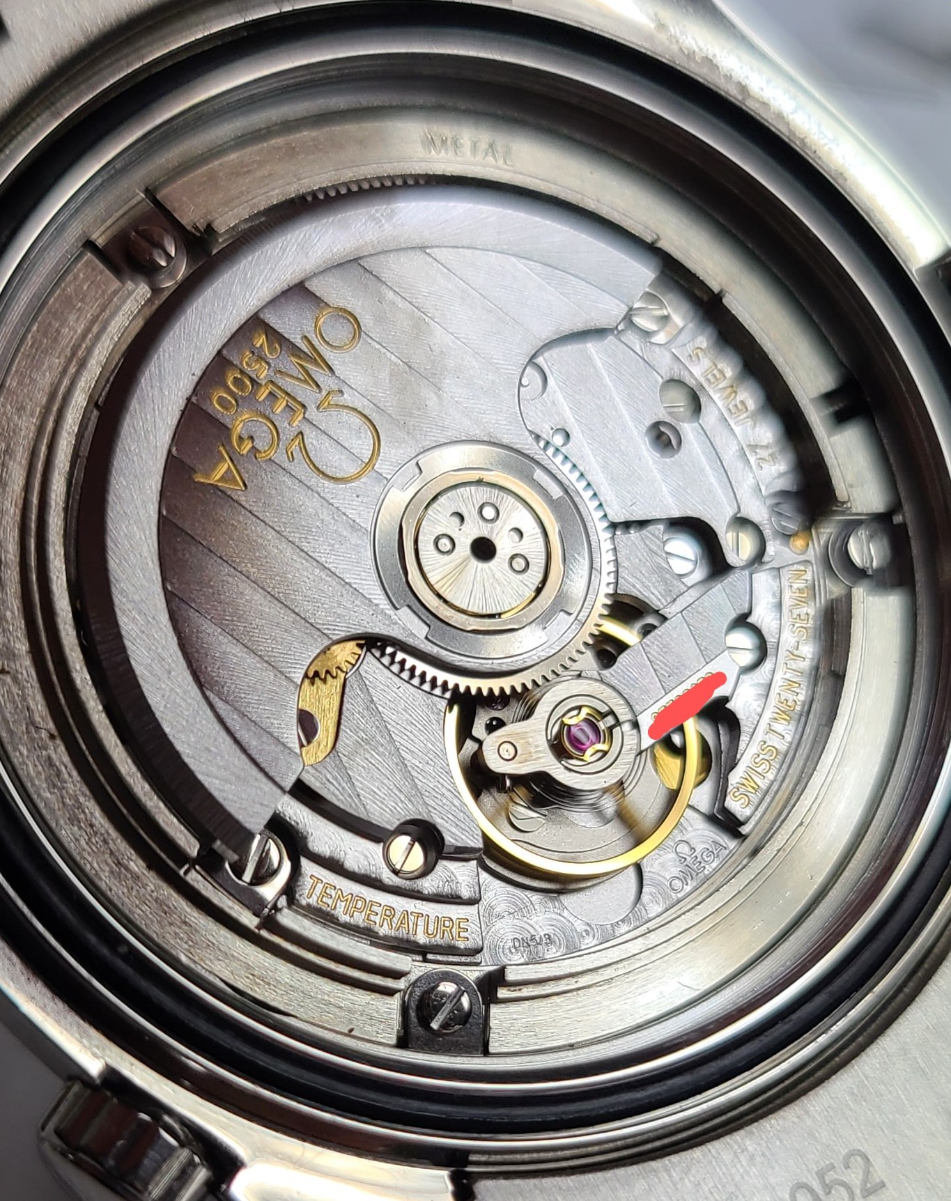

My date wheel looks like the 2500D but on inspection of the movement, where it should say, it just says Omega and the logo. I'm puzzled.
Serial is 855xxxxx

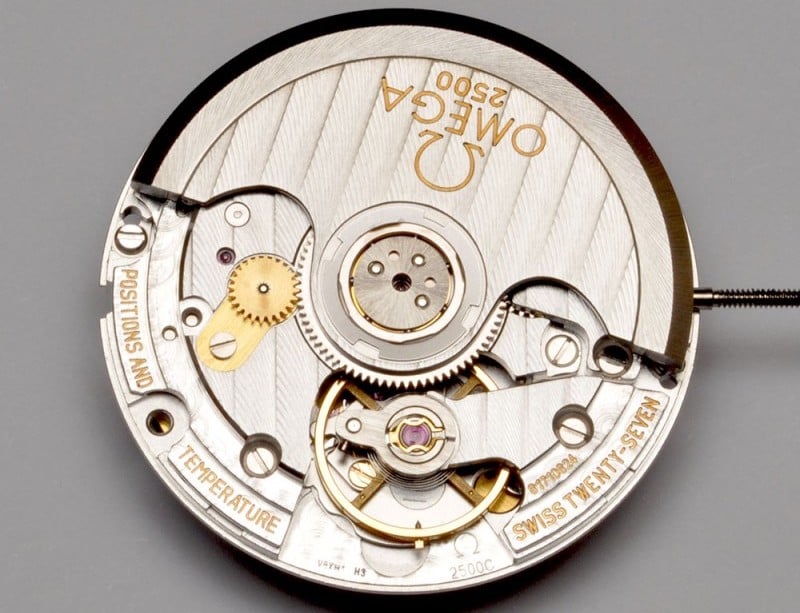

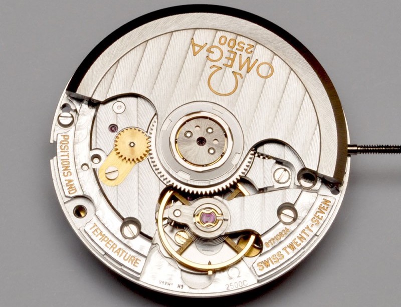

I have read somewhere in this forum that up to 2500C the version is stamped on the main plate, for version D is not.
Up to 2500C, the serial is stamped on the base of the balance cock (just above the "SWISS TWENTY-SEVEN" text, as in the following borrowed picture:
On the 2500D it is stamped on the balance cock arm, like yours.
Also read that serails 8525xxxx and up are likely to be 2500D.

Ok, so all signs pointing to being the D version. But still a bit puzzling as my watchmaker mentioned it's not the D. Or maybe I misheard him. How do I confirm this?
Or maybe your watchmaker is wrong...
With the serial and model number, Archer could possibly check for you.

Well, looking at the escapement will tell you for sure. I would expect the watchmaker to know the difference between a 2-level and 3-level co-axial escapement, because it's pretty obvious.
I can check it if you give me the serial number, or you can call the closest Omega boutique and ask them to do it.

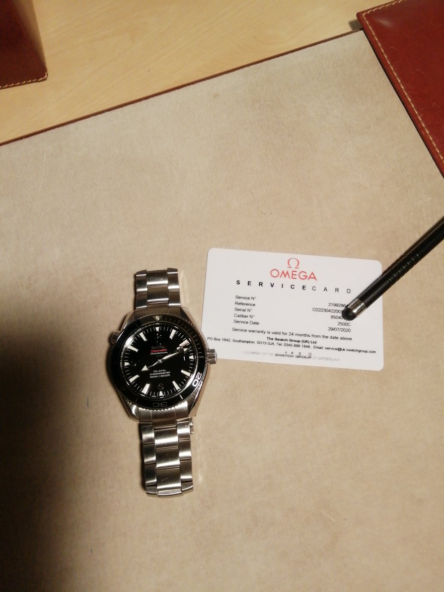

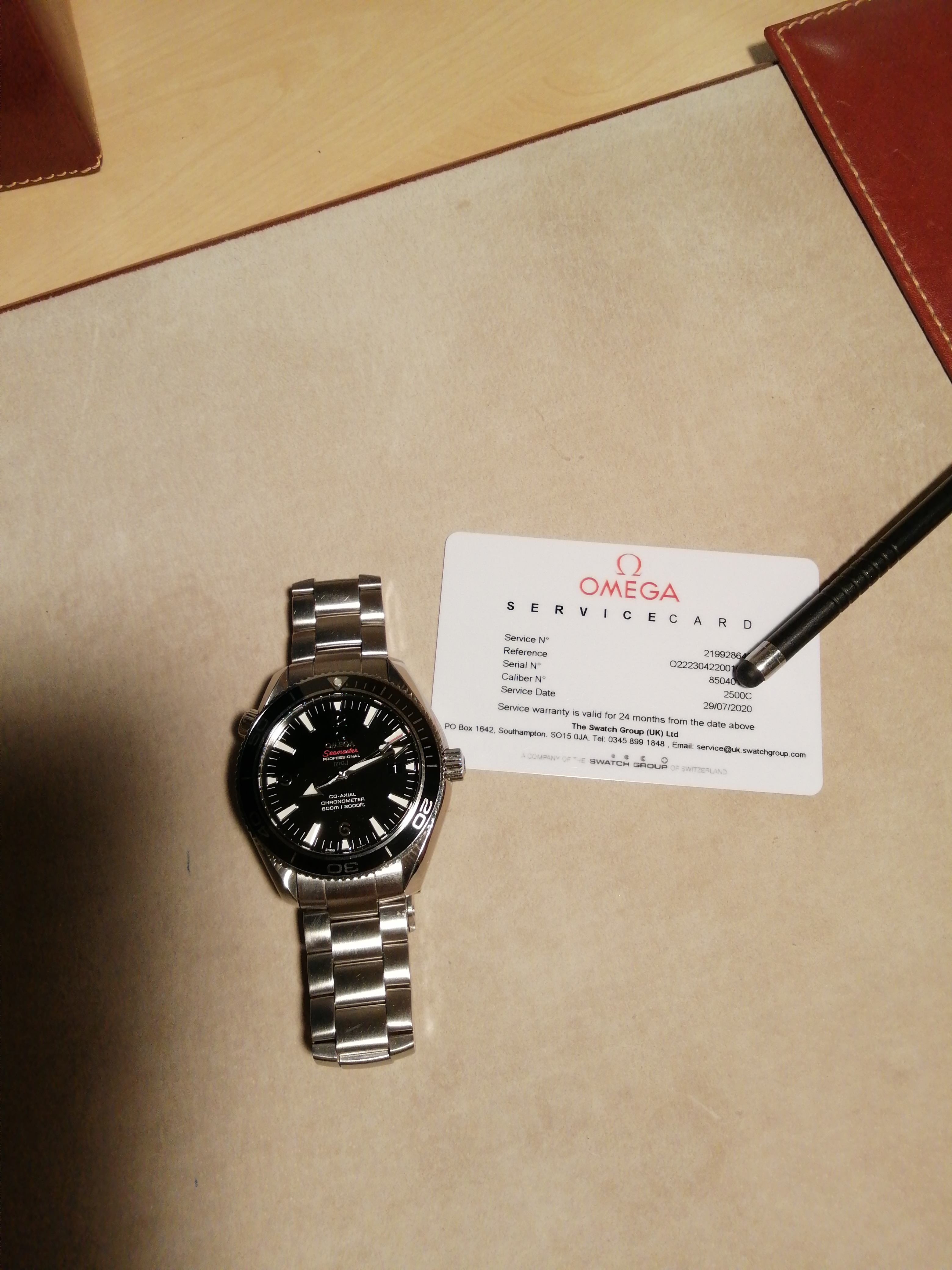

Ask for a service card if you send yours in. Mine is a "c". Regardless of it being a c or d, we can at least be thankful it's not a Rolex 32** calibre.
