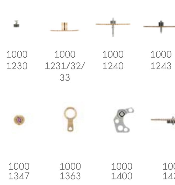

It's worth being cautious here. These calibers are not the easiest to work on and have some quirks - just fitting the hands will require a movement holder that is adjusted to support this calibre. You really do need a watchmaker.
You can get parts lists for all three calibers and put the parts in a spreadsheet to see if they are the same. If they are, then the movement is the same but, further words of caution. Here is an extract of the parts list (actually, the pictures at the front of the document).
All of these start with the number "1000" as will the vast majority of the parts for all three calibers as the 1000 is the base caliber. But, as an example of other possible issues, if you see the hour wheel here (top left second in), it has three options: 1231; 1232; 1233. These are all different heights and suit different cases/dials. If you buy a spares movement, it may come with the wrong height hour wheel and the seller certainly won't know.
