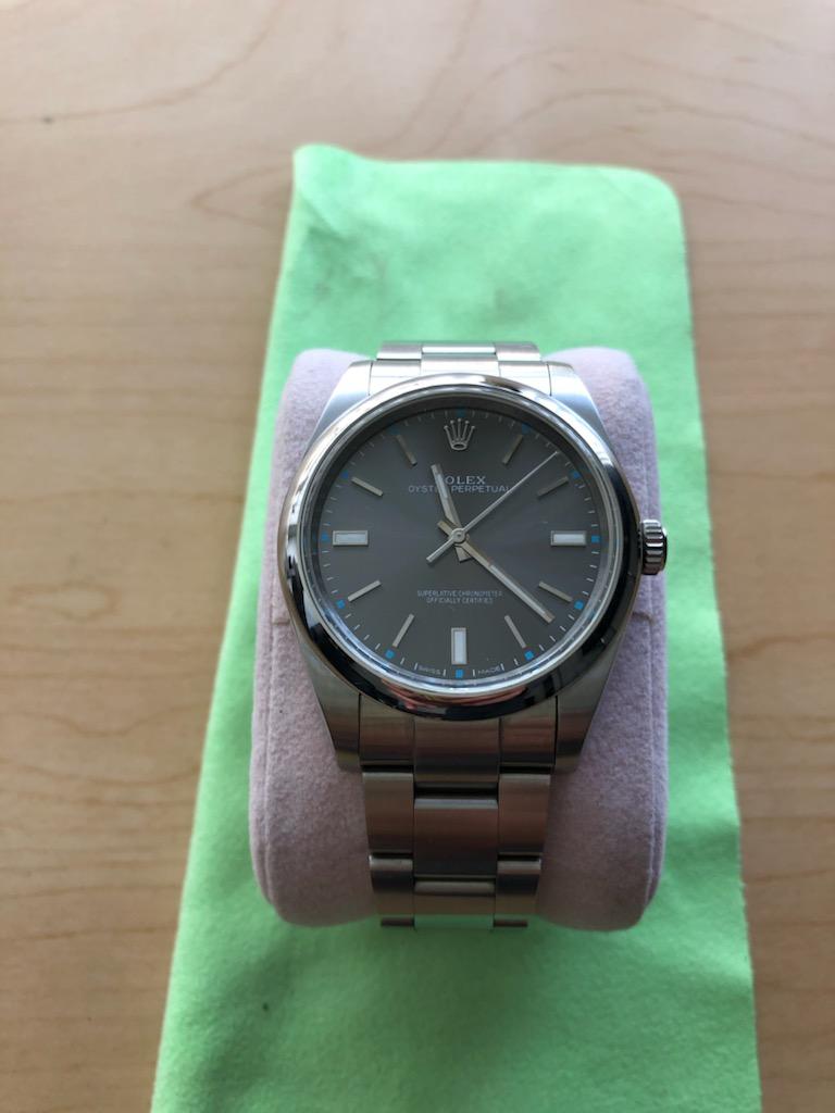

Here's the watch in question:

Can you post high resolution pics of the movement?
There should be an etched crown in the sapphire crystal at 6 o'clock that does not photograph easily. You should be able to see it at certain angles only.

This is all I have right now. I'm really looking for advice on what to look for when I do get it in-hand. So:
- crown in sapphire at 6:00
Seems like it would be pretty easy to tell based on the movement. Even the good clone movements don't have regulation screws in the balance wheel, right?

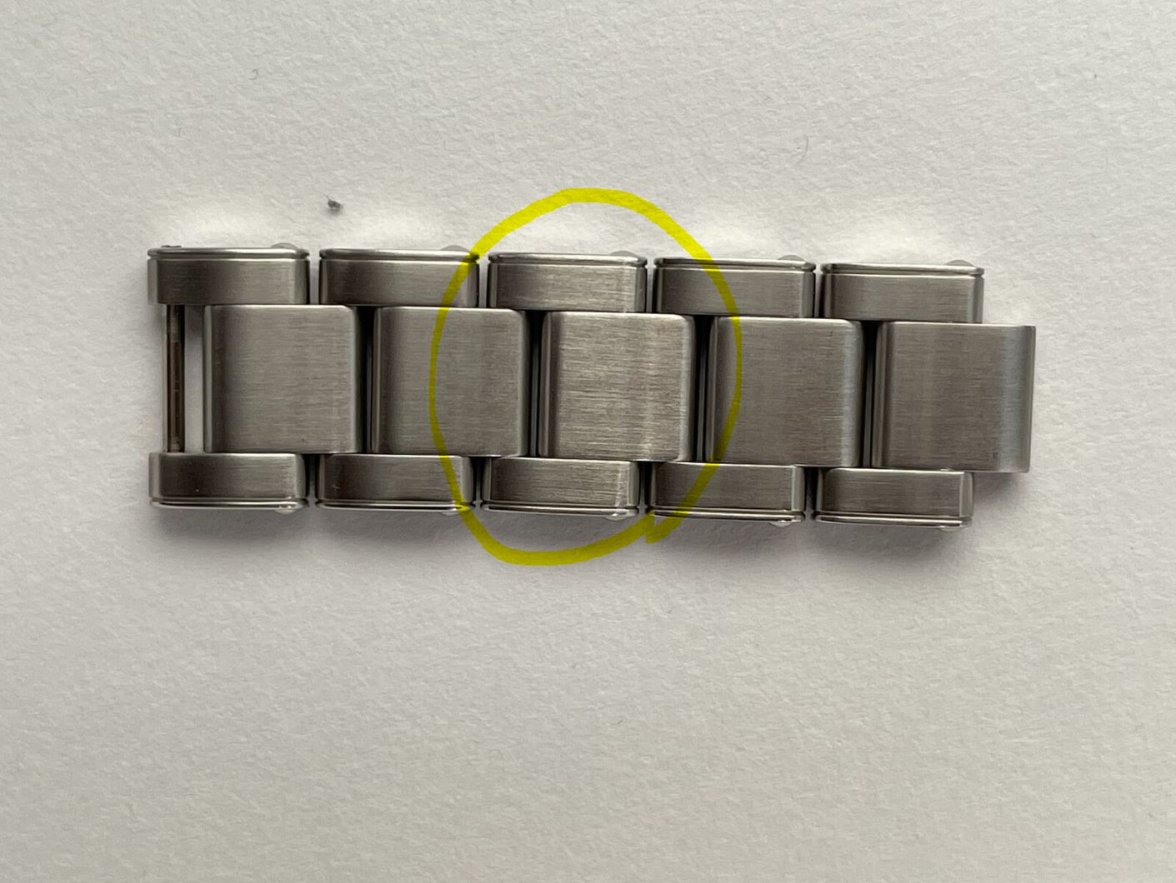

Here’s what I can suggest for confirmation. I usually use my iphone (to zoom in) and need some daylight.
Brushing of the Bracelet
Recently bought extra Tudor Heritage Black Bay links. Seller was great and replacement. Picture shows circled in yellow the non-genuine link. It's next to impossible for the brushwork to be replicated.
If you have your own Rolex and Tudor you may be able to put them side-by-side and snap a picture to look for a difference.
