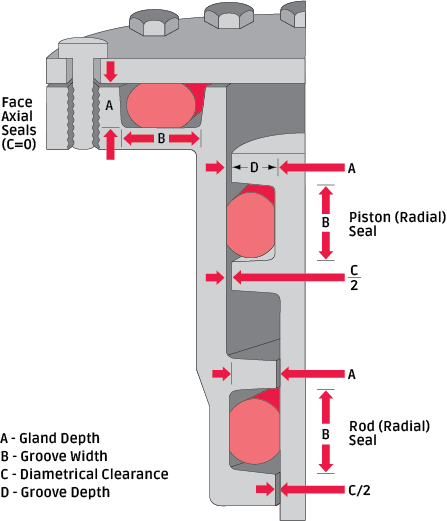

Thanks for the answer. This is really strange, not that I don`t believe you, but its just much easier to get a good seal with axial compression than radial compression seal. In the petrochemical industry we don`t like radial seals, using mechanical shaft seals instead, on gases and other toxic or flammable fluids were a shaft must exit a chasing or a flange were it don`t.
Found a pic of what is meant by axial and radial seals.
But I guess Omega knows what they are doing. Learned something today as well.
I guess the reason for Rolex not using two seals in the case back is because of the better seal of the axial seal and because the case back isn`t regularly operated by the owner thus experiencing less wear.
Not when your crown threads are stripped! 😉
The radial seal is all that's needed - it is in constant contact with the case tube, and the compression is engineered into the design. There's really nothing that can cause a problem here, other than lack of maintenance.
This kind of seal (piston seal) is used in so many applications that the engineering behind it isn't a mystery. Virtually every pneumatic or hydraulic cylinder on the planet uses this design, so it's not something unheard of by any means.
Possibly, but that wasn't really what I was challenging - I was challenging the idea that the extra seal is purely for redundancy.

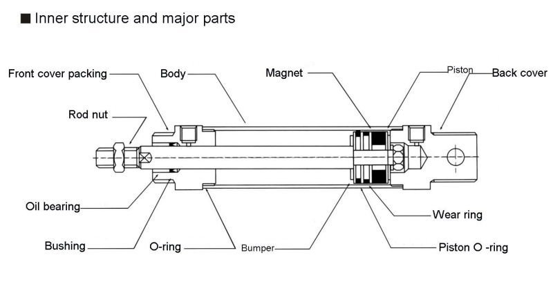

Pneumatic or hydraulic cylinders use Zimmerrings seals with a lip that are pressed against the shaft or axle by a spring and internal pressure. Quite different from an O-ring.
I think you are right if Omega don`t need that extra seal it must be for redundancy. Tri-lock or what they call it, sounds good in marketing though. I would have been comforted by that fact I think.
I think you have misunderstood my point. I wasn't saying that they all use O-rings (although many do) but that they use a radial or piston seal design. This is why it this design has the name piston seal...
Back in my engineering days I worked with many cylinders, from 1 inch bore up to 30 inch bore. They can use a variety of different seals, but often they were just simple O-rings, depending on the application.
