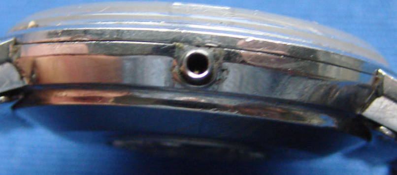

    Hi all,
    This might be an ignorant question however I won't know unless I ask....
    Found this watch that is not running with a broken crown, what are the price ranges I'm looking at to get this up and running? Case and crystal also in rough condition.
    Thanks in advance for all your help!

    Well the movement looks to have barely been touched in all those years, the screw heads are in great shape. The case looks in good shape too, so depending on the rest I'd think it could be a watch to invest the €150 or so a 565 would probably cost to service. Parts would be extra, although I'd wager this one doesn't need much more than a clean and lubrication. A correct crown and crystal around €100.

    I think it will probably costs around EUR 300 if I bring it to my watchmaker. 175 with tax for a cal 565. EUR 75 for a original omega plexi and 50ish for a crown. If you bring it to a omega service centre you can double or triple that...

    I might have the plexi and crown in stock if you give me the case number, It looks like you might need the female part of the split stem too.

    The original Omega plexi is all scratched up so will need to replace that too. Just hoping nothing major is wrong with the movement and wanted to gauge what the damage/cost would be at the max. Still looking for a good, trustworthy watch maker in NYC or Toronto.

    Just wanted to update everyone here. Finally put in the work and here is the result. Apparently, it was difficult getting an original crystal since there is a metal ring that flushes against the dial. So a little buffing actually took off most of the scratches. Cleaning was needed and a few replacement parts. Let me know what you all think! I'm very happy with the result. Everyone here was a big part of me getting my first vintage so thank you very much!
