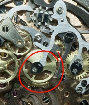

It's due to the shape of the "coeur du mobile" (I don't know the english name) :
With this pics it's very obvious

The hammer drops onto a cam - the cam is heart shaped, so it just depends on what side of the peak of the cam the hammer hits...if it hits on one side, it will go one direction, and if it hits the other, it goes the opposite way.
Exactly. Intelligent design. 😉
