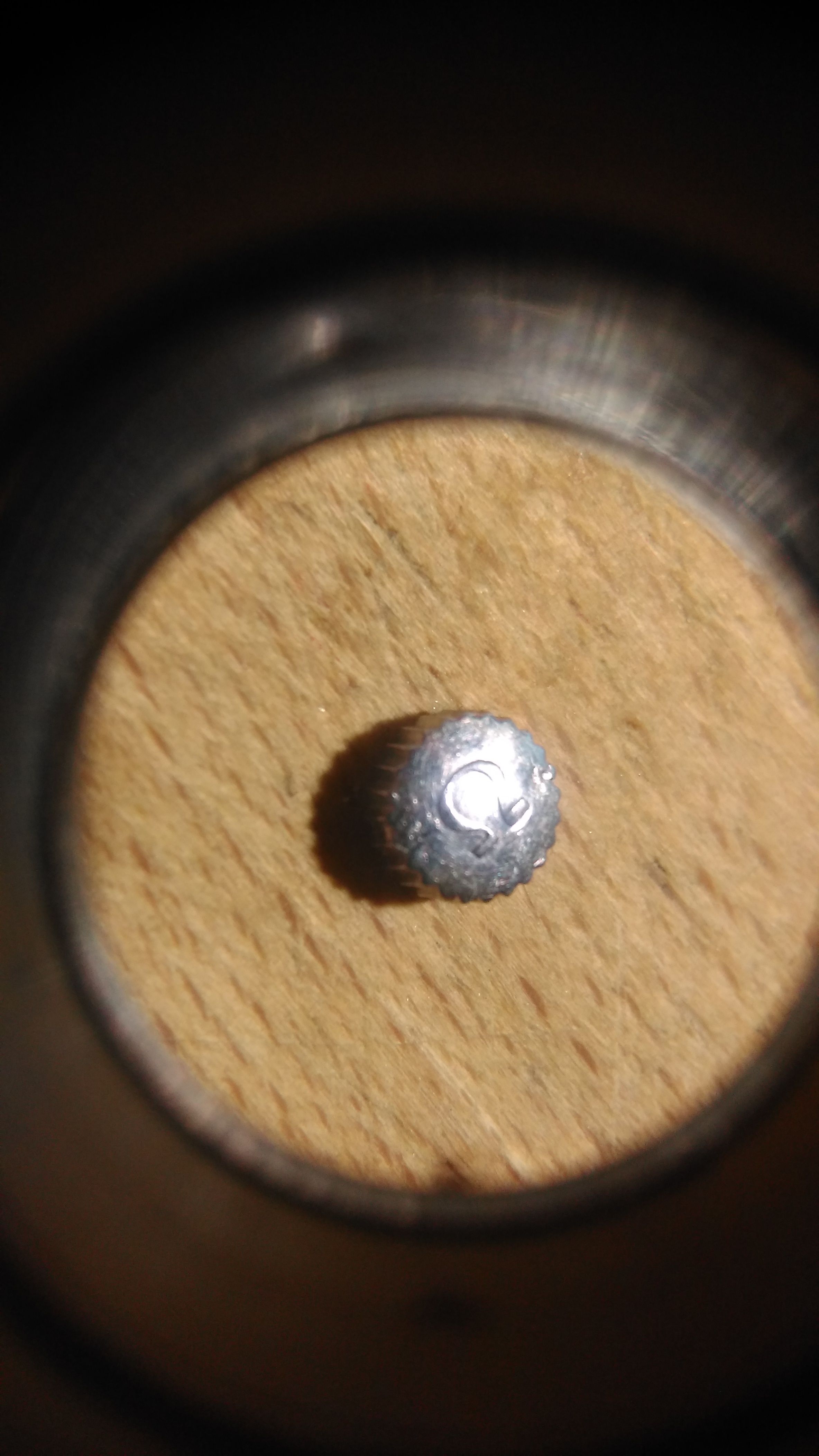

    Hi fellows,
    As I said before, I'm servicing a vintage SM300. Of course the stem was broken due to some rust. I'm willing to save that crown because it's unusual. See the narrow logo. Of course I could replace it but it won't be originaL I think that you undestand me you geeks!
    There's a tiny part left out of the stem. really small and rusty. What do you suggest. I thought of 2 things. Drilling with a 0,5 mm drill or try Vissin.

    Since the stem is ferrous and the crown is not, you might burn it out with an EDM. Well, not you (nor me!) but an expert.

    Could the stem be dissolved with an alum solution?
    Archer likes this.
  8. Archer Omega Qualified Watchmaker Apr 13, 2016
    26,432
    65,379
    You can pay Bergeon for Vissin if you like, but alum from the spice aisle at the grocery store is a lot cheaper...

    Place and cover completely in a small bowl of white vinegar, cover to prevent evaporation, come back in a week...
