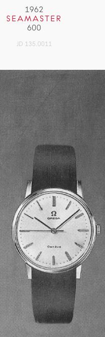

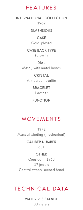

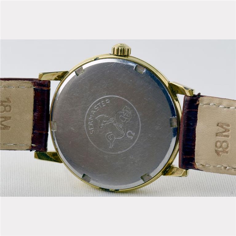

  8. JimInOz Melbourne Australia Sep 30, 2016
    15,489
    32,377
    Genèves has Seamaster inscribed casebacks.
    The Omega Vintage Database shows this model with a Genève dial.
  9. JimInOz Melbourne Australia Sep 30, 2016
    15,489
    32,377
    Omega was all over the place with Gèneves/Seamasters/De Villes at that time so a Gèneve dial could be OK.
    The damage on the watch could just be dirt, but more like loss of gold plate.
    Also more spots on the lugs etc.
    If you want a nice watch to wear, it's OK.
    If you're a collector after a NOS/mint/rare item then keep looking.

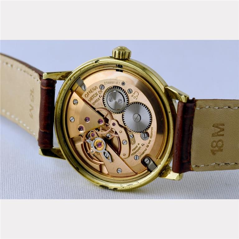

  10. cristos71 Sep 30, 2016
    7,157
    32,938
    Sometimes even Seamaster Geneve´s ;) This one also a cal 601.
